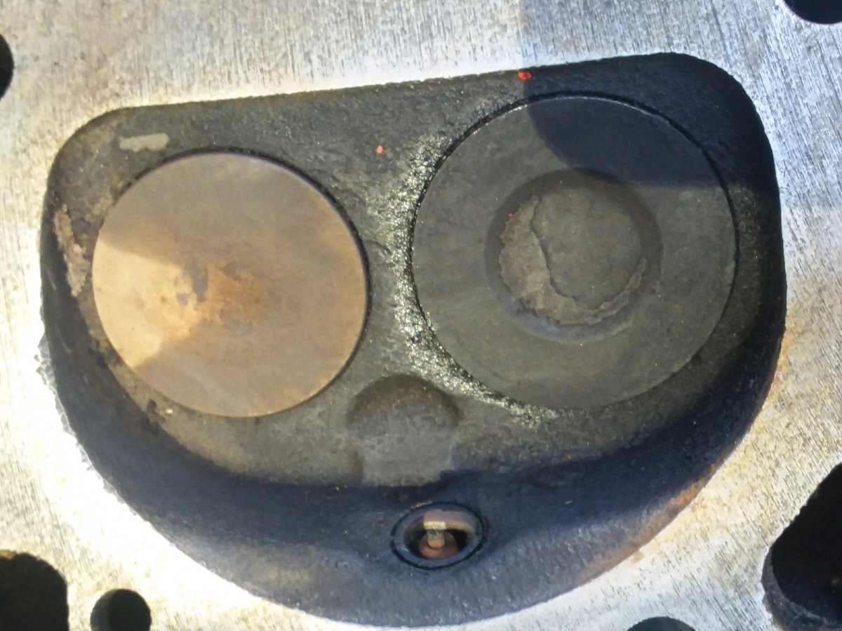

    so thats what the bottom of the heads look like im pretty sure those exhaust valves are burnt but its my first engine so thats just an ***umption based on the color of them

  5. I don't see any burnt valves. If they where mine and I wanted to use them I would clean them up and lap the valves. I run several engines on corn gas that do not have hard seats. I simply add a quart of diesel fuel to every tankfull of gas. Now I reciently put rings and bearings in a couple of 283,s. And I used 602 casting 305 heads and the stock factory 305 cam and lifters. too much lift and duration on a short stroke 283 and you dont have any low rpm drivability. Those 305 heads have smaller chambers and larger intake valves and are set up for unleaded gas. Now I have a 327 I built for my 55 chevy. And Ive pretty much got my choice of any type of stock cyl heads. However I installed a extensively reworked 57 power pack heads on it. Why? Because those heads where on the very first 55 chevy I ever owned. And they are stagger bolt pattern. and I wanted to use a set of cast aluminum finned valve covers that I bought new when I was a teen. ngines 007.JPG

  7. You can dissemble your heads clean up the valves on a wire wheel and lap them and it don't cost anything but your time. If the heads are crusty spray them with oven cleaner. Ive been adding diesel to my gas for decades and its never caused any problems.
