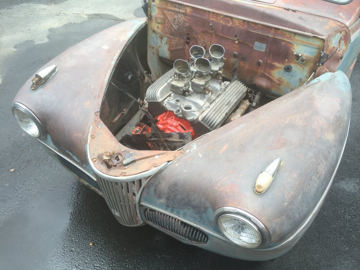

    These are the heads, someone can correct me if I'm wrong
    jetman likes this.
  4. Chris
    Joined: Jan 5, 2005
    Posts: 14,500
    Chris
    Ok thanks, and no the cars not my daily driver, but I drive it a lot. I also know a lot on Stromberger carbs, and zero on 4bbl or rochesters which is also a bonus on running this set up

    Great, thanks. I bought some Stromberg linkage extensions and planned on running straight linkage like this setup @***us did on a customers car. Very nicely made pieces

    Chris, one other thing I have heard, you probably heard the same thing, is you need some sort of bar to support the outer end of all four throttle shafts in the same plane, or you won't be able to sync the carbs consistently.
    Chris likes this.
  11. Chris
    Joined: Jan 5, 2005
    Posts: 14,500
    Chris
    The two "floating" shafts have a support coming off the drivers side carb mounting stud (look close at picture). Is that what you mean? It holds the long shafts steady, and I will use 4 arms and a strait piece of shaft to connect all 4.

    I was looking at his photo. looks like he has an extension tied to the carb closest to it. I've talked about this with jeff(***us) on just how important it is to tie them all together. if anything, it would probably accelerate shaft bushing wear without some sort of support.
