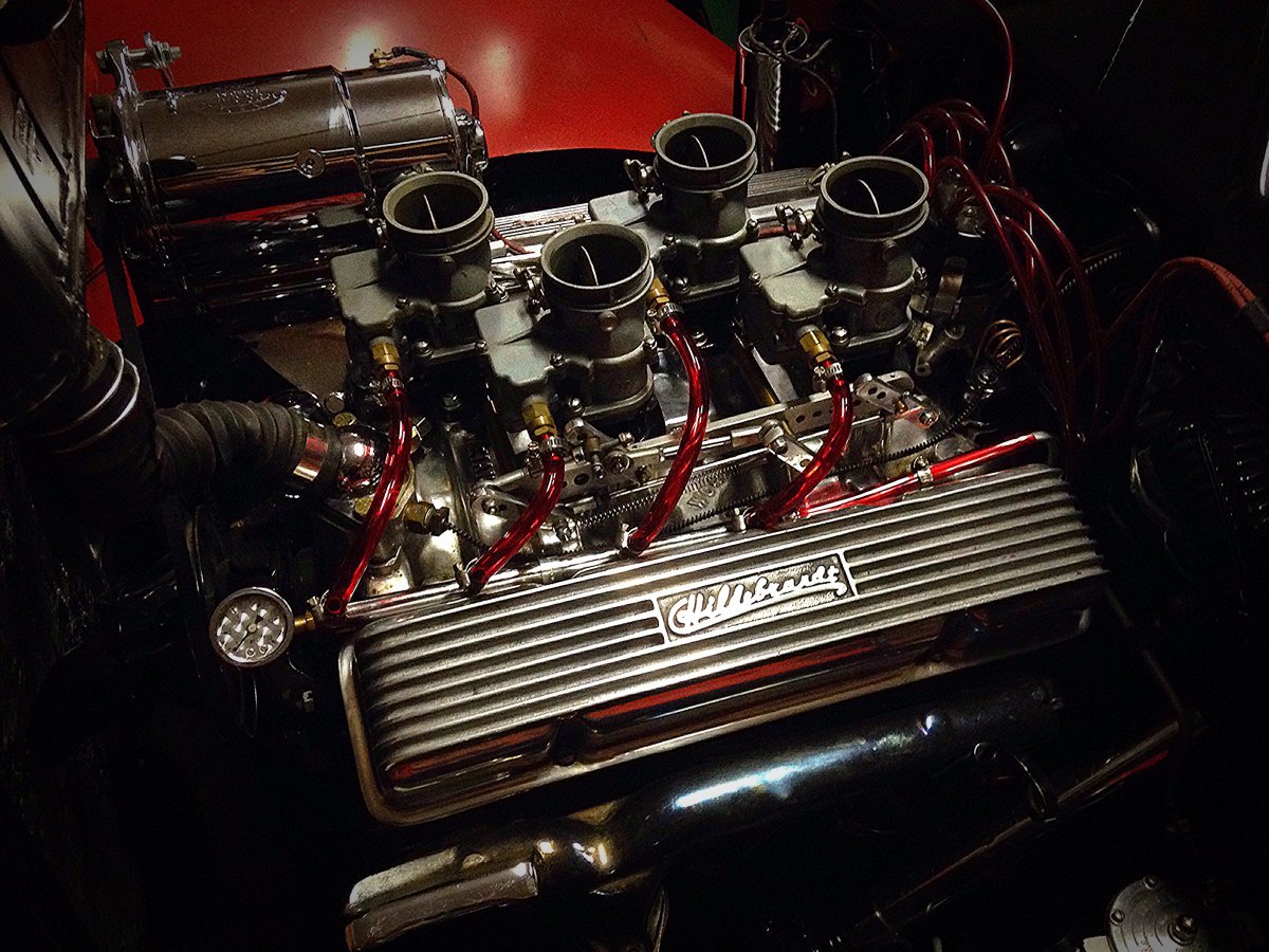

    Chris, the 4x2 would really have the "wow" factor if you have all the carbs dialed in. My 46 has a 60 power pack 283 that was bored .040 over, and I put a L79 cam in it. Idles at 650-700 RPM. Its the perfect cam for your application. I'm running 2 carter 9400-s 400cfm carbs on a eddy c-26 intake. Got to drive the car before the snow came, and it is a pleasure to drive. Took out the front axle Monday and sent it to Sid's, so its going to be a long winter!

    I spoke With Jeffery James last fall at a show about the 4 X 2 setup on his 35, as i am dying for one and on the hunt for an affordable 4X2 Weiand Manifold for my 39. He says it runs and drives awesome, and was relatively easy to set up. Just as others have said the Linkage was the most important part of it, i believe his had a linkage from Stromberg, it was really nice. His has a 265 in it i believe but i know it has a Duntov 097 cam in it and man does it sound perfect! I already have that cam for the 283 that i am putting back in my 39. Build it and run it!, or i'll trade ya a nice early weiand 2X4 setup for it......

    The 097 cam can be bought as a Melling copy of that original grind for about $100, got mine from summit for that price. He is a Pick Of the motor in JJ's 35. IMG_1-8.jpg

    Yes I know JJ very well and have picked his brain about this. He loves his set up, I think he even has an extra manifold. I believe Dickster did his linkage.

    Not sure about the four/twos setup. A friend of mine has it on a 350 and at full throttle I had to ask him when was he going to get after it as nothing seemed to have happened. I believe a single four barrel would have had a better response.

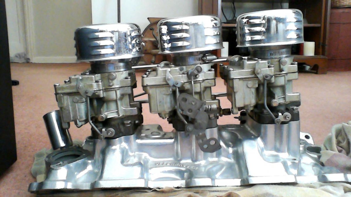

  30. I'm doing the progressive 3 2bbl. on my 57' 283 vs. 2 4bbl.. Great economy and won't "wash out" the rings when I put my foot in it.. Also, to really benefit from massive intake flow you have to have massive outake flow. How big & loud an exhaust system are you willing to use on the street?
