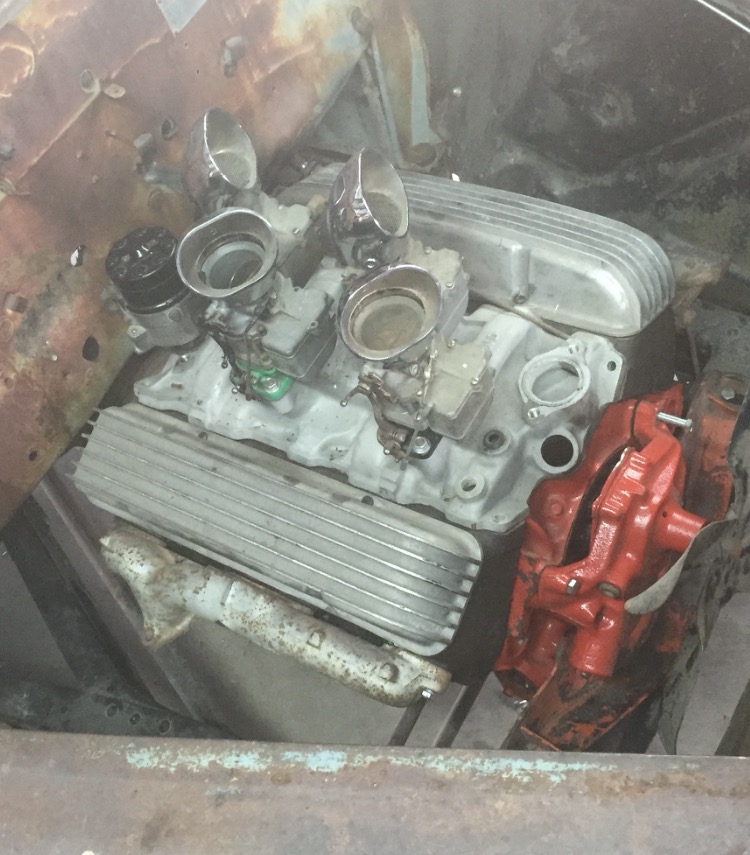

    That looks like it has a bar tying all 4 throttle shafts together. Is it just a piece of bar stock with 4 holes drilled into it? Any close up pics of it's something special?

    Chris, that's what I was thinking of in post #10. Yes, basically a bar with four holes in it.

    I made this one out of 1/4" bar stock with holes and bushings in it. without it there is a ton of movement on the extended ones before the throttle plates open
