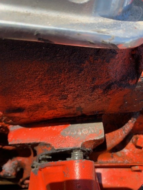

  11. woodboater
    Joined: Jul 12, 2021
    Posts: 38
    woodboater
    Hey guys, have a head scratcher I figured someone might have run into in the past. I just bought a 283 to run in a project of mine, it is a 3849852 casting, I have several of them, the strange deal with it is that it has F03I6XF stamped on the pad. According to what I can find, that would mean it is a 69 350...it has the vent tube on the rear. Came out of a 56 Chevy, looks like they bolted the 56 intake and all peripherals on the 283 as it has the old school distributor and a Rochester 2 barrel. I am including a pic of the stamping so you can see I am not just drunk...anyone run into this kind of thing before?
