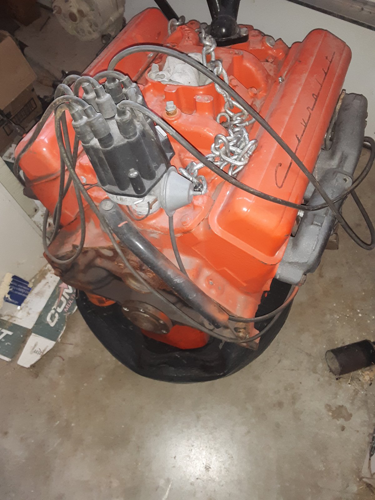

  2. Dodged rain and snow showers to haul my 283 home from a friends. I will buy all this junk I can find. 20220521_151410.jpg
    61Cruiser, raven, Baumi and 8 others like this.

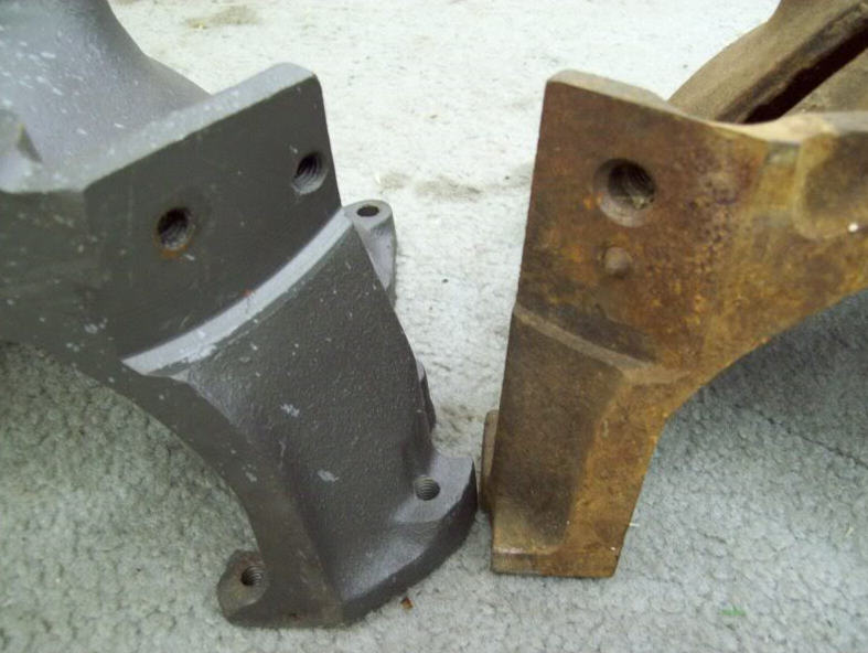

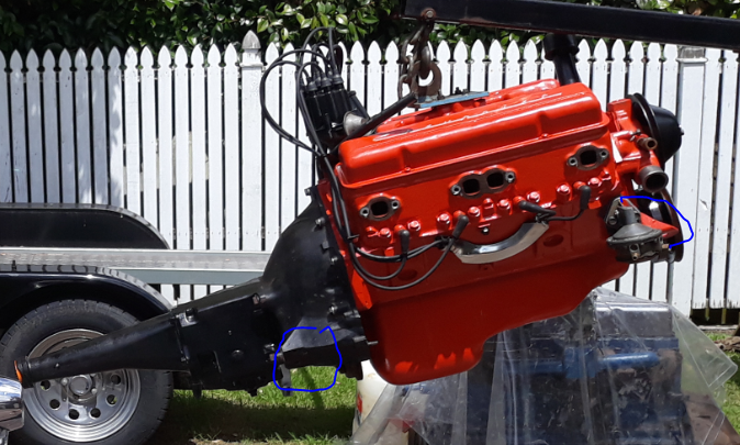

    Hey Mate! we can all be heroes when spending somebody else's money. But the cheapest way to go is install the parts that belong to the vehicle.
    You cannot use a 350 bellnousing with your existing transmission [neither have provisions for rear mounts]
    You need the side mounts of the bellhousing to control engine torque.
    The simplest method is to find a 55-57 V8 bellhousing and the V8 front engine mount brackets and everything simply swaps over.
    [circled in blue] note there is not a rear transmission mount on a 55-57
    You cannot use a truck bellhousing [they have different bolt and angles for the mounts]
    [Car L , Truck R]
    Your frame is already pre-drilled for both 6 and V8 front mounts [circled in blue] this photo also shows side mounts that somebody welded on [red] You dont need these side mounts.
    If you use the factory bell and front brackets the engine will bolt in, your transmission will be in the same position , same driveshaft length, and the stock 3 speed column can still be used.
    6 cyl and V8 57's used the same 3 speed Muncie sm-318 trans.
    Also watch what oilpan you have. Late model deep sump pans hit the steering [you should be OK with the 66 283 pan if it is the original]
    Baumi, Torkwrench, ubuybme and 4 others like this.

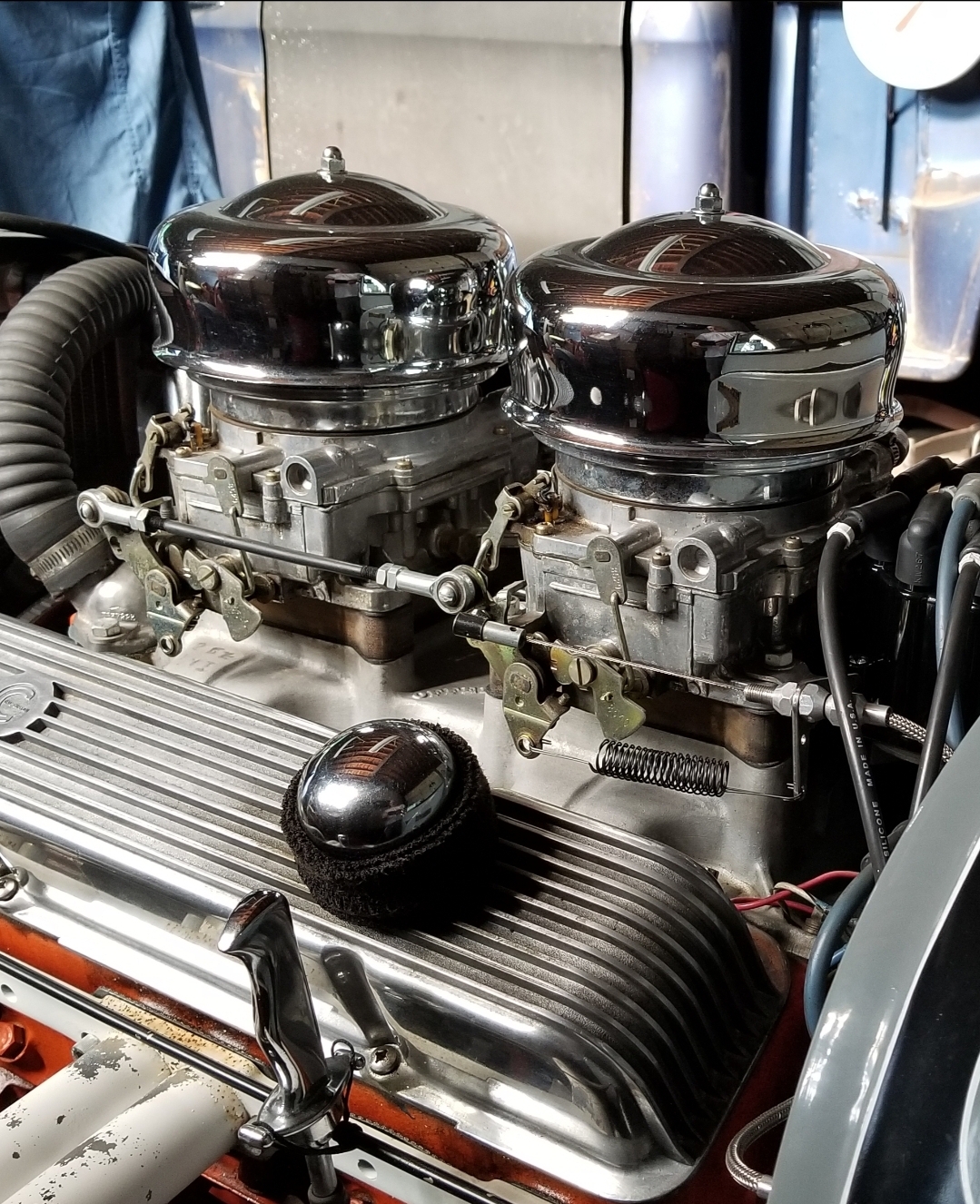

    Back to the topic of dual quads on a 283, if a picture is worth a thousand words, how many words is a video worth? How about 2, or 3 videos? OK, here's Bryan McCool's *****in little 34 Ford roadster, there's a build thread on the car here on the HAMB. Dual Edlebrock 500 cfm quads on an Edelbrock manifold with progressive linkage, on a 283. I don't know anything about the engine, it may have a mild build, or it may be totally stock with just the dual quads and headers. You can spout all kinds of stuff about how dual quads just won't work right, how a single quad is better, yada, yada, yada. Or you can just enjoy the videos:
    This next one can't be embedded for whatever technical reason, but here's Bryan out enjoying his roadster (before he sold it!), too bad he doesn't know that it won't run any good with those dual quads on it....
    https://www.youtube.com/shorts/NsnVk7BMyRI
    Like I posted earlier, it'll probably be better to swap those 600's out for a pair of 500's, or even a pair of 400 cfm AFB's if you can find them; or even a pair of WCFB's. But don't let these guys convince you that they won't work, they do. Here's the proof.
    SS327 and Tman like this.

    Here's that sweet little 283: [​IMG]
    Imagine popping the hood on that 57 and seeing this. Stick to your original vision, don't be swayed by these naysayers.

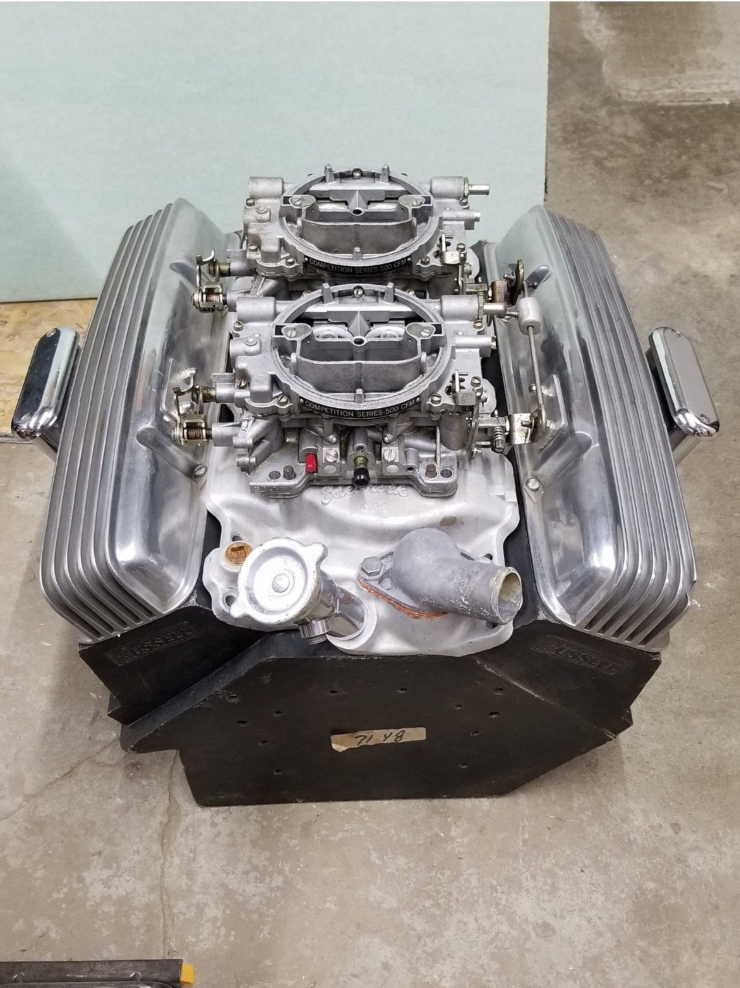

    I agree with sticking with your 2x4 setup, nothing says old school performance like a pair of dual quads, I've been running this setup for 15 yrs without issues.
    I actually have 4 cars with 2x4 setups in varying brand, height, width and function, they all run great with easy drive ability once tuned, plus I have a handful of backup units waiting their turn just incase.
    You just can't beat the looks

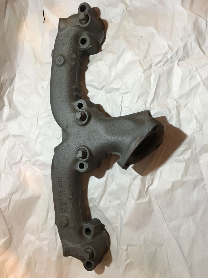

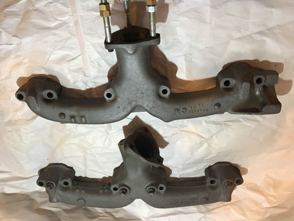

    If you haven't pulled the trigger on the exhaust manifolds (I'd) wait. 45 angle won't be any issue but seeing those plugs in them and the driver being the wrong style generator/alternator mounting surface. But that's just me knowing how a tri-five should look as best possible when collecting parts.

    SEE.... Yep.....So bad *** looking and seems to run great!! I'm doing it. I will get smaller CFM carbs though.
