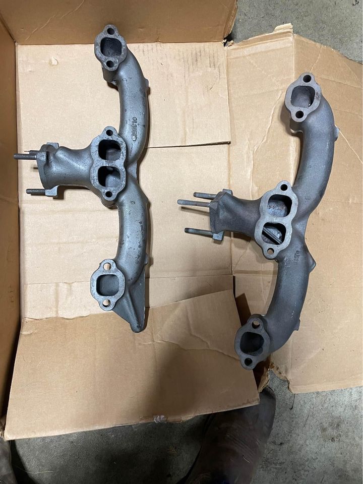

    So you're saying those plugs are mounting taps for the gen/alt and they're on the wrong side? They should be on the drivers side correct? For the 283?
  2. Johnny Gee
    Joined: Dec 3, 2009
    Posts: 14,642
    Johnny Gee
    from Downey, Ca
    No no. The 4 pipe plugs on the p***anger manifold that has 45 degree dump. Drivers side should have this type generator/alternator mounting point.

    How about these? Fuel injected corvette....does it matter?

    That's the look you would be after. Just watch out for "Corvette" sellers pricing.

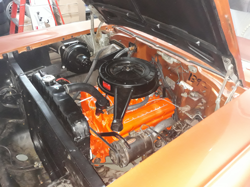

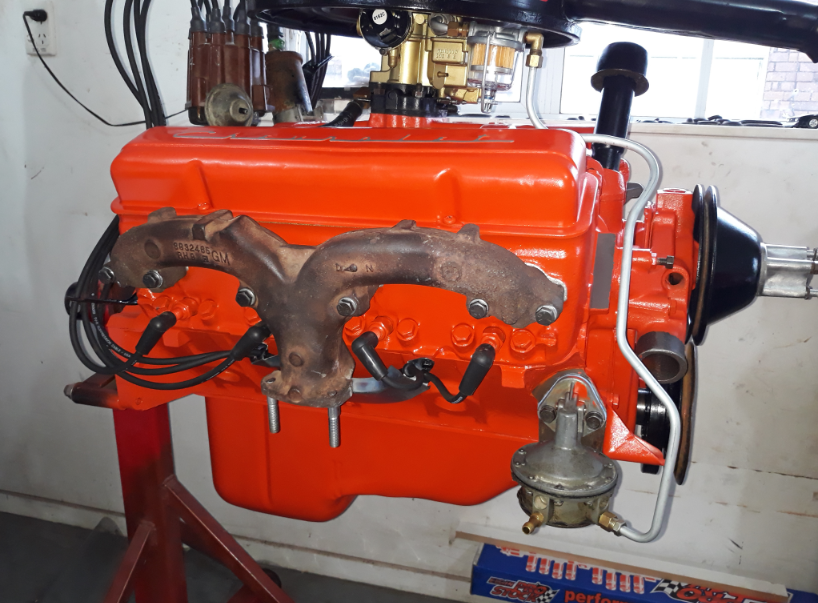

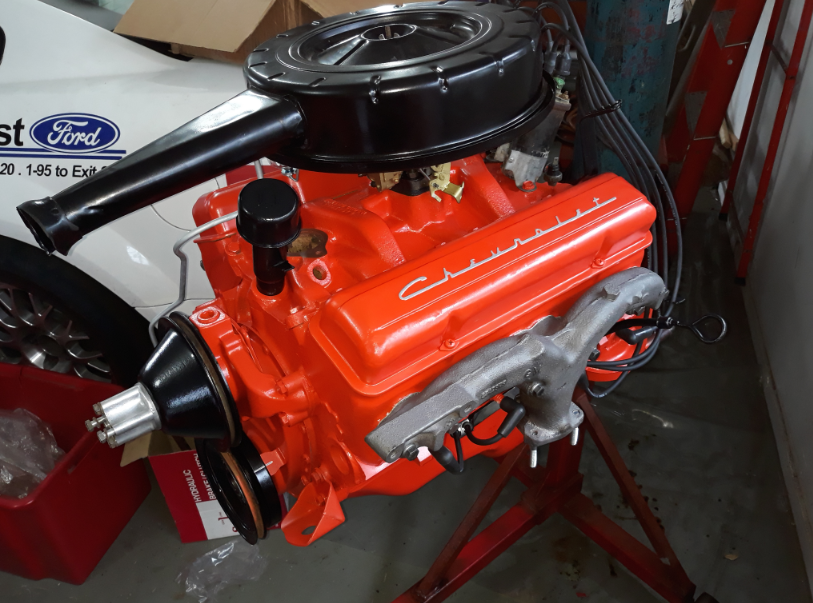

    That L/H manifold you have shown is for an alternator bracket.
    If you get the correct Generator type rams-horn manifold your existing 235 generator bracket [that bolts to the 235 block] will attach to that.
    Generators are less desirable in modern conversions so the generator mounting exhaust manifold is used less often and should be readily available.
    Please excuse the incorrect 1958 Air Cleaner [I wanted a dry paper element]
    My engine is a "Bitsa" .
    I used small port small chamber 265 heads and 2 barrel intake on my 283
    With a zero decked block it cc's at 10.0:1 compression
    I chose a low RPM "torque cam" and a 2 barrel 2G carb.
    This engine pulls very hard up to 4500 rpm and with the 3 speed column shift is quite pleasant to drive.
    I don't need to downshift all the time in traffic.
    My goal was to get an old 57 Chevy to behave like a Diesel SUV
    I still have the original correct matching heads and intake /carb in my garage for later use.
    Other mods were a single big-bore exhaust, electric choke, canister oil filter, PCV valve, rubber rear main seal, priming electric fuel pump.
    Remember our grandmothers probably drove these cars as daily drivers back in the late 50's early 60's, so there is no reason why they can't be used as a daily driver today [with a few carefully selected mods]
