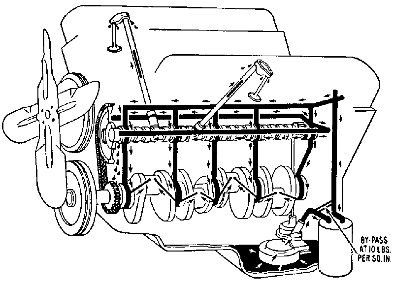

    I don't know what the hell you are working on but his small block Chevy distributor turns clockwise the same as all right hand twist drill bits. A Small Block Ford distributor does turn counter clockwise.
    SBC oil to the mains flows down the Galley above the cam and around the cam bearings in the groove then down to the mains.
    A Missing galley plug at the front of the engine would cause a no oil pressure condition.
