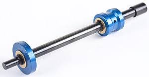

    Also, can you post a picture of the priming tool you're using? I know you said it's a Summit tool, but it would help to see exactly what you're doing.

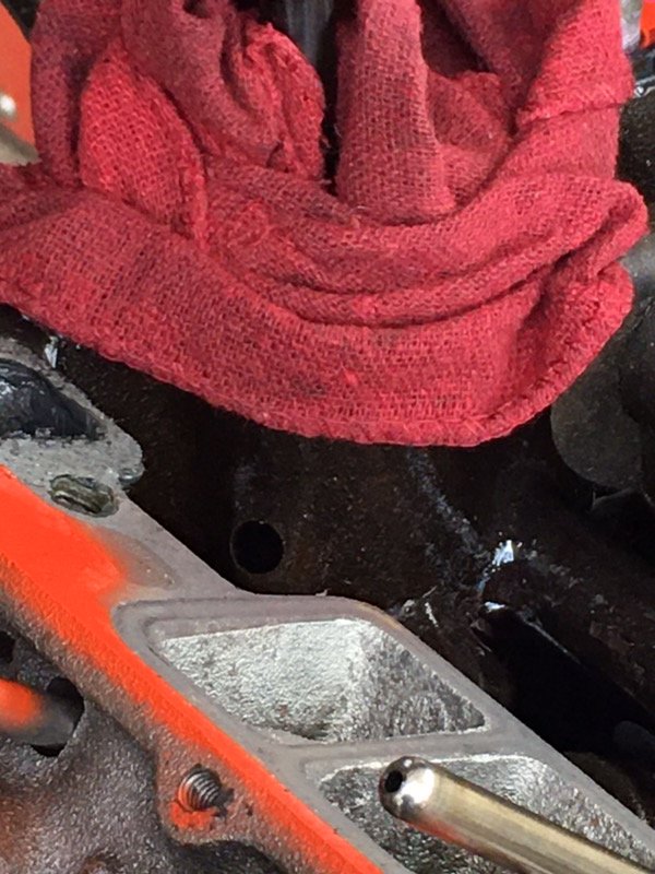

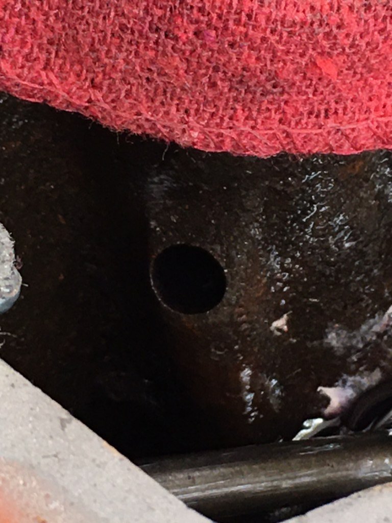

    I pulled the intake off and have good coverage through the lifter valley. I did notice there is a “hole” in the casting of the distributor tower. Whenever I run the priming tool, oil blasts out of it. When standing at the back of the block, the hole is oriented at about the 1:30 position and is angled slightly upward. And it is good pressure. It looks like a factory hole as opposed to someone drilling it. However, it seems likely to me that that is where all of my oil pressure is going.
    I havent looked at any pics of other blocks tomsee if it’s supposed to be there or not. Its not tapped with threads.

    ^^^^^ That explains why only #7 is oiling. Now show us your priming tool.

  6. spook498
    Joined: Sep 26, 2009
    Posts: 188
    spook498
    Right at this moment I dont have a spare gauge, I have to run to town to buy one. But rest ***ured, I have plenty of pressure after the gushing mess I have on the shop floor.

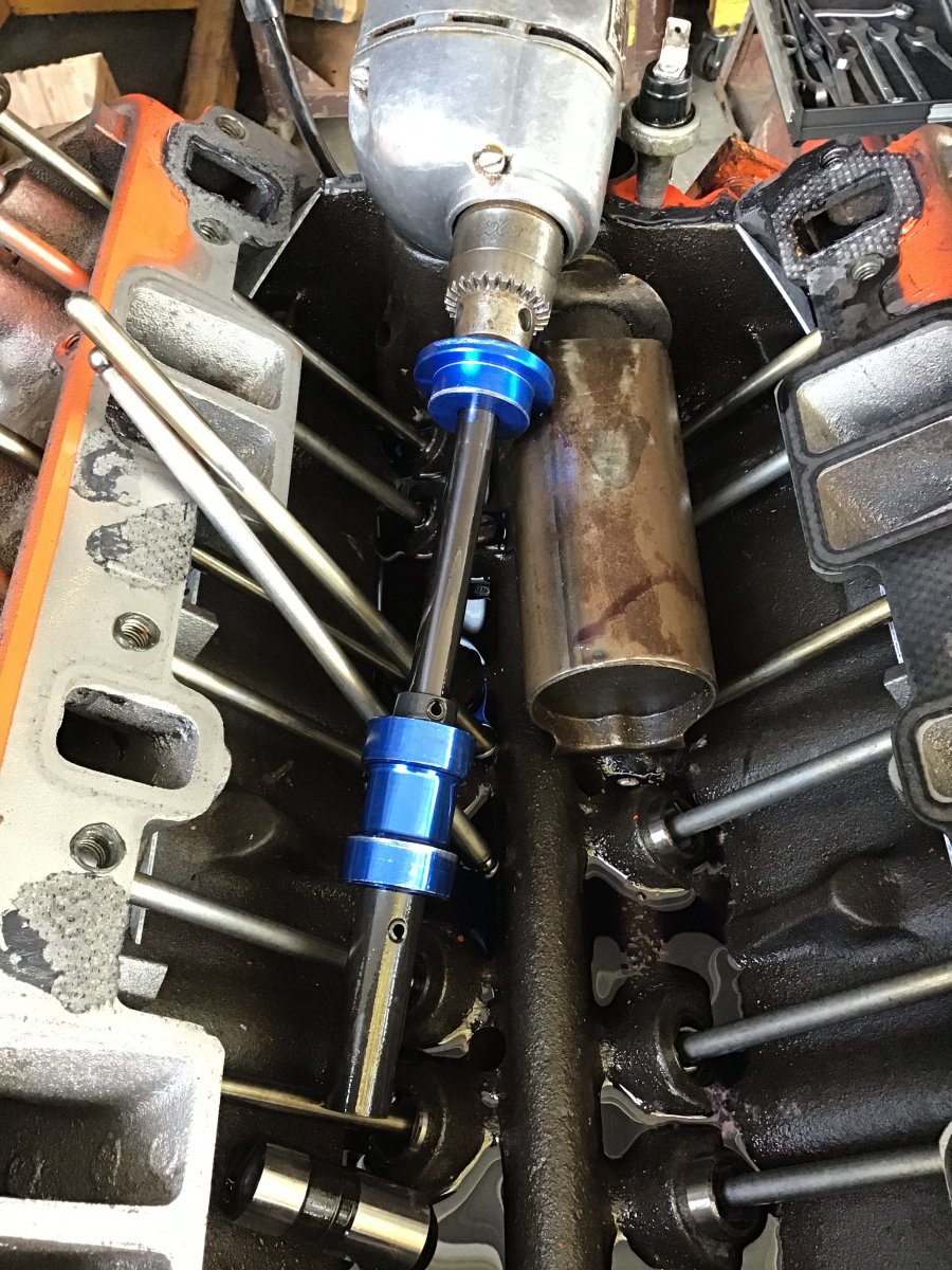

    Here is the tool I am using.

    and looking at other 283 blocks, that hole is there.

    Ok I'm sorry. Is the lower bushing of priming tool sealing correctly (not too small around) and positioned at the right height?

    I would have to measure the height on everything. It sits in the slot snug and has almost no wiggle to it. I will measure it against a couple of distributor bodies that I have.

    I use a priming tool that is an old distributor, with some modifications. It always works. Compare an old 283 distributor to your priming tool, see if you can spot any significant differences? I see one...it might be the problem...

    DSCN2901.JPG I recently used one of those speedway primers with similar results to the op. After wasting a bunch of time I took the gear off the bottom of one of my Mallory YC distributors connected my drill to it and bingo, we had it all.

    To clarify my post, I had less than 30psi with oil to one or two rockers (#7 also) with the tool. I operated the drill at least a total of 15 minutes while turning the crank before I gave up and modified a distributor. Pressure jumped to 60 instantly with plenty of flow everywhere. I could feel/hear/notice more resistance against the drill instantly also.

    After Johnny Gee suggested the tool, I compared it to an SBC dizzy and the lower bushing was taller on the tool than on the dizzy. So I cut apart a junk one, ground , modified, etc. I no longer have oil pushing up through the distributor shaft well and flooding out the byp*** hole. The intake is still off and I can see the lifters and the valley flood with oil almost instantly. #7 exhaust pumps up much faster than before, and now #2 intake is also pushing oil. But those are the only ones.

    Actually since lazy me didn't look at your photo's I ***umed the oil flow you described was coming out of the right lifter oil galley (which it was actually) and you was using one of these.

    Nope. Coming up the distributor tower around the lower bushing of the priming tool. Using an actual SBC distributor body with properly spaced lower bushings stopped that. While it increased the lifter valley oilling, it only added oil to #2 intake rocker. Im going later today to buy a bigger chucked electric drill and a pressure gauge as my cordless just didnt have the oompf to sustain use.

    Yes, but still hemorrhaging none the less from right oil galley. Instead of the oil water falling back into the pan, oil had no choose but to go upward.
