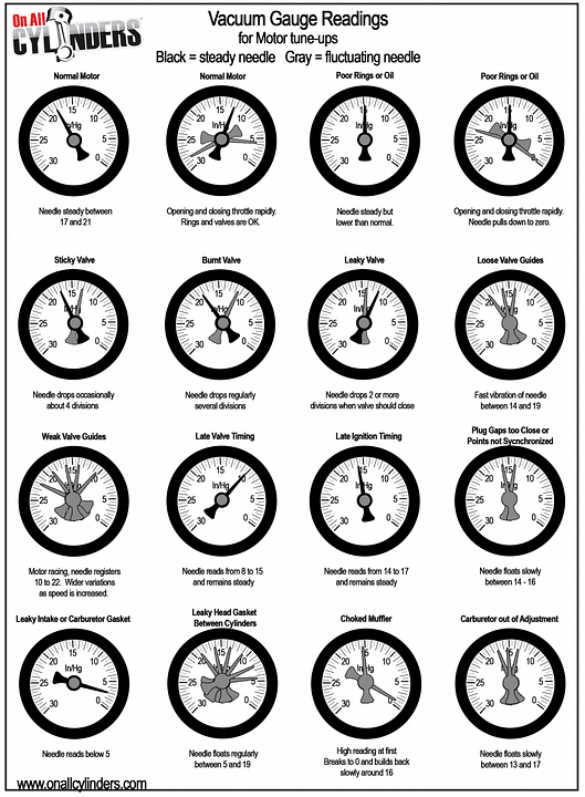

    If you have a vacuum gauge or access to one a vacuum gauge can tell you a lot about what is going on inside the engine. Here is one popular vacuum gauge reading chart that I have saved.
    It might be wise to check it with a vacuum gauge first and go from there.
