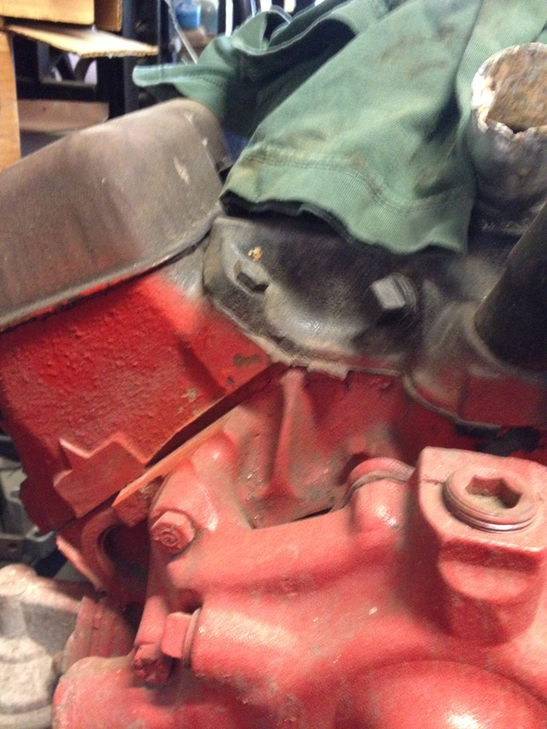

  3. Voh
    Joined: Oct 18, 2006
    Posts: 1,073
    Voh
    This rib?
  4. Well there's a lot that can happen in almost 50 years. But if your 283 has a 327 crank in it, it wouldn't be the first time somebody did that.
    Best thing is to measure the stroke like lone wolf laid out.
  5. All The 67 block,s I ever had did not have that rib as pictured its quite a bit smaller. that looks to be a 66 or earlier.
