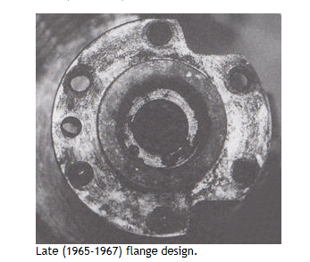

    Fwiw, a '67, 302 small journal Z-28 forged crank will have a round flange with a notch out of it.
    The 283 I finally got that was my Nephews has one in it! it started life out as a '66 283..
    My old junk301 had a completely round flange and it's crank was out of a '55, 265 P/U engine..
    I put it in a worn out early SJ 327 block to make my 301..

    I have a 1967 283/2brl that came out of a 40,000 mile original C-30 wrecker...block #3896944 date A277...heads#3884520 date A177...suffix code WA...and the rear of the crank looks like the OP's pic...double notch.
