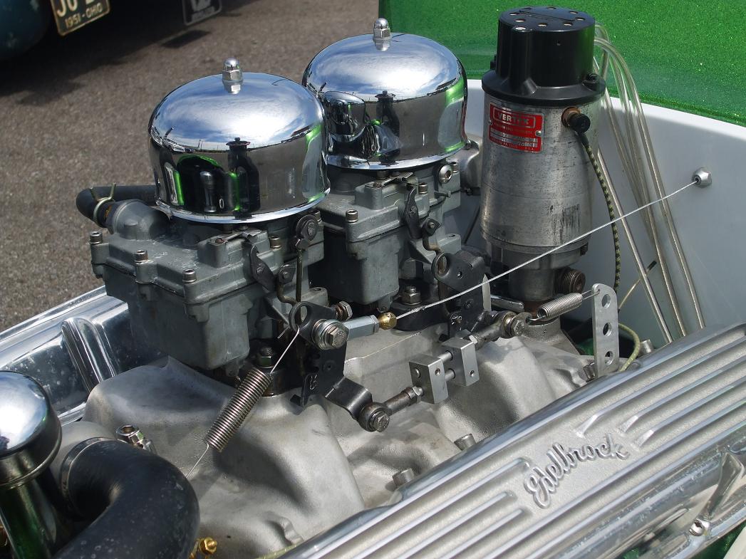

    I believe @FlynBrian used dual Edelbrock 500's on the 283 in the 34 roadster he built, he said it ran great, it sure sounded good. I just adapted dual 2GC Rochesters to a dual quad manifold for my 283 and it runs damn good. My seat of the pants dyno says it has plenty of air flow for the cubic inch.
    My setup was inspired by @SamIyam who ran a modified single quad manifold to accept dual 2Gc's, he had real good results with it, I think this is it:
    And at least 1 more Hamb member did much the same for the 283 in his Model A too, with great results. I think this is it here:
