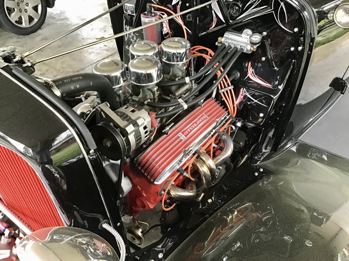

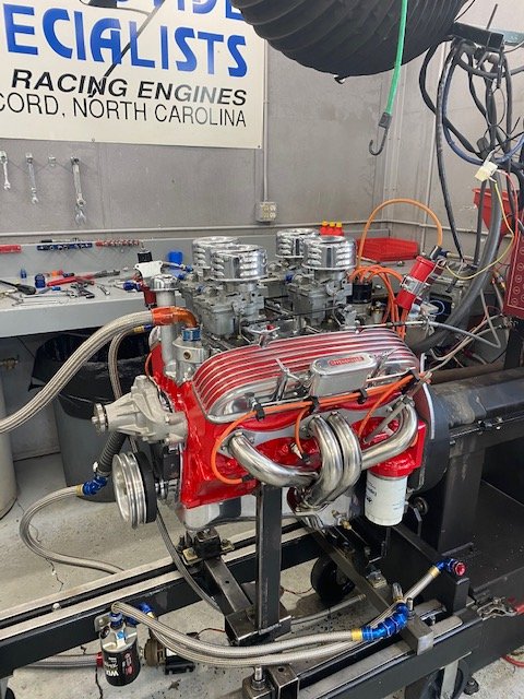

  24. Go with it.... I am running a 292 in (bored 283) with Small Thumper cam, Power Pack heads,
    four Ford 3 bolt carbs on a Weiand intake . runs regular gas. Makes 276 hp at 5600 RPM on
    dino. It runs great. Best sounding SBC that I have owned. I liked the Thumper well enough 683998CA-2F8E-4120-A525-8032CC3BDF32_1_201_a.jpeg to buy another for my 33 Willys Coupe with a bored 327 in SMC
