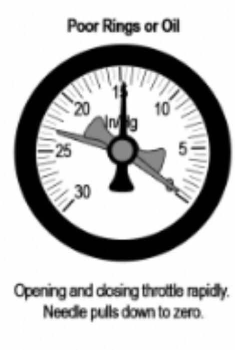

    Did the vacuum test and got this result (see pic) this was a new rebuild when I got it and it looks fresh and clean inside. I will do a compression test next. I am guessing that they might have lined up the ring gaps. The oil looks and feels ok but I have never changed the oil so I might put some good oil in it and see if that makes a difference but doubt it will
