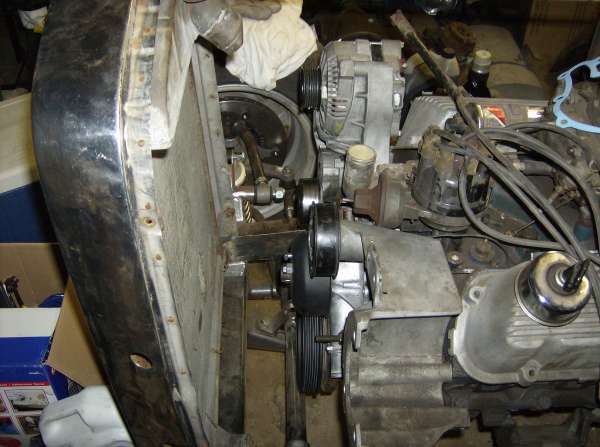

    Packing a 5.0 HO carbed in a A with air . A 94-95 serp system will shorten engine alot . Takes some mods of the A/c brkt but easy work . Just need a good alum welder .

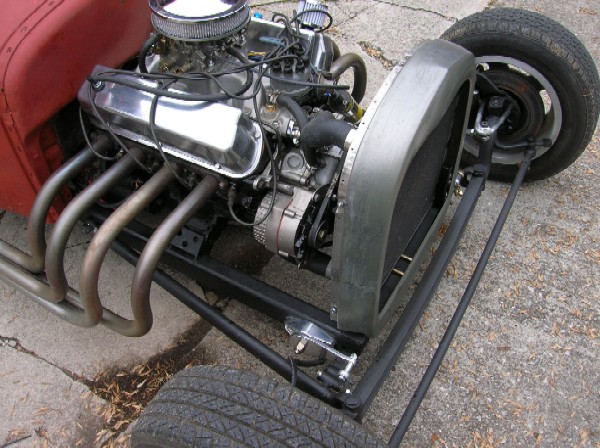

    I have a 302 roller motor and T5 in my T, '71 Windsor heads with Chevy valves and a little port work. A motorsports E303 cam and an old swap meet Edelbrock intake. Had some old finned Edelbrock valve covers but they won't clear the roller rockers so looks like I'm going to have to make some spacers. Has the early 260-289 front cover and water pump ***embly on it.
