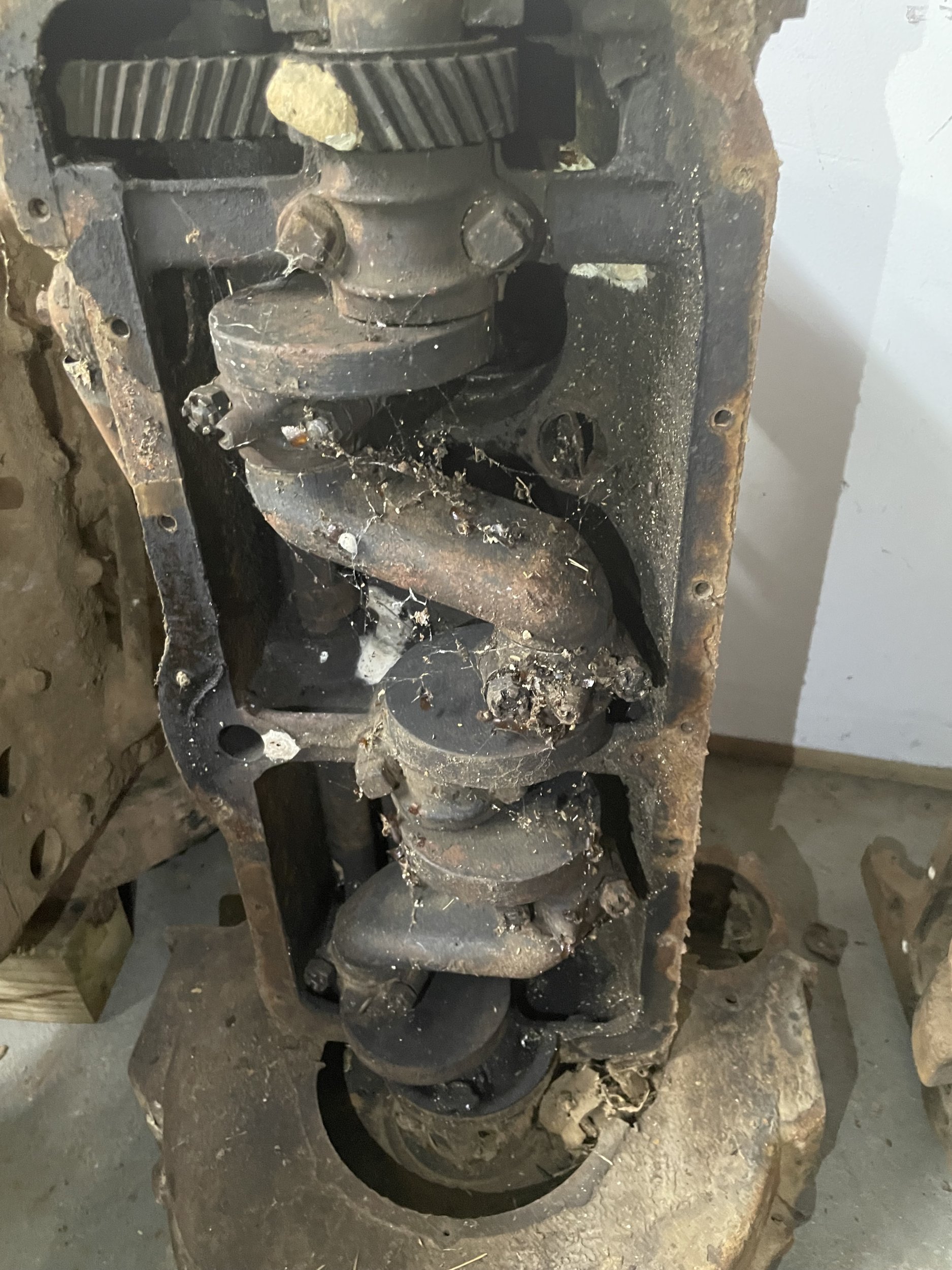

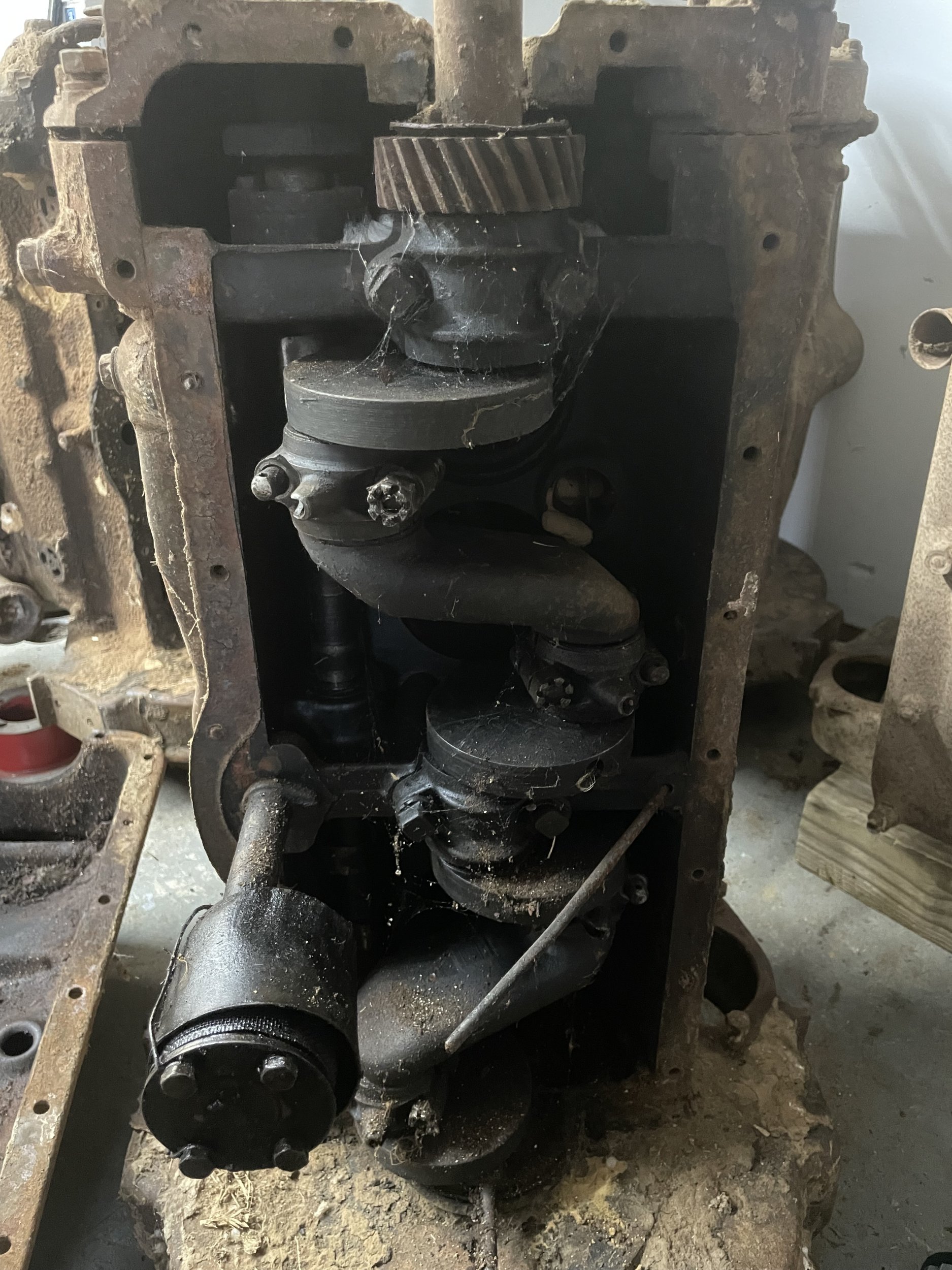

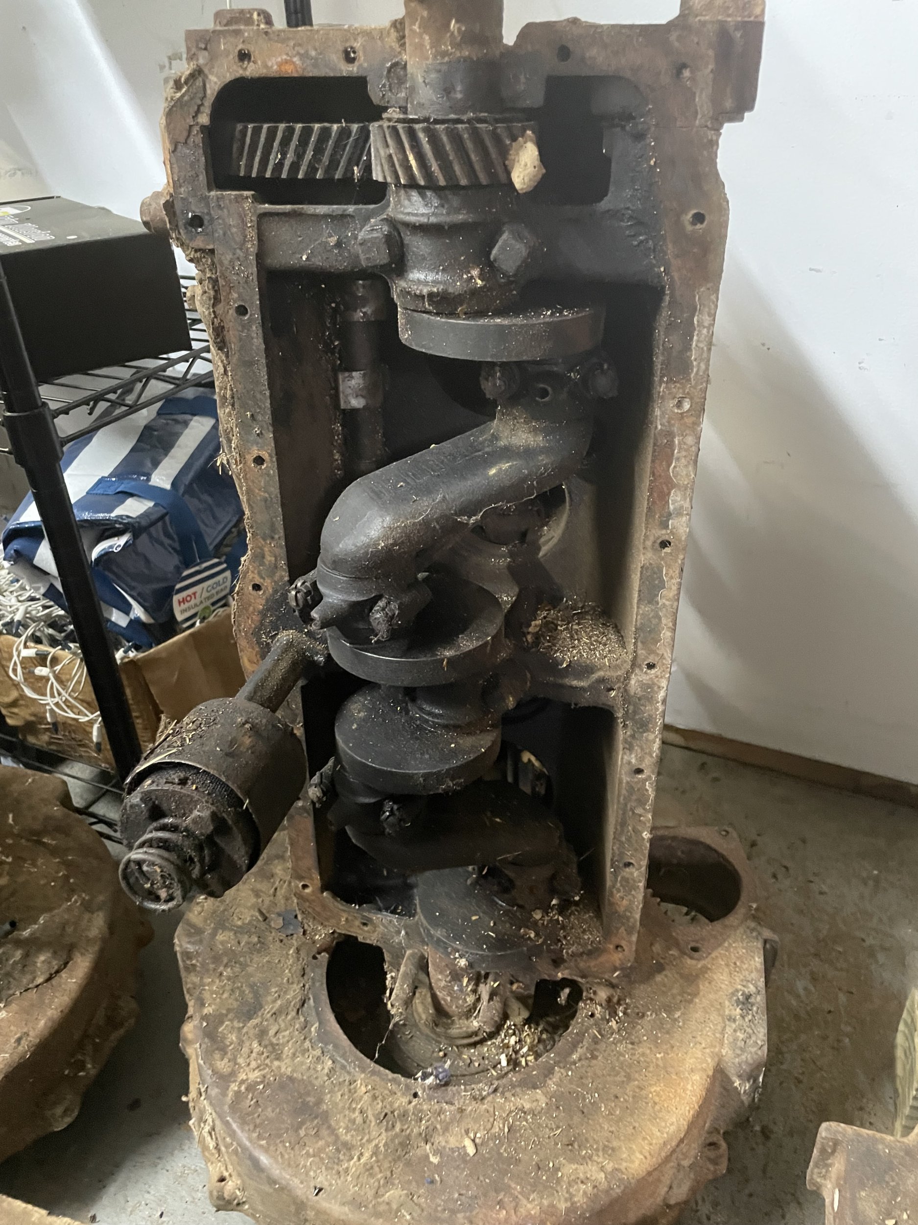

    I didn't get a picture of just the 289 but here are the 4 Model As. I rolled the dice hoping to get at least one good block and one good crank for my AA. Two of them were turning just as we were handling them to move them around and look pretty clean inside but the other two look pretty rough.

    Hard to tell without opening them up, but good news is that engines rarely wear out when sitting in a barn. Many banger cores have -.050” cranks and +.125” bores, but every now and then a standard engine shows up. Good luck!

    Did OK on the banger lottery.
    1 and 2 turn and look pretty good, but I haven't started pulling caps yet. 3 is missing a main cap but also looks OK.
