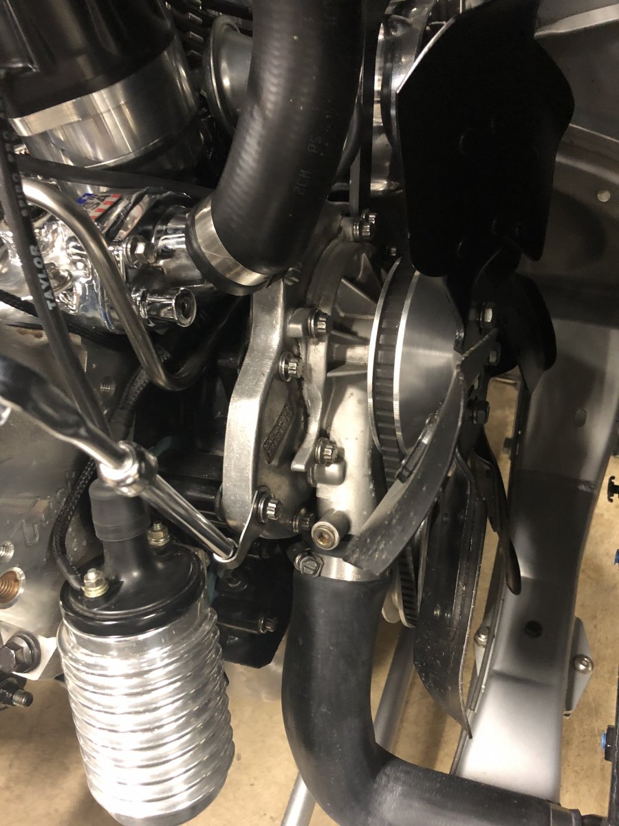

    BD8BFB05-4170-447A-BE7D-9BE35058AE4D.jpeg Snow White water pump or the shorty ford pump works good

    ^So you have a short waterpump and still had the cut into the firewall 3"?

    28A00EFF-EE90-4103-9954-2611E9F7C096.jpeg Terry, I have the Snow White pump kit with a 3” cut firewall ,mechanical fan and a front sump oil pan . Fan bolts are 3 1/4” from the radiator. With the bronco oil pan it might fit but it would be tight without the fan . ​

    So how far is the fan from the rad? I see you have an aftermarket front crossmember, did you push the rad forward?

    Stock radiator location, fan is an after market from Summit and it’s 2 5/8” from the radiator. Motors runs cool with a 180 thermostat and Walker radiator.No complaints whatsoever with it . No spacer
