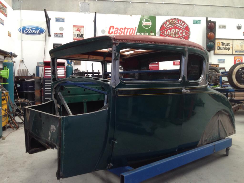

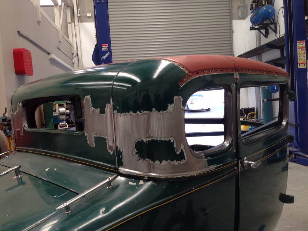

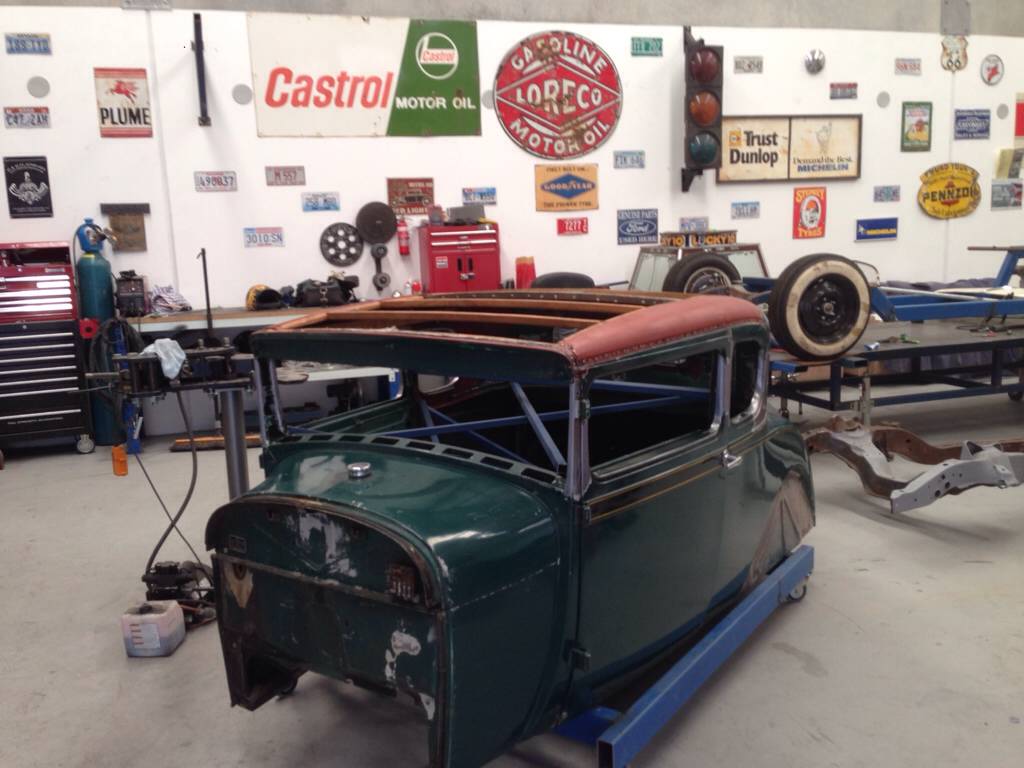

    End of today as I must venture out into the world for tonight, but aside from afew little imperfections in weld ill fill n sand back, the A and B pillars are pretty much done inside and out, doors done and a little more around the coupe window, then it's sailplane time!

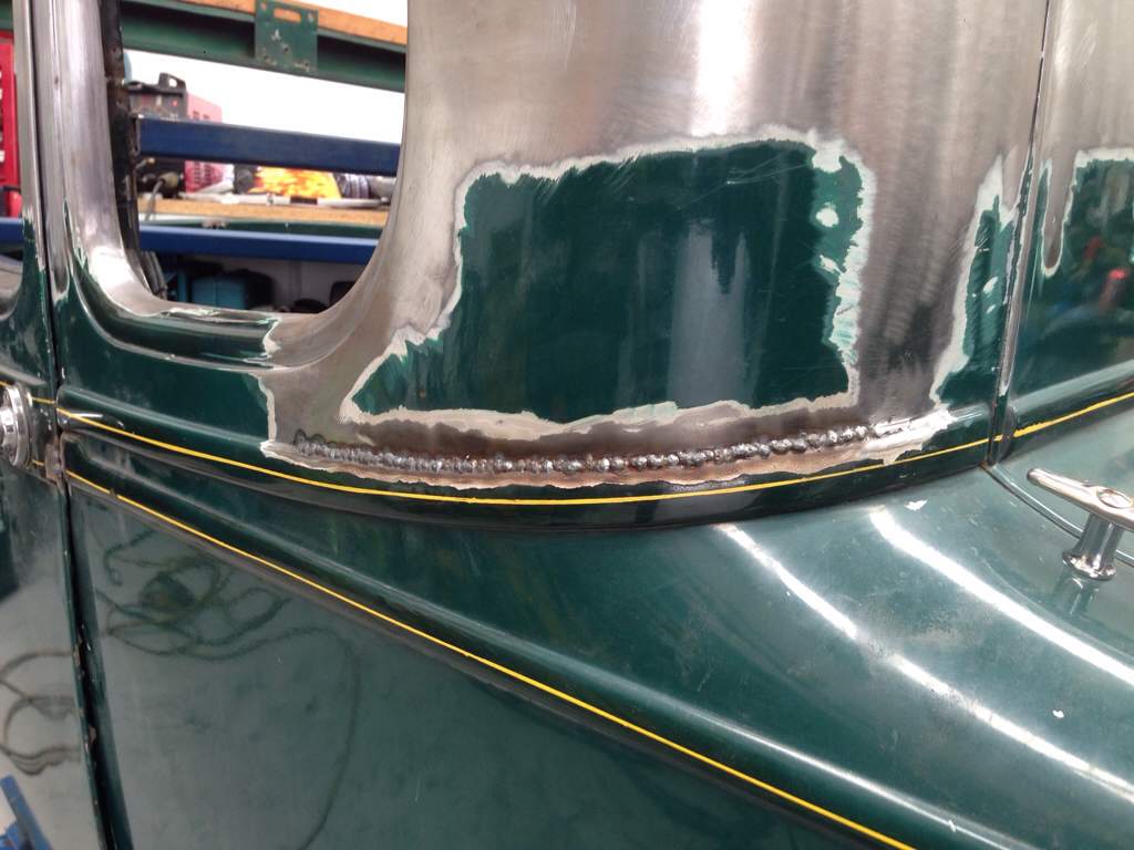

    Thanks for the concern fellas but it was only afew tacks, I'm an aluminum fabricator by trade, and we Mig our Ali, so it's even hotter than steel, I'm well aware of the dangers. What you didn't see in the picture was the copious amounts of sunscreen I put on before I start.

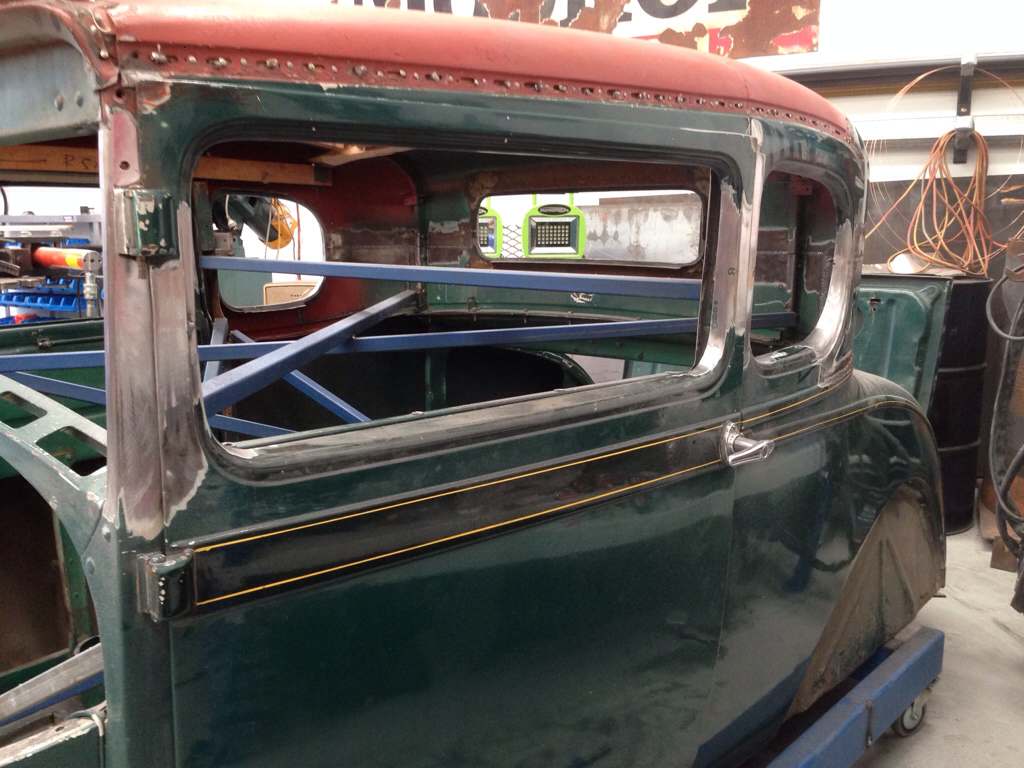

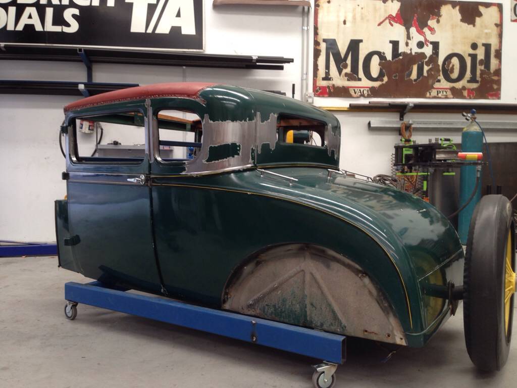

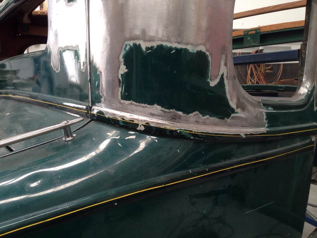

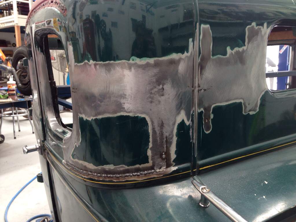

    On a brighter note I'm finished with the A and B pillars, doors and little coupe windows, and have been on the left hand side sailplane for the last few hours. Never in my life had I had to use a dolly and hammer for more than 10 minutes, let alone hand file a surface... But I'm learning quickly and am pretty happy with the way it's coming out! Still chasing perfection :) ImageUploadedByH.A.M.B.1420099475.518948.jpg
    Before I started;
    2hours in;
  8. Deadbeat63

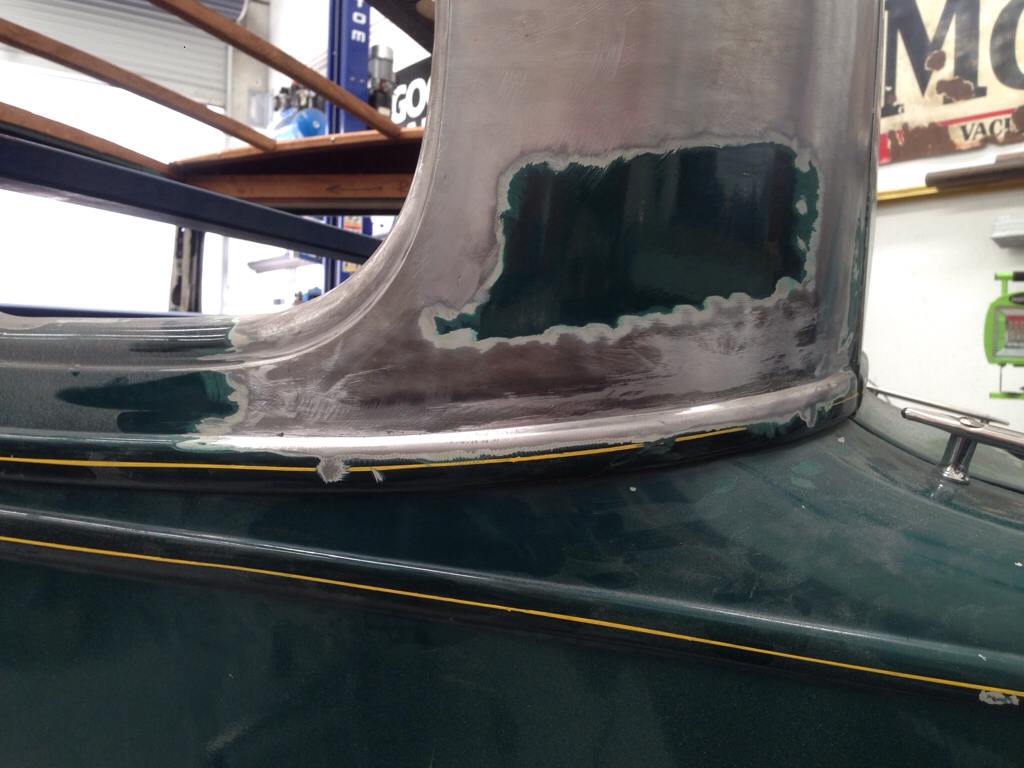

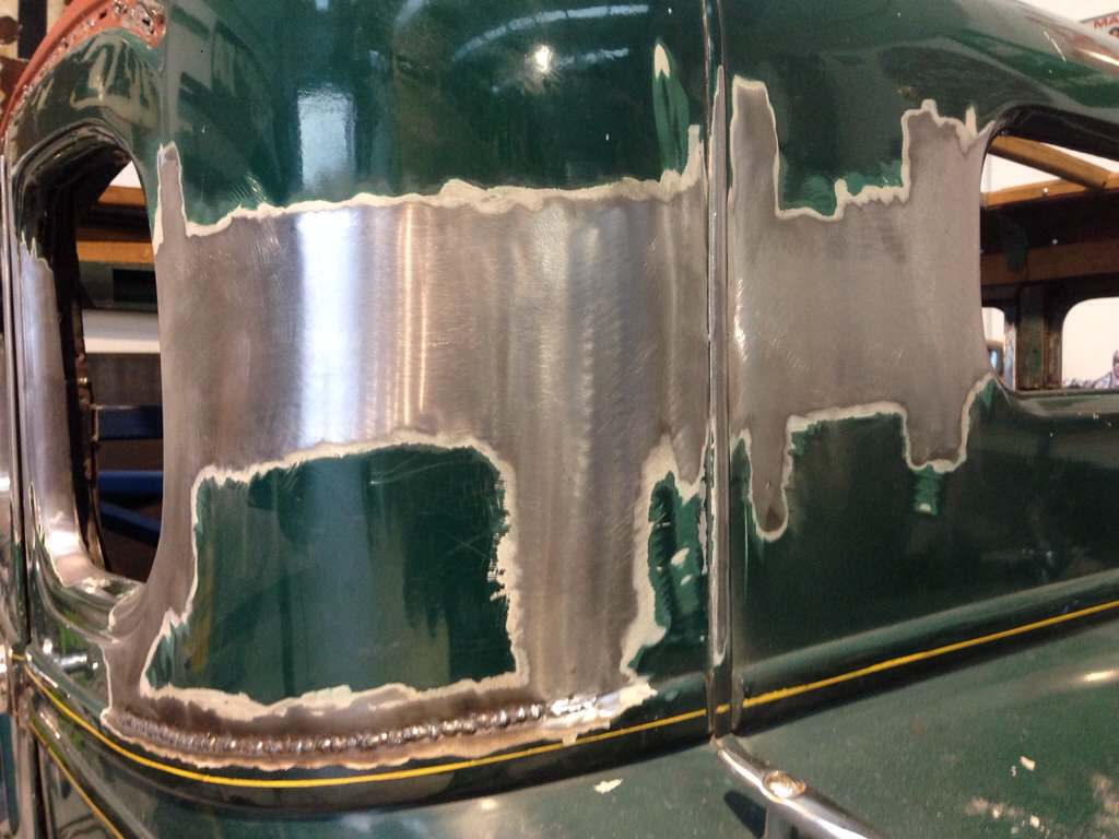

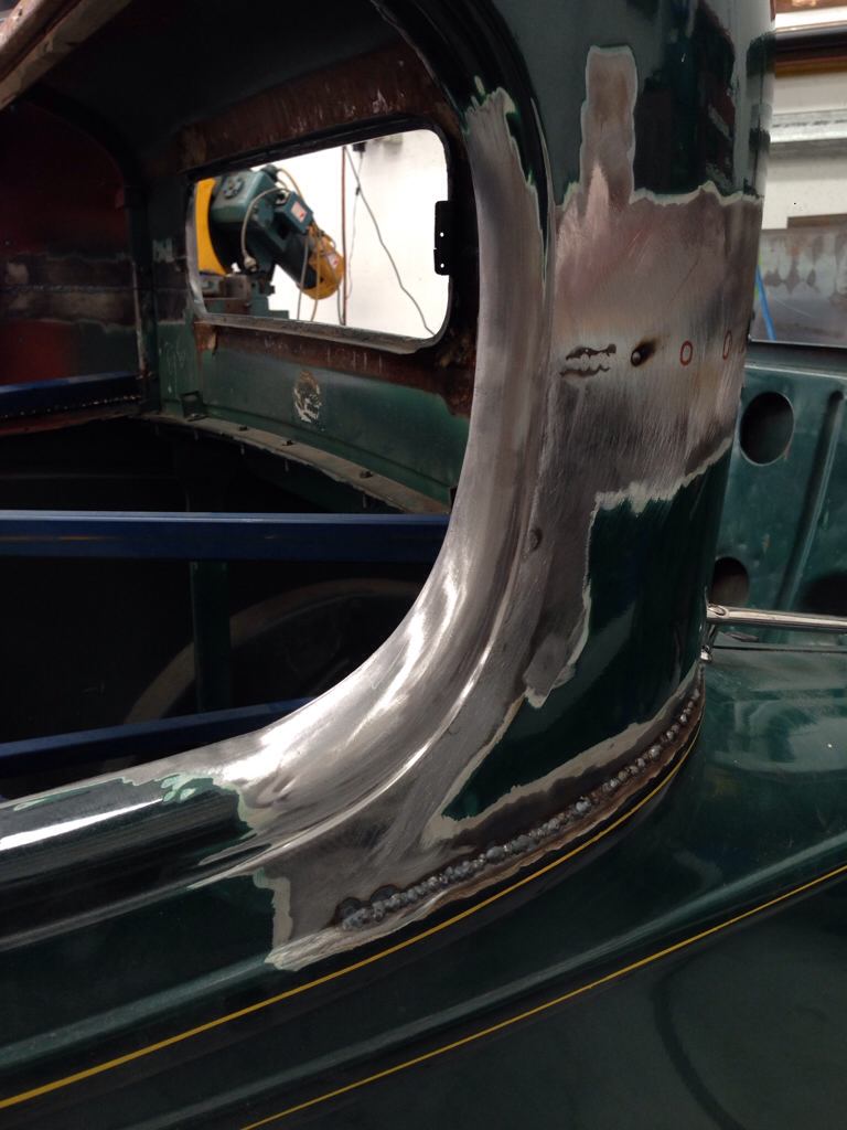

    Well after a little error, abit more welding, then more n more metal finishing, I have one sailplane that's almost done! The bottom weld needs to be removed, but the rest is 95% Hollywood...

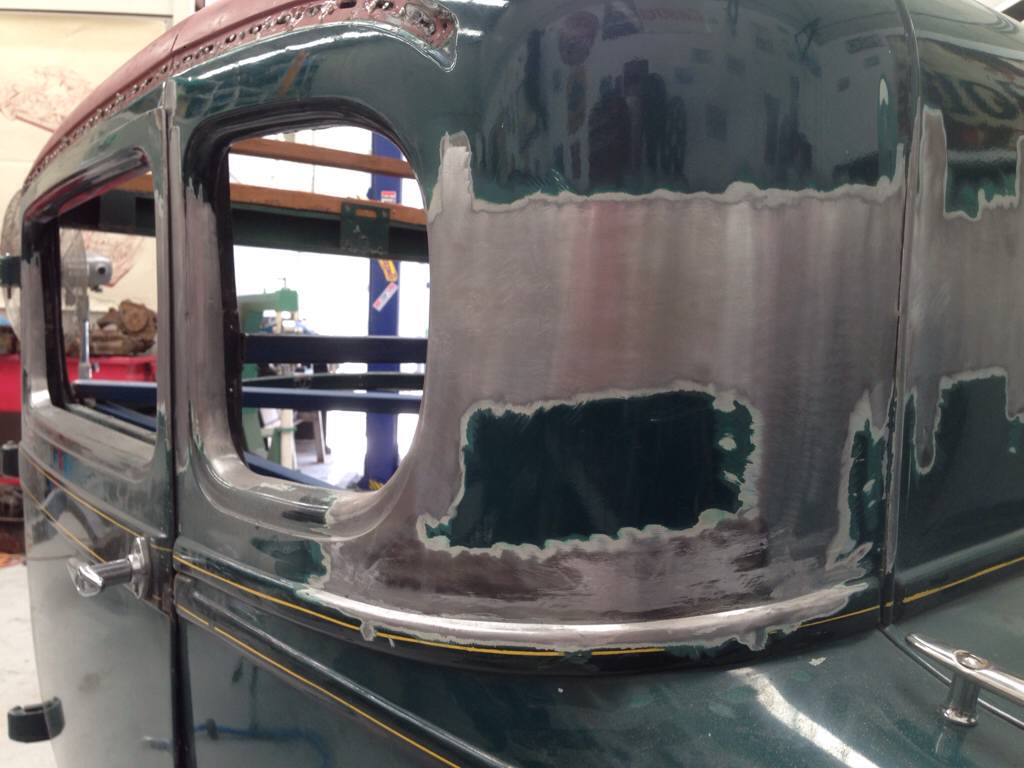

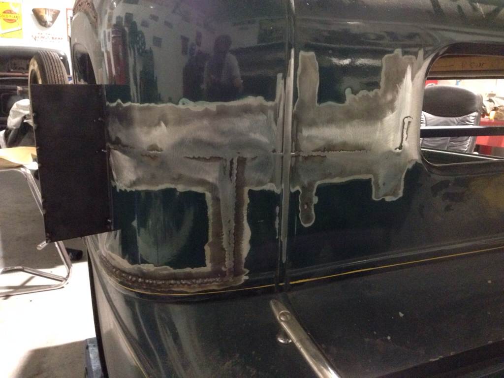

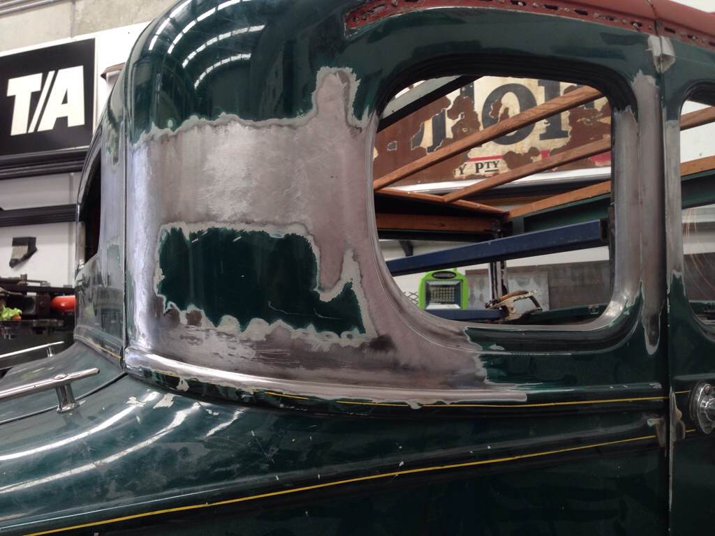

    At the days end, but got the other sailplane to the same point, so Saturday will involve cleaning up the bottom weld of both sailplanes, and then slap some clear on it ImageUploadedByH.A.M.B.1420121241.580493.jpg

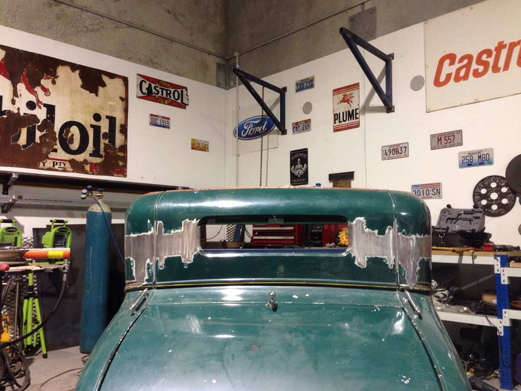

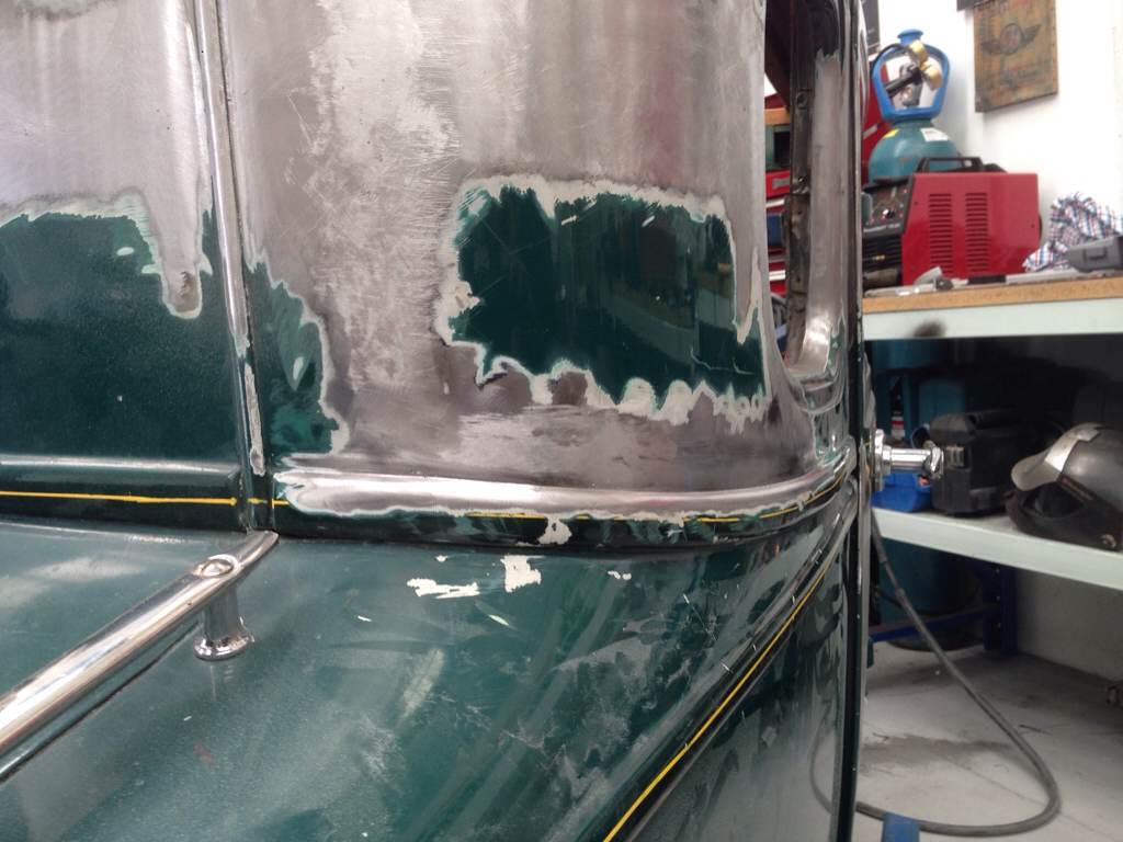

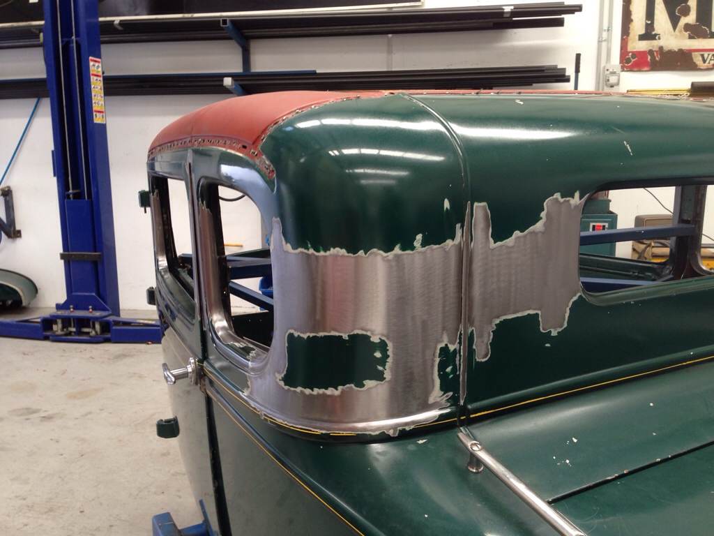

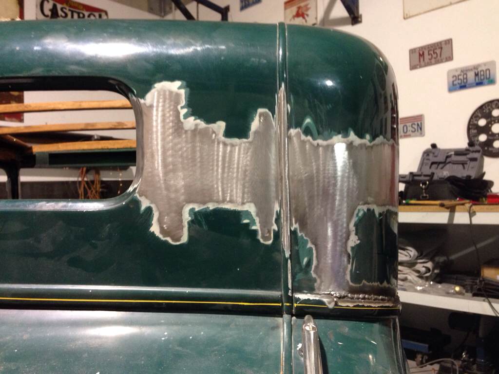

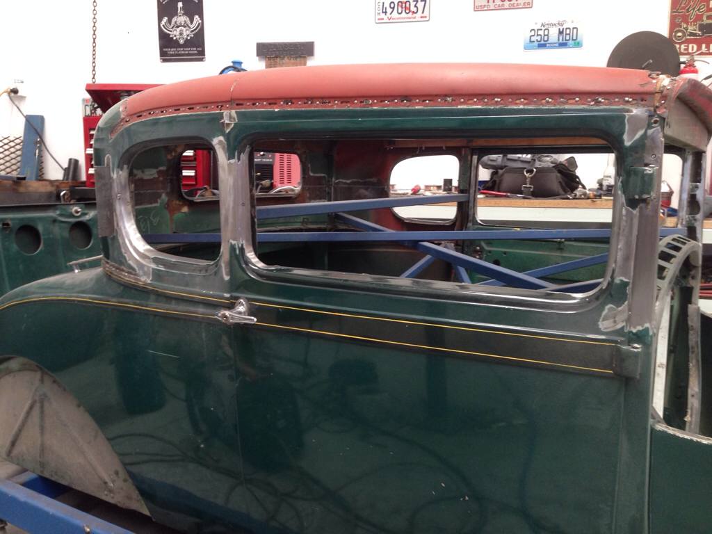

    Well today is the 2nd last day of my holidays, so I had aimed for this as D day.
    All the was left to do was clean up the welds around the base of the sailplane and body swage line. After a tiny bit if sanding, 1mm cutter to give me the hard point and then a whole lot of hammer, dolly and filing, they played the game.
    After this I gave the rest a light file in any high spots, then got afew coats of clear on it and she's pretty much done!
    Pretty much as in I've still got to do the 3 rear interior window moulds, the A pillar covers and also clean up the weld on the inside of the A pillars in the door jam, but aside from that stick a fork in it!
    Well it's been a hell of a time the last 14 days (10 spent working on this...). To say I'm nearly, but not even, 27 and chopped a Model A is pretty freaking awesome. Not only that, to challenge yourself to a bare metal chop, on your first chop is something even better...
    Enough talk here's some photos...
    How it looked at the start of the day..
    Getting through them, redoing the body line...
    And then all done! With a very happy me!
