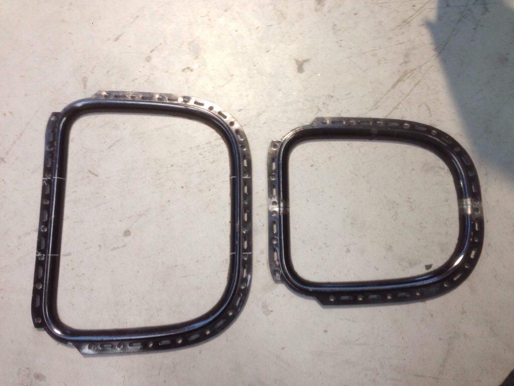

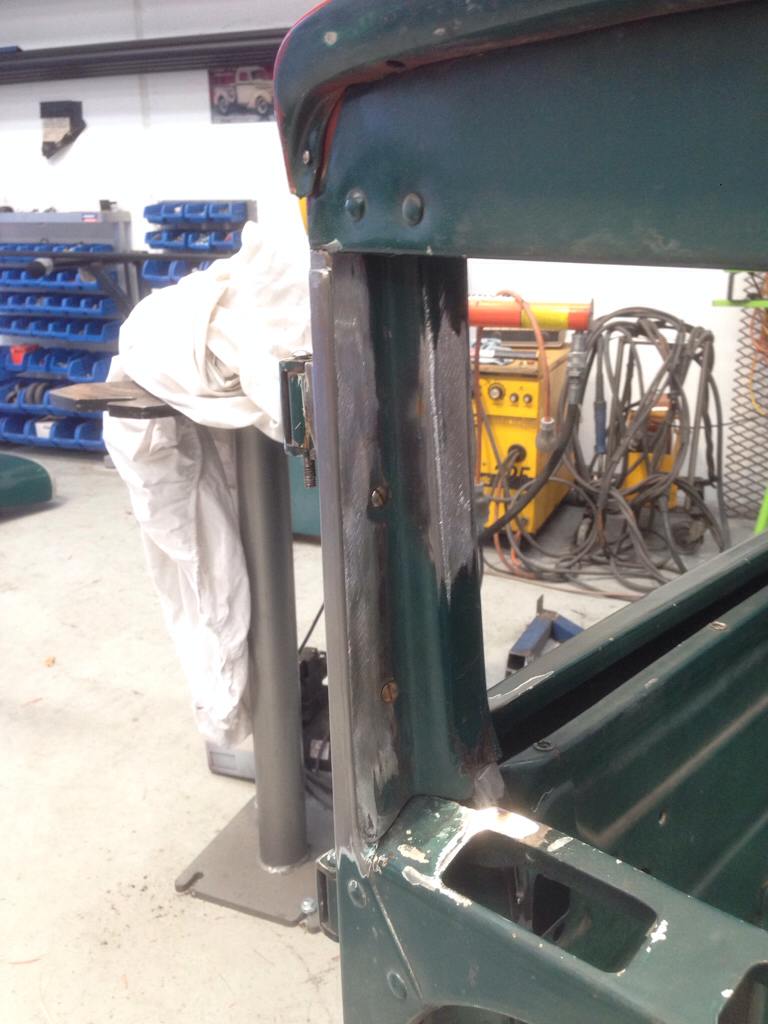

    Got the A pillar covers shaved, as I'm not running the pop out window, then shaped a little and finally mounted. Also got all the interior window garnish trims chopped down and welded up.
    Then finished the arvo off by doing a major mod, bolting the sun visor back on... A crucial part! Anyway here's photos!

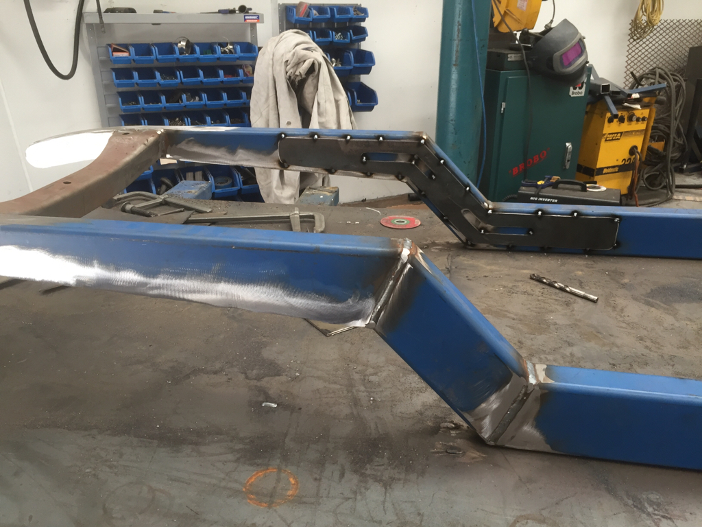

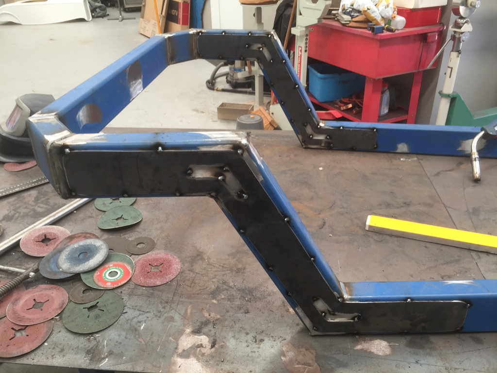

    Well today, after leaving it for more than 10 months I decided enough is enough, the little fairies who were supposed to build the car for me were taking too long, and it was time to take matters into my own hands!
    So I welded up my frame today, and started working on the fish plates, as I've taken a new direction and will be registering the rod here in Western Australia. Ended up putting 3mm down each side of my 13" rear kick and 4mm on the inside of my front 6" kick.
    As far as I'm aware, it'll be the first 13" rear kick going up for plates, so I decided to add more area in the plates than required. Also cut some 16mm slots to plug them into the side of the rails.
    Also as it's the first time working on this in a long time, I got a little picture happy.

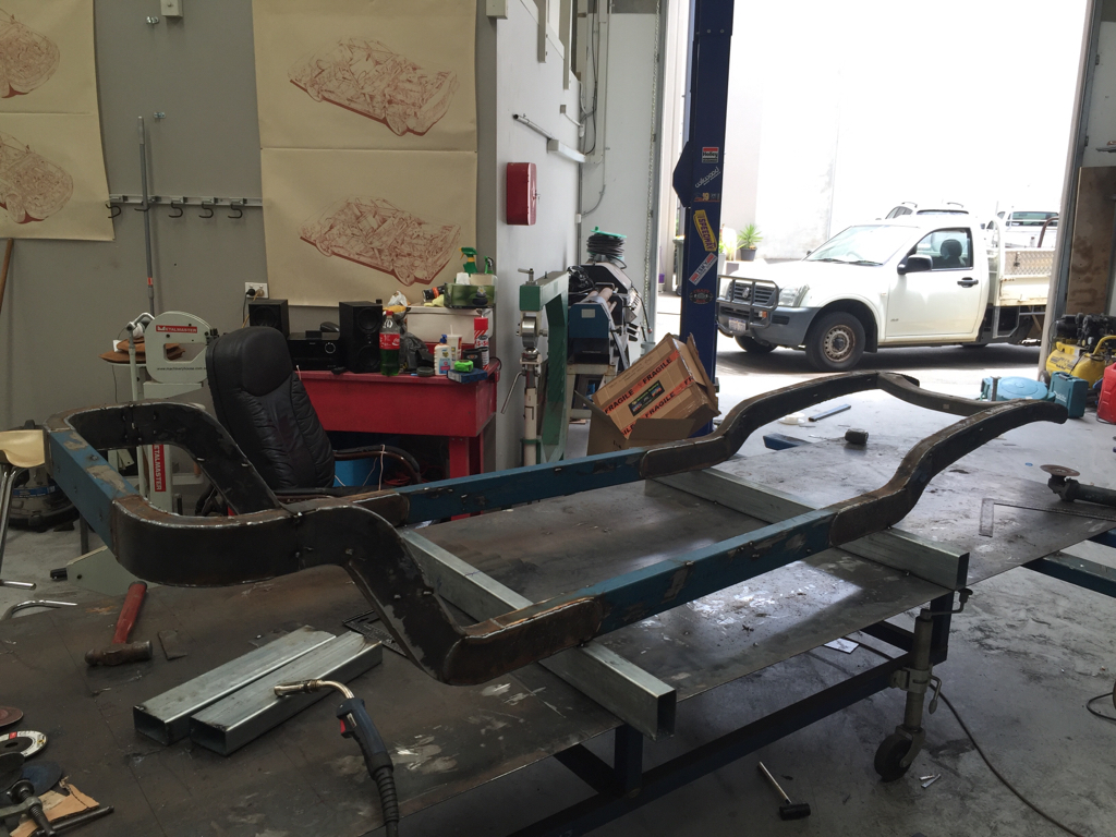

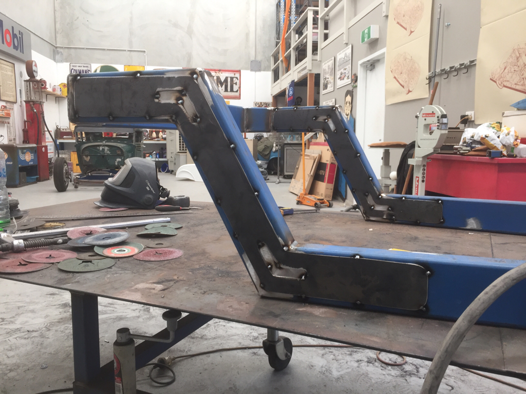

    So as I'm taking a new path with this build, I decided to s**** the ch***is, take it back to a standard wheelbase, as I don't need the extra 5" for barwork around the motor. And also to get a little curvy with it :)
    So I've been busy cutting new plates, fabricating it all, and tonight finally welded it all together. Next will be to mount the motor and gearbox Friday!!

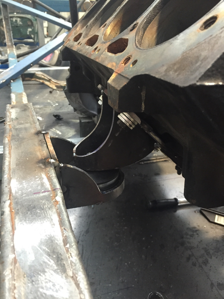

    So I ended up with the $$$ making the decision on a motor, got my hands on a 454 BBC. A very lucky short block, from the 1 year they made them with a full forged bottom end from factory, at standard bore! And then picked up a tough TH400 to whack behind it. Then came the mounting...
    So I got the motor mounts finished up today, aswell as the ****** mount, had no idea on how to make a ****** member to tie in with my rails.
    But after leaving there at midnight, no sleep from laying there all night thinking,l about it, to returning back to my shed 6hrs after leaving, the ideas started to happen.
    So here's my ****** mount, pretty happy with how it came out. Same with the motor mounts, seeing as this is the first time I've done something so major!
    Oh and just to clarify the washer tacked in the motor mount was till I got a bush, so it's gone now! And the cuts in the ****** mount are plug welds, connecting a gusset on the inside to stiffen the mount...

    Well after a whole lot of squeezing, measuring and measuring again, ive reset my motor at the correct angle now. Silly mistake on my behalf not understanding directions haha.
    So now the motor is set, ended up using the flathead style engine mounts with an under slung bracket. Wasn't sure if the inspectors would enjoy that so I put them on a fish plate for extra strength. The ****** mount is also reset,l in, but I'm unsure if it'll remain there, or atleast become removable...
    I have also started mounting my front end. Both 4 bars are mounted, just need to tweak the forward half of the bottom ch***is mount, so it flows abit better back onto the ch***is. I can't wait till the 1st inspection is done, they've ok'd my welds and I can sand them all pretty!!!
