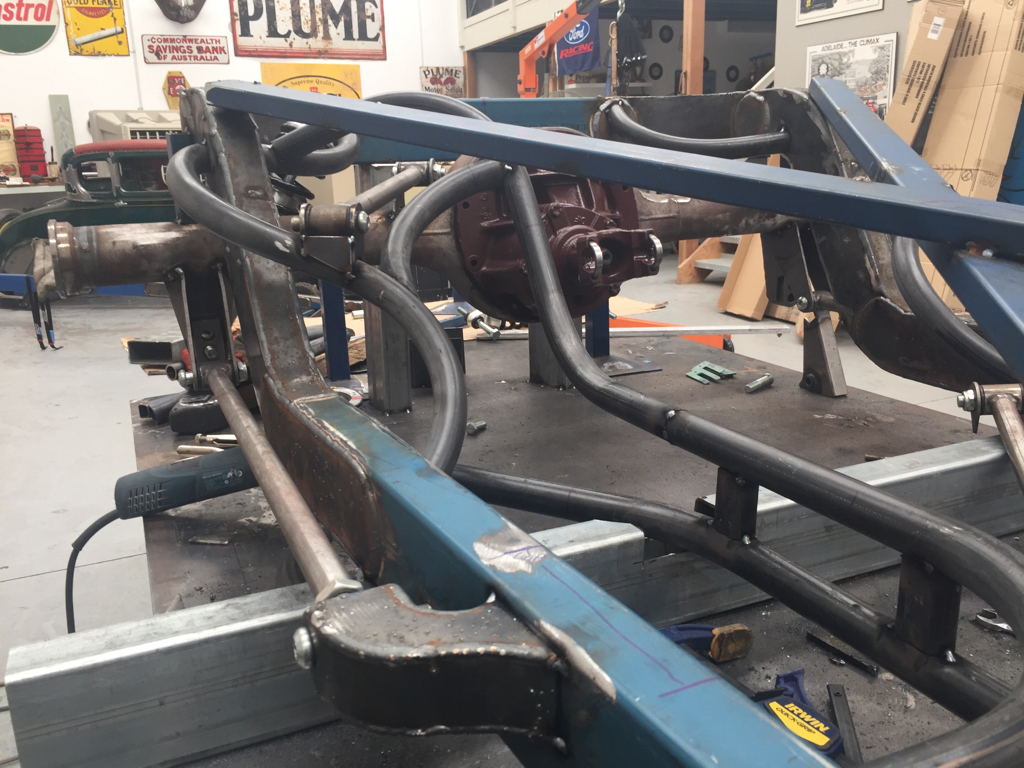

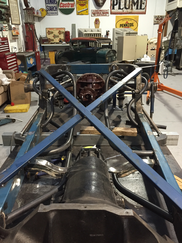

    Not a bad view at 3:20am... Sitting here trying to get funky with the K member, picking up the top trailing arm and the coilover, and still tying the top of my kicks together to try an satisfy the authorities...

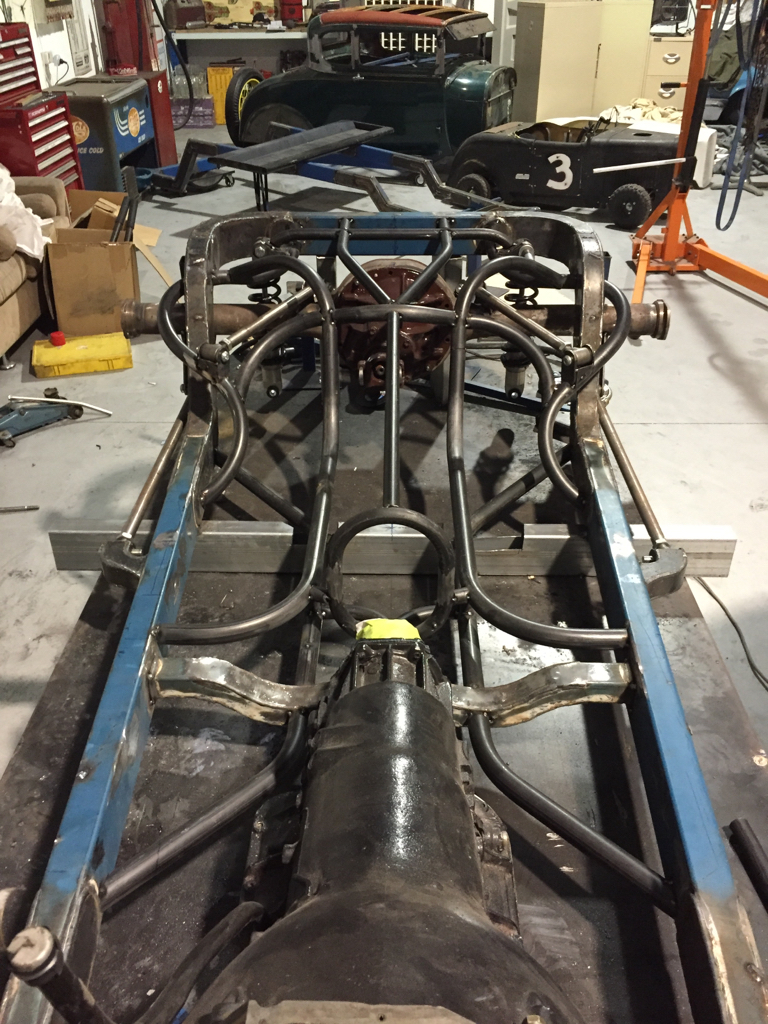

    After a little bit of messing around with my pipe bender Saturday morning, I ended up with half a K member that I'm kinda liking... I needed to pick up my top trailing arm and coilover, so I think I've achieved the most weird and wonderful way too! Ha ha
    I should also explain I do a fair bit of pipe work at my daily job, so when I get free reign I like to make things that confuse the eyes haha. Also don't mind the X brace still there, that'll be removed shortly...

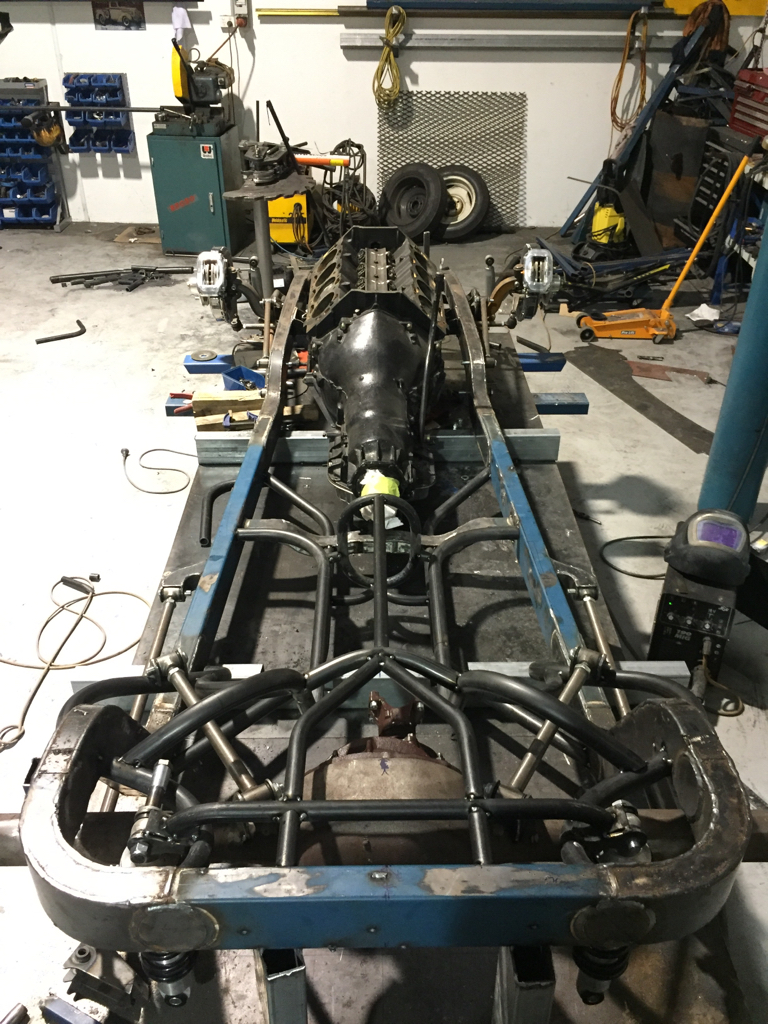

    Bit more progress on what I'm calling my 'K'onfusion member haha. I got the drivers side top trailing arm mounted, another piece to brace that mount, which will flow over the diff to the others side, and also started the replication process on the p***enger side... Starting to really like the look of it but also doubting my chances of registration... I cannot wait to have to whole K'onfusion member done to take those ****ing braces off! But paranoia won't let me just yet [emoji23]
    I'm also incredibly happy with the service I got at Unisteer. They are going to custom make me a RHD center steer unit at no additional cost! So once the rears done, that's been made m, shipped and mounted it'll come off the bench and I'll finally get to put the body on. I'm hoping for that just over a month and abit away!

    More progress, top coilover mounts are done, all trailing arms are mounted and in, I'm working on the K'onfusion frame at the moment haha

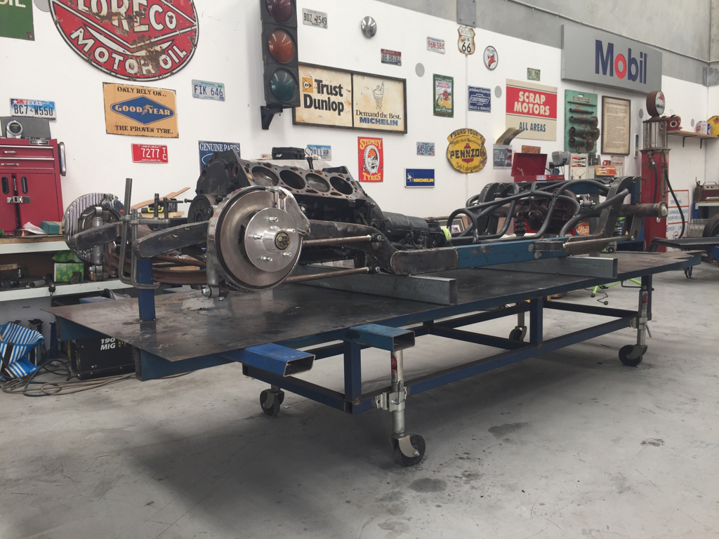

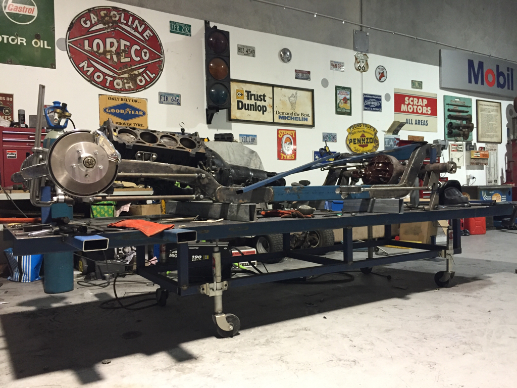

    The further I get into this build the further I realize it's not really HAMB material, but none the less...
    The L frame is now completely fabbed up tailshaft loop in, all suspension points are done. Now I'm just waiting an oil pan so I can put bars underneath the oil pan and also receive and mount the RHD Unisteer Center steer R&P, which is probably a month or so away, then the ch***is will be complete!
    Onto the body tomorrow, and getting it ready to put on the ch***is!!
