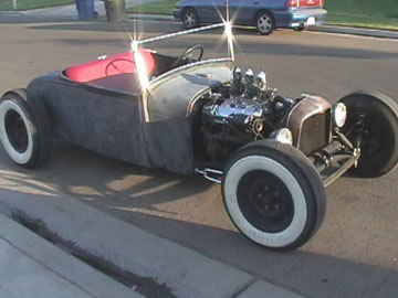

    here's a 29 i did...

    Very nice how did you take care of the door tops and windshield
  7. tobyjuarez
    Joined: Jul 10, 2005
    Posts: 298
    tobyjuarez
    I took the top off of a coupe door, cut the inner door out, and thinned it out. also had to shorten the door length.
    the windshield is from a 31,,,I took a section, about an inch,,out of it as well.
