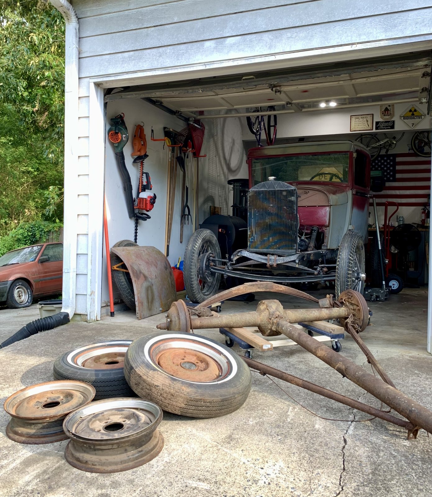

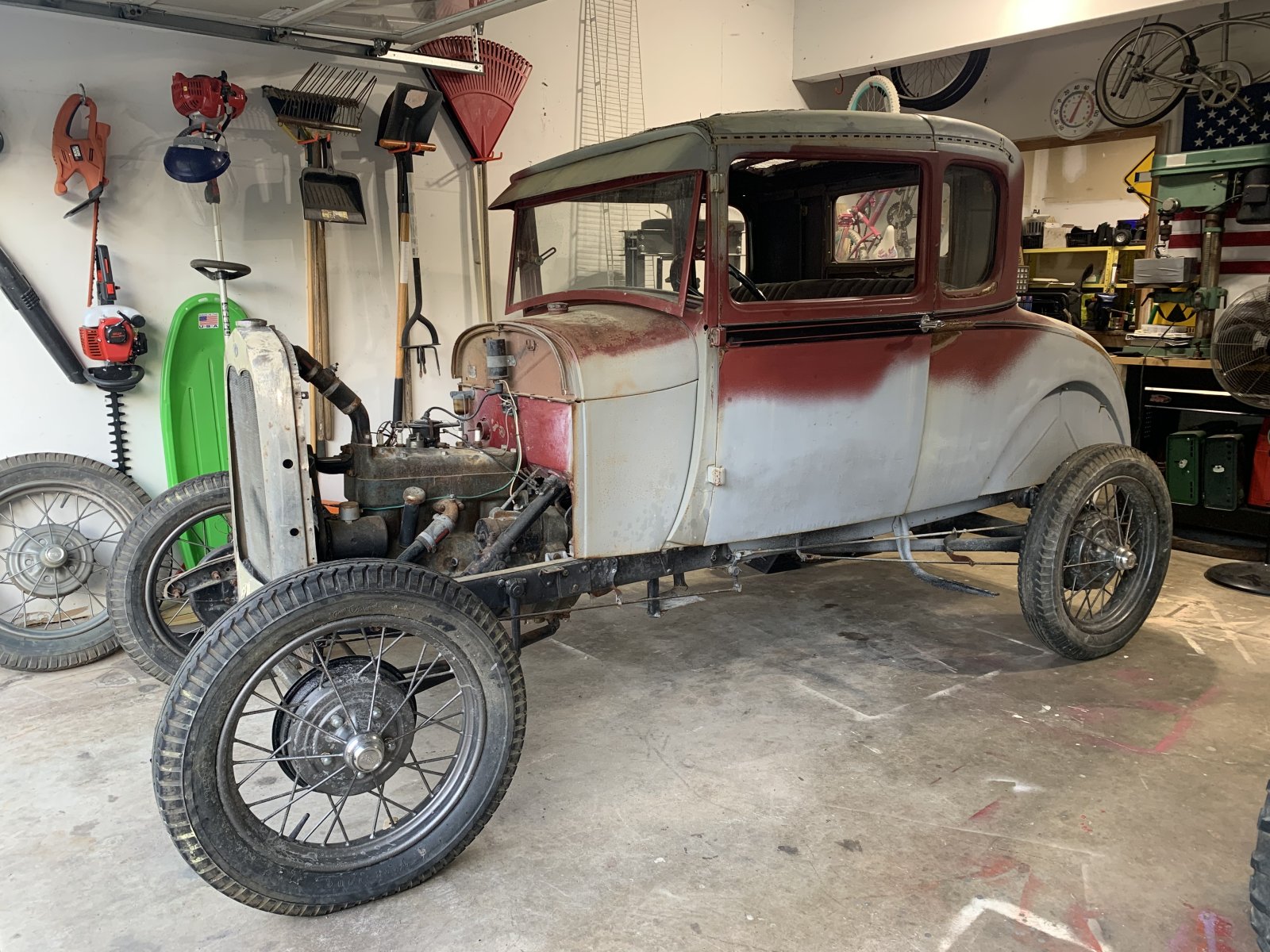

    Here’s the day I brought it home, 1 year ago.

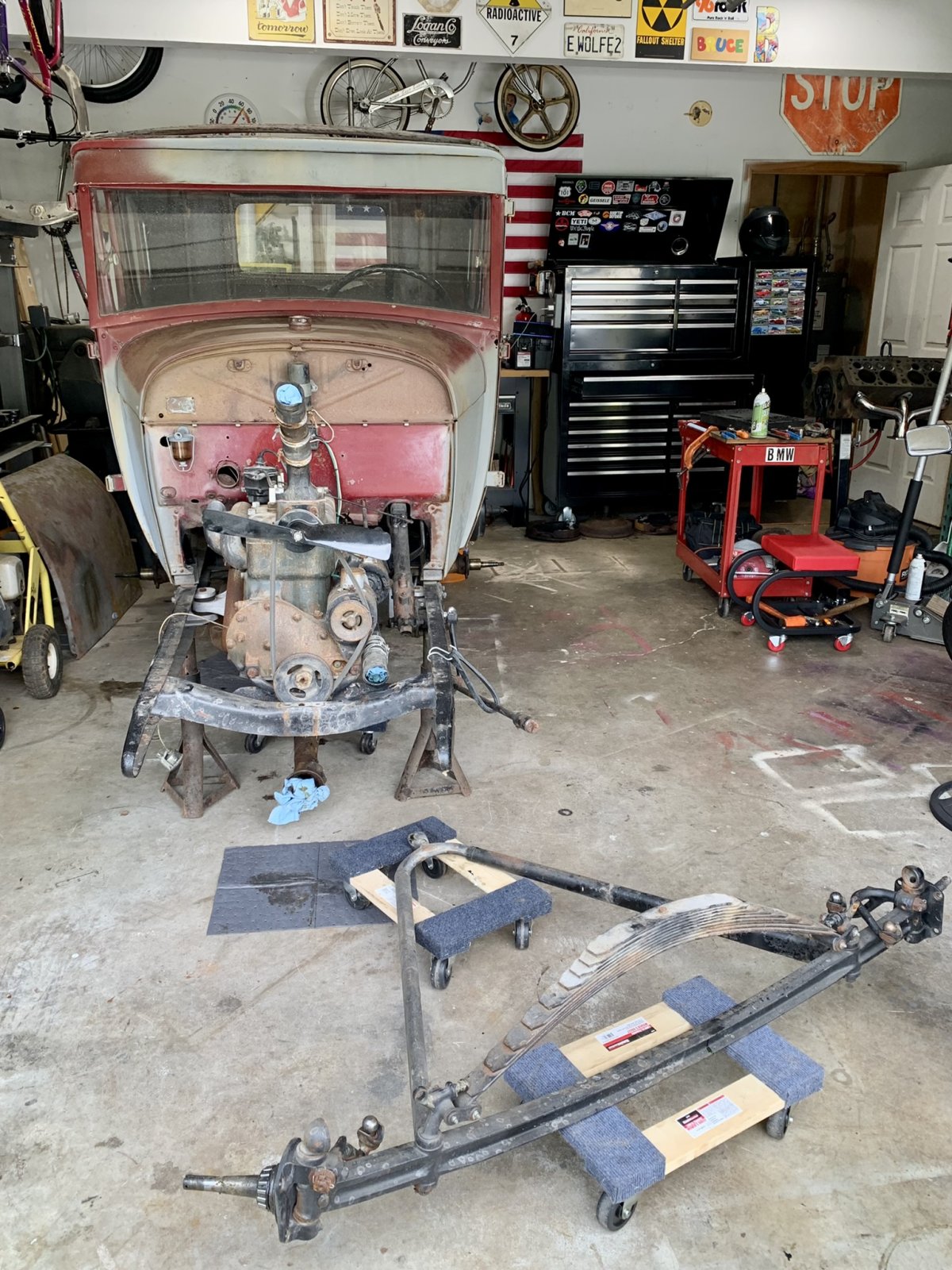

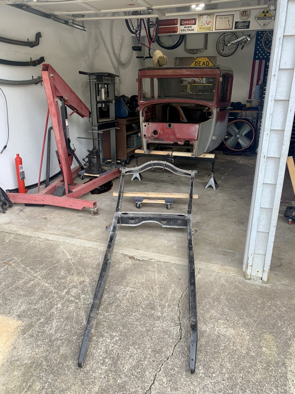

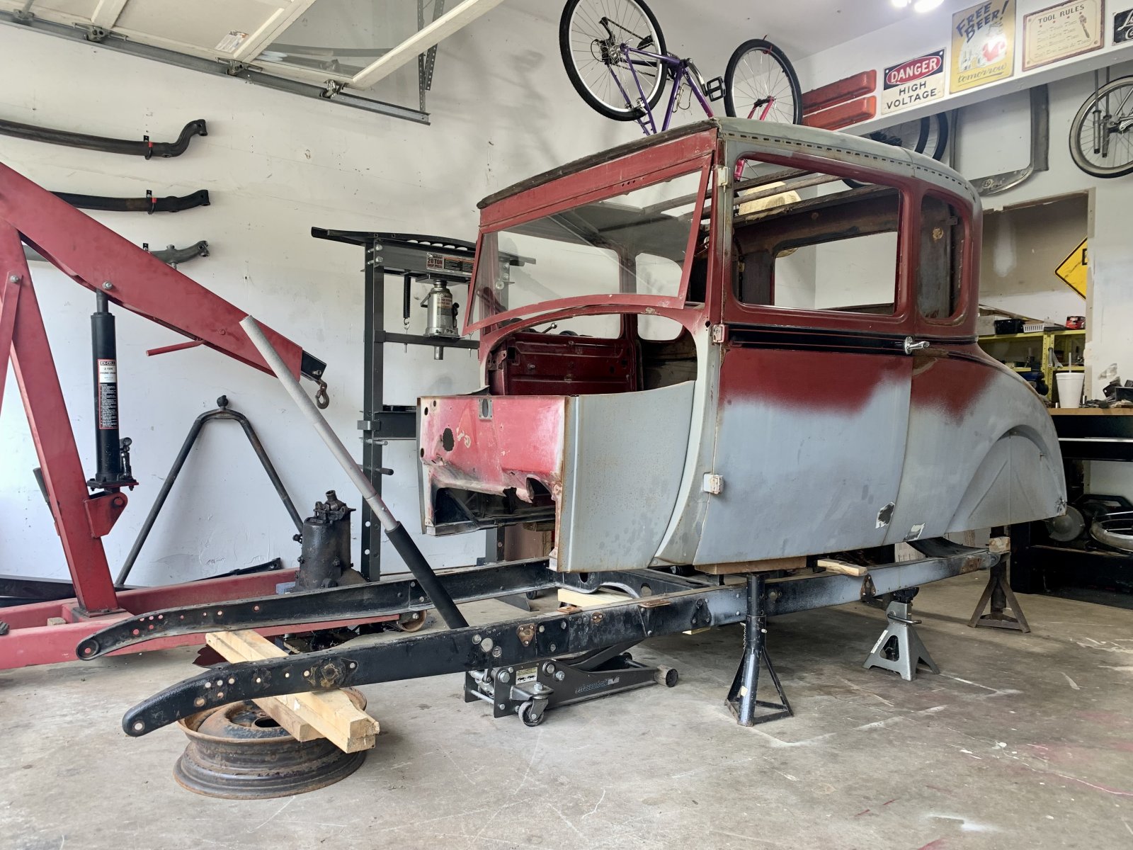

    Front end out.
    Rear end out.

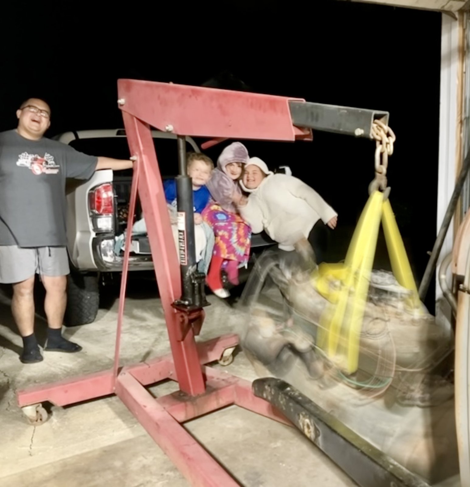

    Removal of the banger, ft. Daughter, Niece & Nephew.

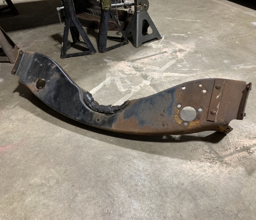

    Once the forward motor mount was free I discovered that the previous owners plug welds used to keep the front crossmember in place, broke. This worked to my advantage because my tired cherry-picker cylinder doesn’t go much higher and I was able to roll the engine out from between the frame rails.

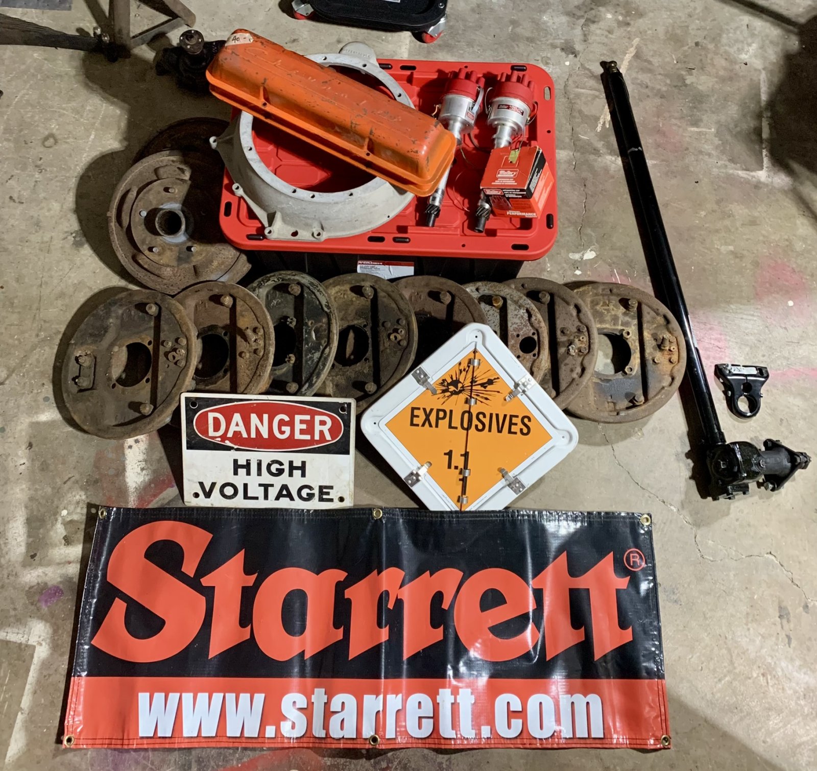

    A few picks- a collection of eBay, local, HAMB, and FB Marketplace finds.
    15x6
    The proposed mill. A 283ci with power pack heads. I traded a Wilton Bullet vise for it. Topped with Offy 3x2 w/ Rochester 2 jets, and Cal Custom valve covers.

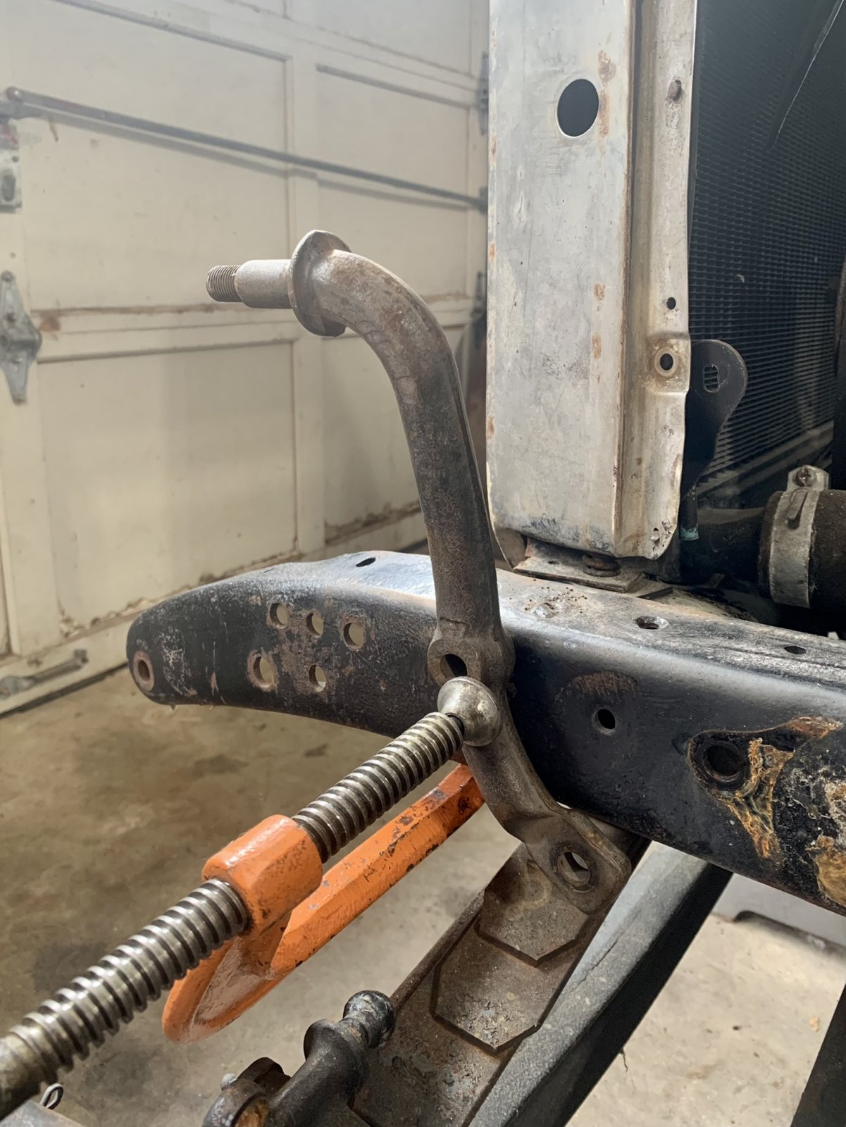

    “two is one, and one is none” F1 steering gear
    I pulled this previously hot rodded A frame out of my friends dads backyard. “Free -Just get it out of here…”

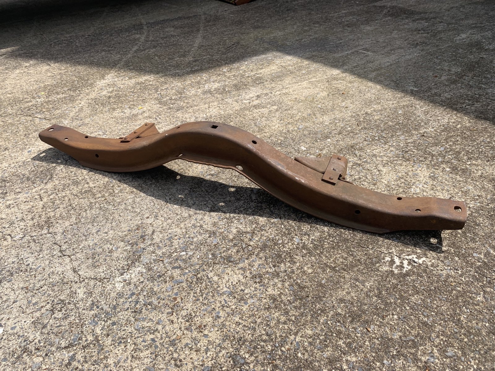

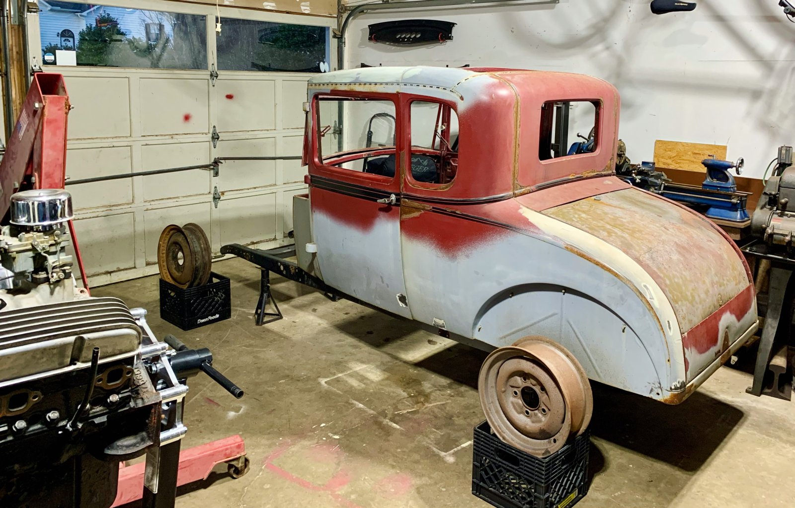

    A silly mock up, 106” wheel base.
    The plan is for a “suicide” front end, bobbed frame horns and front axle forward -yet tucked close to the grill shell.

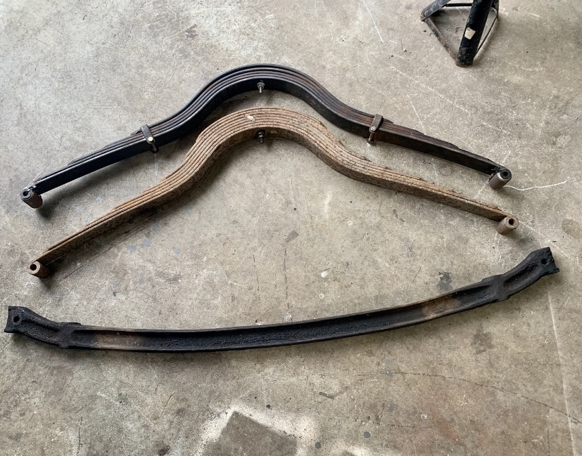

    26-27 T stuff for the rear.

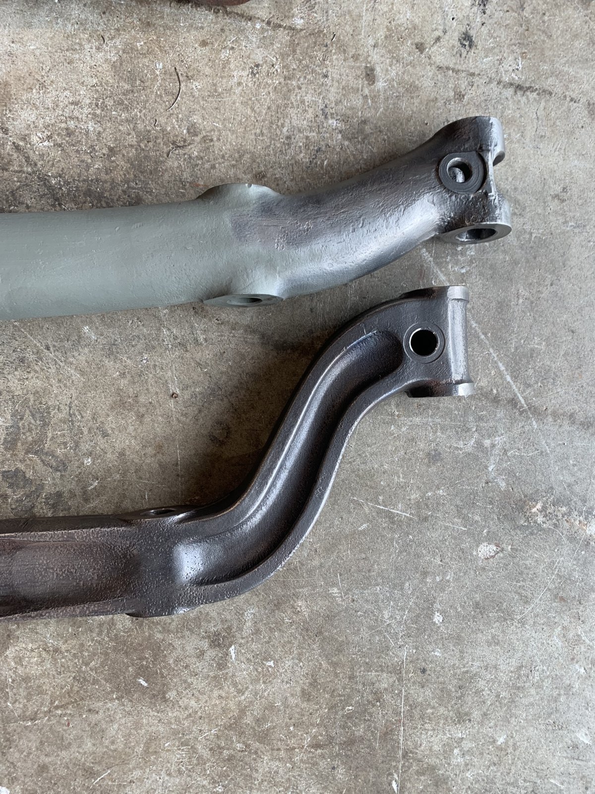

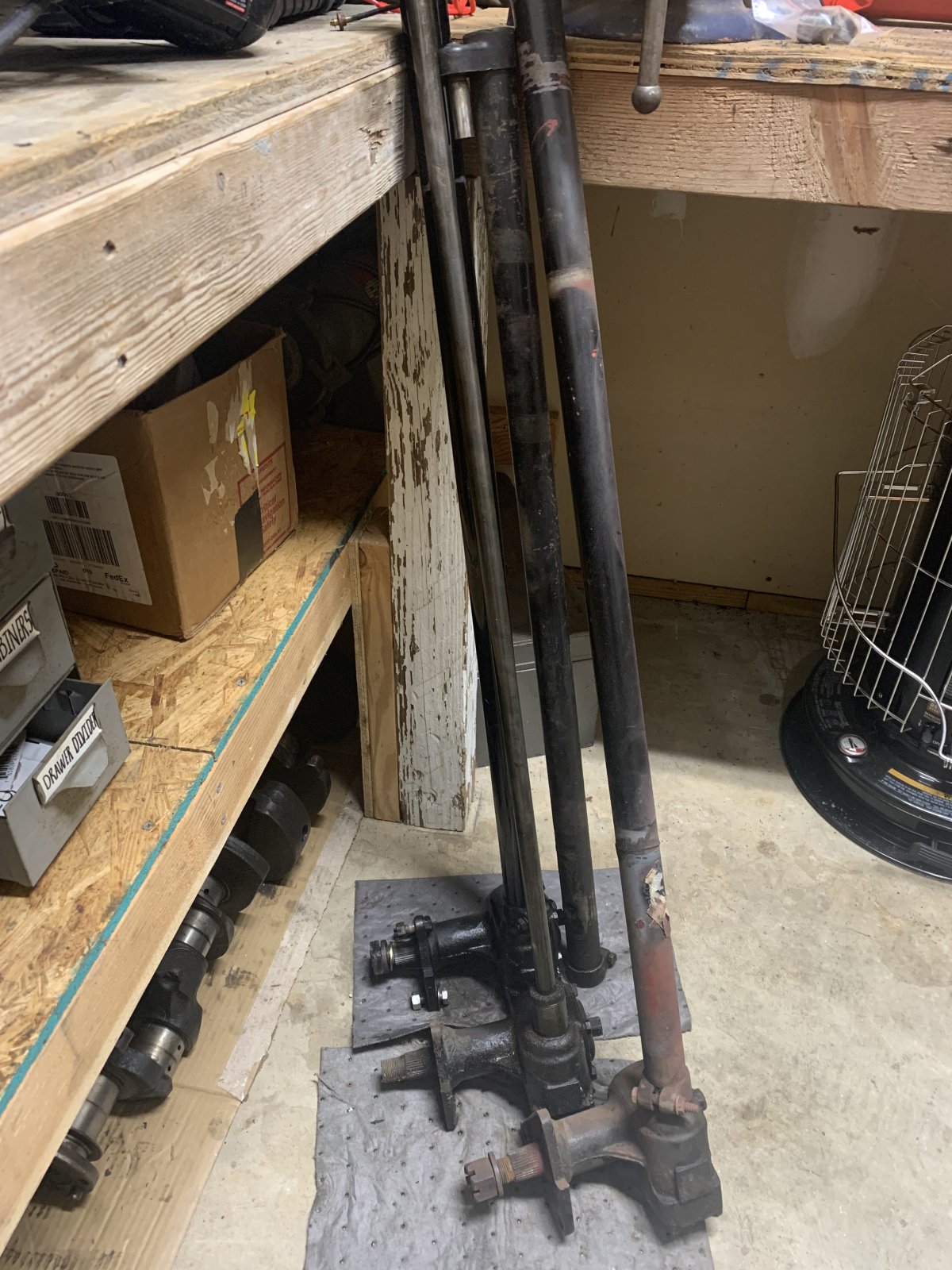

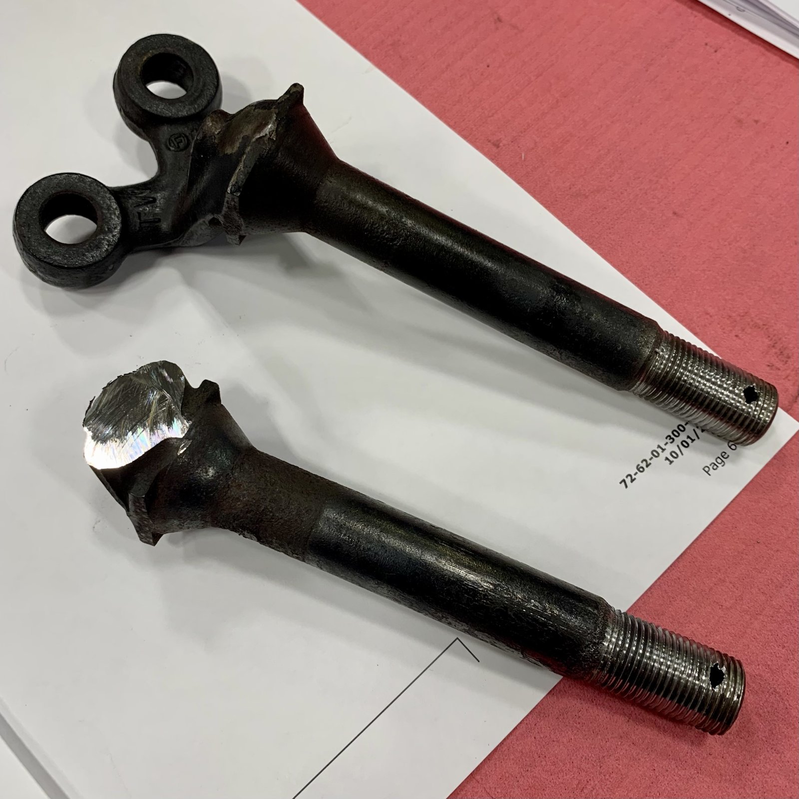

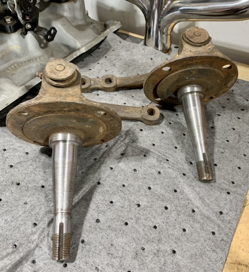

    I found a V8-60 axle locally. I paid full price, but that’s ok. When I was 8, Dad and I modeled a pinewood derby car after the Pierson ‘34 Coupe, and it was one of the details about the car I always loved.
    Anyhoo, The kingpin bores ended up being oversized, .830 in a few spots. Instead of attempting to resize the ends myself I opted to make the relatively short drive to Athens, GA and have Greg with Anson Axle do it. We also brought a ‘36 axle for dads build to have dropped and got two birds stoned at once…
    I also scored two sets of repopped V8-60 lock bolts from 2 different HAMBers

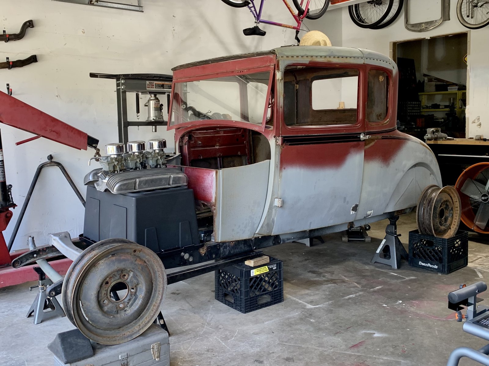

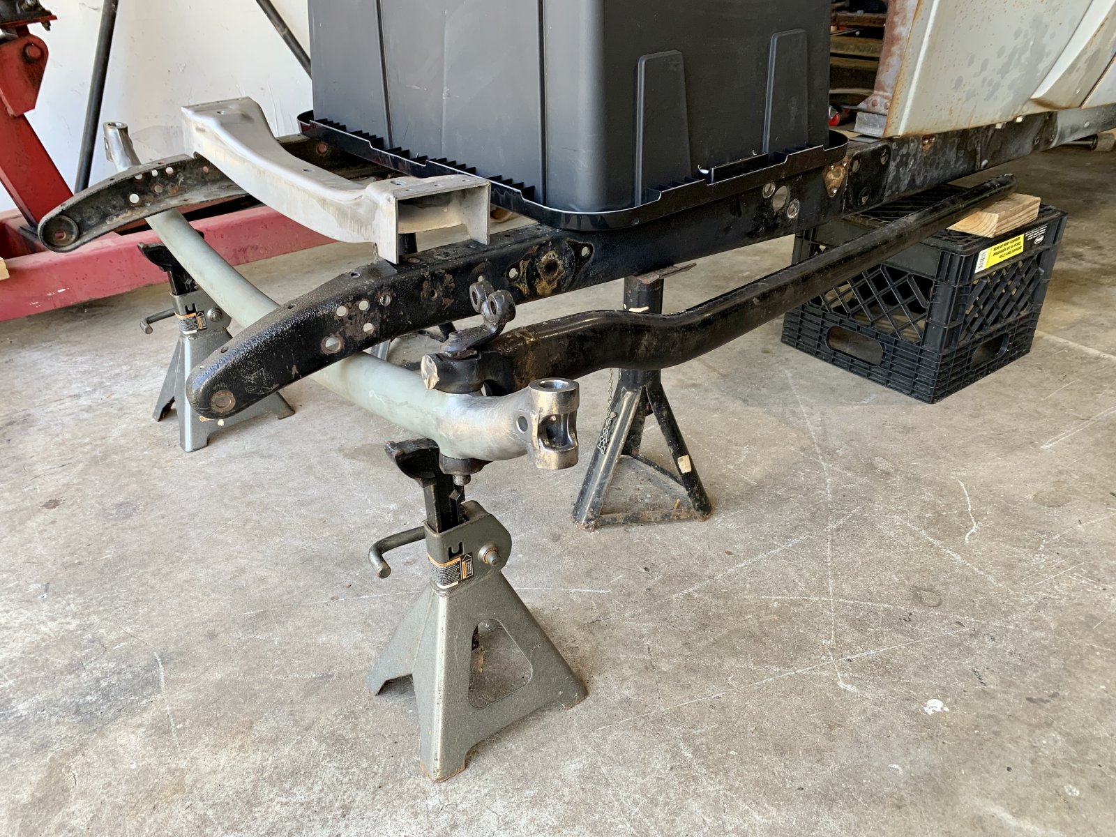

    Now that the V8-60 axle is home I can do another mock up. I find these silly mock ups important for morale.
    It’s also the first time I mated the V8-60 axle to the 46-48 bones and I love it.

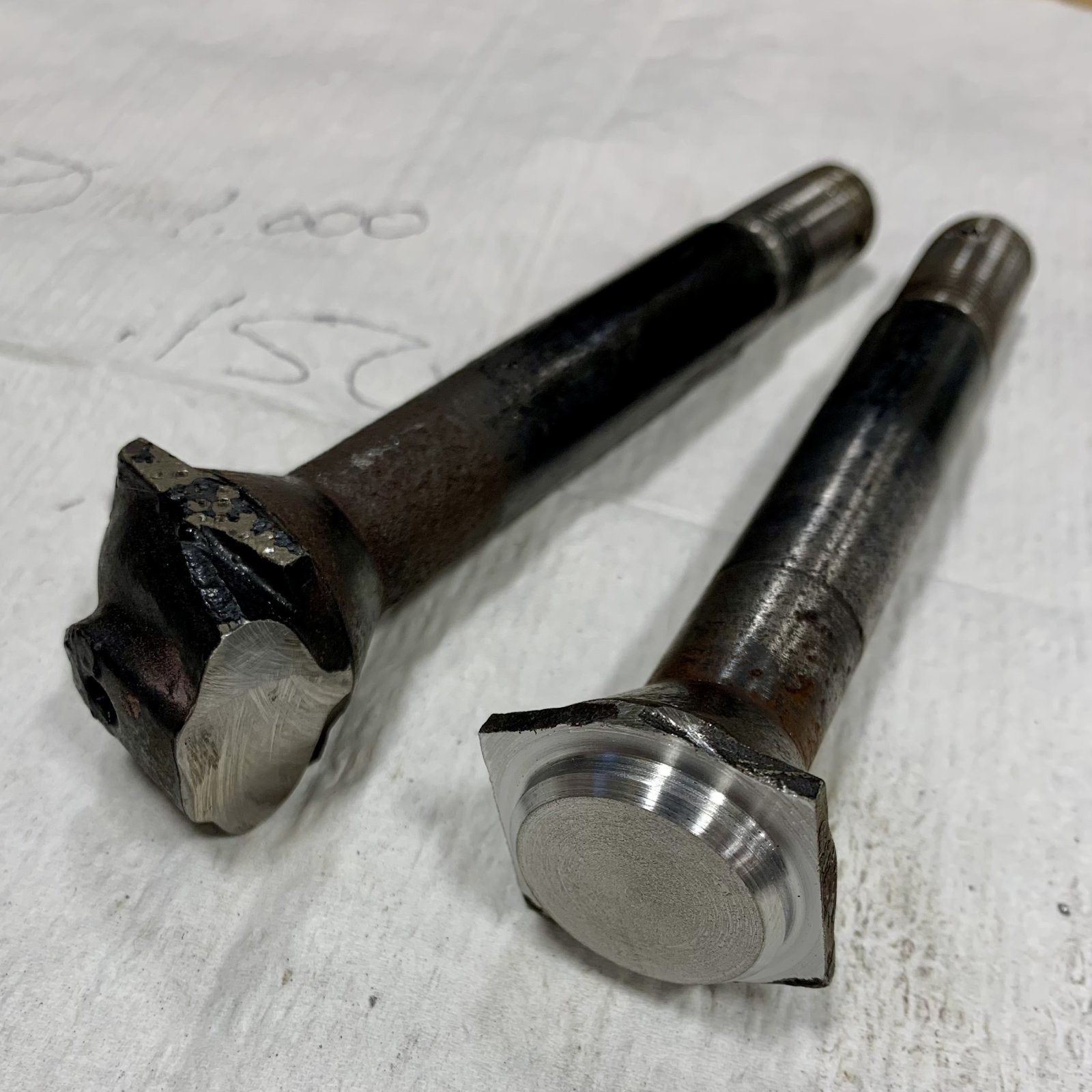

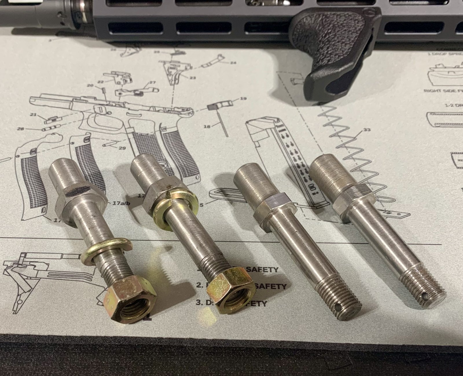

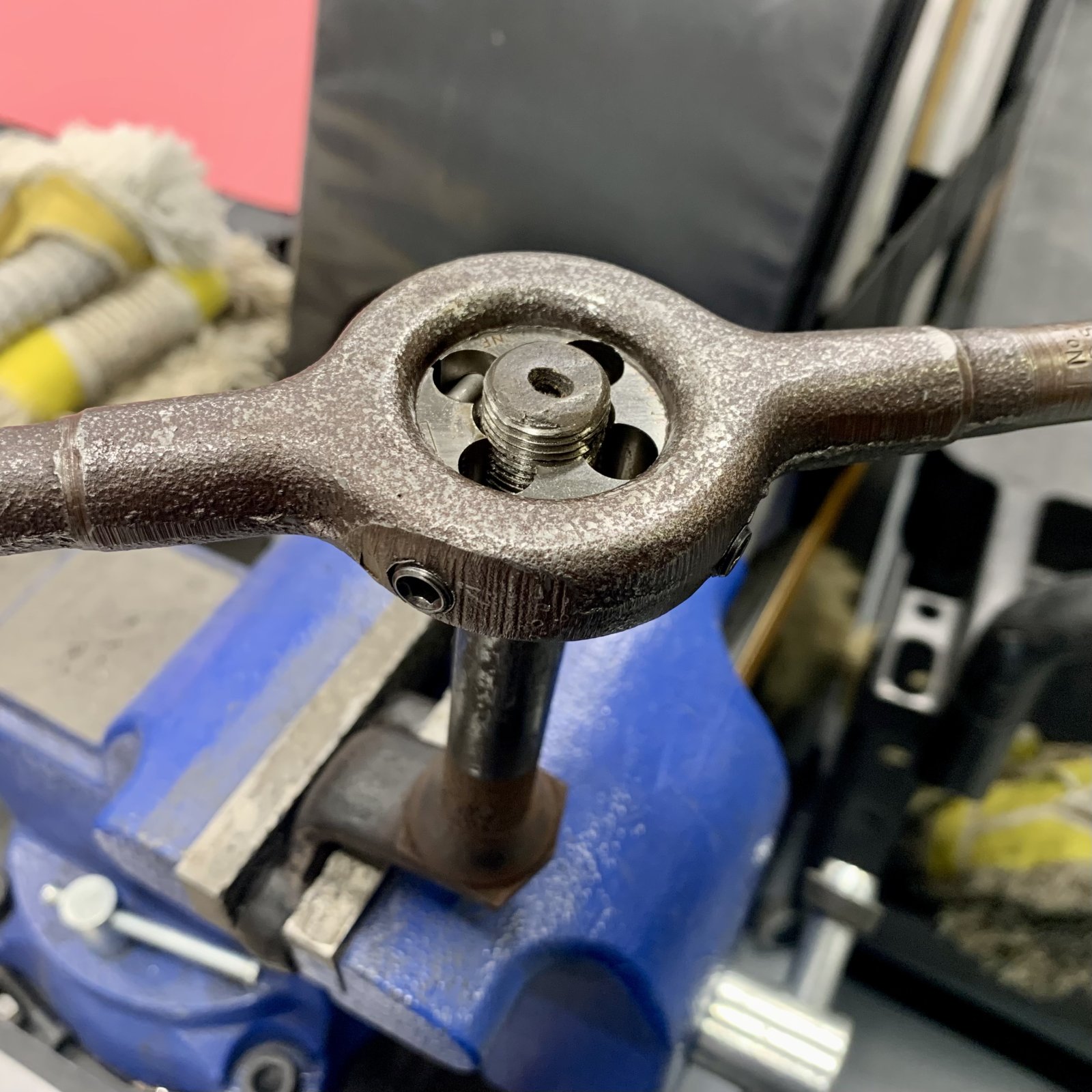

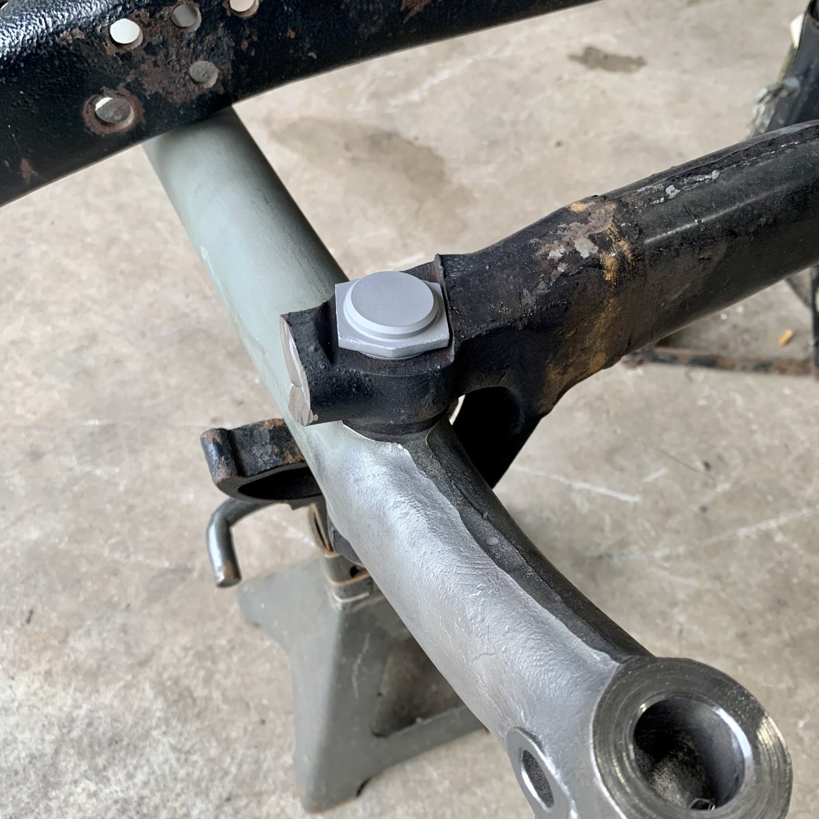

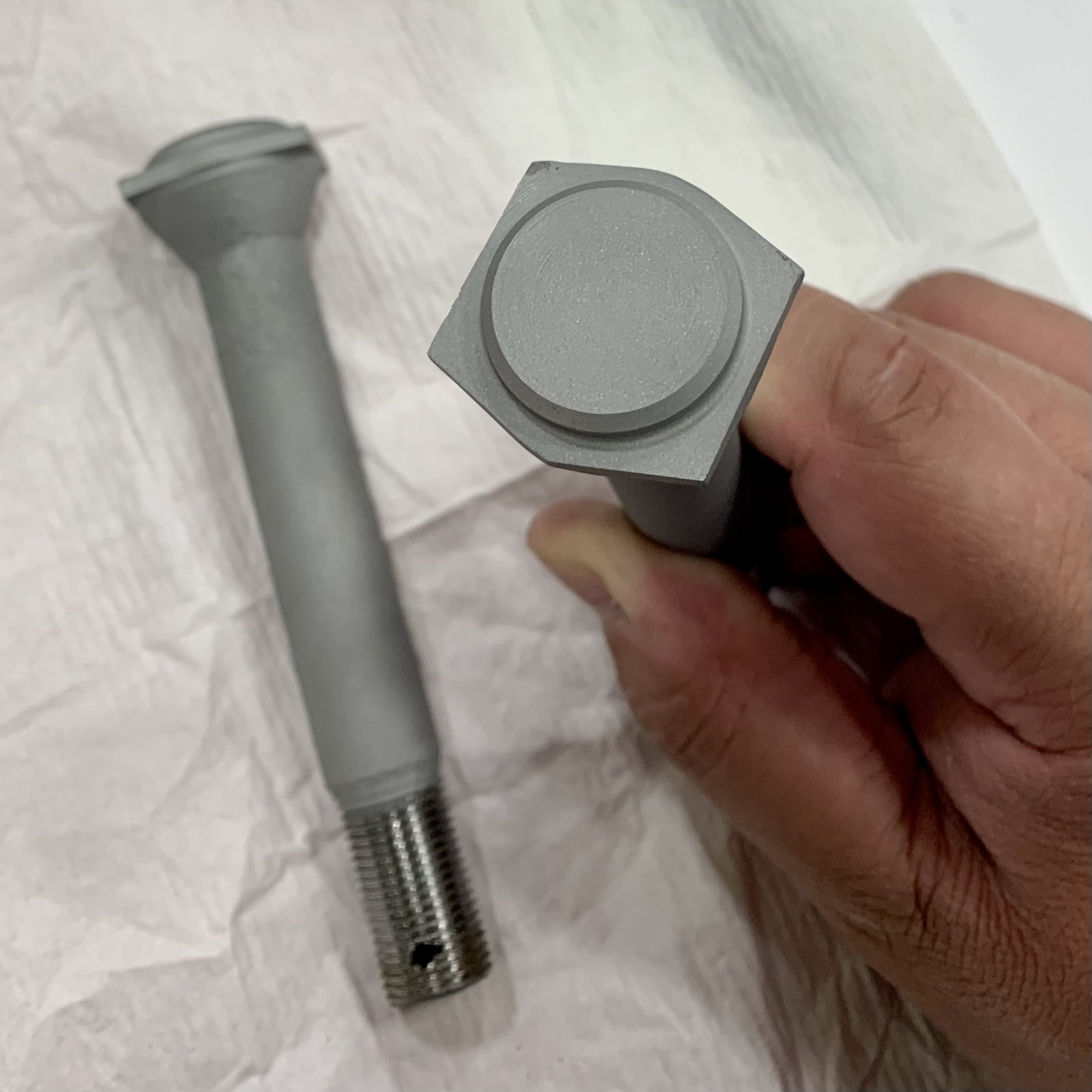

    I addressed the perch bolts today.

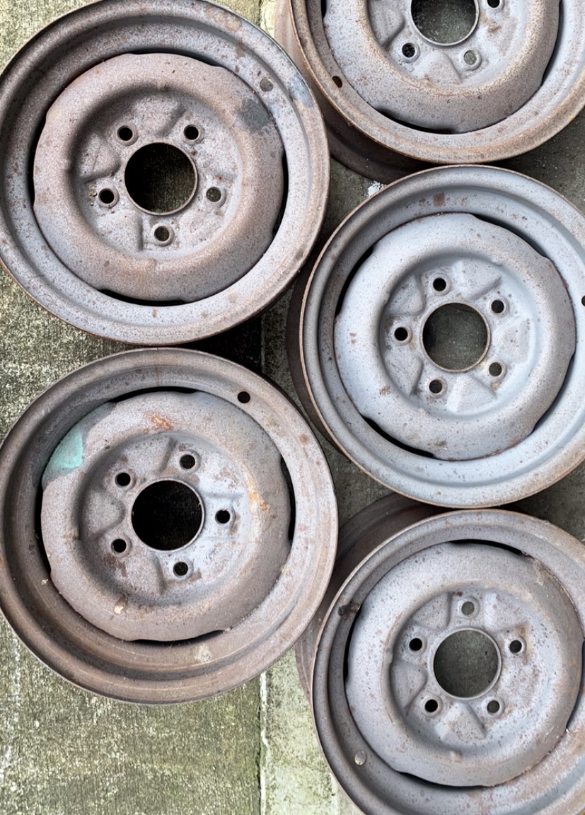

    I get by with most of my hunting, I will keep you in mind however! Come to think of it, ‘40 Ford style 16x5 or wider wheels are high on my list. I’m generally interested in any ‘40 Ford wheels 16x3.5 - 16x6. Also looking for a Model A truck cab for my dad.

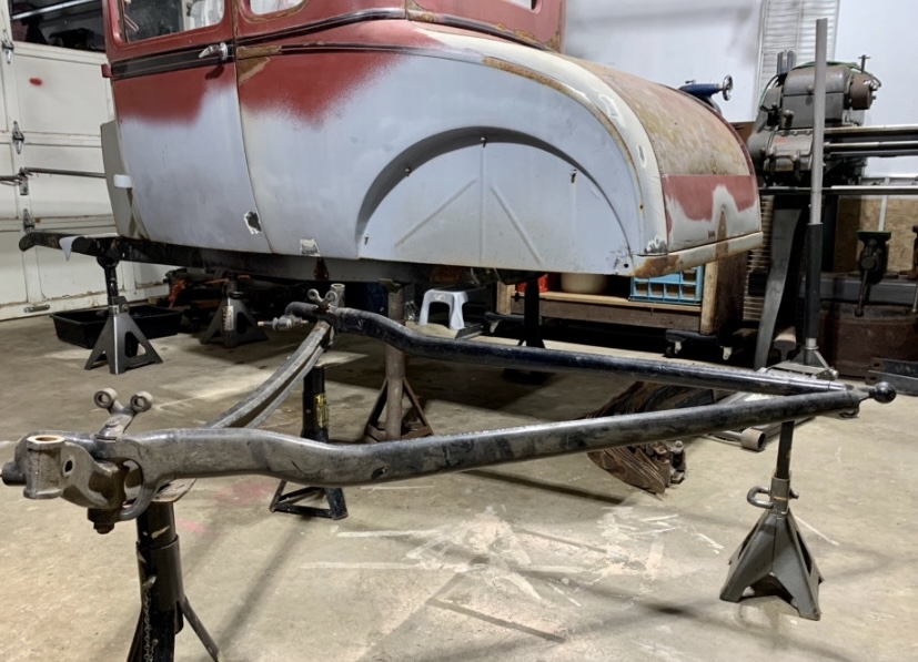

    Decided to go with ‘32 frame rails. I’ll be road tripping to ASC soon.
