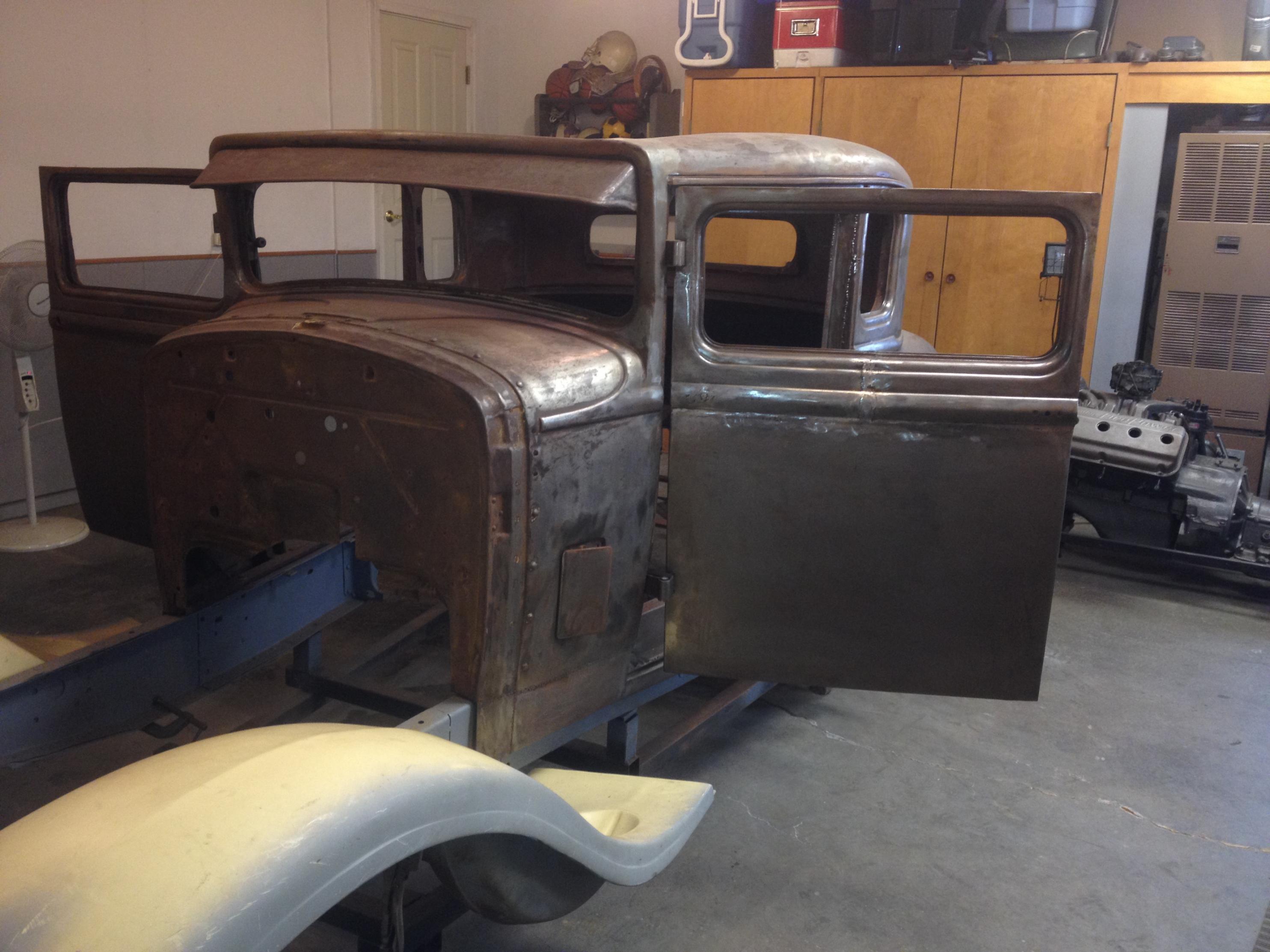

    It now has both doors on.
    Enclosed pics of the drivers door , It's Swings and shuts, need fine tuning,
    but not to bad for having a wrong swing door and to narrow.

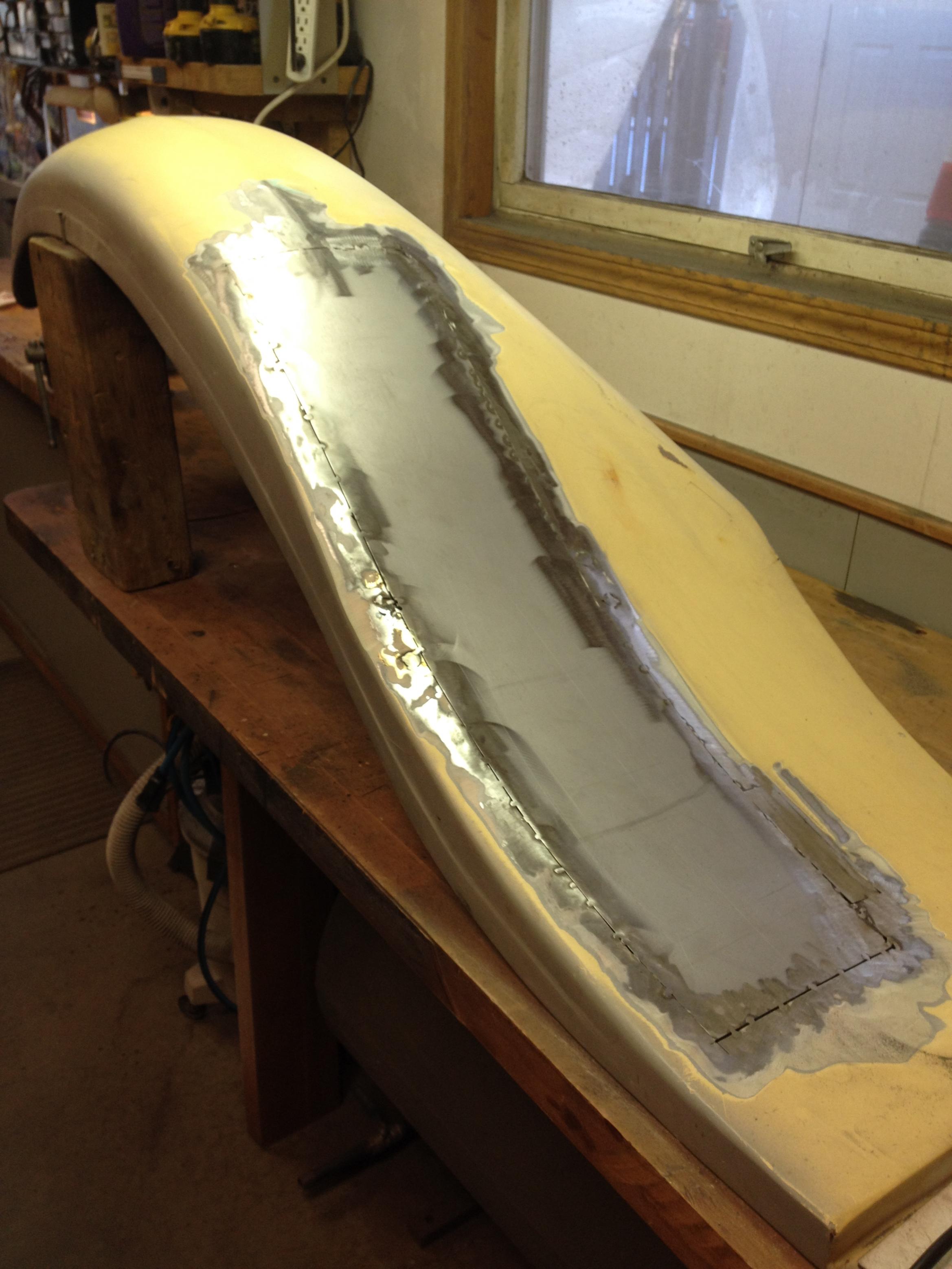

    I took out the front fender wells and filled them.
    Choff
  16. notaford1
    Joined: Feb 6, 2012
    Posts: 283
    notaford1
    from webster ny
    lookin' good..don't worry about purists you p***ed that point a long time ago.You're gonna have a good time putting in the fender ridge in that patch.As for the running boards those are the simplest ones you'll do. On my 29 I just made a frame out of 3/4 square tube and covered it with sheet metal,once I put the board rubber on you can't tell from factory and they have survived 25 years and 100,000 miles.Good luck
