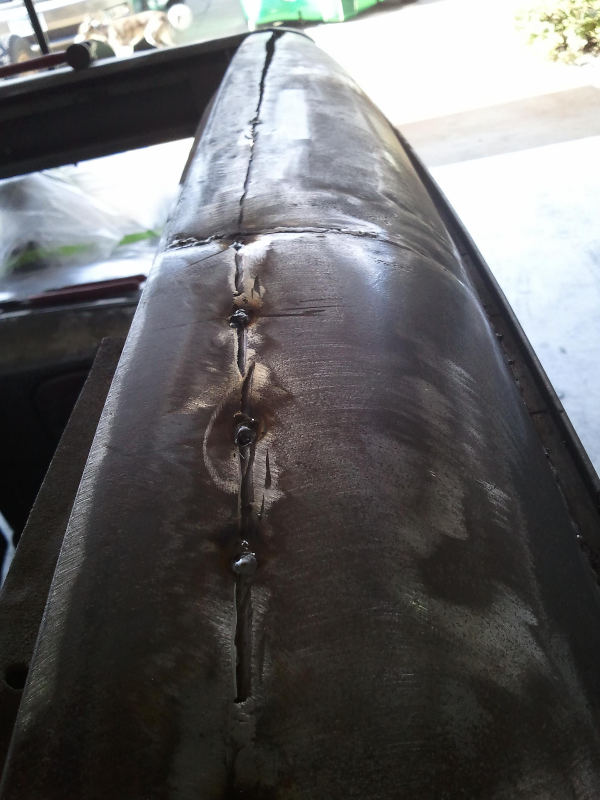

    Finished molding the body line

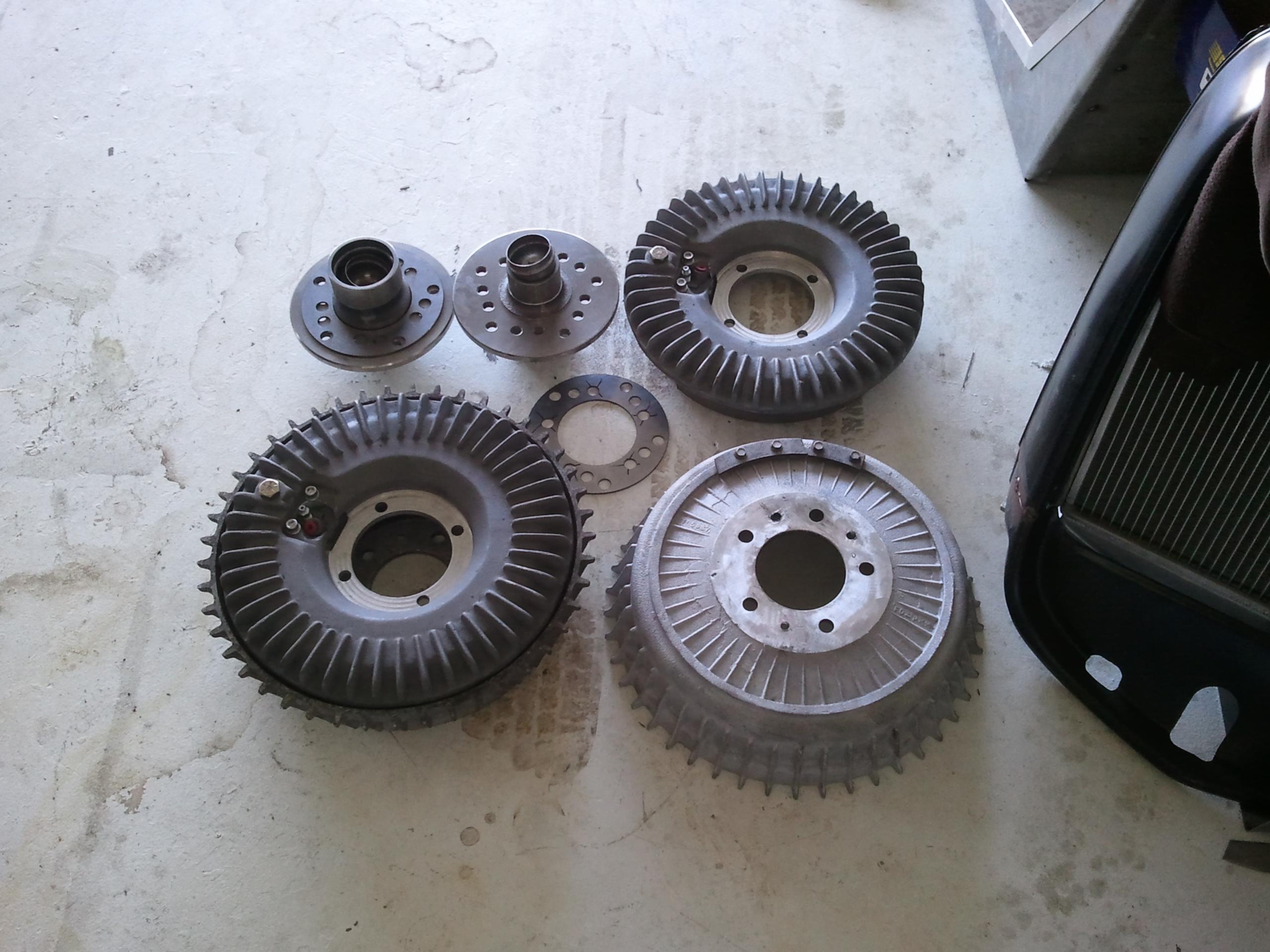

    Got the drums in today. Sand blasted them and got the old hub out. Time to drill the new bolt pattern and get them turned.
      438.4 KB
      169
      409.5 KB
      143

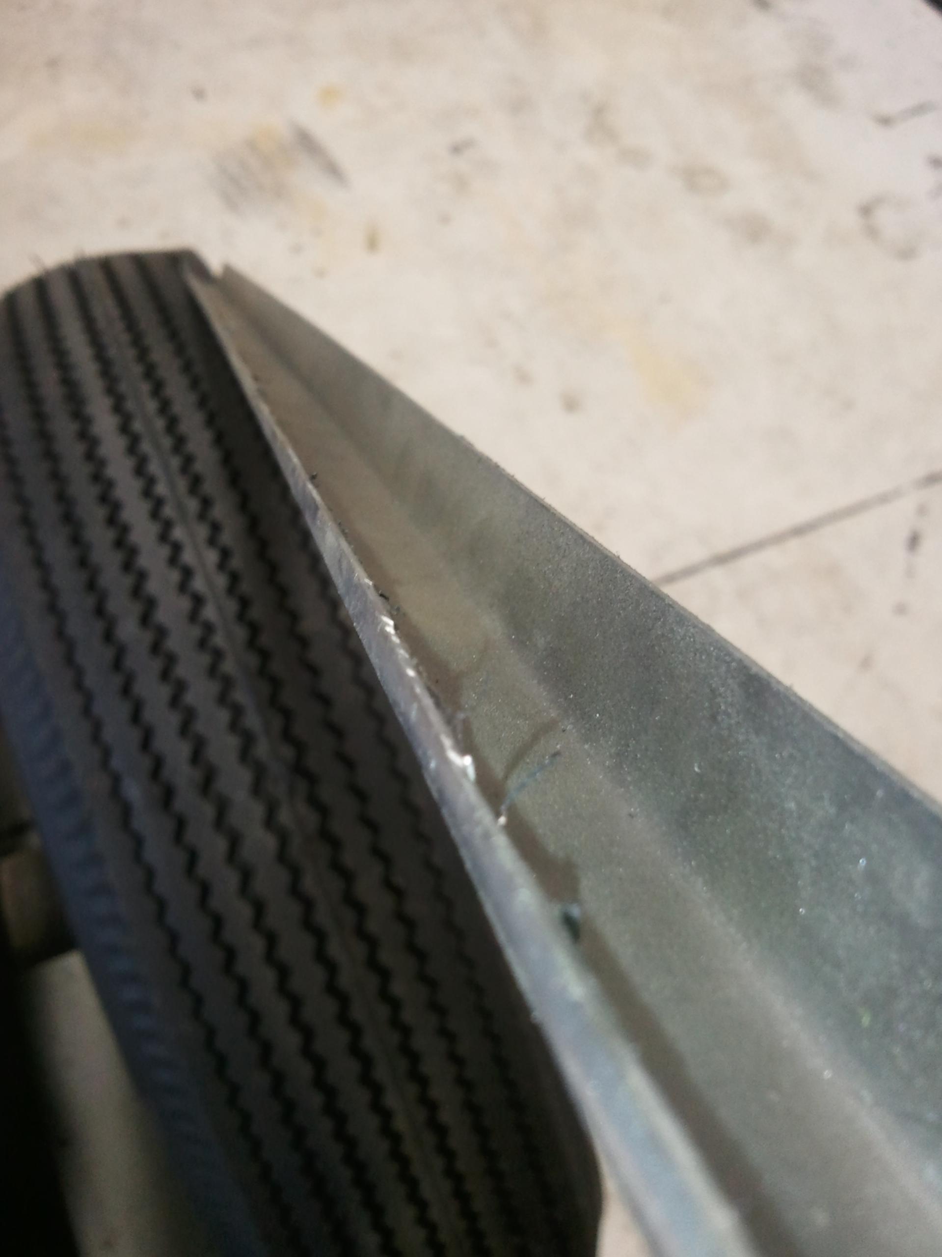

    Your belt line is looking pretty good. How did you end up making it? I will need to do something like that for mine. Origianlly mine was a sport coupe, I suspect your's may have been too. Originally sport coupes had a vinyl top with a clip on moulding for the belt line.
  9. Drivinford
    Joined: Aug 24, 2012
    Posts: 852
    Drivinford

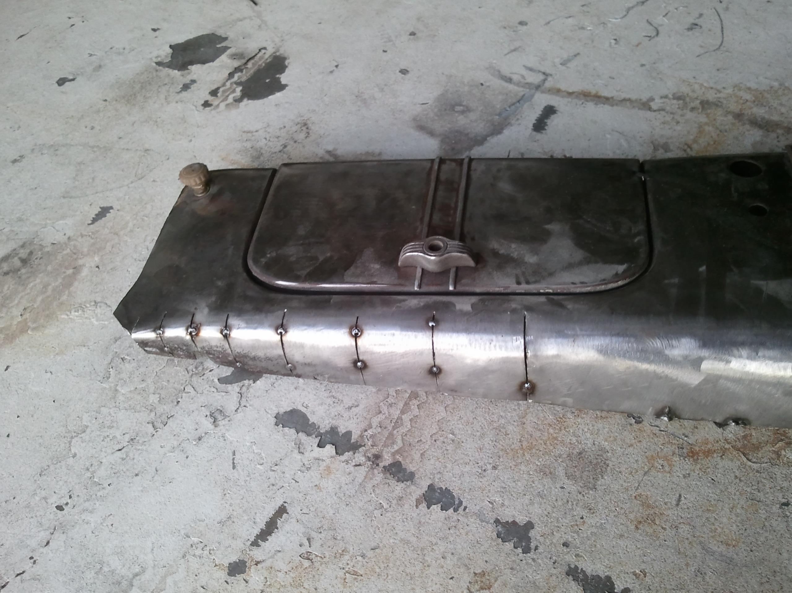

    Thanks. i took 20 gauge and bent the edges on it. Then pie cut where i wanted the curves to start. Its not that bad just takes a lil time. Im gonna do the other si
    de here in a week or so and il post pics on how i make it.

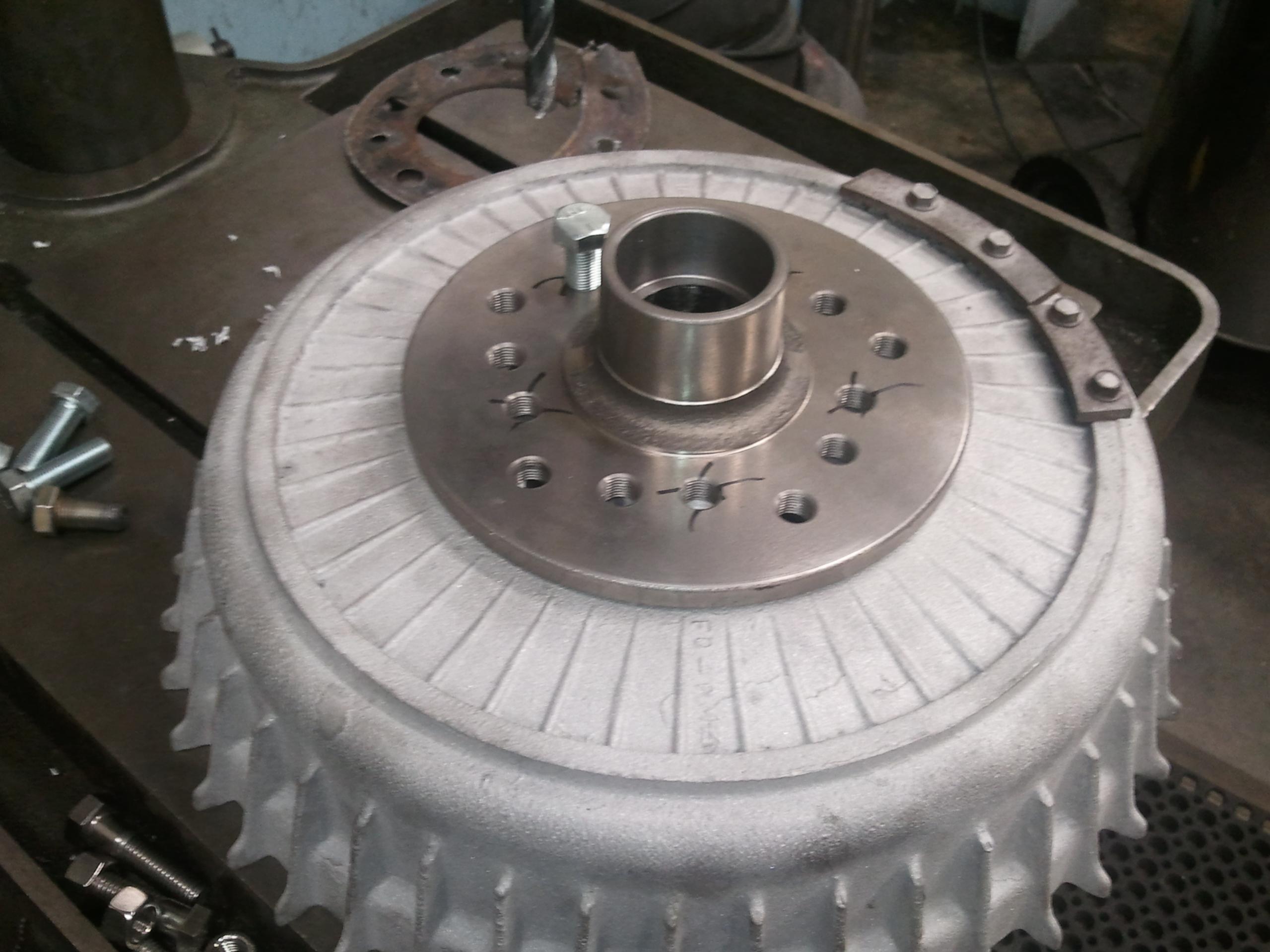

    45 buick drums i drilled for ford bolt pattern.. I have them mocked up so dont mind the position of the backing plate.

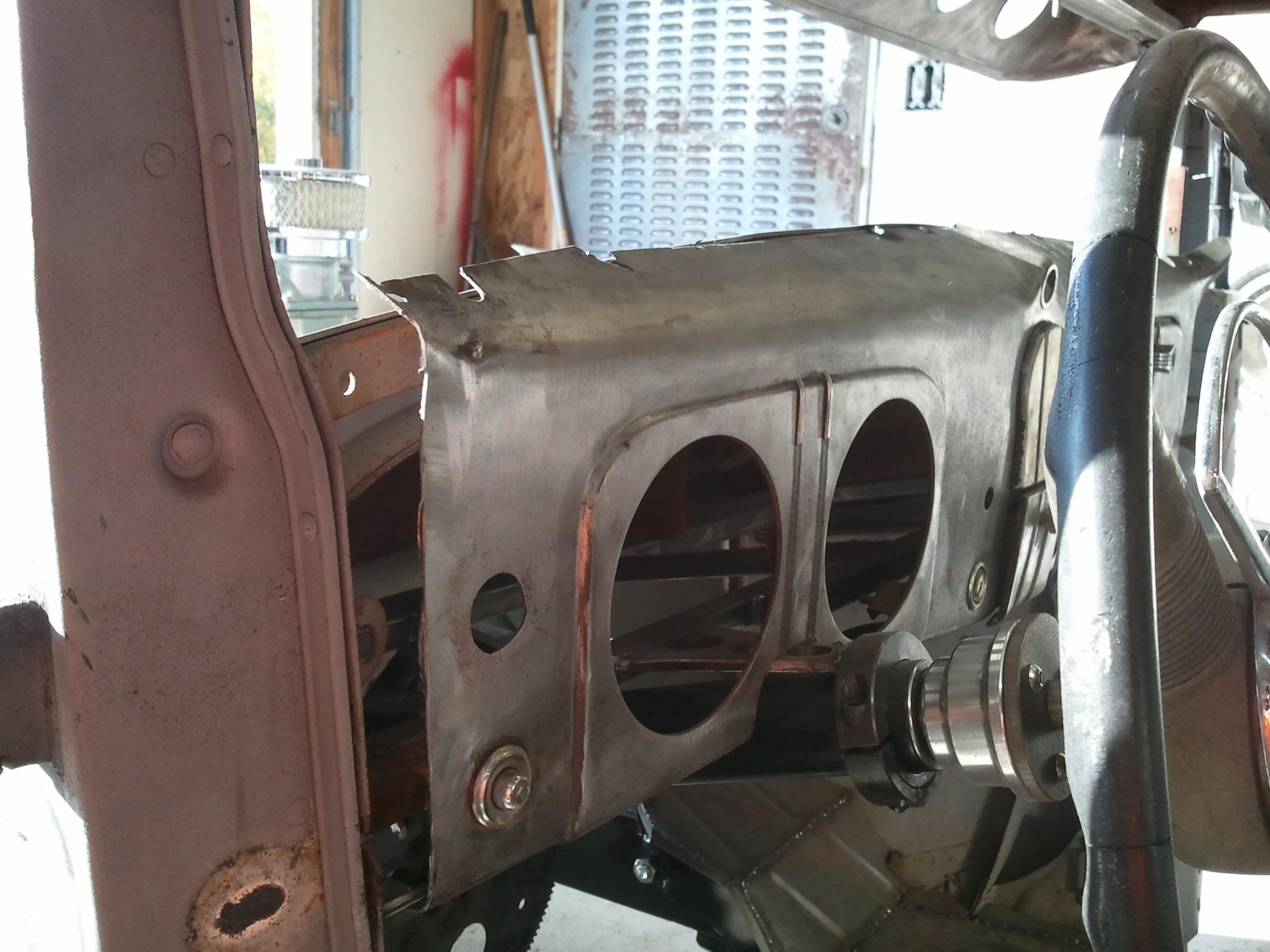

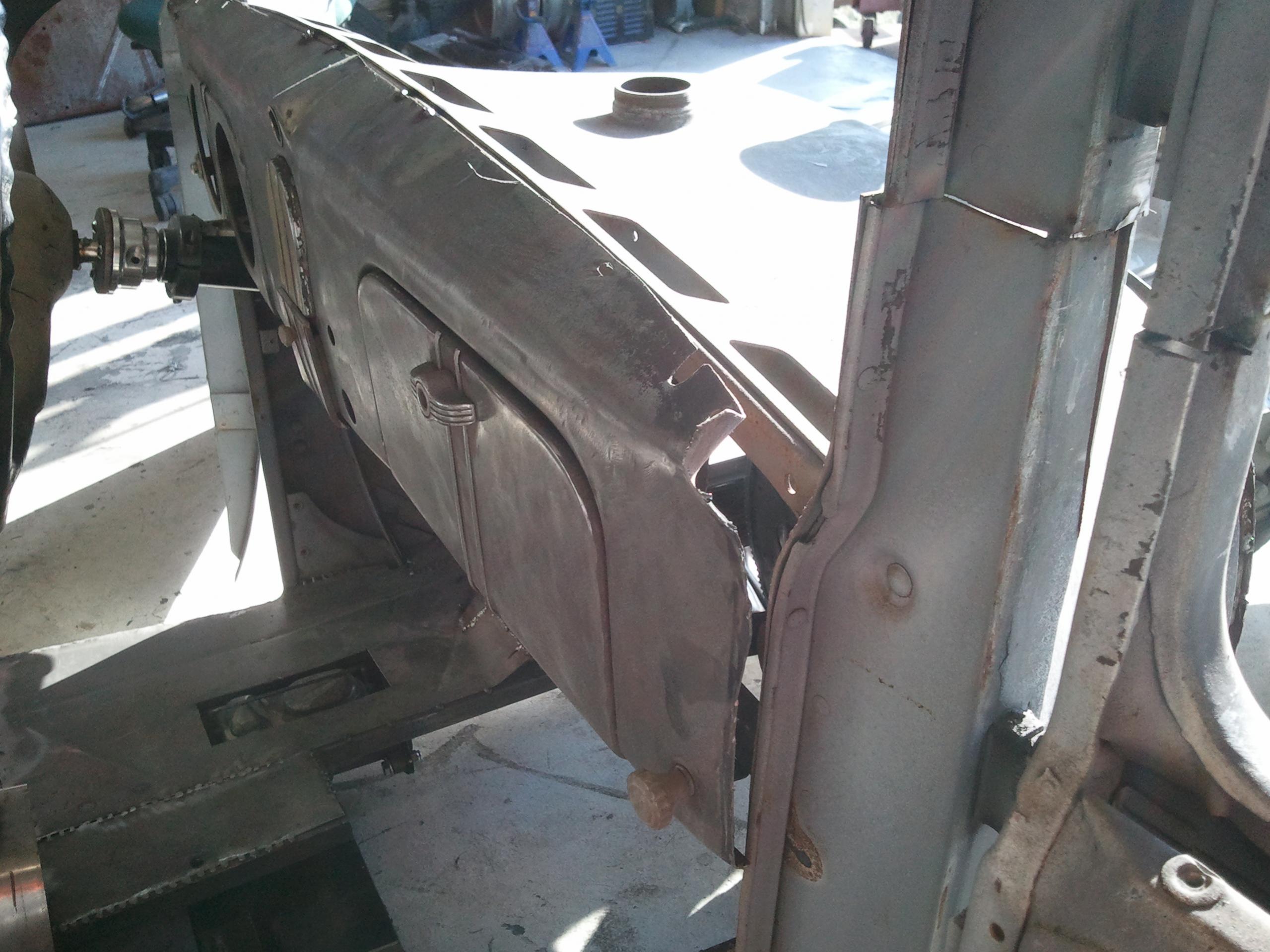

    Today i worked on makin the dash fit.

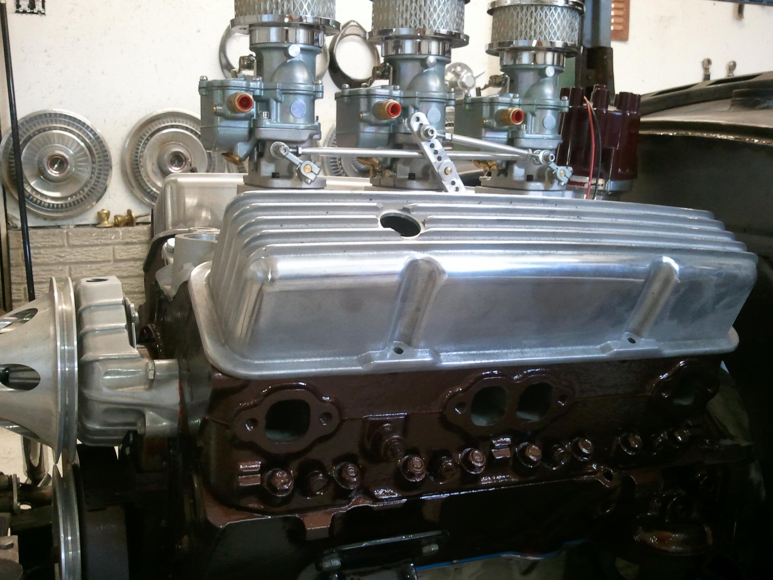

    Got the motor painted. And started ***embly

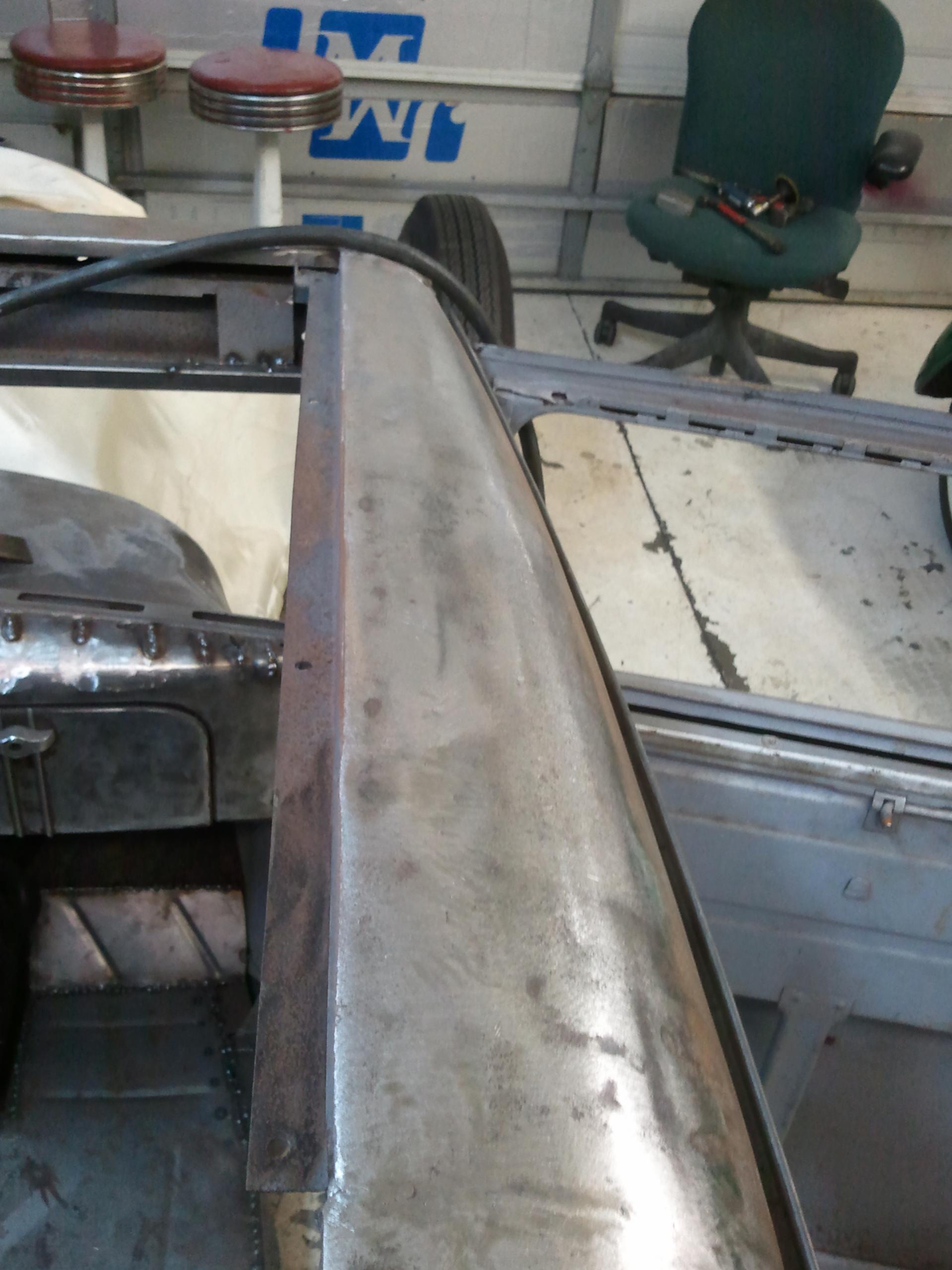

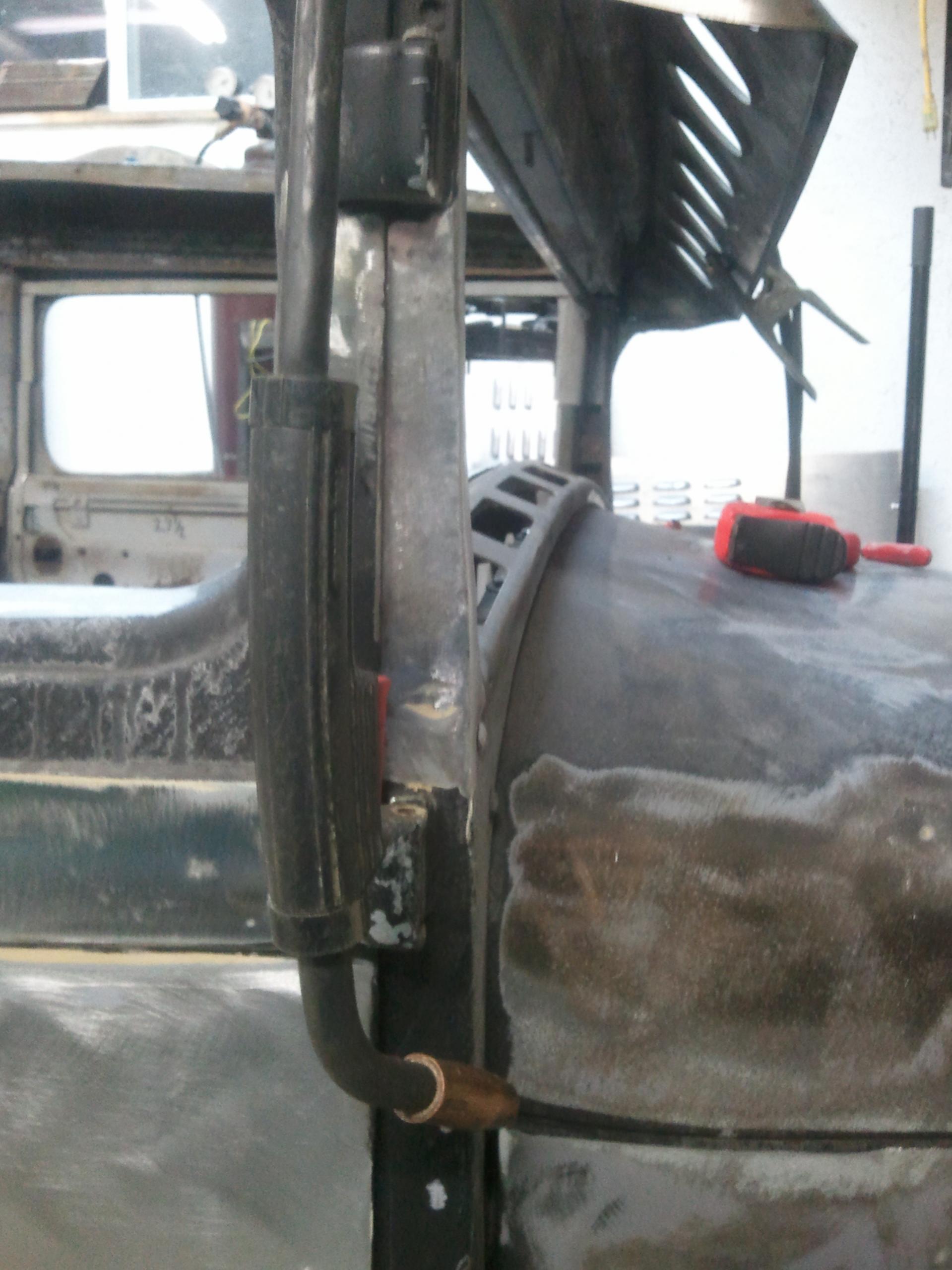

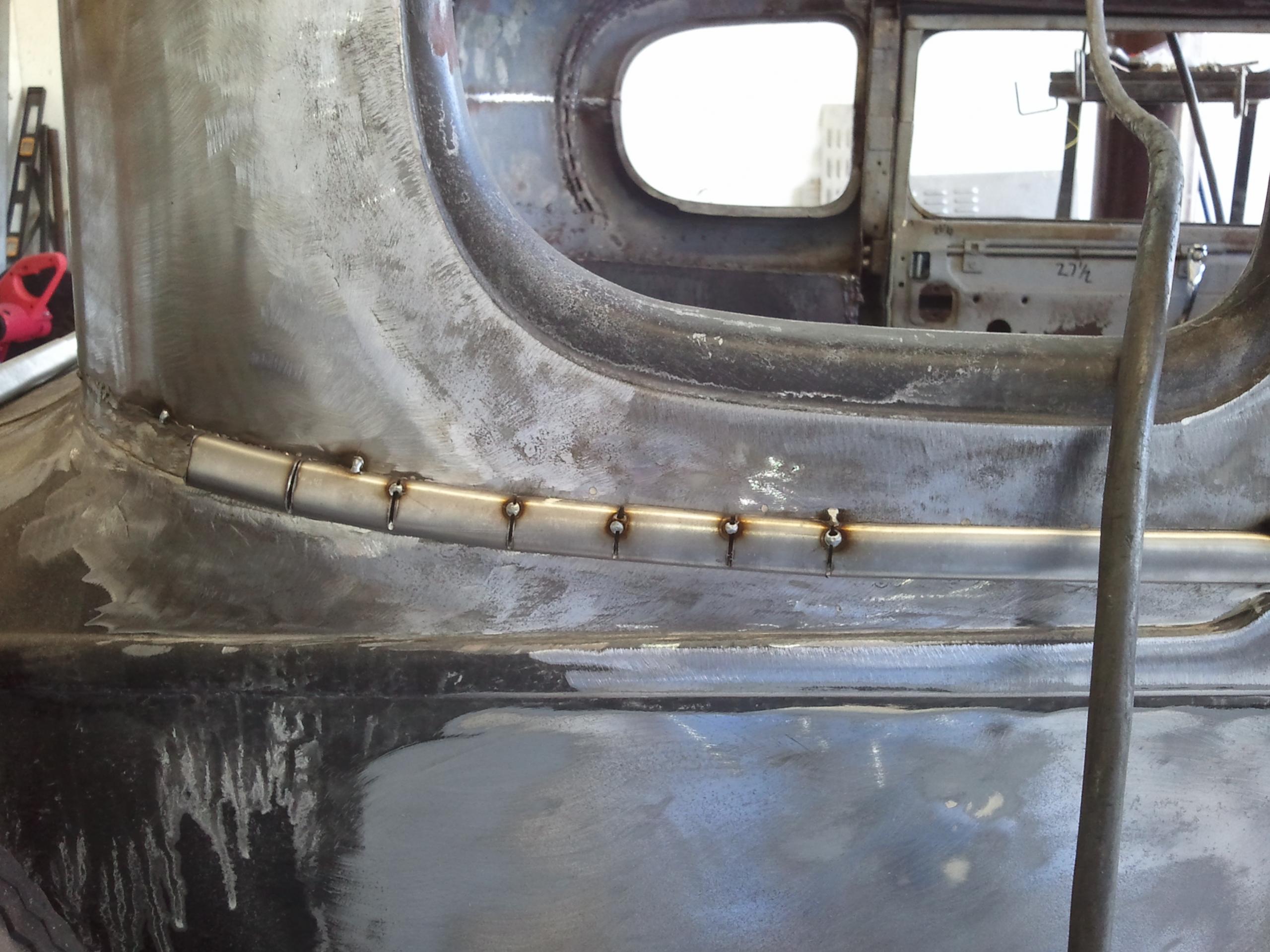

    I started on the p***enger side body line today.

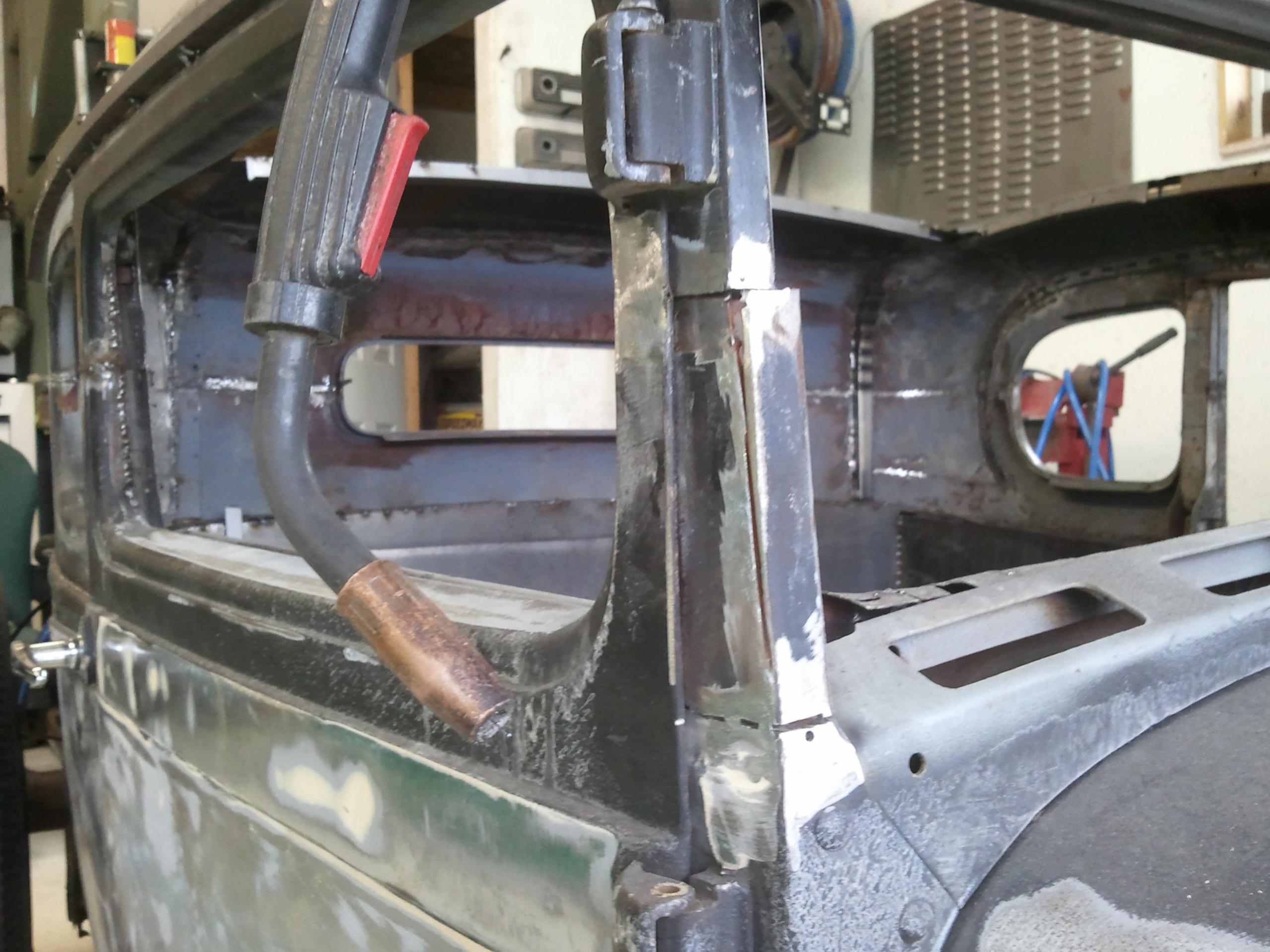

    Some repair on the panel above the door

    I dig that engine color!

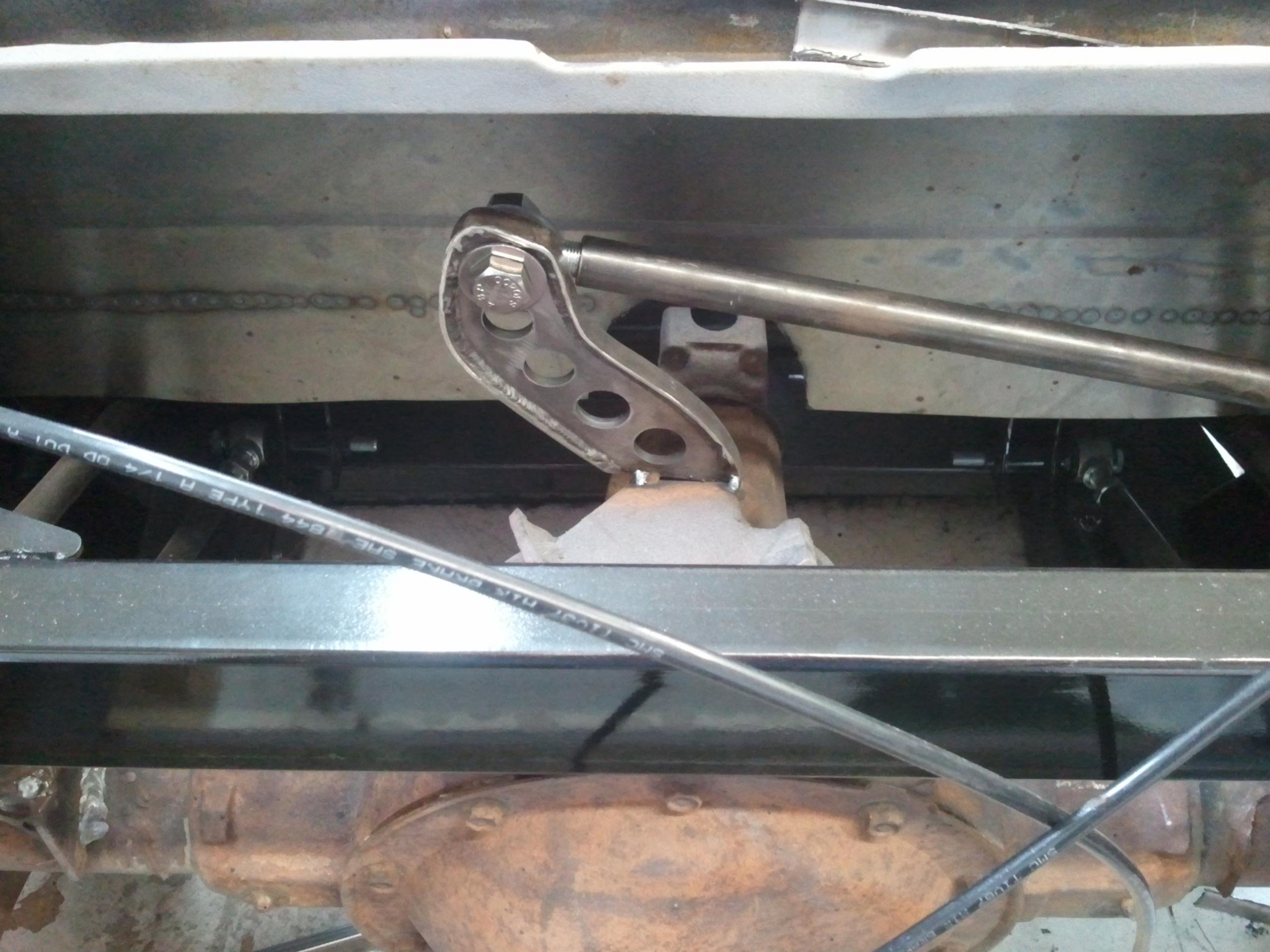

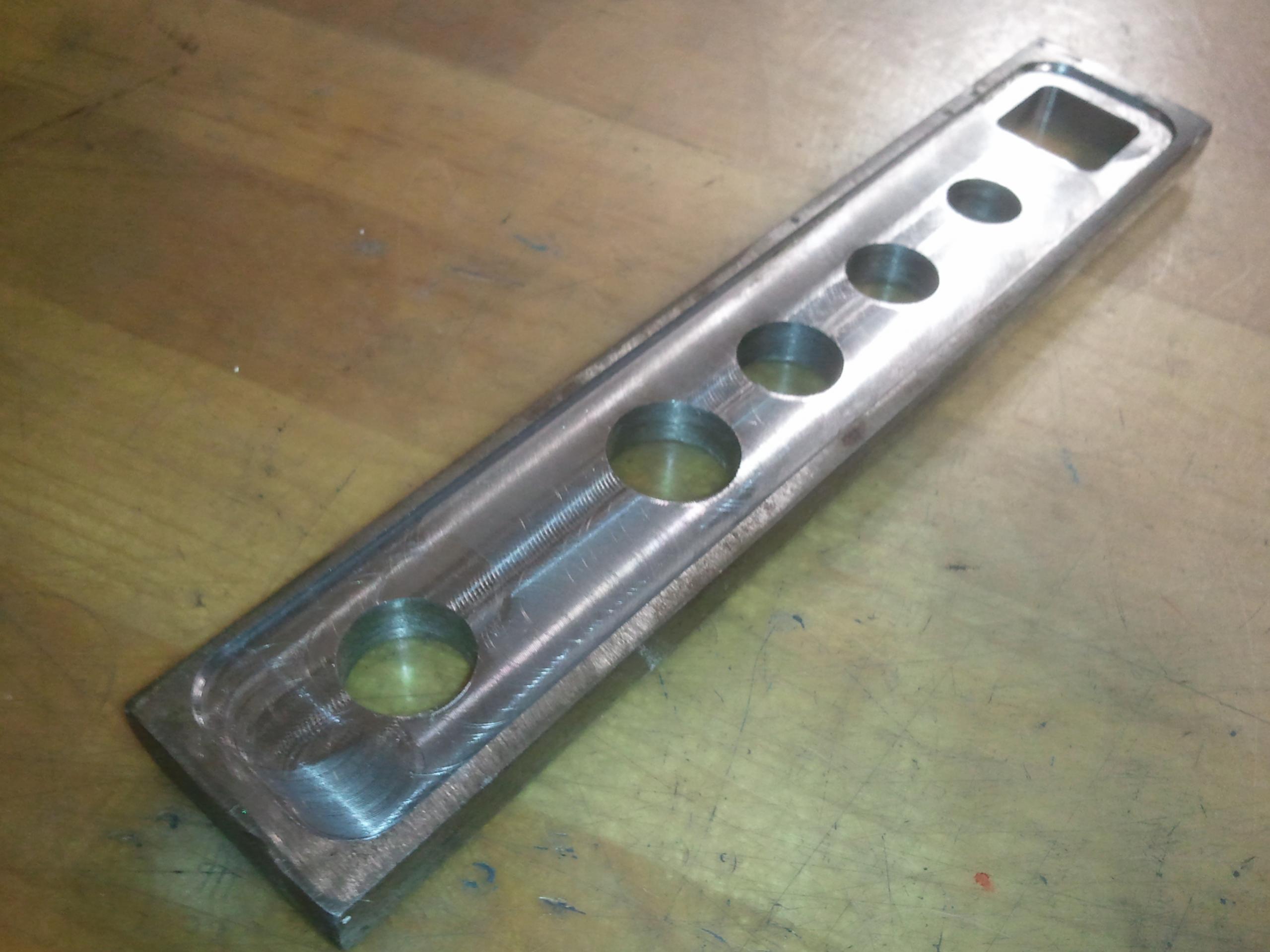

    I made this bracket last night for the panhard bar. I offset it a little so the rod wasnt so short
