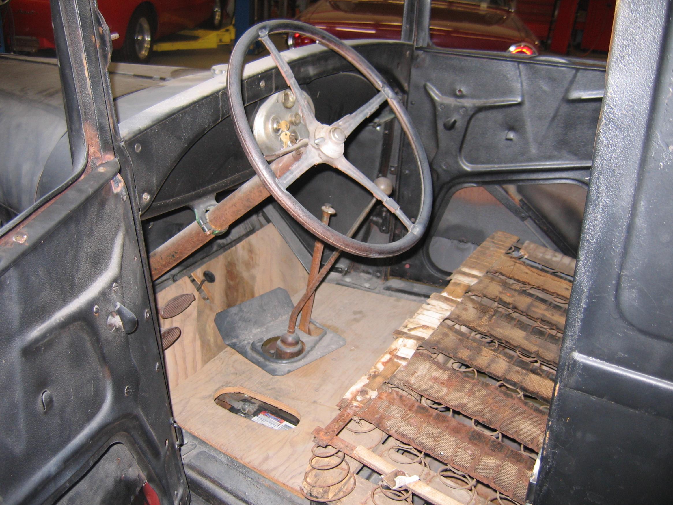

    Why do I always start with crap? So this is the starting point, and the plan. I have titled truck, 40000 mile original 265 chevy, muncie M21, and a V8 quickchange. I may ditch the muncie for a T5. Standard hot rod stuff. Box frame, dropped axle, split wishbones, reverse eyes on both springs and remove a leaf or two, 16x3.5 or 4 steelies up front, and 16x4.5 rears. Bias ply black walls, bigs n littles. Juice brakes, maybe MAYBE chop the top 1.5 inches so you have to look carefully to see if anything was done. Keeping hood, fenders, etc. May just run hood top. F1 or F100 steering box. The mundane stuff, rust repair, replace wood, align gaps, etc. Anyone need a running banger with an Otwell Health Heater Manifold? Work will commence soon, like Saturday.

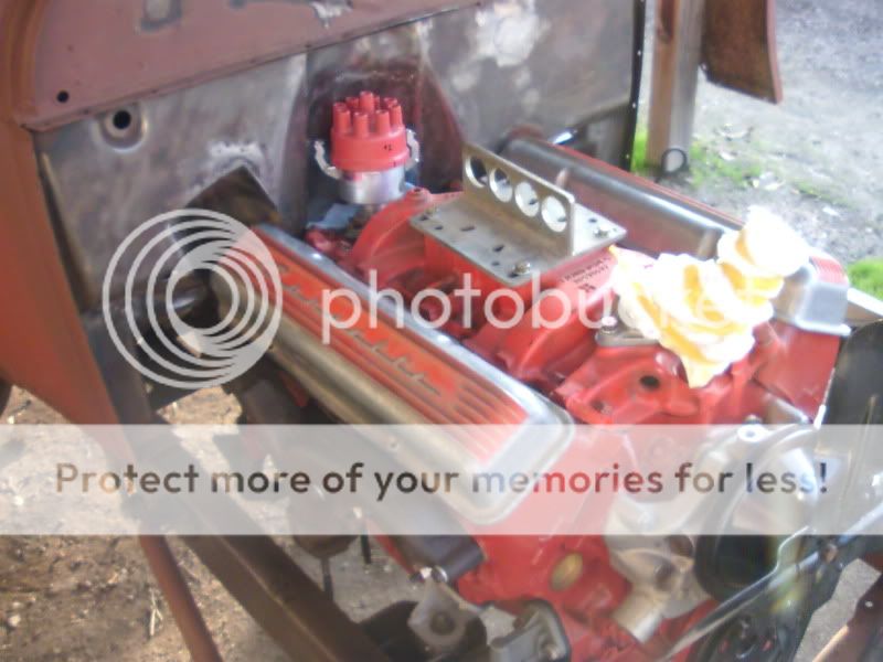

    Looks pretty good to me compared to what I started with. I would go with the T5, I love the over drive in my pickup. Here is a after pic, running a 283. That cab gets small quick with a V8. Keep us posted...

    Looks like you had to set the firewall back a bit for the distributor? Have any engine shots? Looking good.

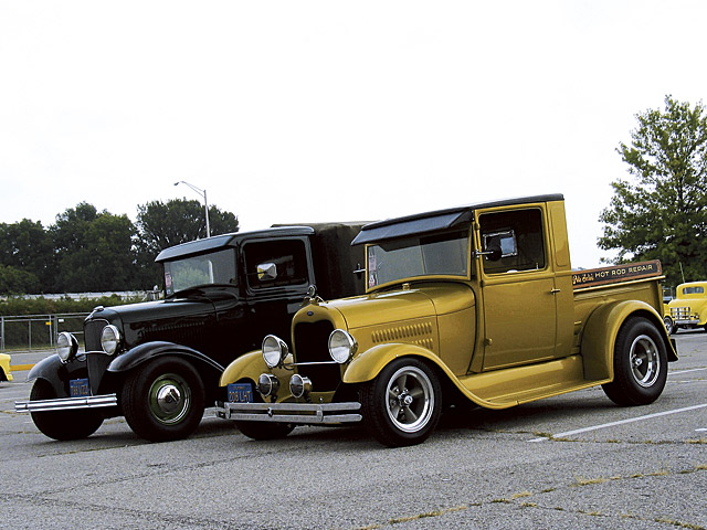

    See if you can find any pictures of Jake's (as in Pete and Jake's) A pickup. If that doesn't get your juices flowing nothing will. He built it before joining forces with Pete Chiporis (sp) to form the Pete and Jakes hot rod business.
    Frank
  15. Yup, building a loose clone of that truck in the future!

    I tried very hard not to recess the firewall and just notch it were needed while still using the stock tank. It is a very tight fit, I have about 5/8 inch from the water pump pulley to the radiator but it works. Although I have to take the tranny mount off and back up the rear of the tranny and pull the manifold to take the dizzy out. These are the best pics I have right now, feel free if you want more pics or any measurments.
