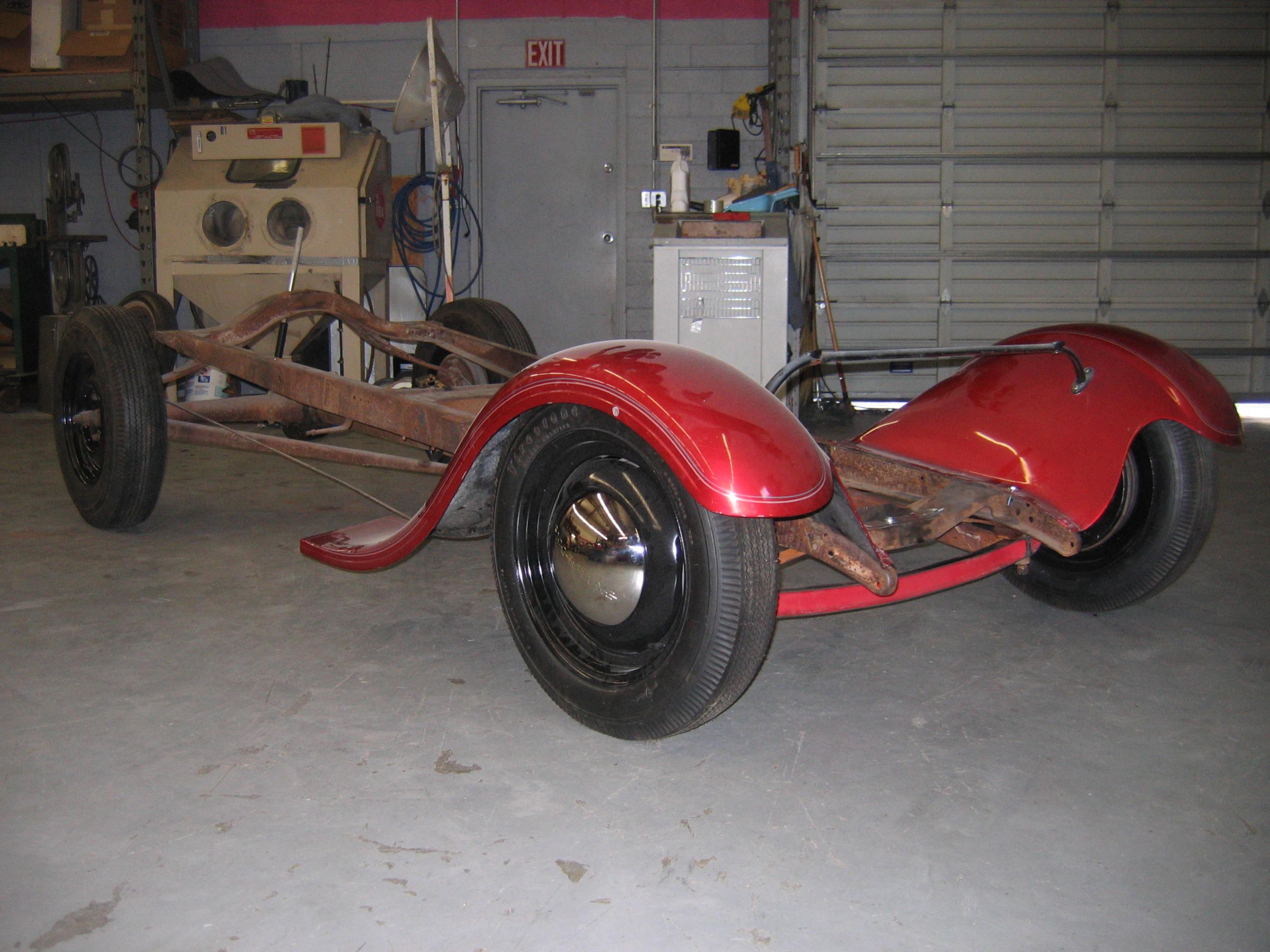

    Mocking up suspension and ride height.

    bobscogin
    Ha!! Dude, you're a tough customer! That truck is primo! Here's how ya' start with ****!

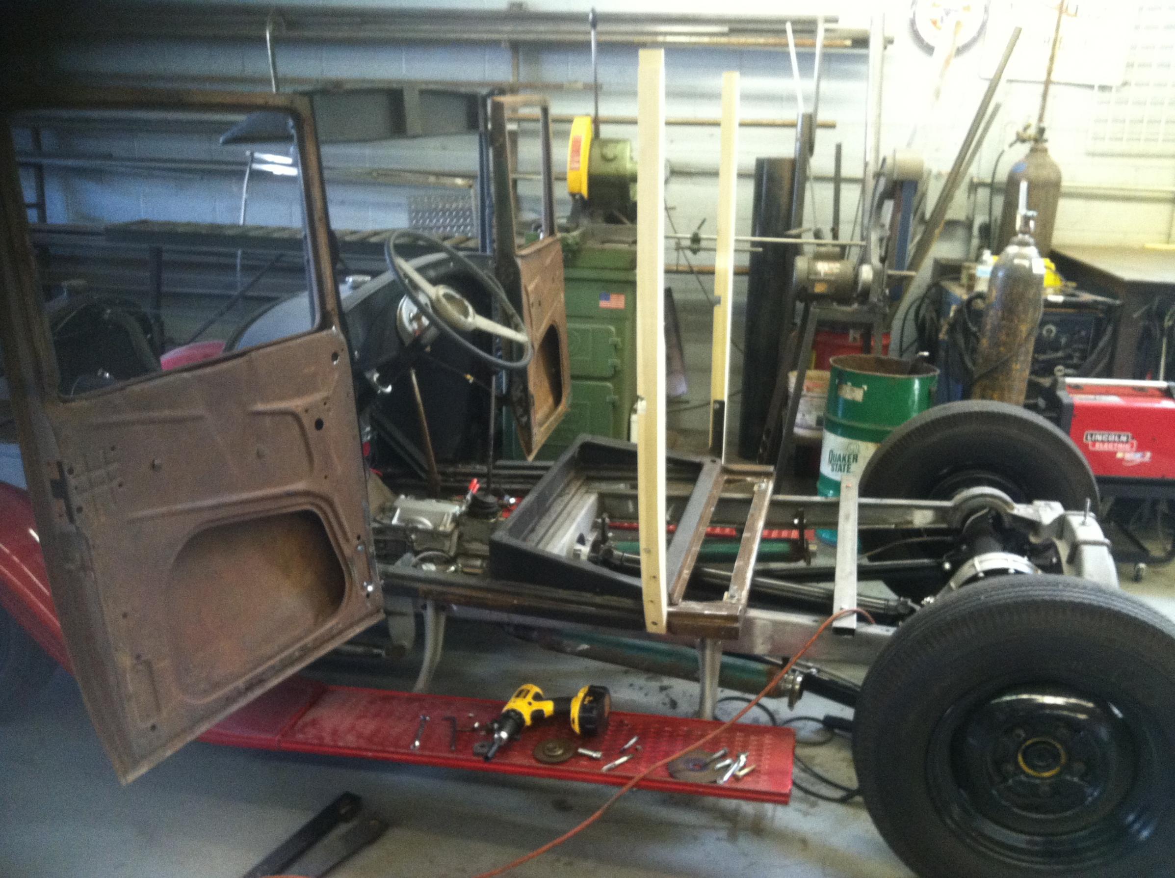

    Rear wishbone done, F100 steering box done, body back on for fitting and shimming. Will re-install bed and redrill mounting holes, as the frame got stretched 7.5 inches for the spring behind rear setup. Gaining momentum as I go.... Gonna mount the pedals this week and then box frame and install legs for K member/center crossmember. I installed the engine/trans forward and low, I gots me some foot room, and room for pedals, exhaust and a battery. The lower firewall is out at the moment, it will get a slight setback that will look stock. Yes it's getting floors.

    Pretty cool build. Appreciate the info on straightening axle tubes back on page 2.
