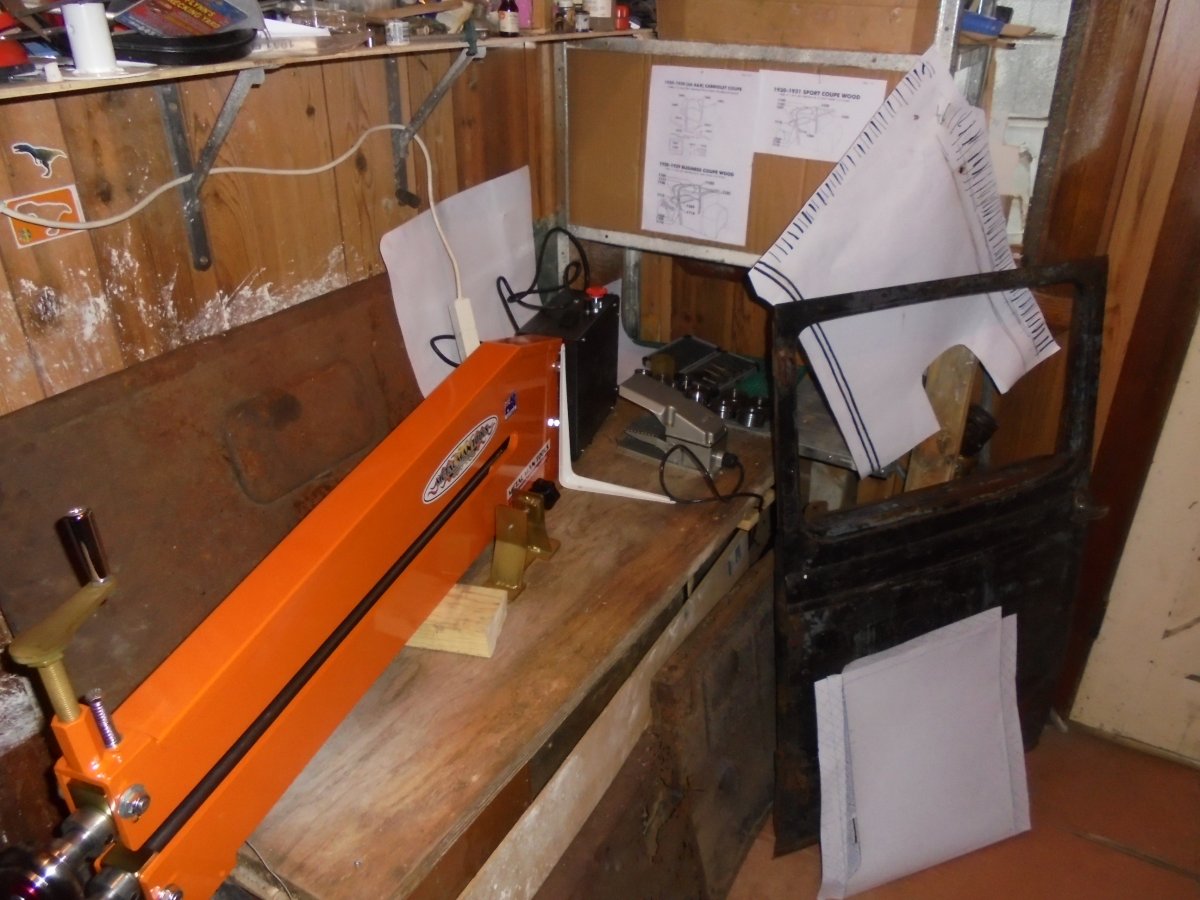

    Once the upper and lower buck is completed, the next task will be to make the patterns that will be used to trace onto the sheet metal.

    Hey Guys.
    Just a quick update, fellow HAMBER "low down A" raised a very good question about why I did not just purchase a set of repro sub rails for $300. The simple fact is that I live on the other side of the globe in Australia where we pay a lot more for everything.
    With the differences in our exchange rate the $300.00 US would work out to around $360.00 Australian. I don't mind paying the 20 percent extra but the shipping could end up being two or three times the purchase price.
    While these reproduction panels can be shipped in, the cost of the shipping often makes purchasing panels un-economic. As far as sourcing the parts locally, there are only two businesses in all of Australia that manufacture steel Model A panels and they are pickup cabs and beds so again there is no option there.
    While I would prefer to use the original sub rails for this project, the severe pitting and rust makes repairing them more trouble than its worth. There is just enough of it left that I can use it for a pattern to make my own.
    While the ones I make up will not compare with good originals or repro ones, I will be striving to make them as accurate as possible. There will be various other panels that I will be fabricating as well including the hood, rain channels below the deck lid and even a folding top.
    I figured out last year it was far cheaper for me to purchase the equipment to fabricate the parts I needed, rather than to try and track down the originals or pay sky high shipping for repro versions. DSC00543.JPG DSC00544.JPG

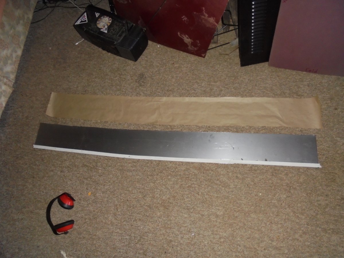

    As I could not find a marker, I used masking tape for the outline before cutting out the desired shape. DSC01246.JPG
  7. chev34ute
    Joined: Nov 13, 2011
    Posts: 1,594
    chev34ute
    Once i had further trimmed the piece, I made sure to take a paper pattern of it for the other side. DSC01251.JPG

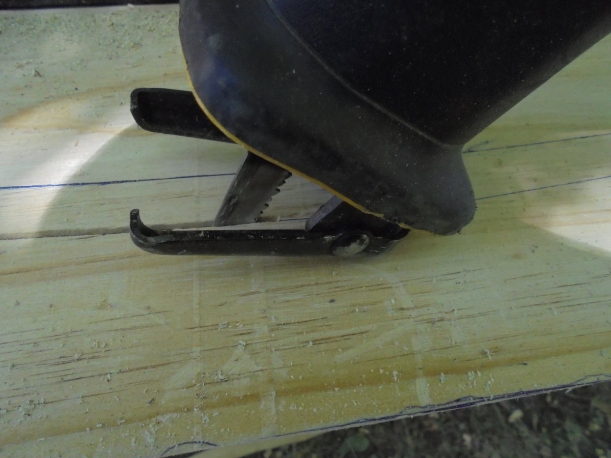

    It was a tricky process as I did not want to deface the metal, so I opted to turn the metal with the wide vice grips rather than hammer down.
  10. chev34ute
    Posts: 1,594
    chev34ute
    I worked the inside leading edge first, followed by the inside trailing edge making sure to keep the same width at each ends which worked out at around five inches. By doing so I was able to lock the piece over the buck and turn my attention the outside edge. I then focused my attention on forming the inside contour. DSC01258.JPG

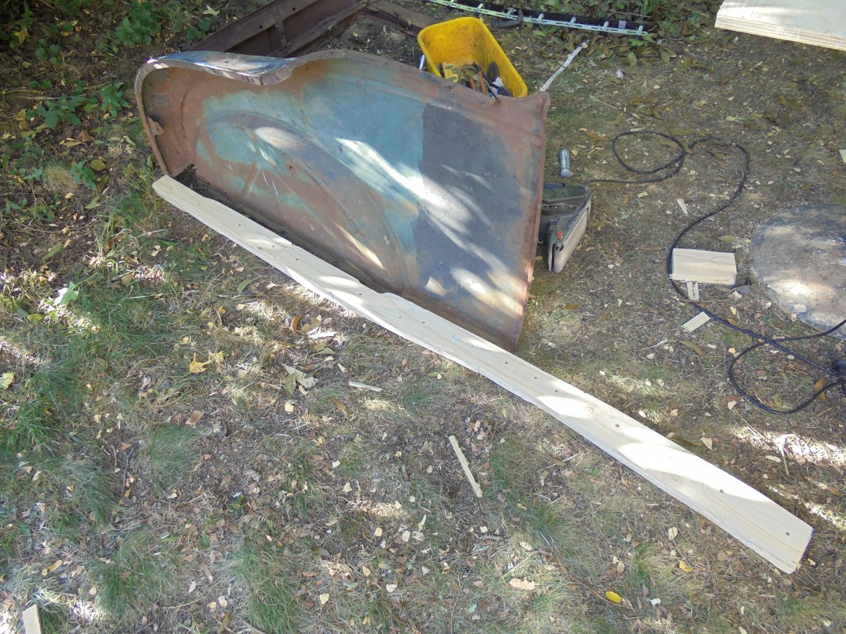

    I finally picked up the materials from my local building supplies store yesterday. I was not able to get the right sized slab that I needed so I had to make do with an off cut section. I also got two lengths of 4 x 2 hardwood lumber for some other bucks I will be making. The first thing I did this morning drag the frame out and place the sub rails on top and clamp the quarter panel over the top. DSC01262.JPG
  16. chev34ute
    Posts: 1,594
    chev34ute
    I did this so that I could get the precise measurements for the length of the sub rails.

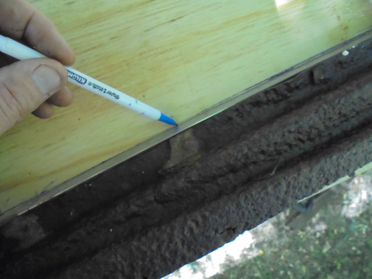

    I was out of luck in that department, so I needed to find another way to get the desired shape. What I worked out was that by placing the sub rails over the slab of ply, I could trace its outlines. DSC01273.JPG

    DSC01274.JPG I was careful to use a rule when I was doing this as there was a considerable gap between bottom of the rails and the surface of the ply.

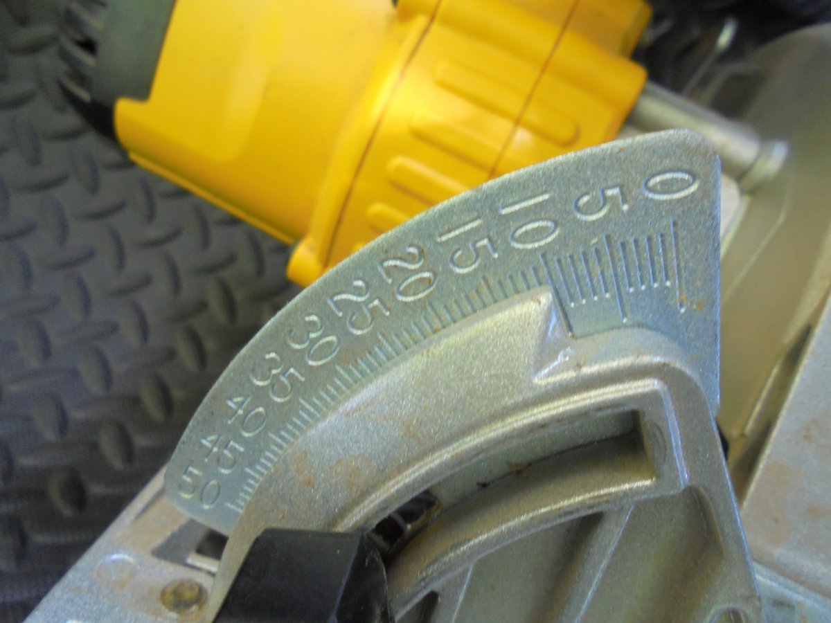

    Once I had the outline worked out I got it ready for cutting. I had to measure 20 mm in from the inside edge as the outline along here only showed the flange and not the main body. I also angled the bench saw to allow a slight angle for the cutting to allow the sheet metal to be more easily turned to 90 degrees. DSC01278.JPG DSC01276.JPG
