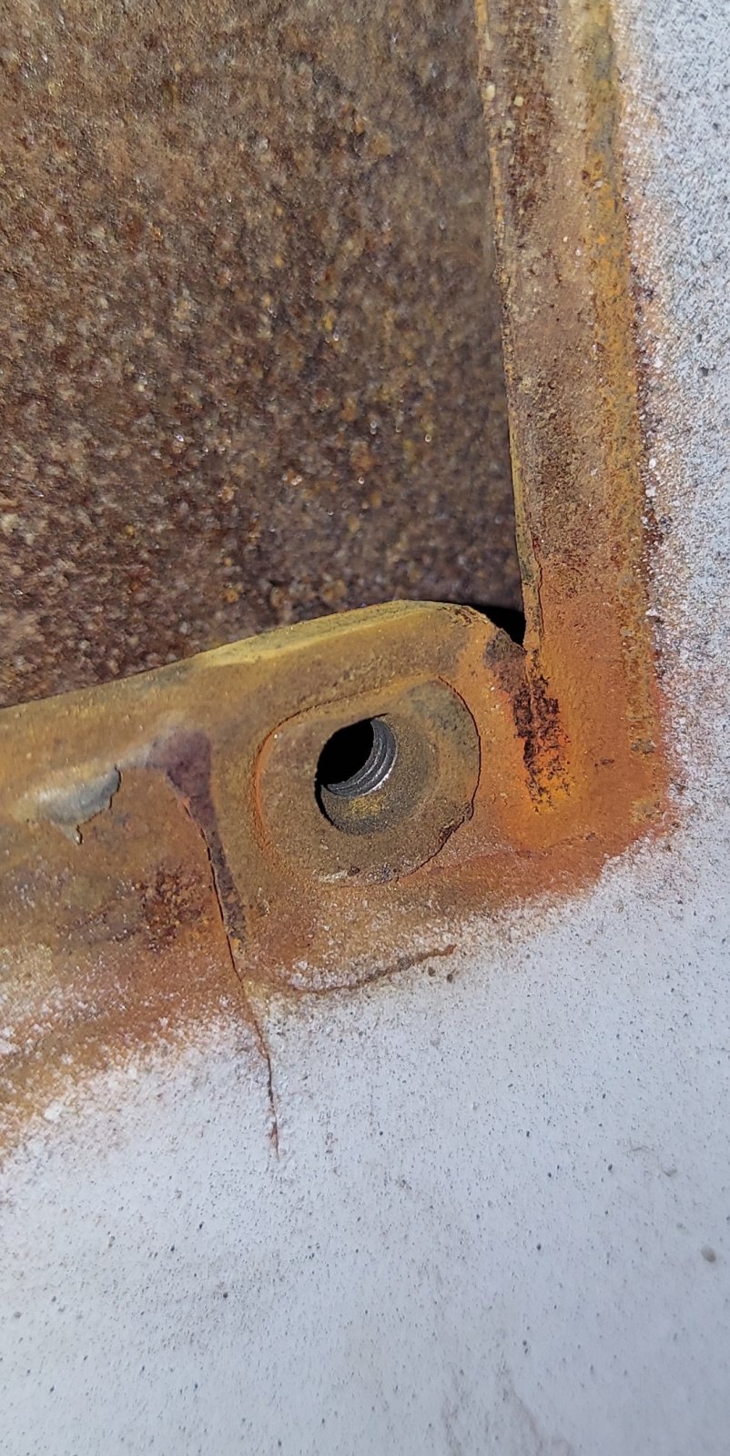

    I started looking at the driver door this evening because I noticed there was more play in it that before. It would close and latch, but would have room to move in and out. The latch inside the door had some play and moved around. One screw was missing and I found that this was stripped out and cracked.
    Does anybody know if these inserts are available anywhere or what they are actually called? I tried searching all over and I may be looking for the wrong thing if someone reproduces them. Am I also trying too hard and would it be easier to just drill and tap it for a bigger counter sunk screw? I'll address the crack the same time that I do this.

  11. ZerroHalfcup
    Joined: Dec 6, 2022
    Posts: 105
    ZerroHalfcup
    Huge thank you for sharing this, I'll get a couple ordered and take that route.

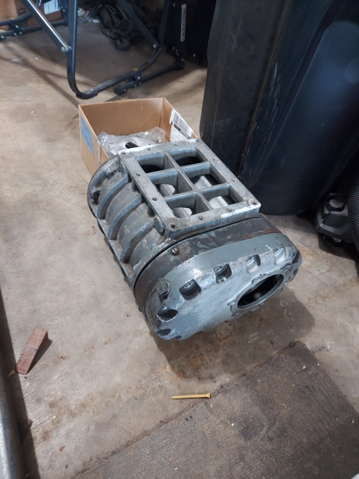

    While I'm putting a plan together to tackle the driver door latch area, I jumped at an opportunity to score some parts.
    I was able to get a mostly complete but dis***embled Mercury flathead and transmission. The story I was told is that the car was parked in the late 50's and then the engine was pulled out in the 80's. He dis***embled it, boxed it up and never touched it again. I couldn't find any cracks but I'll clean it up and really go through it.
    What I now plan to to top this mercury off with is this McCulloch blower I picked up this week. Has anyone ever seen one of these before? It is about the size of a 4-71 but I can't find anything on the internet about this. It wouldn't be the first time I've tried searching for the wrong thing but I'm open to any input.

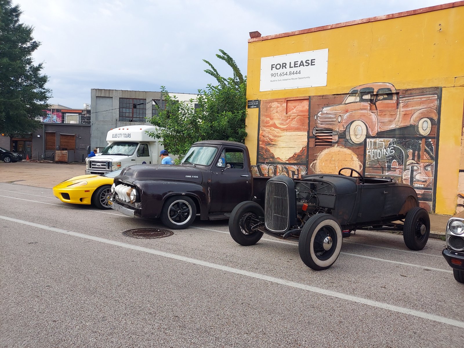

    Back in August, a friend of mine had a damaged reproduction '32 grill shell that he was letting go for dirt cheap. I also stumbled across a new 30/31 radiator for just as cheap. It wasn't ideal but I decided to get them. I would rather drive my car with too tall of a radiator for now and try to hide it with the '32 shell, than to wait for a good 28/29 radiator. A driving car is just worth so much more to me than waiting on perfection.
    After I got them on, we decided to drop by a Cars and Coffee that coming weekend. It was at the Edge museum here in Memphis, less than 100 yards from Sun Studio. It's a great automotive museum that I highly recommend to anybody coming through Memphis. On the way there that morning, I met my friend Mike at his shop and he jumped in the p***enger seat with me. We found some more friends of ours at C&C and we all had a blast. The car did great cruising around Memphis streets.

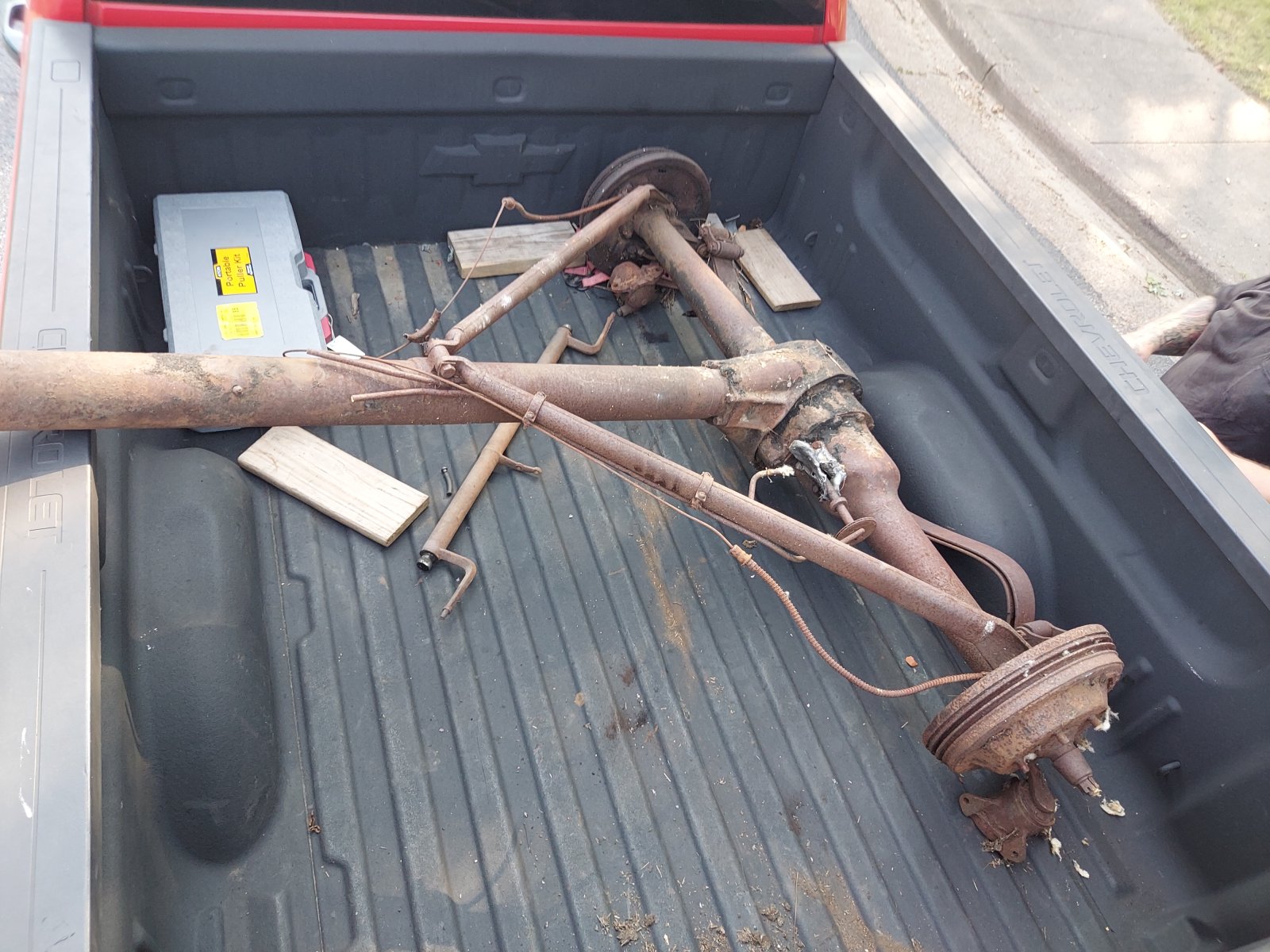

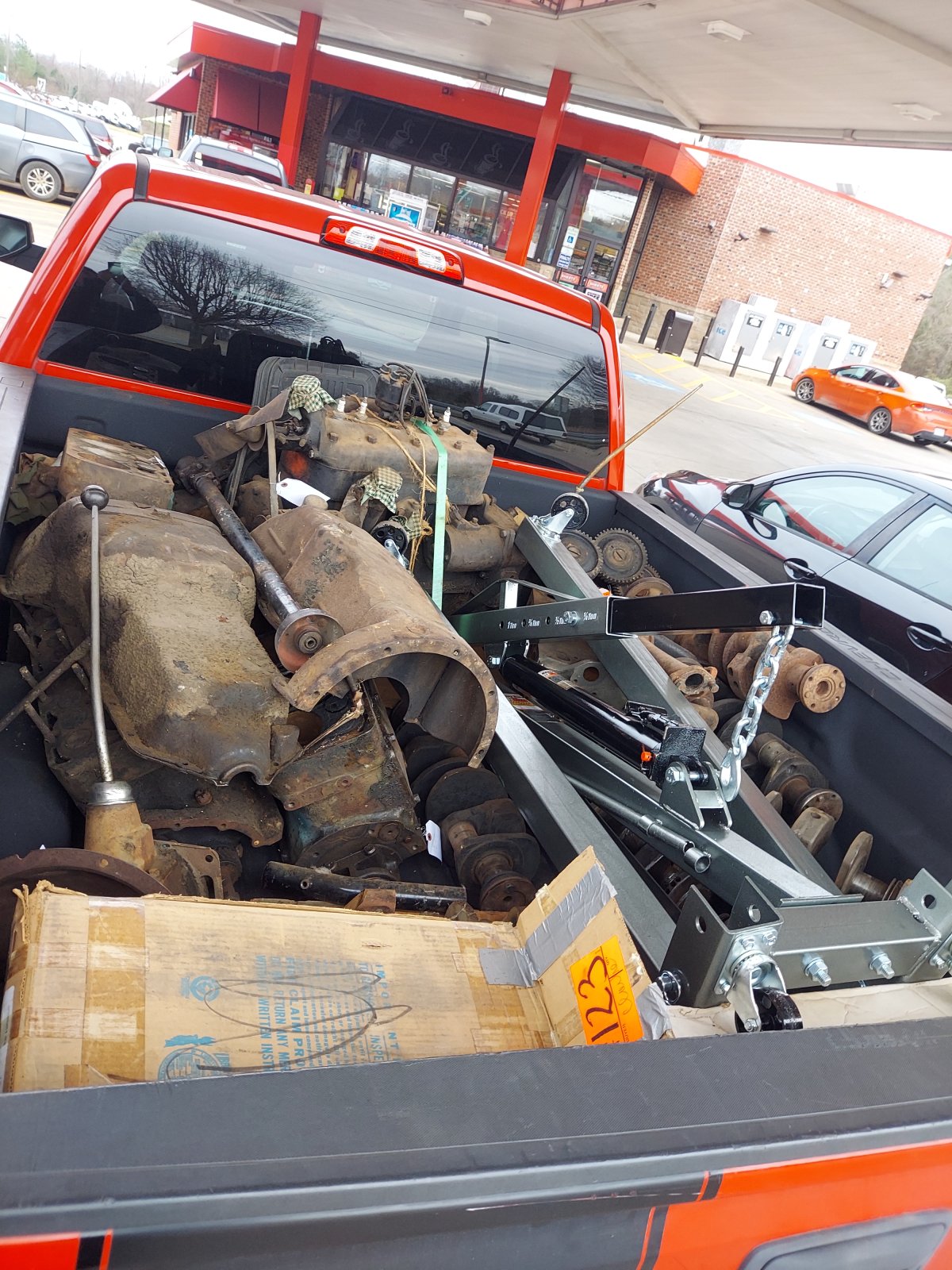

    To wrap it up, I went to an estate sale not long after and spotted this rear end laying on the ground out back. I offered $100 for and they actually took it! I know it's a Columbia from a Lincoln because of the hypoid center section, but the backing plates and adjustable shocks lead me to believe it is from a '39/'40 based on what I can gather online. If anybody knows more or can point me to some reputable resources, I'm all ears. My intention is to rebuild it and use it in my roadster just to be different.

  17. hfh
    Joined: Oct 22, 2012
    Posts: 512
    hfh
    from Western MA

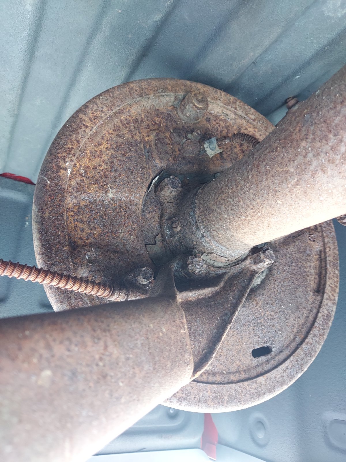

    Thanks for sharing the great pictures! The Columbia axle will be very nice but be sure to learn about internal reinforcements, etc.

  19. ZerroHalfcup
    Joined: Dec 6, 2022
    Posts: 105
    ZerroHalfcup
    You absolutely nailed it, I've been missing out all this time.
    Thank you! I'm eager to dig in and learn about it.
    Note taken, I've been searching through here and other parts of the internet to learn what I can before I start digging into it. Thank you for the heads up.
    Thank you! I can promise you there will be no shortage of fun.

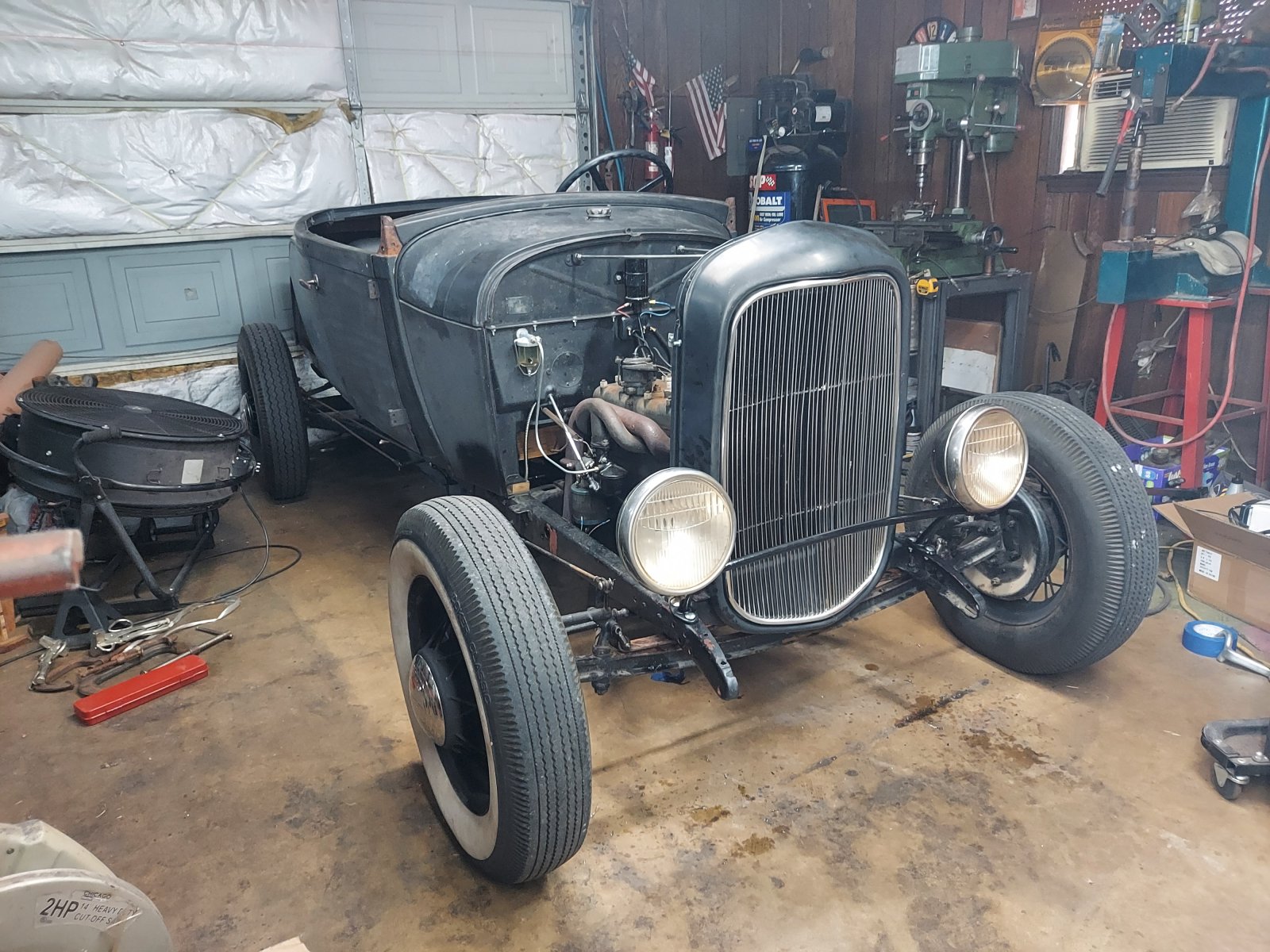

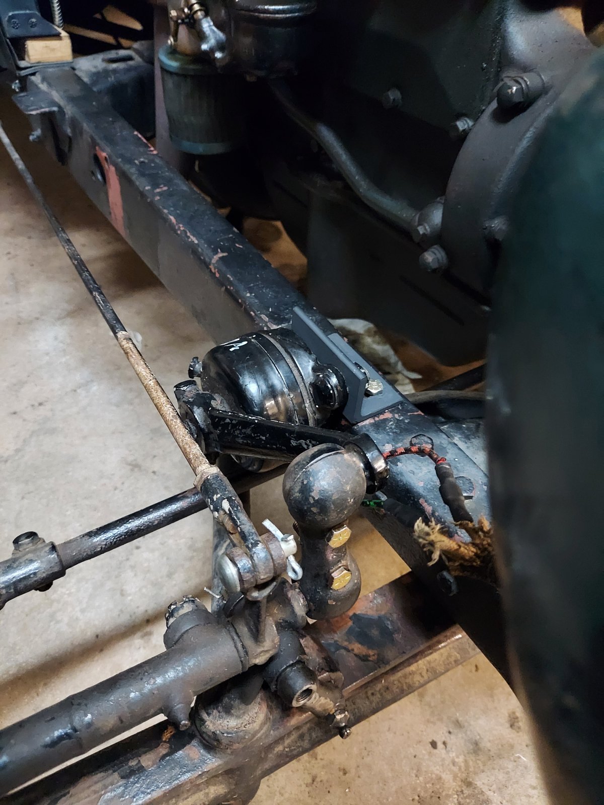

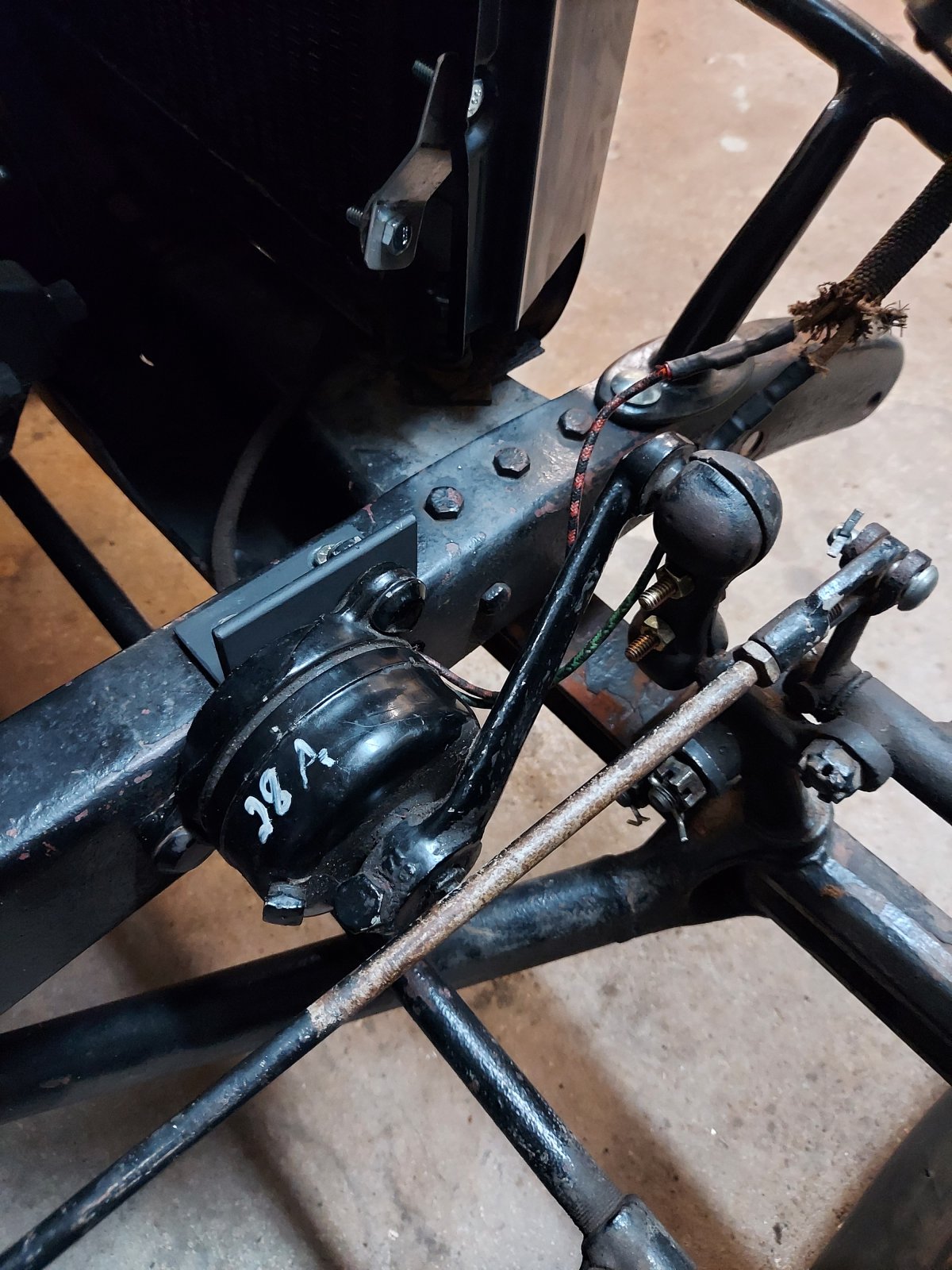

    After the Georgia trip, I finally installed some front shocks. In order to make it work right, I had to clock the shock upwards and make a bracket for it to bolt to. It's a bit crude but it works well. The shackle that looks horribly abused will be addressed too.

    I am having to do a similar shock rotation on my current build, but found with these shorty shock links, I was able to keep both bolt holes in the frame. Just a thought.
    Outback, Okie Pete, 303racer and 3 others like this.

    Thank you! I really like how you have that set up, I'll have to find me some shorty links as well.

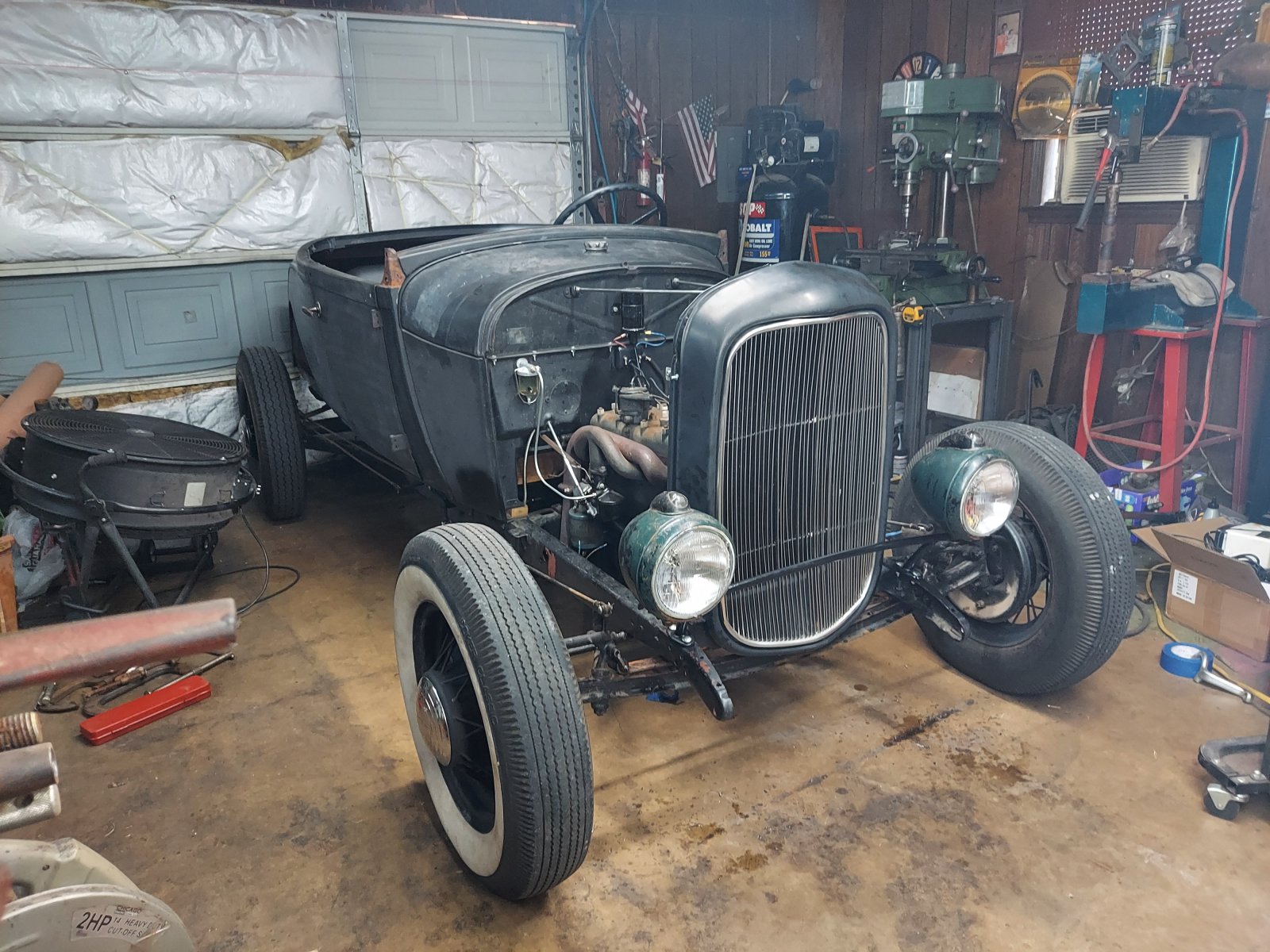

    I realized after that I never shared pictures of the headlight process. Unfortunately, I didn't get any pictures of us making the headlight bar. My friend and I cut up a '30-'31 headlight bar and mounted it to some existing holes on the frame. He is a bit of a headlight hoarder so we tried out a few different ones to see what looks best.
    Ultimately, the Guide's were the lights that stuck.
