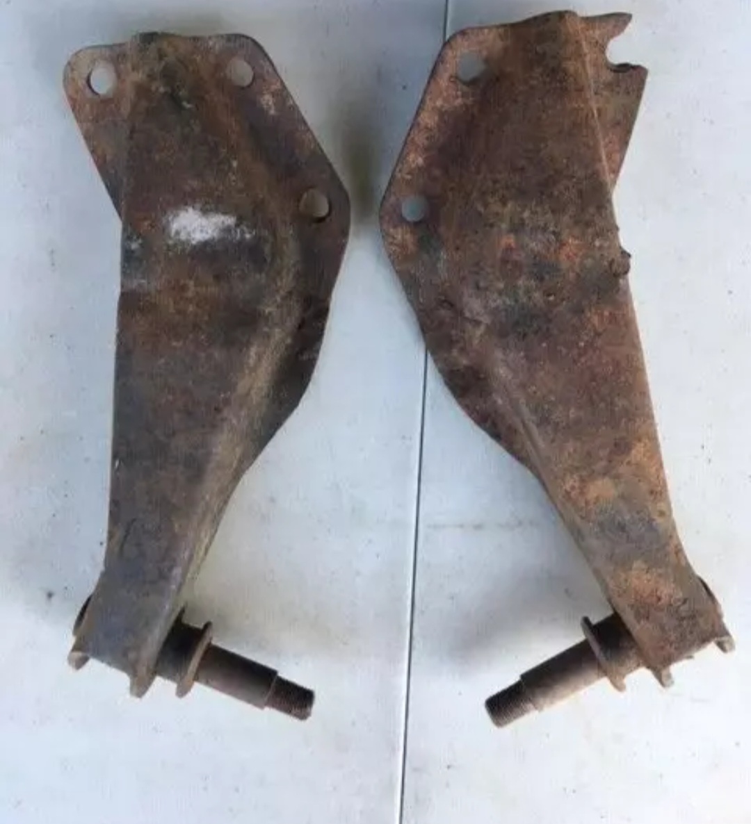

    I've wanted to put better shocks on my car for a while now, I just couldn't figure out how I wanted to do it. I was looking over cars on here and digging through old photos when I remembered this article from Rod & Custom.
    These were, and one still is, a couple Memphis cars from the July '54 issue. The front shock/headlight mounts on the coupe made me start digging around on ebay. I ended up buying some shock brackets that I thought I could make work. These were advertised as '46-'48 Ford aftermarket shock brackets. It's hard to tell from this photo that I stole from the ebay ad, because I forgot to take my own pictures, but they were previously cut and rewelded.
    After more digging, I found that shocks from a '46-'48 Plymouth should fit pretty well and give me 4-1/8" of total travel. I ordered a pair of Monroe reproduction shocks and grabbed a couple universal shock studs. I jumped right into it and completely forgot to take pictures until we were welding them in last night. It's blurry in this photo but the stud is mounted to the rear crossmember.
    This is the end result. I'm pretty happy with how it looks but I'll be able to road test it this weekend and see how they work.

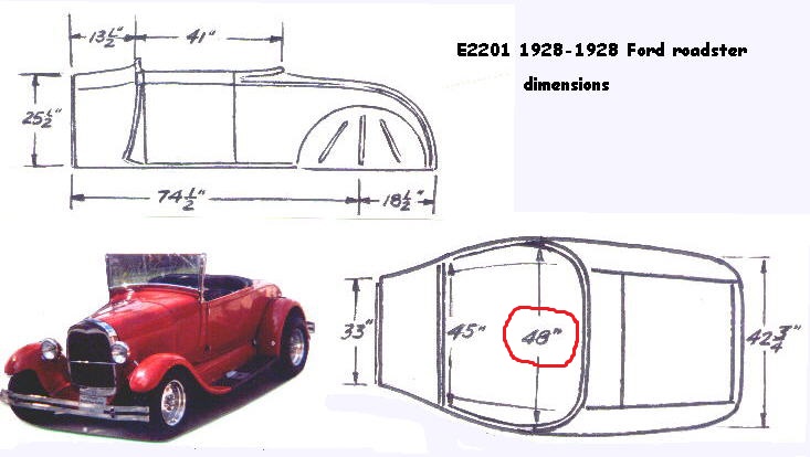

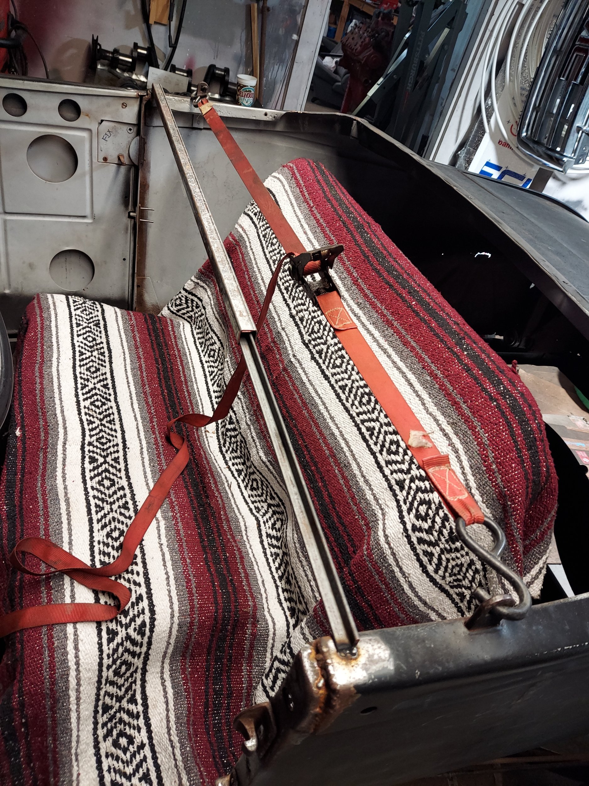

    It is long overdue but I started correcting a lot of issues with the body. I have never been able to get the doors to fit how I would like, so I started looking for body dimensions. Everything seemed to be where it should be except for the top of the quarter panels, right behind the doors.
    If it is supposed to be 48", mine sits at 48-5/8". That extra 5/8" really makes the door gap open up towards the bottom of the body. I believe the brace at the bottom that connects the quarters to the subrails is bowed out. They are both pretty pitted and one has a rust hole so I'll be replacing those to bring it back to 48".
    After removing all of the wood, I was able to use a ratchet strap to pull the quarter panels in. I thought I had a long enough piece of tubing but I had to piece two together. This seemed to work pretty well because I was able to slide the angle piece into the box tubing, tack them on both ends and fine tune the distance between the quarter panels. Once I was happy with where it sat, I tacked the two pieces together.
    I got it as close to 48" as I could and the door gap is so much better than before. I had to call it a night at this point because I was out of tubing, but I'll be adding some horizontal bracing at the bottom of the quarters, as well as a diagonal piece.

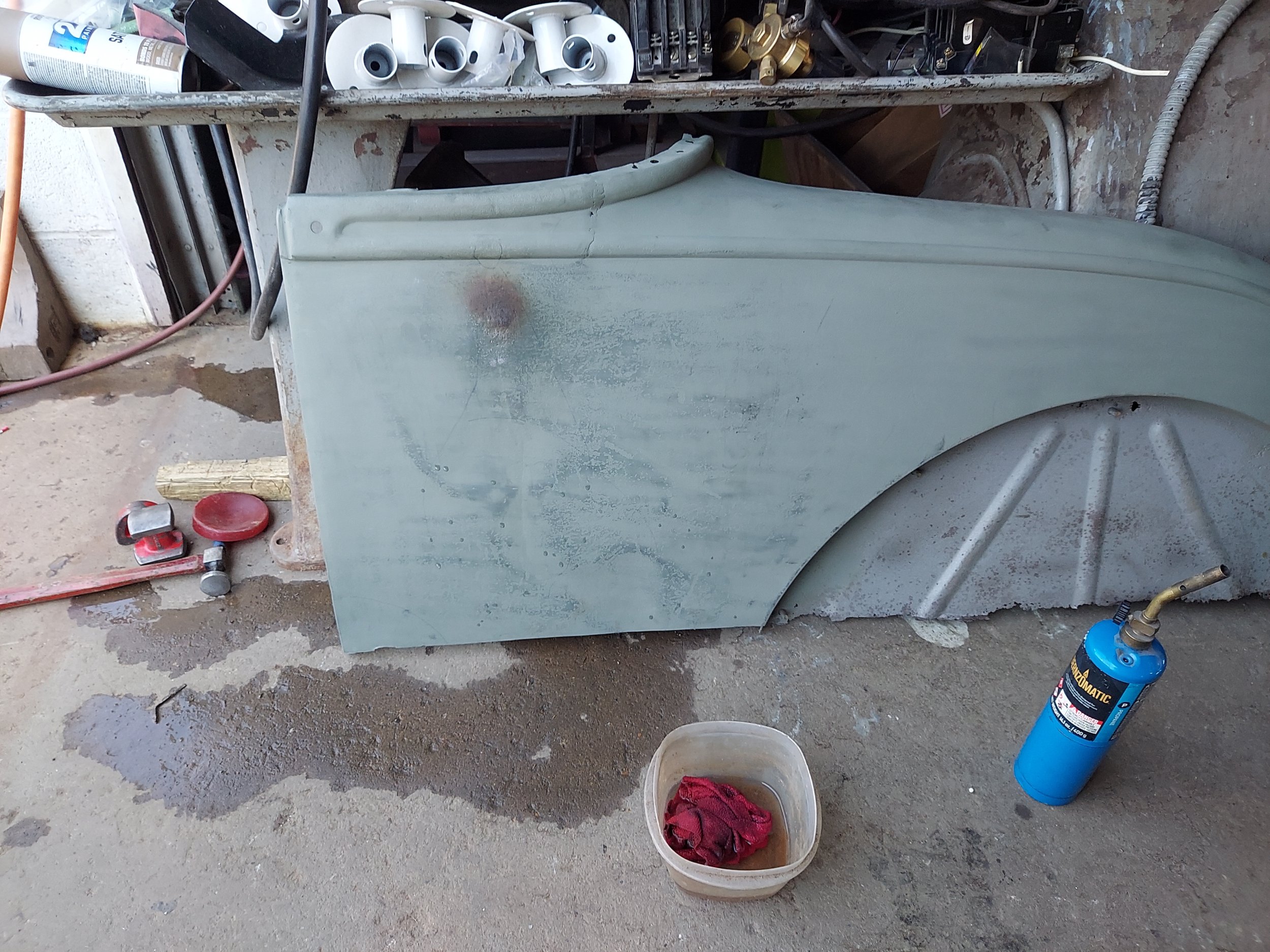

    I started with the driver side quarter panel. This was the worst and had already been cut on, cracks welded and somehow creased.
    I knew the bottom of it was rotted out but I got it media blasted just to get a full picture of the condition. If you ignore all of the flaws, it was in fantastic shape. After comparing the price of a new quarter panel to a set of body hammers, I decided to try to metal work and straighten this out mostly myself.
    My friend does metal shaping and custom metal work for a living so after some guidance from him, I took my best swing at it.
    We tried heating and soaking this high spot below to get it to shrink.
    More heating, shrinking and hammering to get it to this point below. I still have a lot to learn and it still has a ways to go but progress is still progress.
