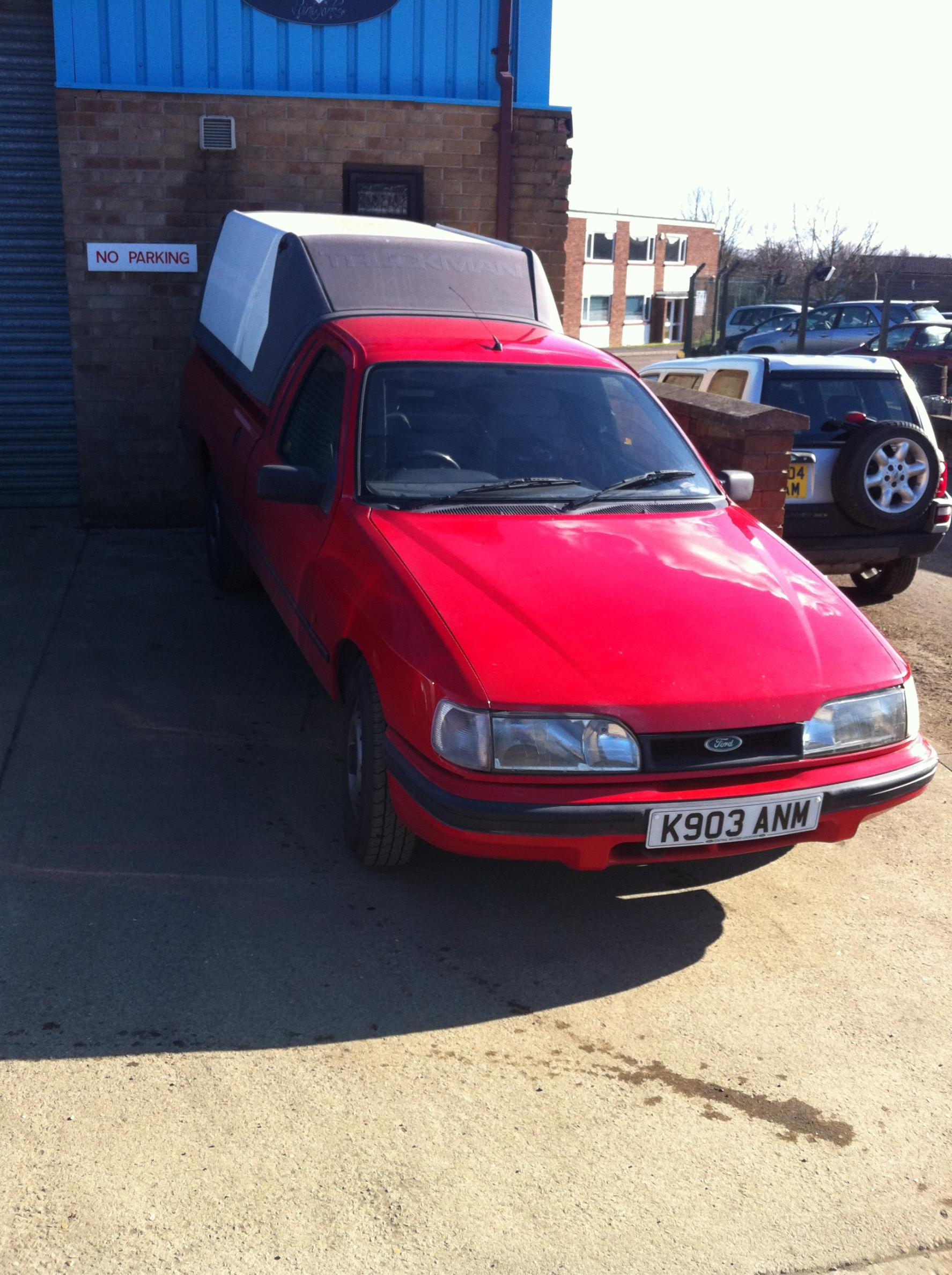

    I have to ask again the Diesel engine is out of a what ? Looks a neat fit in the A model ch***is.

    Its out of a ford P100 pickup truck. This one to be precise ! ImageUploadedByTJJ1344331112.573542.jpg

    OK, I recall you showing photos of a P100 earlier and I have to say they must be an English thing as I have not seen them before.

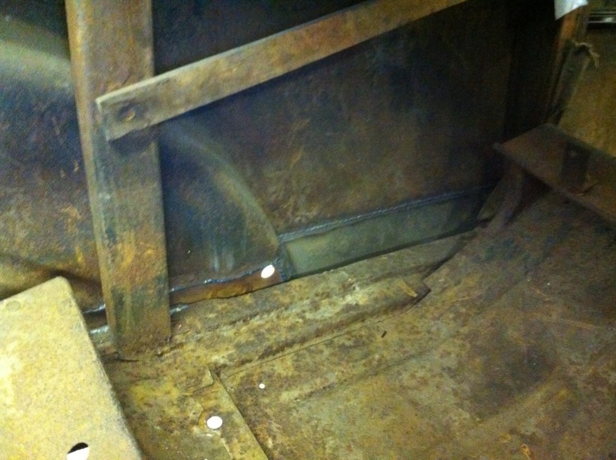

    Just got back from drag racing in hockenheim .. Soo havent updated in a while. This is the stage the body's in at the moment. All the patches welded/ chemical metal'ed and just waiting for a coat of mixed satin/gloss black to blend them to the original paint Patches dont look that bad from
    The inside so i think ill leave them that way !
