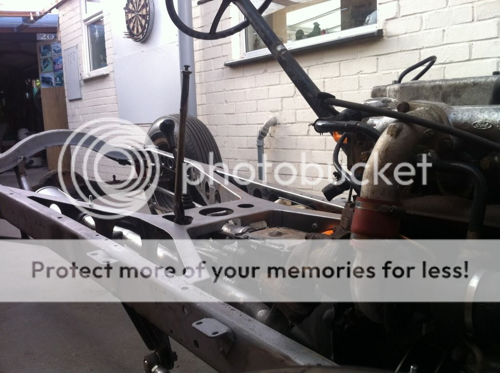

    As hotfr8 asked heres some Pictures of the engine .. I know its a mess right now. It sits literally as i pulled it out of the P100.... im gonna freshen it up an repaint it with the chassis an everything

    Thank you, it looks like it is meant to be there. The 4 banger Diesel suits it.

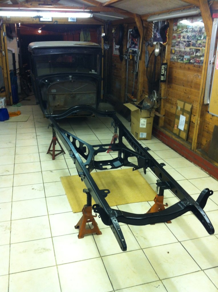

    Well the chassis has been given a fresh coat of black ... Luckily With dad owning his own paintshop .. I can get a little technical with the painting without breaking the budget .. Soo for the frame. Ive chose a mix of matte/satin black. And then all the "attachments" will be gloss black to add a little bit of a contrast to the solid black underneath the car

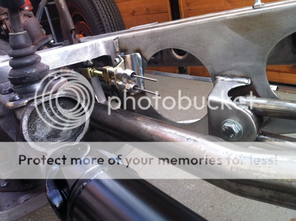

    The day has arrived !! Time to actually start putting the chassis together permenantly Started off the build by installing the ladder bars and brake master cylinder ImageUploadedByTJJ1349209559.772006.jpg ImageUploadedByTJJ1349209587.138809.jpg

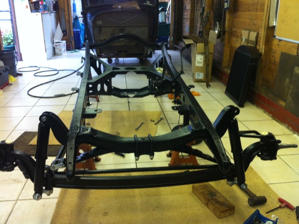

    Spent the day installing the front beam, leaf spring, shocks, wheel hubs split wishbones. Pretty much a lot of the front end ! ImageUploadedByTJJ1349624317.951998.jpg ImageUploadedByTJJ1349624347.662854.jpg ImageUploadedByTJJ1349624378.179231.jpg

    Installed all the disk brakes calipers ect .. The whole front end is now installed apart from things like plumbing the brakes ... Should have the back axle in later on tonight !

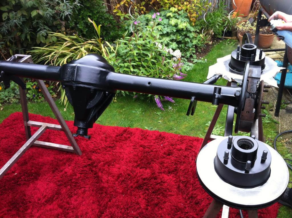

    Weve now installed the rear axle in the car after a tonne an tonne of work trying to get the rear leaf spring back on Ill get some better photos tonight once i get home ! ImageUploadedByTJJ1352975330.164219.jpg

    ImageUploadedByTJJ1352975679.796929.jpg From that one for anyone whos wondeing
