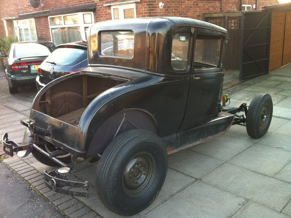

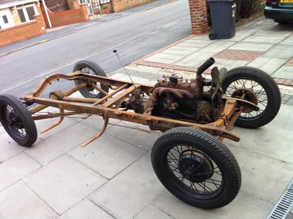

    Cheers joe ... Heres a few more pictures as it stands now ... The first ones are of what happened to the paint on my axle ... We sprayed it with rattle can .. But was running low on matte black .. So we did the first coat in gloss and then added a top coat of matte. But for some reason the paints reacted an gone all cracked style .. I personally like it myself. ImageUploadedByTJJ1353137396.794290.jpg ImageUploadedByTJJ1353137413.495111.jpg ImageUploadedByTJJ1353137423.912138.jpg ImageUploadedByTJJ1353137434.079006.jpg ImageUploadedByTJJ1353137447.112837.jpg ImageUploadedByTJJ1353137458.029635.jpg

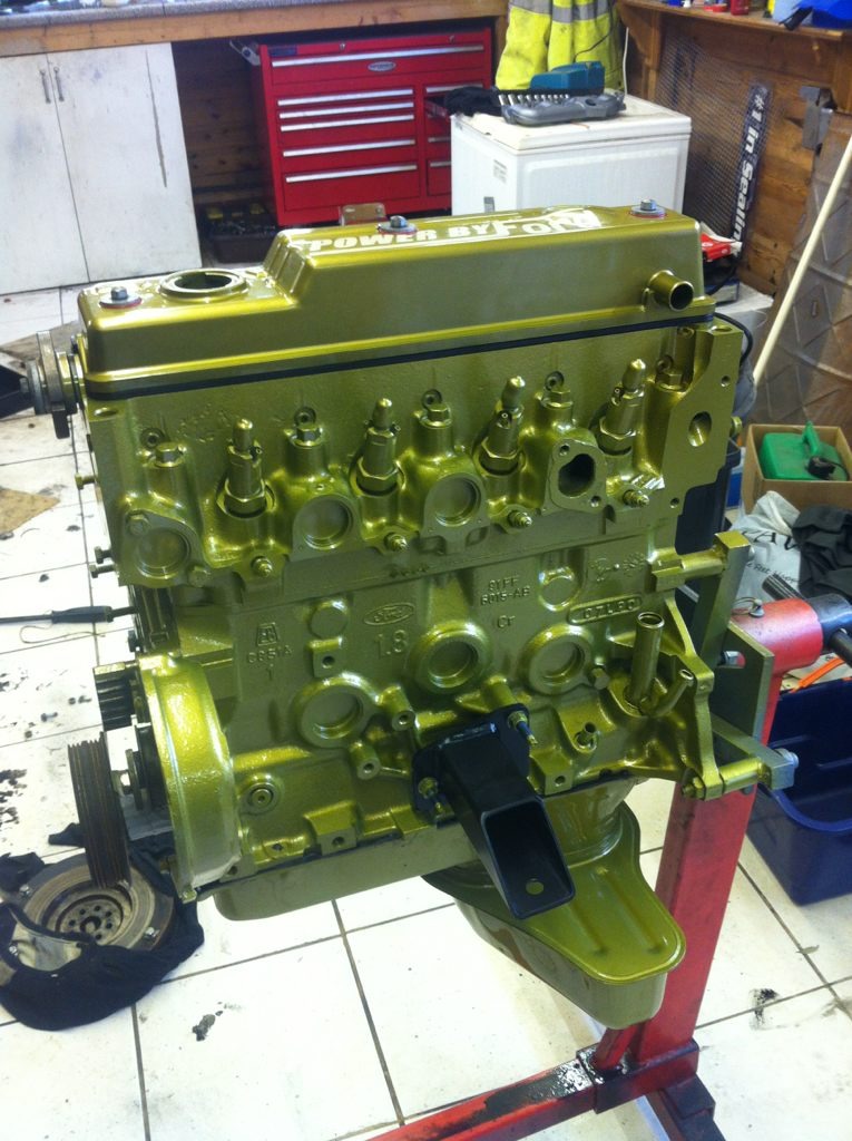

    Back to the A though .. As i said progress has been slow because of the toponlino .. But weve managed to strip the engine an get a colour chosen .. Kind of a metallic green/ gold colour to go with the army canvas on my seat ImageUploadedByTJJ1355480912.081342.jpg

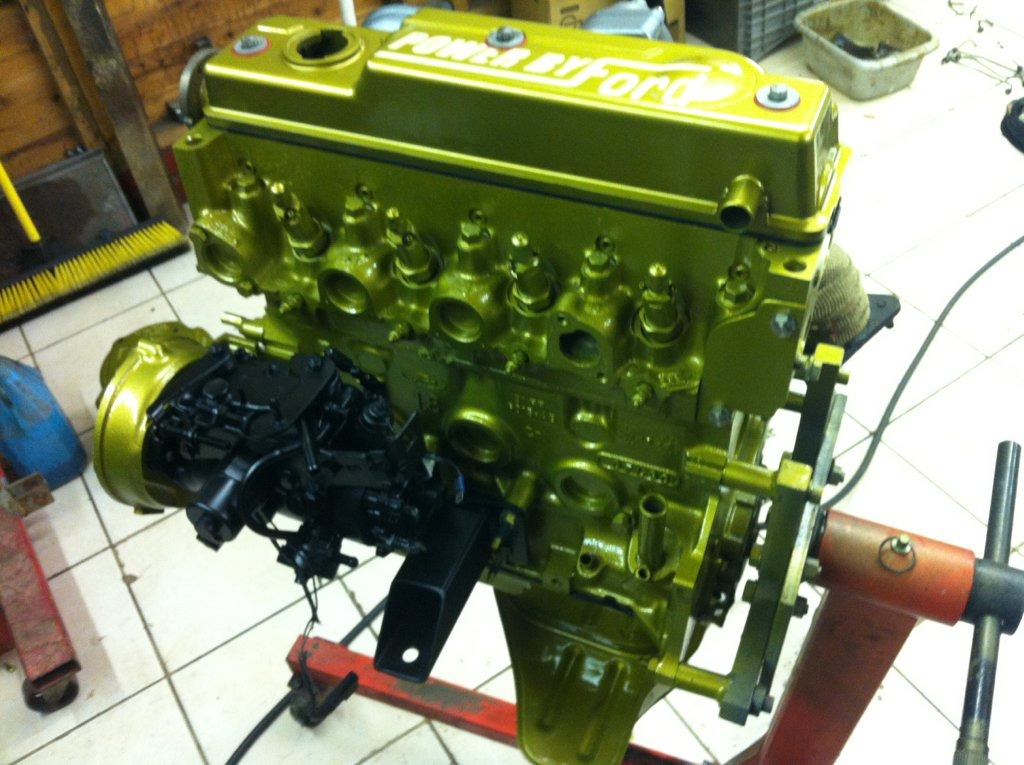

    Its been a while because of christmas an everything .. But i think after this weekend .. The engine'll be ready to go back in the ch***is ... Thats the plan anyways ... Heres a few general engine build up pics ... I decided to wrap the header because it was looking pretty run down with some ****py welds in places ! ImageUploadedByTJJ1356801193.180271.jpg

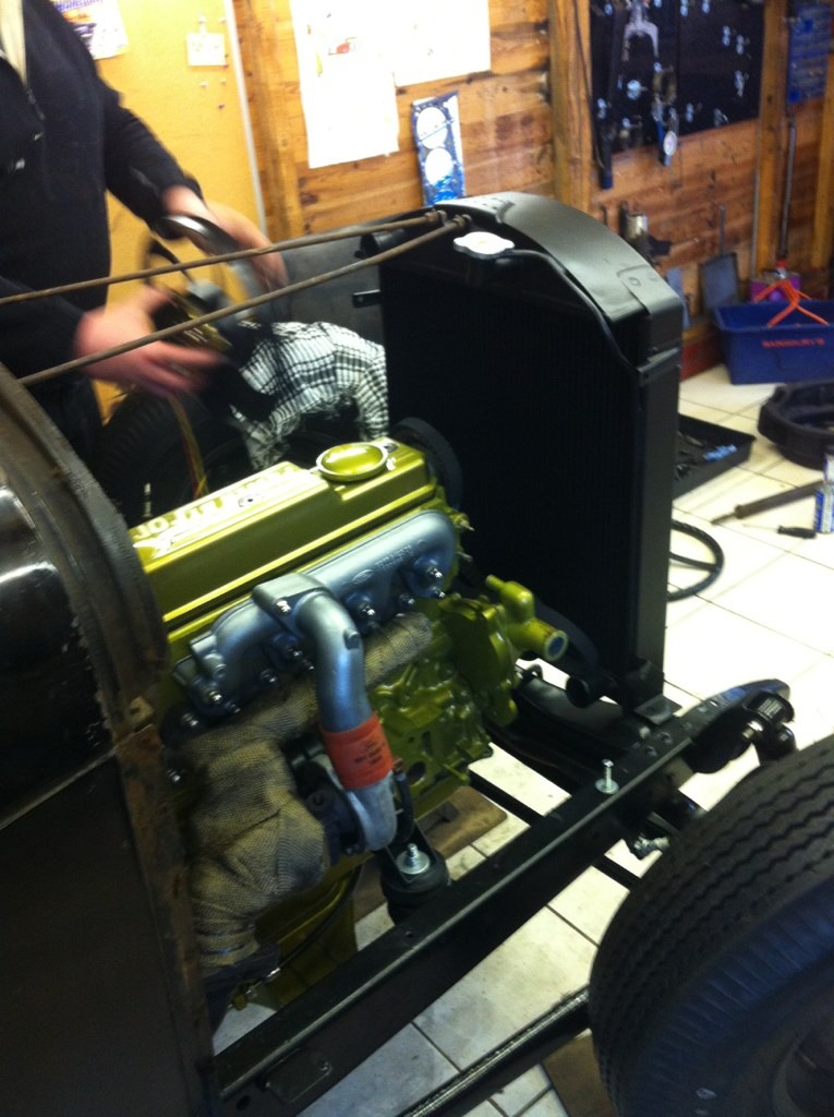

    Theres what the engine looks like in daylight .. Looks a lot more toned down than the pics taken under the garage lights ... Today we've managed to fibish the engine an gearbox .. An its ready to mount in the frame tomorrow morning !

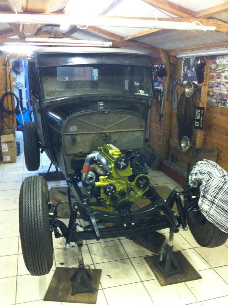

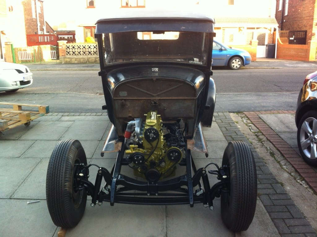

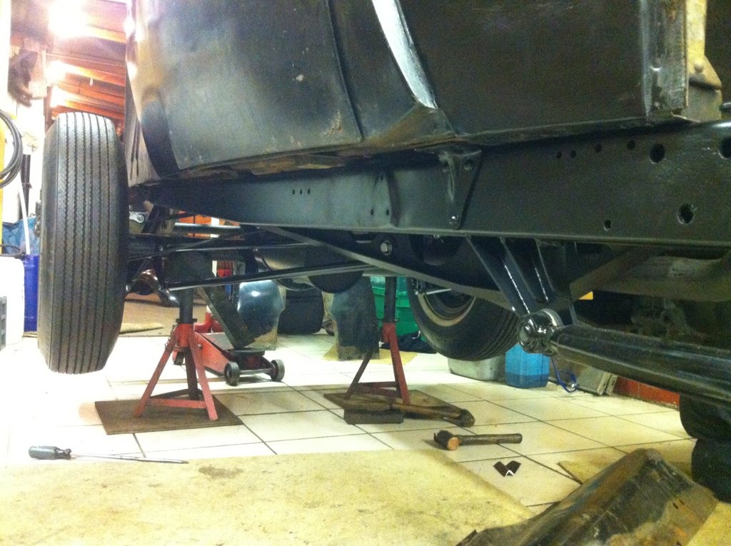

    Finally got the engine in ch***is ! Exhaust's mounted .. Brake pipes are all fitted an installed. Aswell as the handbrake ! Hopefully soon after we've cleaned up all the underside of the body. Ideally next weekend we'll be ready to mount the body on the frame ! ImageUploadedByTJJ1357122719.567791.jpg

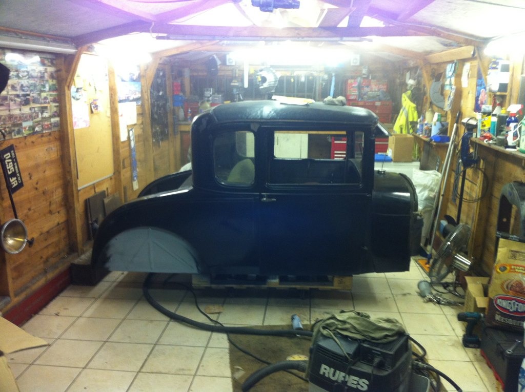

    Its took over a year already. An a lotta work an effort ... But we finally got the body on today ! The ch***is has come on such a long way since we first took it off the car ! An ive loved every minuite ! Another milestone crossed ! ImageUploadedByTJJ1357404910.097815.jpg ImageUploadedByTJJ1357404955.523250.jpg

    ImageUploadedByTJJ1357682417.982462.jpg ImageUploadedByTJJ1357682519.499047.jpg

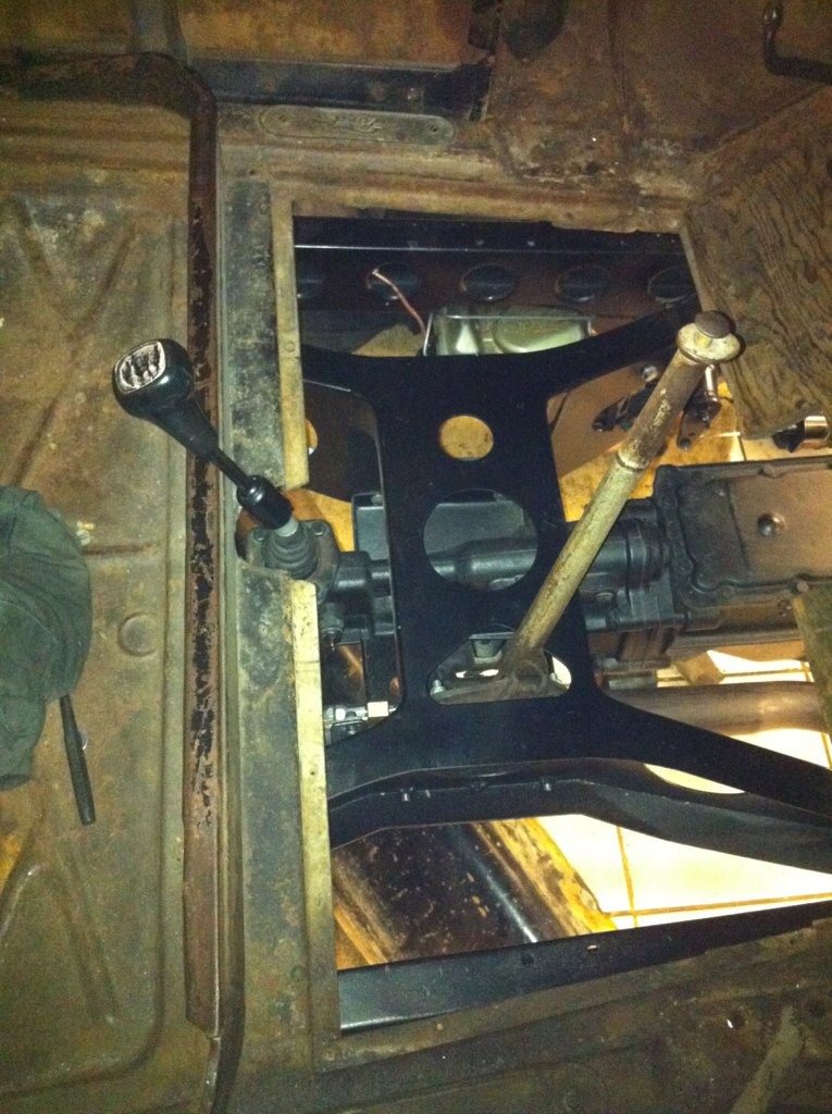

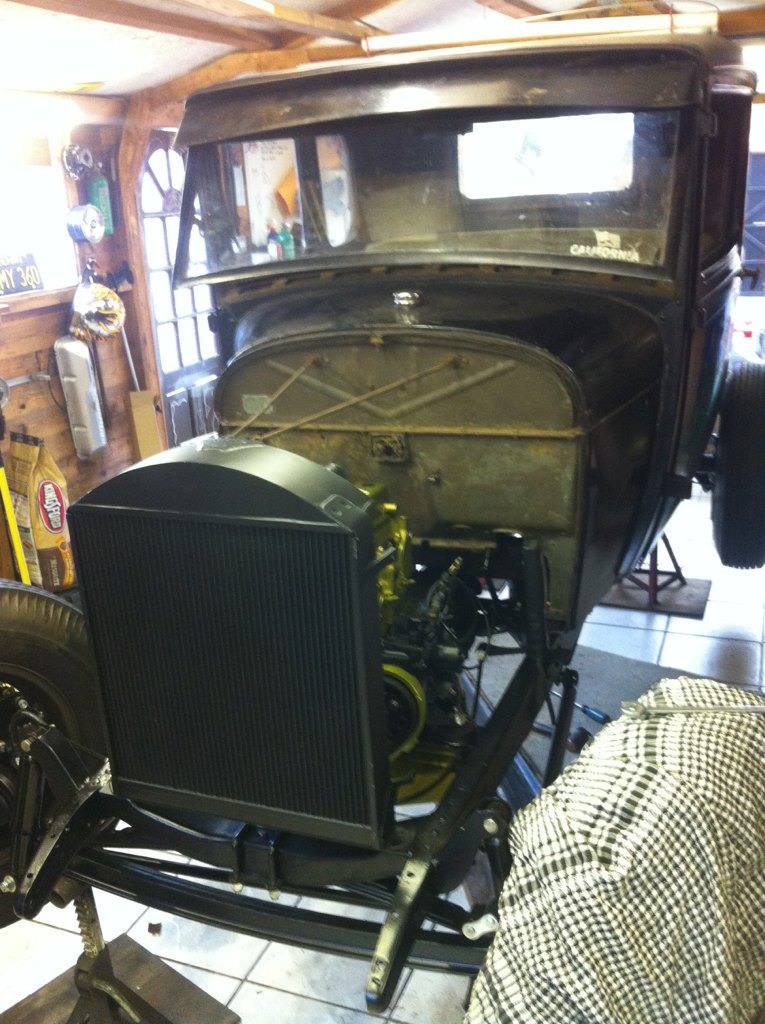

    Got the car in the garage an test fitted the rad for engine clearence ... Fits pretty good really ! Makes the engine look tiny ! ... An also cut a space in the floor for the shifter to come out ... Not really sure how im gonna work the leaverage on the shifter ? ... A longer stick means more travel space needed ... It already moves too much :/ ??

    Check out the shifter on the post jive-bomber did today.
    http://www.jalopyjournal.com/forum/showthread.php?t=766629
    there's a trick shifter extension the guy built.
    Yours would be the opposite way,
    but the same idea.

    Actually ... Thats not a bad idea ! Cheers for that ! Ill definetly look into it !

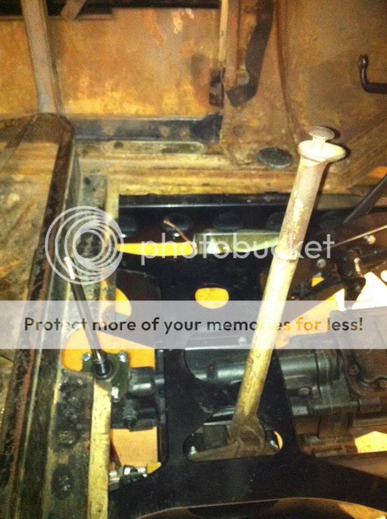

    The the only problem i can see is getting reverse .. As you have to push the whole shifter down into the casing for it to be able to move to the left ? But there might be a way round it ?

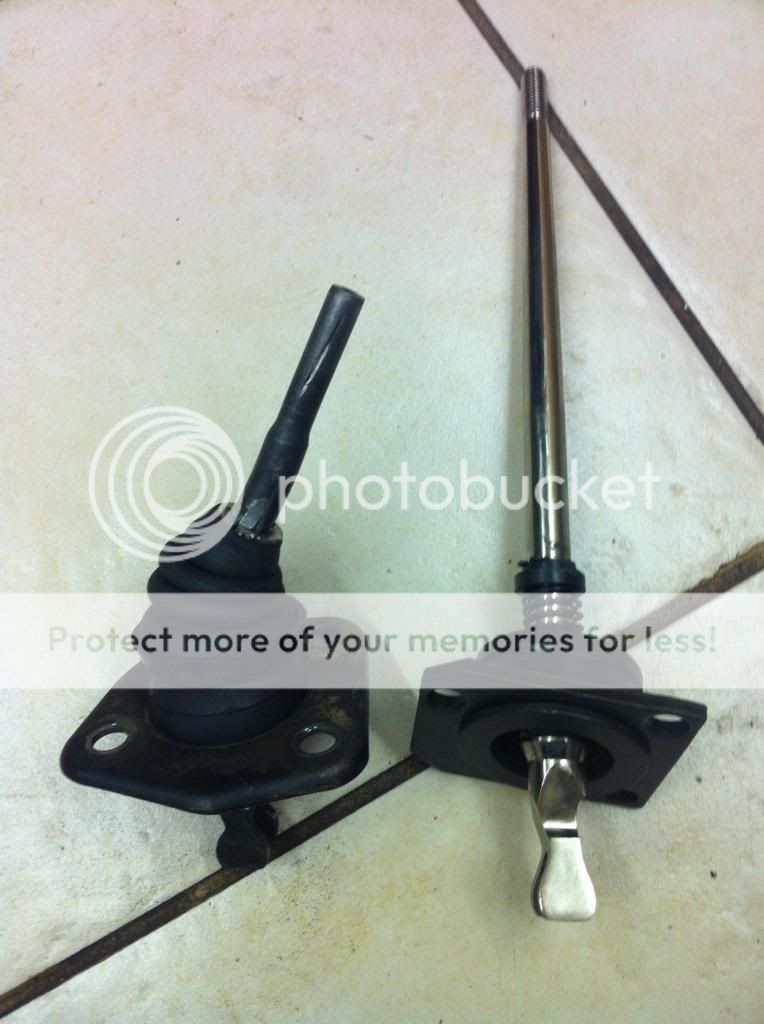

    after whats felt like a million hours of messing about !! we've finally sorted out the obstacles in the way of letting us progress with other things .. we've got a smaller alternator because there was no way the original one would fit in the opening for it ... the only thing that fitted easily was a 40 amp one thats designed for plant machinery of all things !! .. as it shows ... a smaller one was definetly needed !!
    and then the shifter ! .. i always said it had problems with being really sloppy an near enough impossible to get into reverse .. well we found the issue
    the like saddle part on the bottom of the gear lever had pretty much worn its way through the shaft ! ... so we've replaced that with a br*** saddle that shouldnt do the same [​IMG]
    also took a even further step and bought a whole new short shift gear lever aswell just to counteract the leaverage of the longer stick it'll have
    im over the moon with how just the new stick and selector shaft end has transformed the whole gearbox ! changing gear is hardly any effort *easily done with just a little finger... and everything just sounds like it clicks together like reloading a rifle or something ! before all that i got stuck in the middle of the street for about 10 minuites sideways doing a 3 point turn because i couldnt get it into reverse !!
