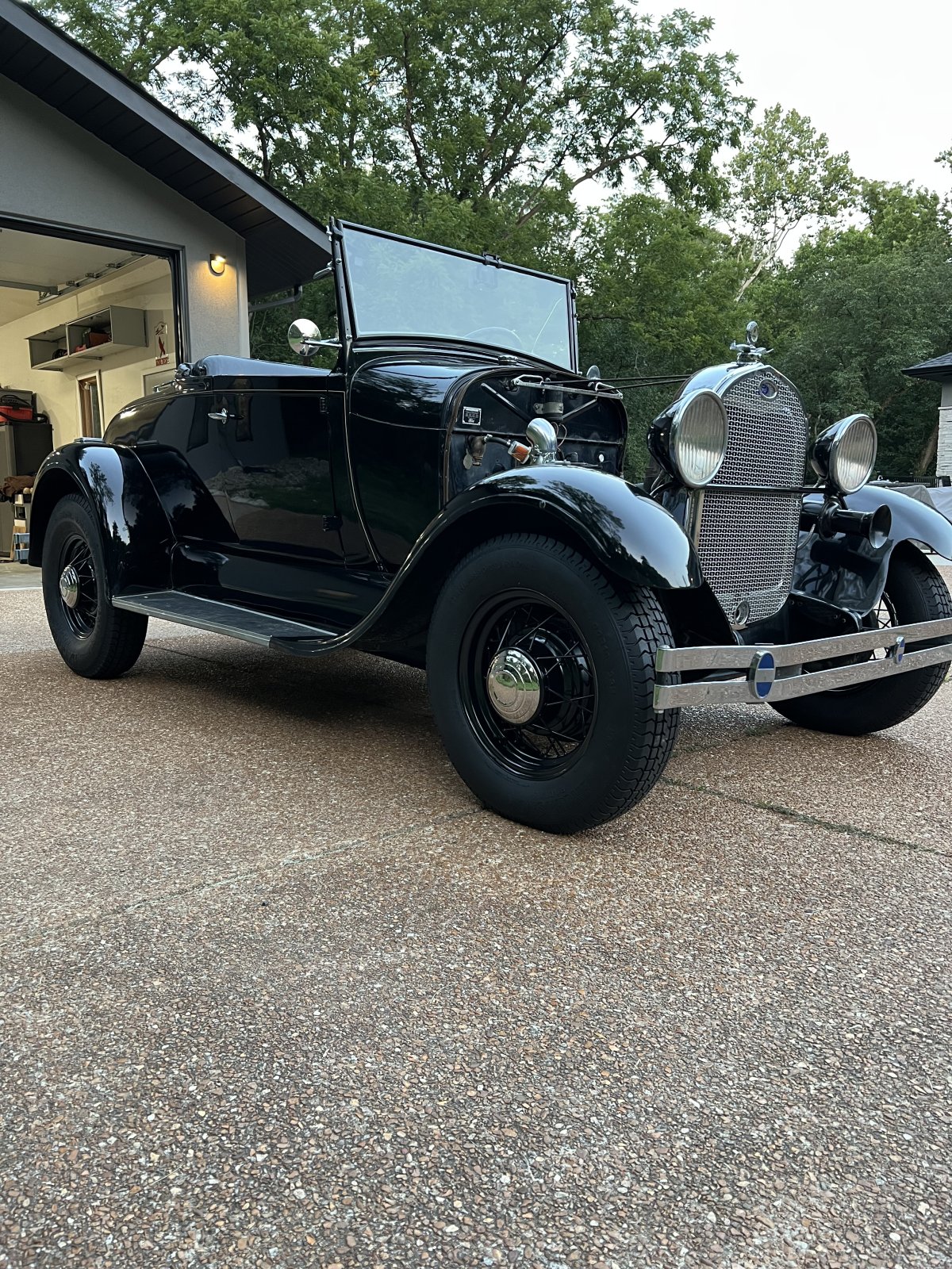

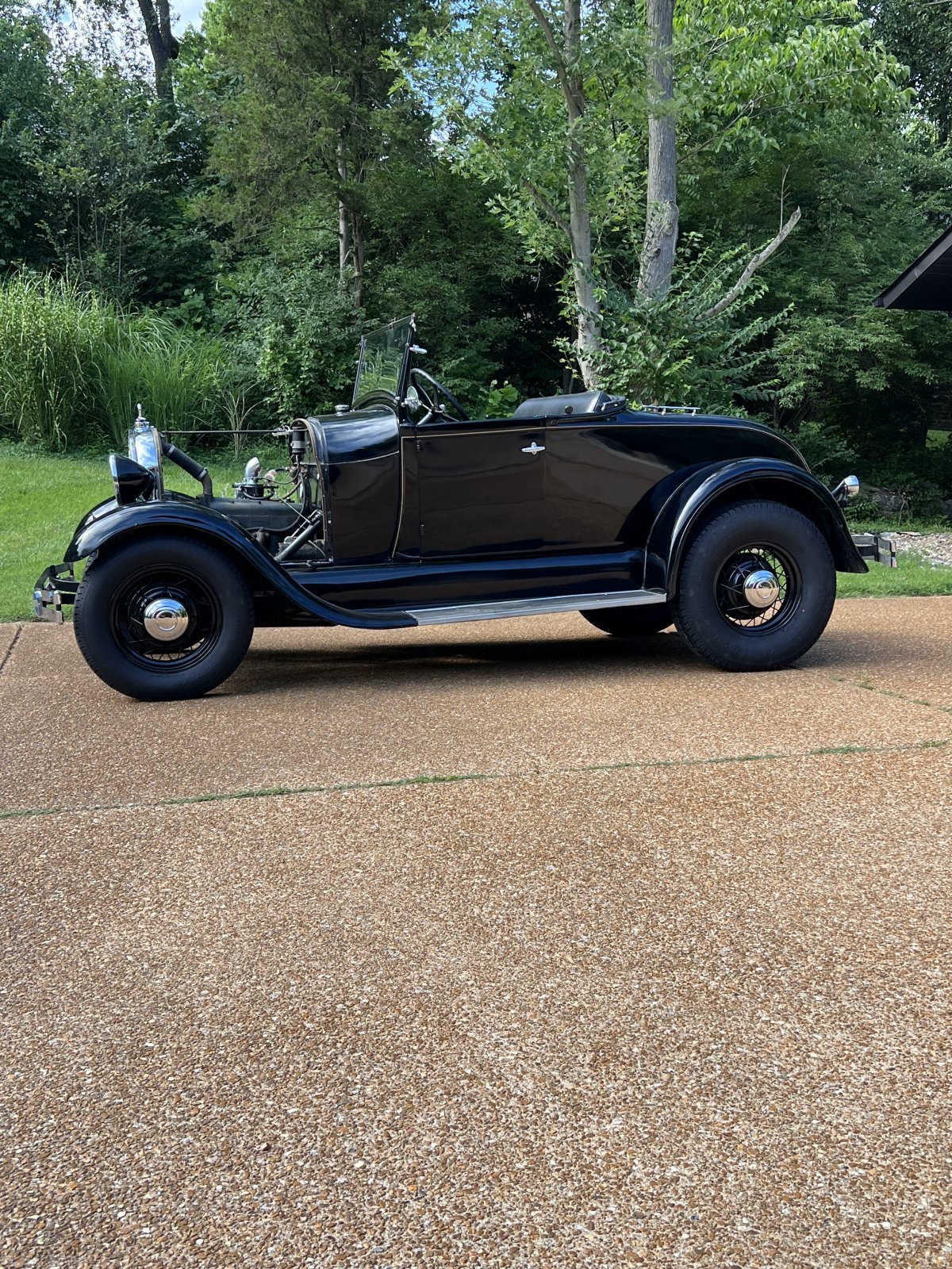

    46AA8DE1-E613-454F-9DD3-A3E42C2E7323.jpeg E493AE99-2E1E-4968-9F87-B5034E72C2DE.jpeg Thanks for the nice comments. The body is in really good shape and pretty complete car. I got the taillight working. I have one headlight working so fixing that. Changed all fluids, ****** was nasty black syrup. Brakes need to be gone through.

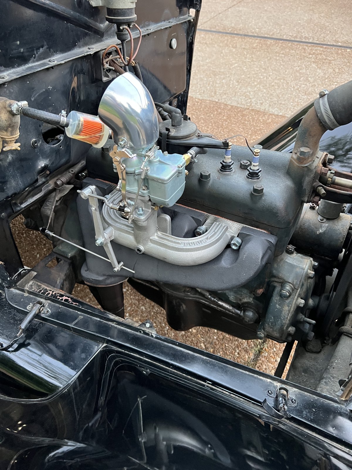

    8FE69483-FD3B-473E-A961-81BFF27502B2.jpeg DD3027DA-B8BC-4FFF-8A1D-E3DE93E28B50.jpeg Converted to 12volt and FSI electronic ignition. I was up until midnight but all went well I need to re index oil pump to change plug wire routing. she fires right. Also put modern shocks on front. Stil need todo rears. Need hun puller. Getting things sorted out. Made a grocery run and made it home!

    Is that intake and exhaust manifold the ones sold by Red’s Headers? Looks like they fit well together.

    That is a beautiful '29, congratulations. You could correct the shock angle by moving the axle clamp to the front side and redoing the top mount to the front. The shock angle would be vastly improved and the shock would function better. But all in all that is a great A Model.

    Fogger, you mean turning bottom mount around and the top stud put toward the front. If so, I will give it a try hopefully would clear the leaf spring.

    Yes, place the clamp for the lower shock mount on the front of the axle between the spring perch and the kingpin. Then move the top mount forward on the frame in a position to clear the spring and axle. An angle of 20 degrees will work very well for the shock. Again a beautiful '29 you'll have a great time driving it.

    It may be tight with the brake rod if he moves the bottom of the shock out toward the kingpin. May have to move the top of the shock outward as well to clear it.
