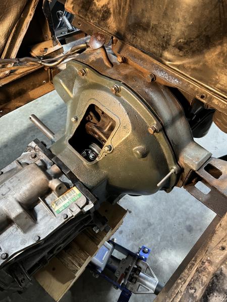

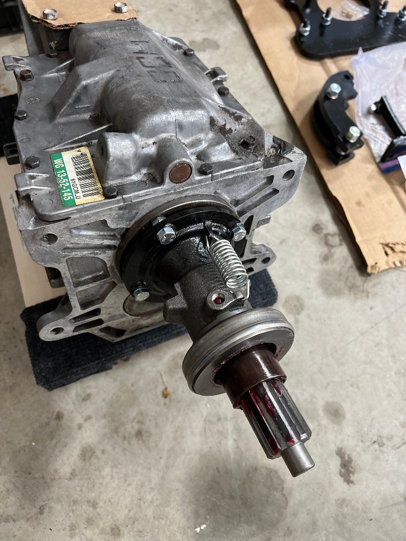

    I received the kit for 5 speed conversion. Doing some prep work and preparing myself to start on the swap.

    Is this for open driveline then?
    Shoot a picture of the numbers on the tag if you don't already know the gear ratios I can look them up

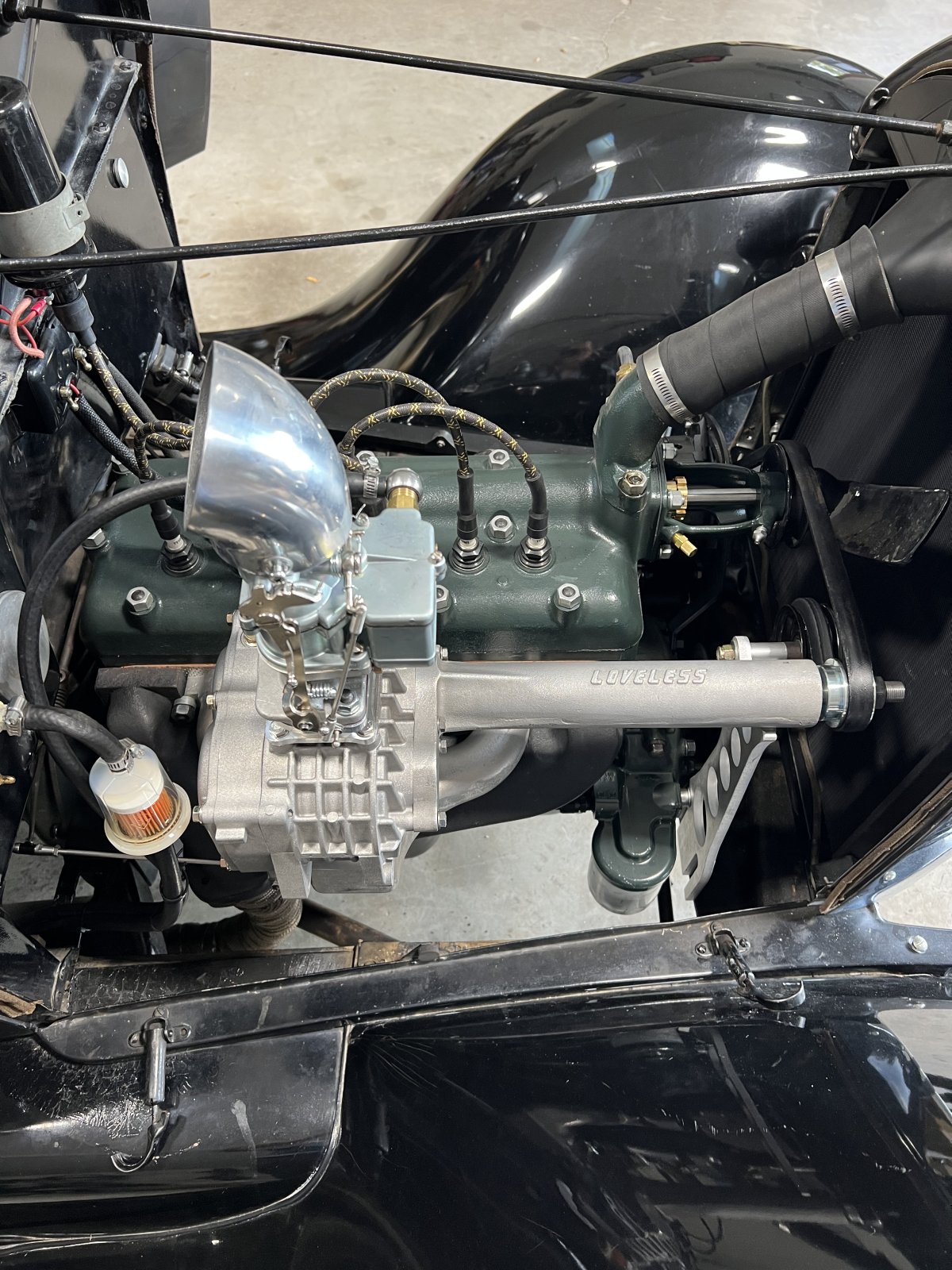

    Neat! Looks much better w/o the stone guard. Heads up on the cheapie plastic fuel filter; they've been known to split, leak fuel and start a fire.

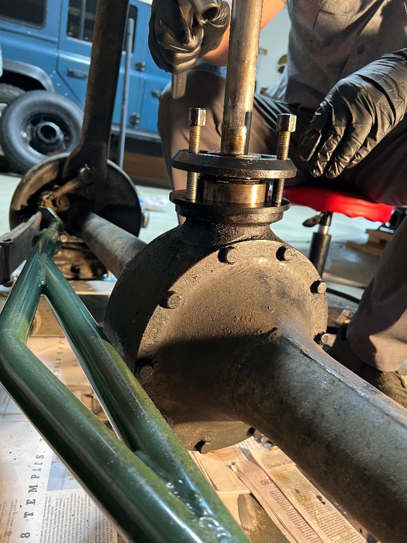

    I have been busy. Took rear end out and converted rear end for the open drive line. Struggled with the pinion but finally got it out. Also installed 2" lower leaf spring. Ready to put rear end back in and start on engine and ******. I got a new burtz eninge and going to install with the T5.

    Looks great! I'm curious to see how the rear stance is with the dropped spring.

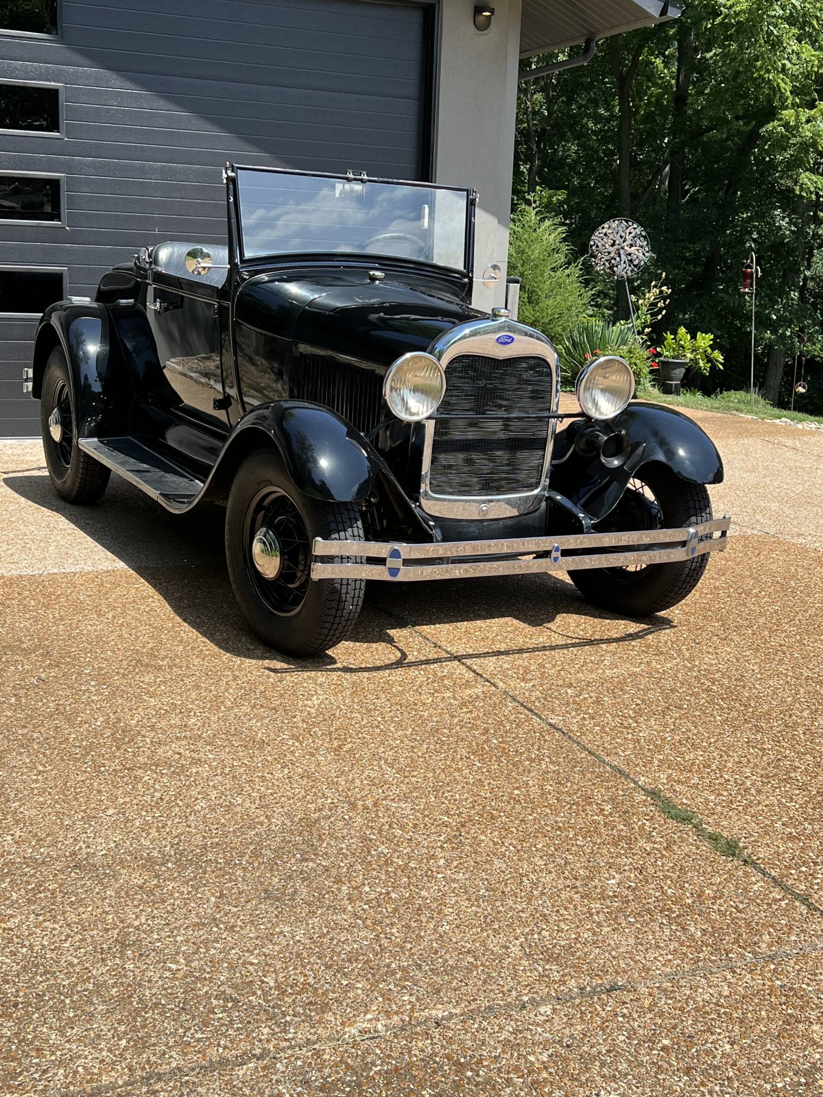

    Nice pebble tech driveway coating. Hopefully it won't stain too badly when your A marks it's spot:cool:

    Pebble Tec is just a brand of exposed aggregate finish used for pools. This type of finish on a driveway is called exposed aggregate and it holds up pretty well from what I've seen (even in our harsh climate).

    I put the new spring in but nothing but problem. I couldn't get the wheels centered then when i did car would lean to the driver side. I put old spring back in and everything lined up.
    Pics of progress. ****** is in and really happy with the end results. I like the sound of straight cut gears but this is so smooth and sporty. Still have few things to finish put its back together and was worth the work.

    Are the new springs equal in length & shape from center bolt to Eye?
    How do they compare to the original springs in shape & size?

    Just finished installing this. Still need to tune

  21. One way to increase cylinder pressure on a banger lol
