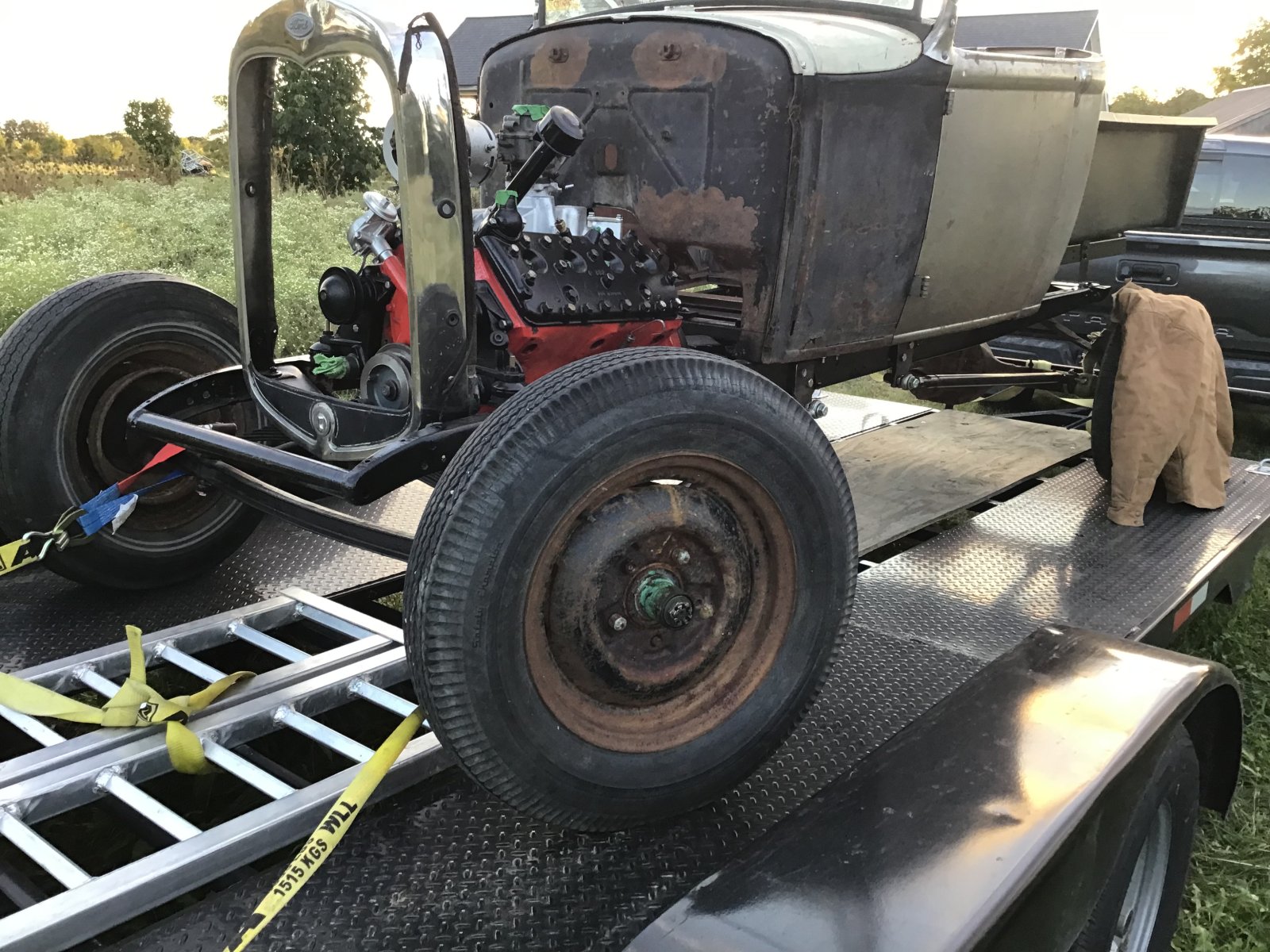

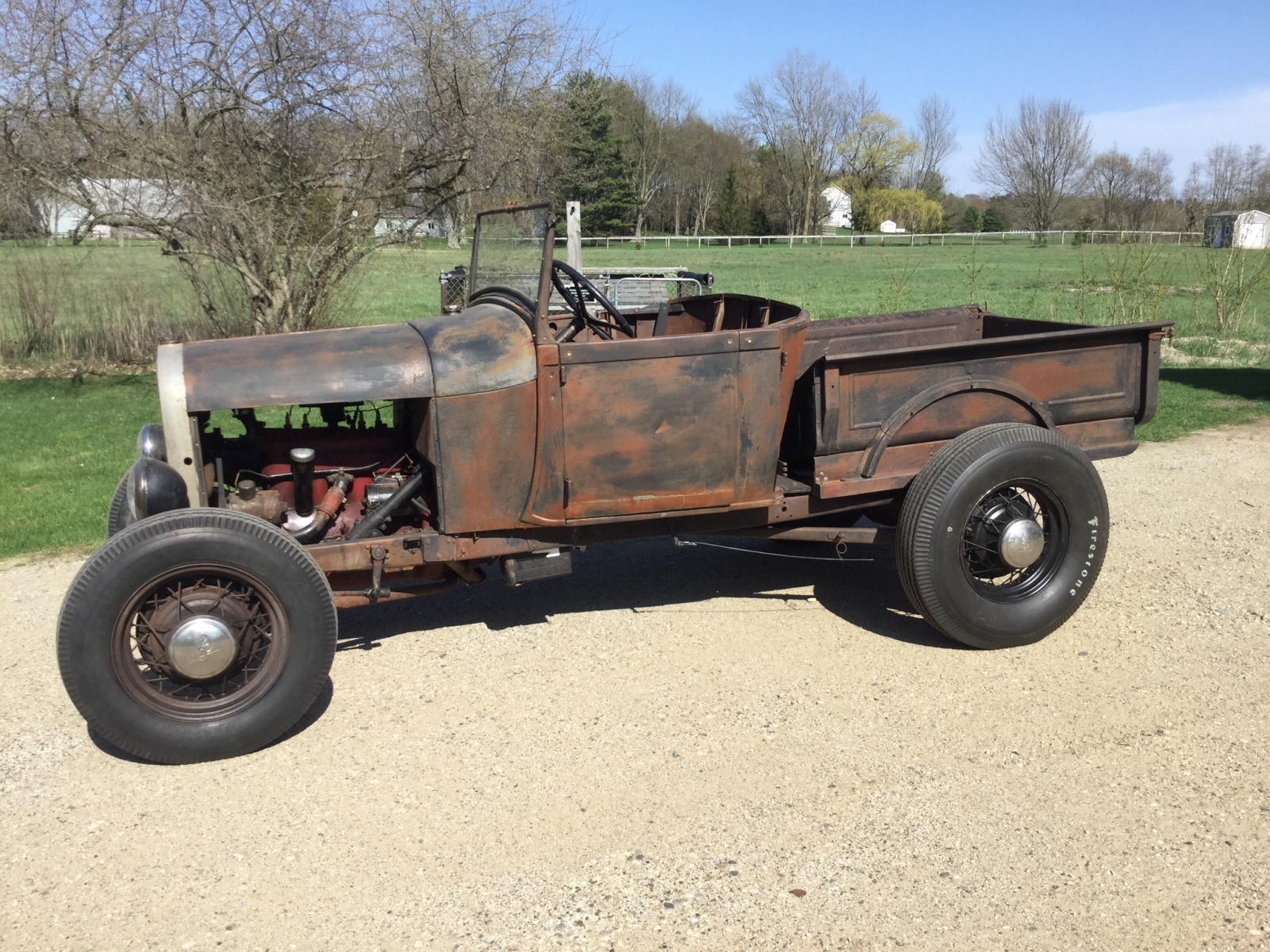

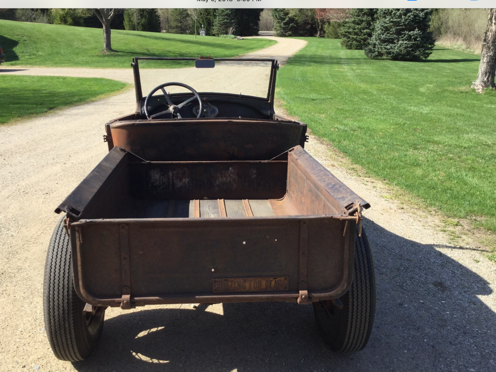

  3. IMG_3160.png IMG_3163.png Here’s what mine looked like to give you an idea......this was before I took the box off and turned it back to a Phaeton.
    This was not an uncommon practice for people to make it into a truck during WW11 , as you were able to get more gas if it was a truck.

    Wow, thanks for sharing. It gives a pretty close look at what I'm aiming at. Even if mine starts out with the phaeton part, I can always change it.

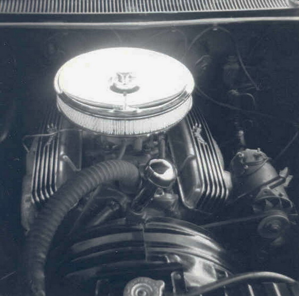

    I have history with 283's, my high school El Camino was a 283 power pack and T10, a few years later we built a 270 horse 283 and put it in a friends 56 210 with a 4 speed.
    Attached are pics of the El Camino and its 283;

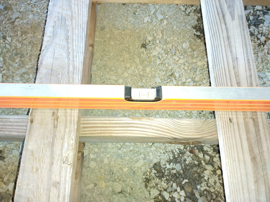

    Oh, well,here's my 2 cents. once you get your carport leveled out, how about setting your frame op on jackstands or whatever. level as you can, then mock up the body parts you have - including the phaeton back. Sit in it, trying different hts, etc. If you can be reasonably comfortable, consider building with what you have - - don't worry about the phaeton back. Lots of good 2 seater hot rods were built over the years using the front half of phaetons and nobody thought twice about it. Hot rod badge of honor!
    Ragged Edge and LCGarage like this.

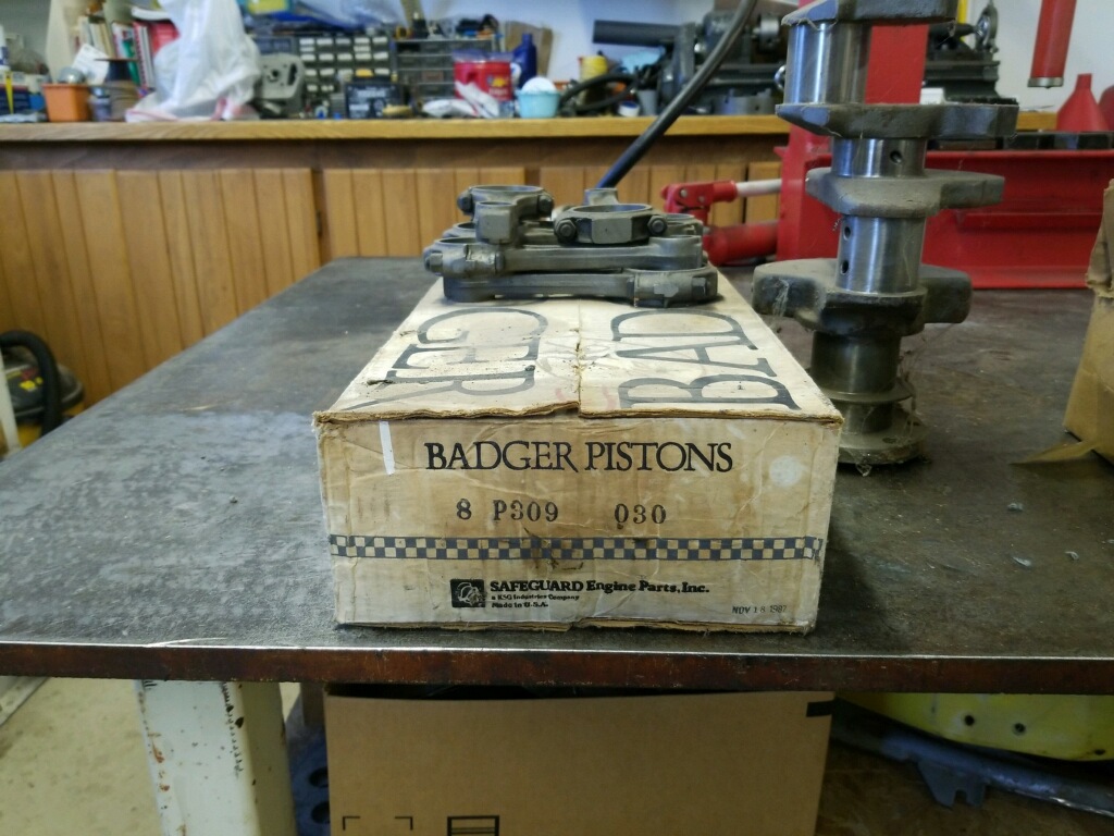

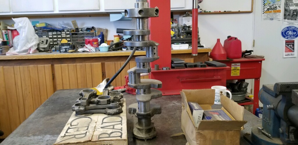

    One of my motorcycle buddies that lives in central Oregon, heard I was building a 283. He said he had a complete old (but never installed) Speedway 283 balanced rotating ***embly (pistons n rings, rods, crank, main and rod brgs) somewhere out in his shop. I asked if he could dig it out and see what shape it was in, especially the crank. He called yesterday and also sent some pics.
    Basically it's all complete and still in boxes except the crank, which probably only need polishing. The Badger pistons are .030, which would be just fine. He's offered all of it to me at a pretty cheap price - $400. Our next trip West we'll swing by and have a look and if it seems like it's all there and usable, I'd do it. 283 rods and mains.jpg 283 crank 2.jpg 283 crank.jpg 283 pistons and rods.jpg

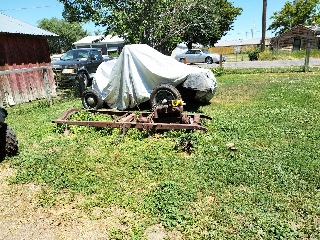

    I've been quiet, but not slacking...the usual work on old motorcycles continues, getting the '55 Dodge ready for our local parade (where the revamped cooling system held up, but it did vapor lock at the end of the parade), and most importantly working on getting the carport ready to actually start on the RPU.

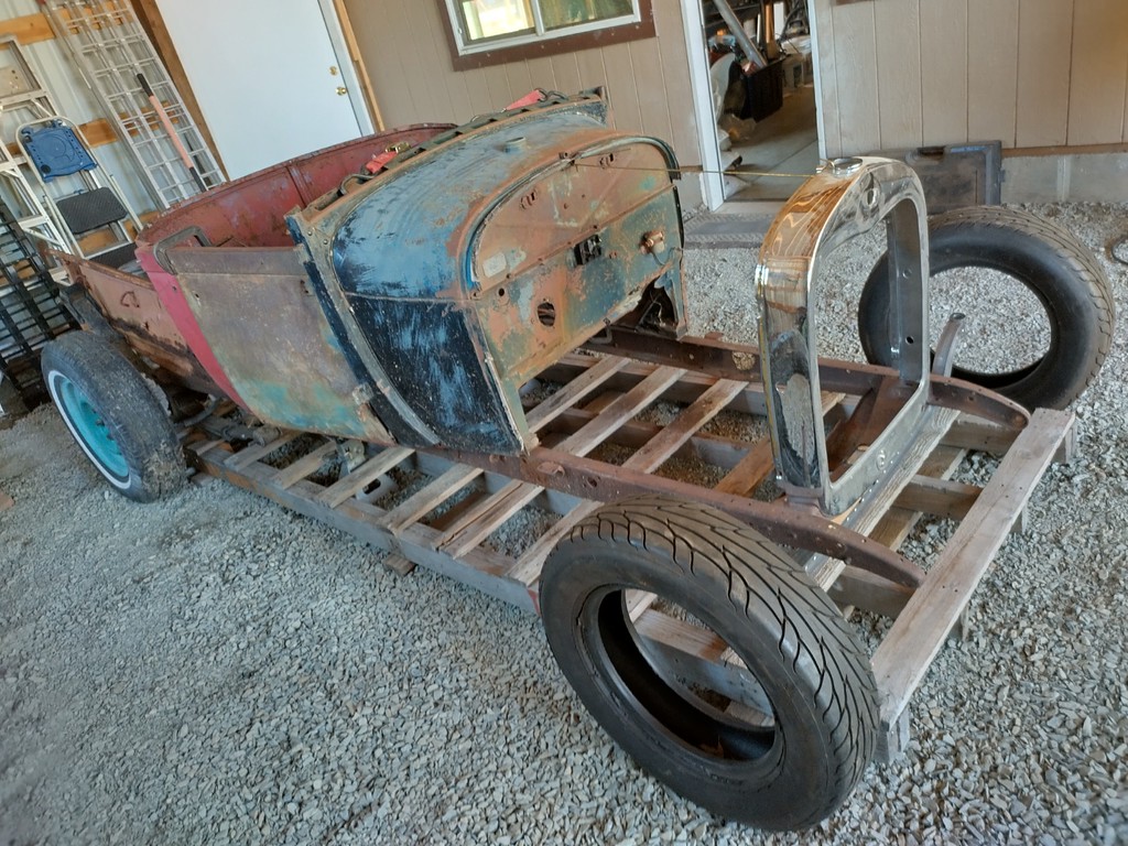

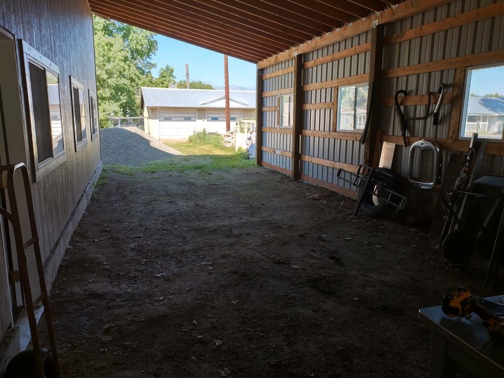

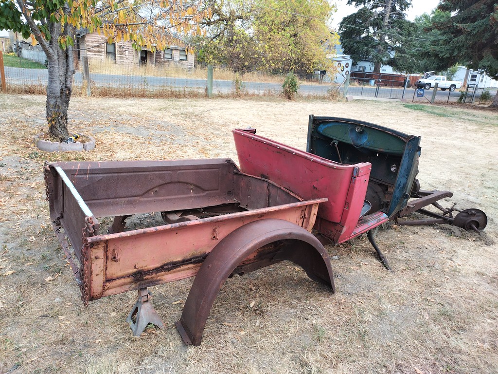

    Here are some progress pictures of the carport, first it shows things picked up and somewhat organized but with the dirt floor, then the load of gravel, then roughly spread (I borrowed an old M***ey Ferguson with a box s****er, not the ideal tool), then hand shoveled and raked out, then starting to set up a few of the tools I've been hoarding waiting to have a place to put them.
  20. LCGarage
    Joined: Aug 28, 2022
    Posts: 226
    LCGarage

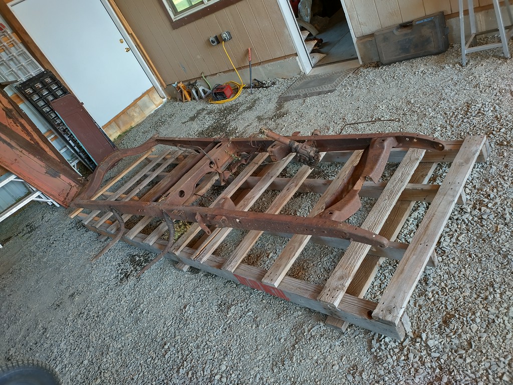

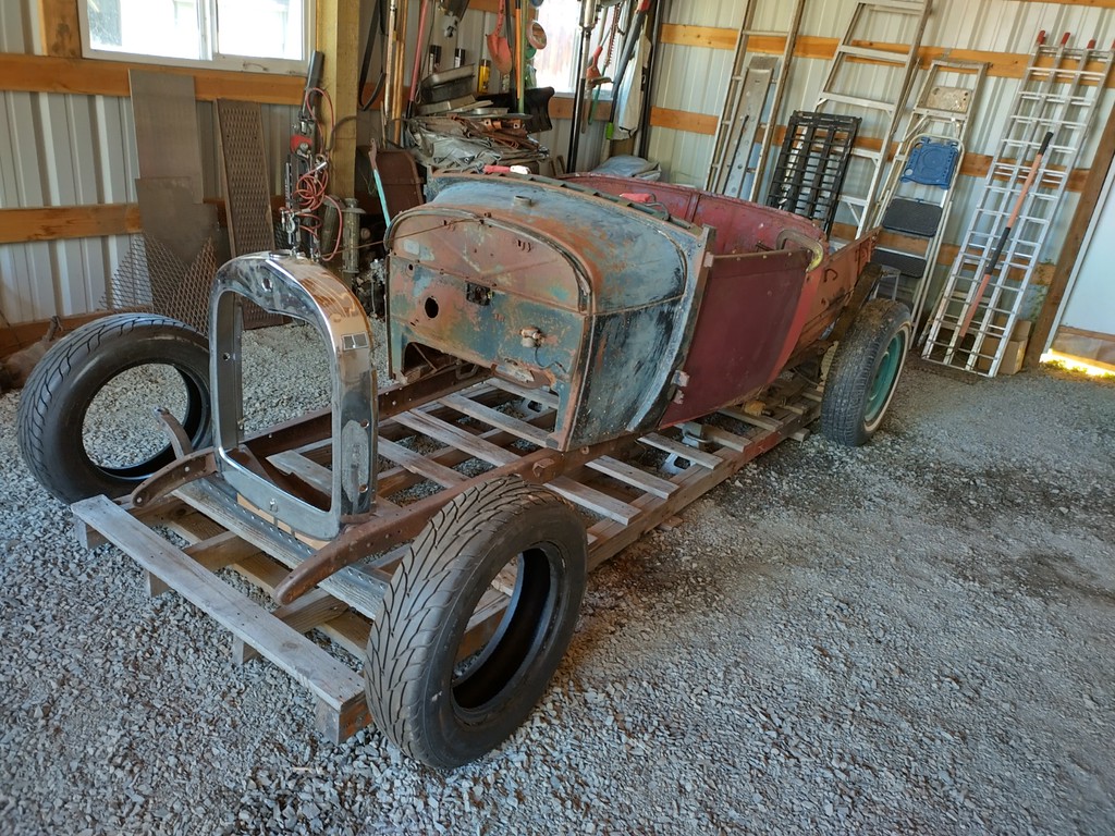

    Today I took chucka's advice and just used a long pallet/packing crate we'd scrounged up, leveled it in the carport, and started dismantling the RPU, so it could get brought inside and start the rough ***embly.
    Didn't get quite as far as I'd of liked, apparently some bees had taken up residency in the Model A and weren't too happy about their home coming apart. I'll let the pictures tell the story for today.
    carport 6.jpg carport 7.jpg carport 8.jpg bed n tailgate.jpg cowl n body.jpg frame 1.jpg frame 2.jpg spring 1.jpg spring 2.jpg

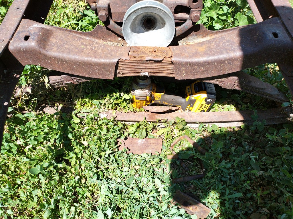

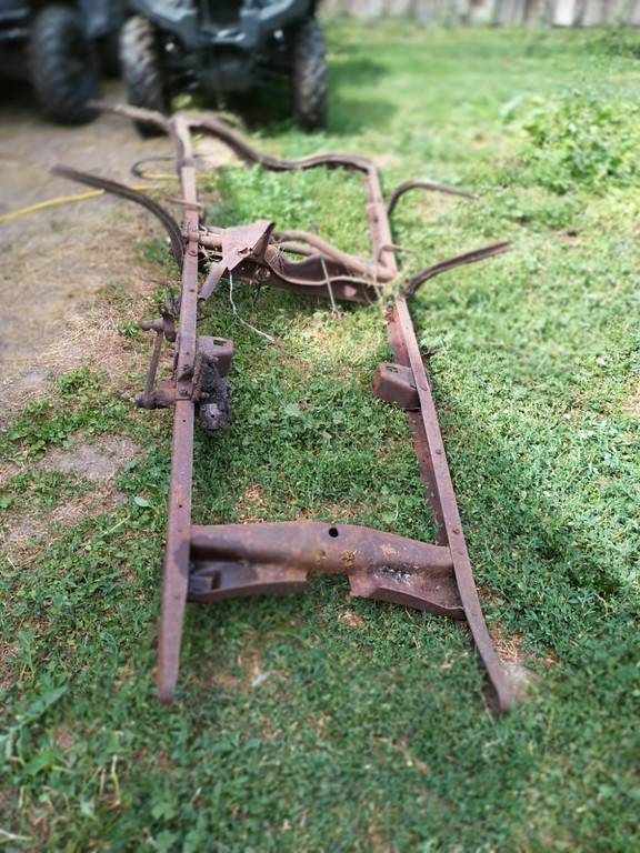

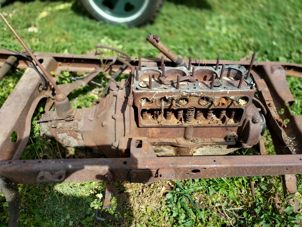

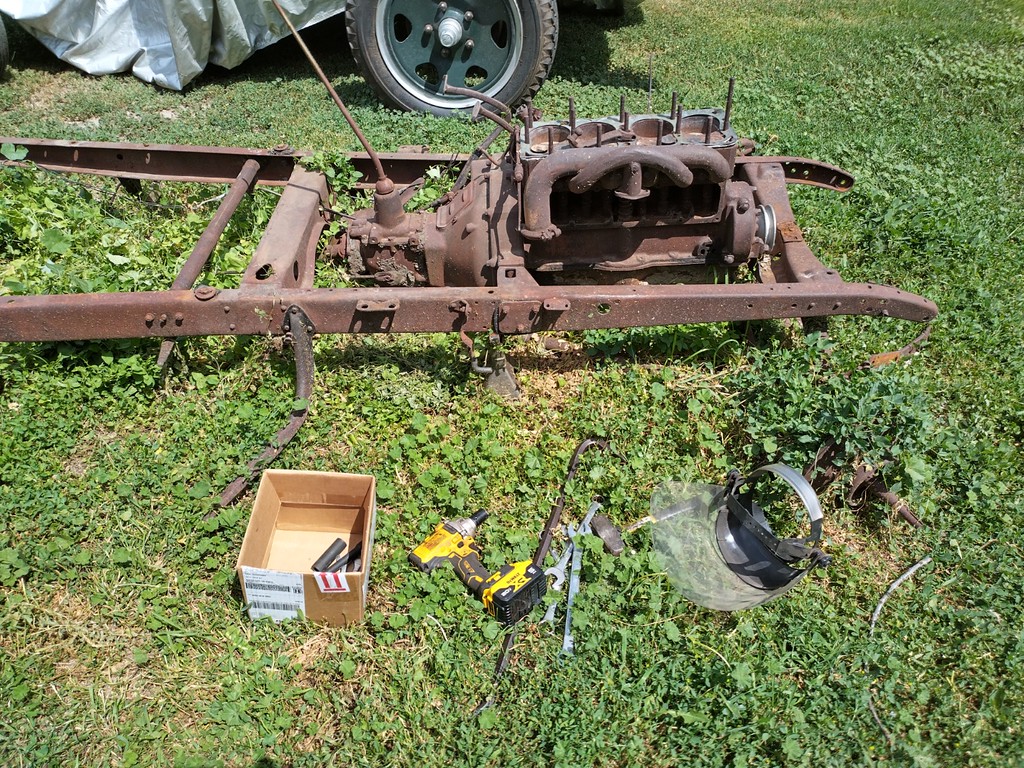

    More work on stripping the frame today, and since i'm working alone and without any sort of lift capability outdoors, had to get creative. Lifting the engine and transmission out of the frame wouldn't work, but what if I could lift the frame up and off the engine, trans and front axle ***embly?
    This ended up working pretty well, and was able to get things apart without cutting, torching or ruining any of the stock pieces that are being returned to the Model A wrecking yard.
    Next up will be cutting or grinding away the rivets that hold running board brackets as well as all of the mechanical brake linkages and a few other pieces. With those removed, the frame can at last come inside and rough fit up can begin.
    Todays pics;

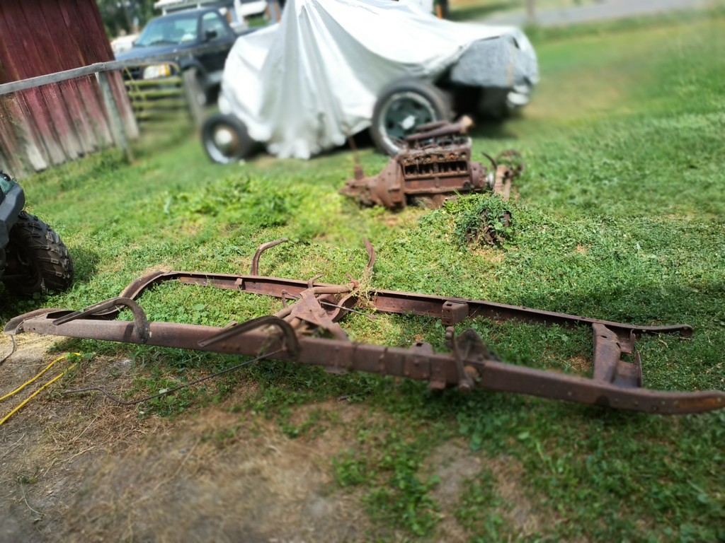

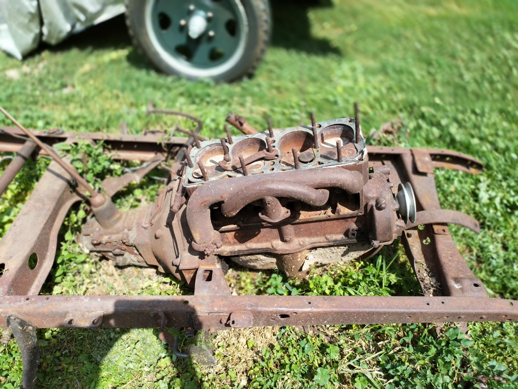

    Todays pics;

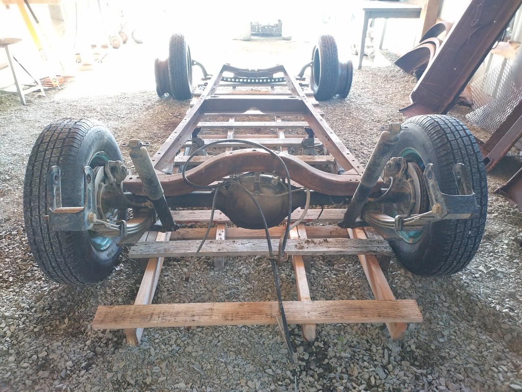

    Plans changed, had an able-bodied friend stop by today, so with his help, brought the frame inside. One benefit to bringing it in now, is at least I'll be out of the sun while stripping the frame.

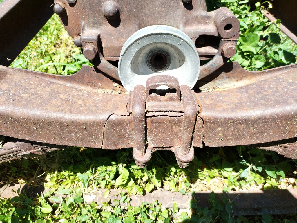

    Made really good progress yesterday, stripping the frame in preparation for the coming mock-up. Needed to remove running board mounts, all mechanical brake cross shafts, battery box, steering gear and a few other brackets and mounts. I'm trying to remove these things without ruining them as they are going back to the wrecking yard.
    Also worth noting, I'd like to try and identify the steering box. It's not stock Model A, and someone went to a fair amount of trouble to install it back in the day. Sadly they really butchered the frame, but that can be fixed.
    On the first running board bracket, used the wheel of death to cut most of the rivet heads off, then ground the remainder flush and used a big punch and hammer to separate the pieces. I over-ground the first one and took a gouge out of the bracket, so tried to more careful on the next ones.
    Everything else was cut, ground or unbolted. One thing I'm really impressed with is the quality of metals and hardware on the Model A. Many of the bolts were still in nearly perfect shape and simply unbolted after decades in the outdoors. Try that with the **** they sell nowadays!

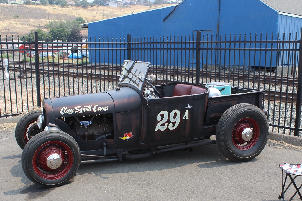

    Here's a picture of a cool '29 RPU that I really like, photo credit to @Mr48chev;

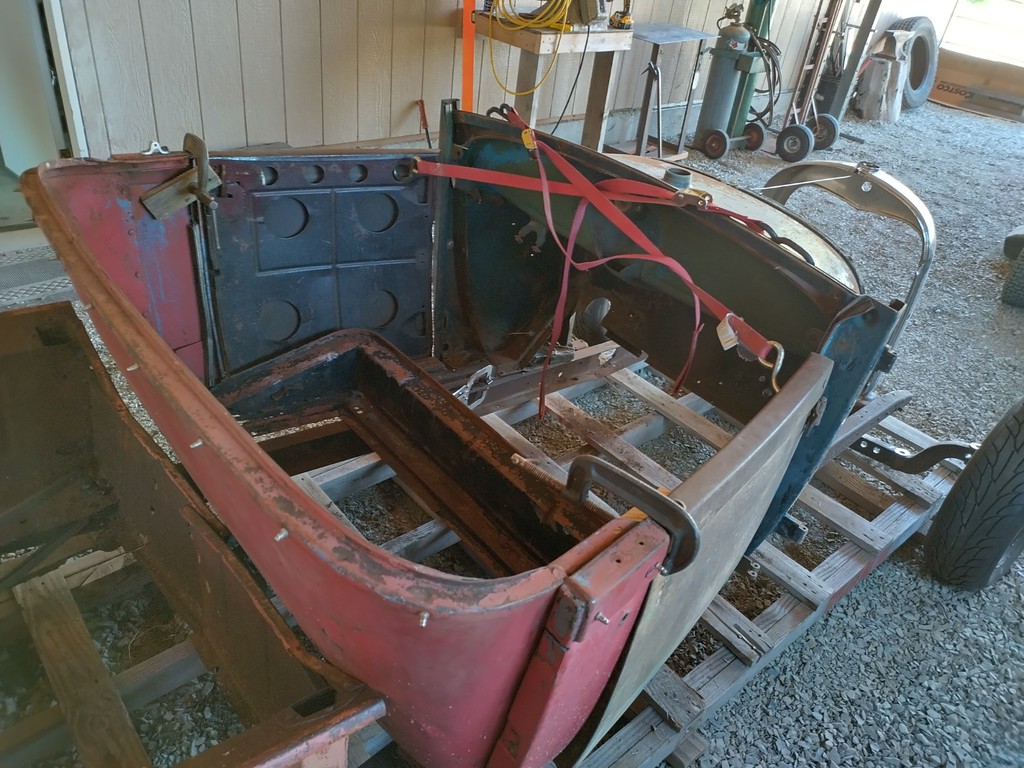

    Had an extra couple hours this afternoon, so moved forward on the first steps of the mockup process. Used a short piece of 2x4 as a "spring" and a couple hose clamps to keep it and the drilled front axle in place.
    Out back put the frame rails on jackstands, then rolled the S10 rear end in from behind and kind of sat it in place. There was a lot of finagling, but kinda got it where I wanted it, at least for a first look-see.
    Then sat the front tires and rims next to the axle, just for a visual. Next step will be to set body pieces on and start getting an idea how it will all come together. I'm already thinking that light little roadster will probably only need the single main leaf.
    Also, just noticed the '29 RPU photo (see above) I borrowed from @Mr48chev is using a phaeton body section. Doesn't look too bad.
  29. LCGarage
    Posts: 226
    LCGarage
    Spent yesterday morning mocking up the body on the RPU, some of it went well, other parts, not so good.
    Overall look is pleasing;
    The plan to use the S10 parallel leaf springs is losing steam, the spring width lands the springs and their mounting points right where the box side panels should go. In this pic you can see how poorly this combination works together;
    I'm thinking about going back to an A or T rear spring with split wishbones to match the front. Thoughts?
    Until the roadster parts are exchanged onto the cowl, the doors are a very weird fit;
    Despite the many challenges that lie ahead, getting to see it mocked up is motivating.
