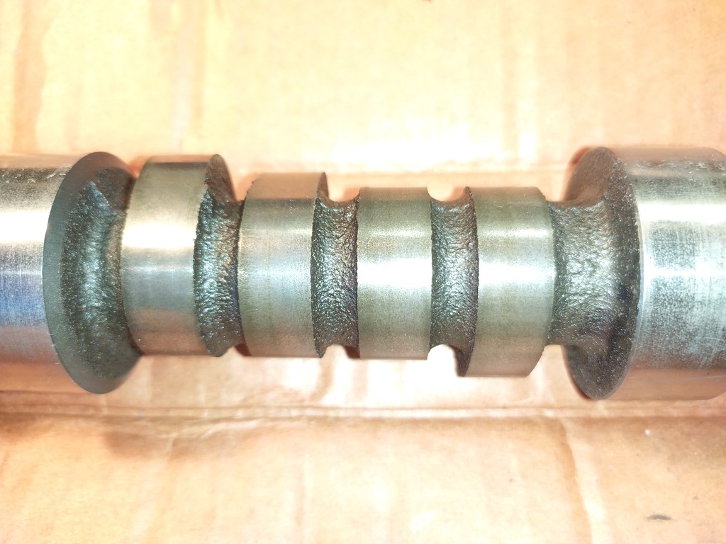

    In more exciting and less greasy news, tonight I brought home the camshaft for this engine. That deserves it's own post.
  9. LCGarage
    Joined: Aug 28, 2022
    Posts: 227
    LCGarage

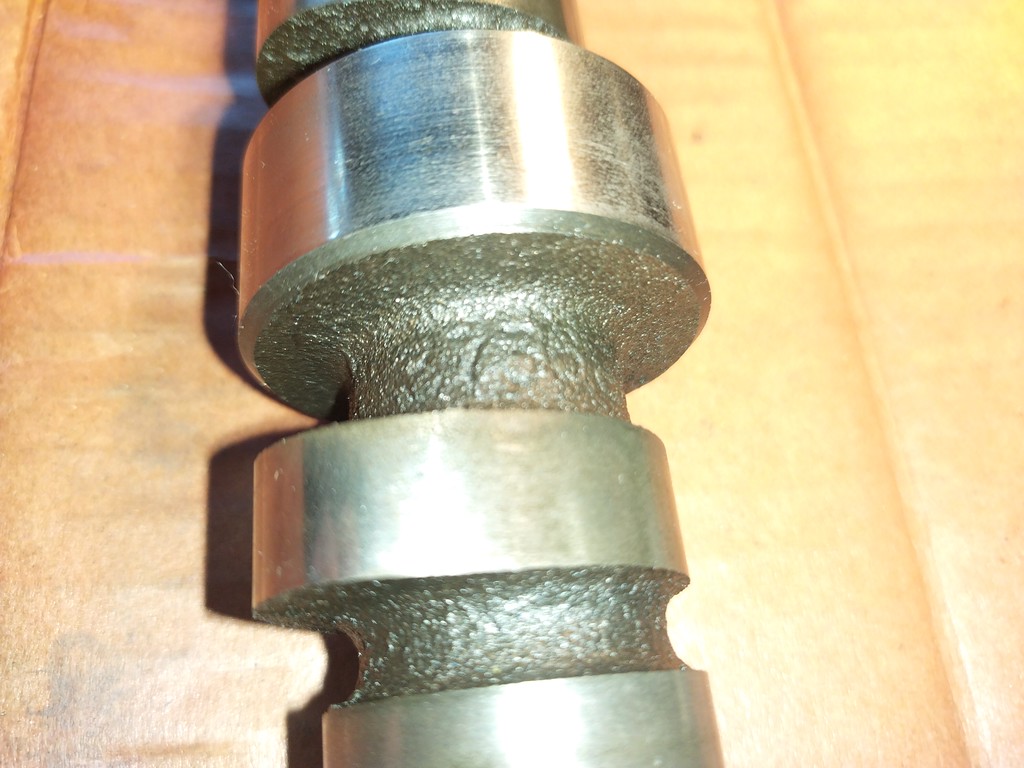

    The famed 283 Duntov Cam. The subject came up at one of the Saturday evening cruise-ins downtown, when I mentioned building a 283 for my RPU. An older local rodder (older is relative, at 69, I'm one of the youngsters), more known for his carb building and tuning skills, said he had a genuine Duntov out of a 270 horse 283. My ears perked right up, and asked many questions. His answers led me to believe this could be the real deal.
    This evening we finally hooked up and I went over to his house. He'd received the cam from another local rodder he'd done carb and tuning for, and the story was the low hours 283 "blew up", had been stripped of usable parts, the original dual quads had ended up on the replacement 327 and the cam given to my friend.
    As he showed me the cam, I eagerly looked for the casting number, and there it was "3736098". On older Chevy parts, the official part number was often very close or just one digit off of the casting number. From what I've read, this was the correct casting number for the "3736097" Duntov Cam. Next I looked at condition, fearing whatever had taken out the motor might well have damaged the cam. It looks pristine, not a mark on it anywhere.
    I understand there's a risk in using a used camshaft. I'm doing it.

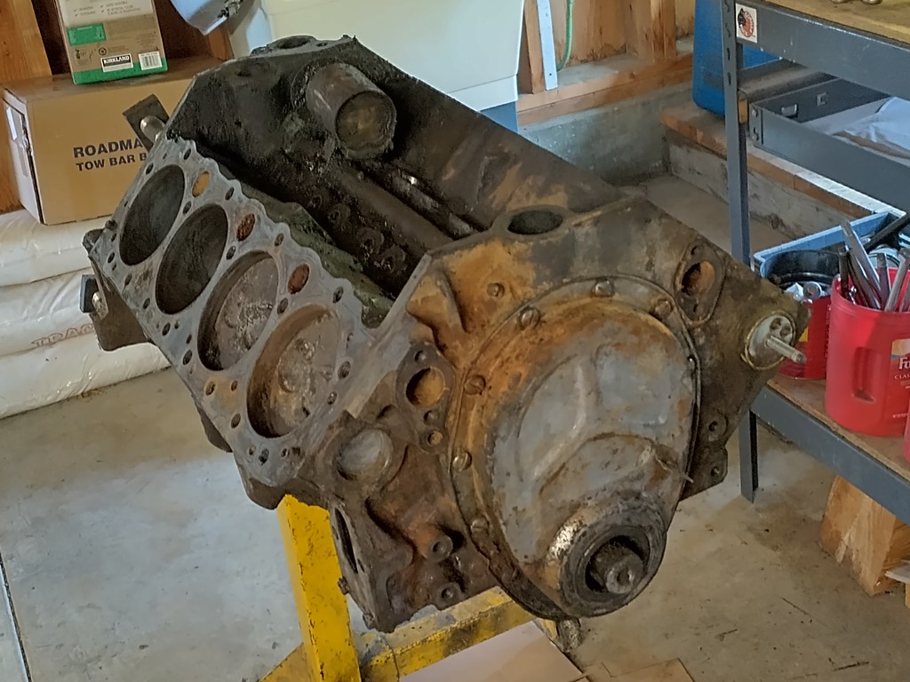

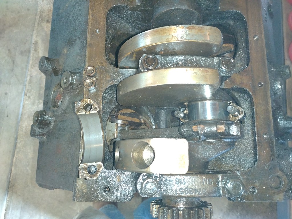

    Finish stripping the 283 down to the block today. My main concern at this point is the hope that the #1 cylinder will clean up with a .030" bore job, so that the Speedway kit I've located will actually work.
    When I started today;
    The "bad" cylinder;

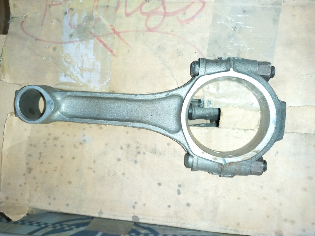

    Before pulling the pistons, rods n mains, marked them front to back (just in case we reuse any of these parts);
    #2 rod cap off, all the bearings looked like this;
    The pistons all came out fairly easily (very little ridge), the biggest hang up were the small ends of the rods were pretty stuck on a few of them, but that was no big deal.
    Bare block, ready to have the soft plugs and oil galley plugs removed and hot tanked;
    I'm planning to ball hone the cylinders, just to see how much they'll clean up and just to get a better idea if the .030" bore might work. Hone is on order.

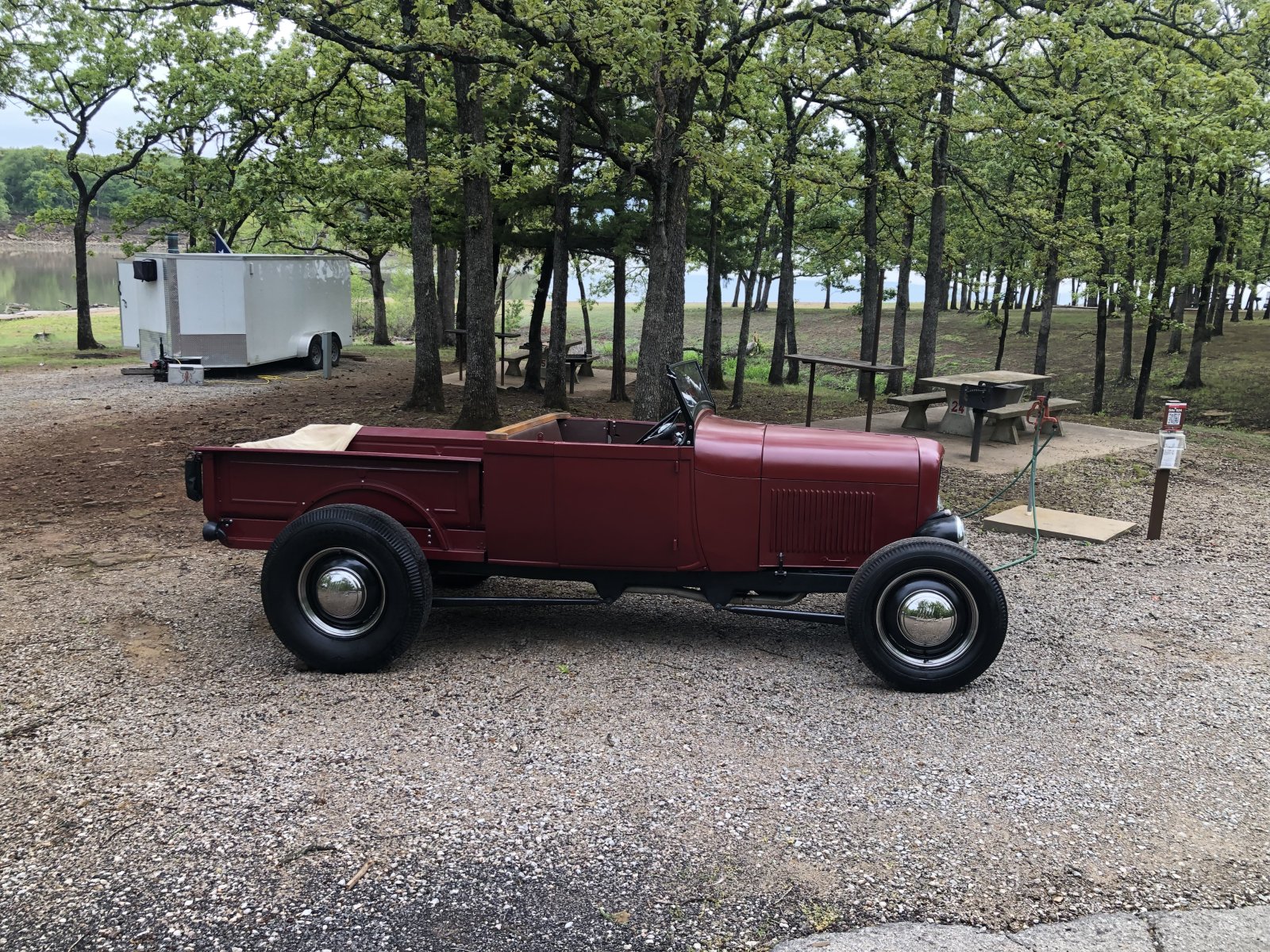

    So this is the one my brother and I built as a tribute to the original. It's kind of similar. Lol
    The bed was added to balance the awkward look and is what sent me down the RPU path.
