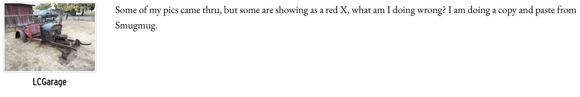

    Some of my pics came thru, but some are showing as a red X, what am I doing wrong? I am doing a copy and paste from Smugmug.

    Smugmug is like a photo collection/holding program. It has its value for a lot of people. But, as you found out, problems can go wrong when you upload your photos to the site and they hold it for you.
    My son liked smugmug at first and his photos were uploaded to the site. Then he, too had problems and so he no longer saved his photos “off site.” Off site meaning his home computer. Our granddaughter was born and like all new parents, there was almost one second that was not recorded on phone cameras, 35mm digital size slr cameras and of course photos from the two grand parents who were overjoyed. Along with tons of movies.
    So, needless to say his computer hard drive was getting full fast. Then the smugmug problem and now he was looking for solutions. One was photobucket, but that too was another company with larger hard drives to store other folks’ photos and movies.
    Not wanting to waste time with those ****py companies, he opted to buy an external hard drive. At the time it was 500gb and it was large! Wow… so, he spent a few minutes filling up that hard drive. At the same time, Our own computers were filling up fast and it was amazing how many photos and live action movies a granddaughter can be in a few weeks. For us as grandparents, when we went to the beach, the whole day was filmed for posterity and her parents who were at work.
    Later, we realized that our computers were getting slower, due to the last several gb of stuff being loaded on to them. If a computer had 500gb hard drive, then when you approach 300 gb, the computer starts to slow down as it tries to find the stuff, get it off of the hard drive and send it to the display or transfer it to email or external hard drives. At the time, very few flash drives were around and what was there was expensive, but portable. We got a few larger flash drives to copy all of the week’s photos and loaded them on our granddaughter’s mom’s computer drive.

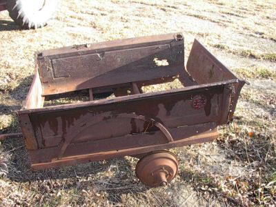

    So...do you know what it is? It's an old Ford...
  30. 05snopro440
    Joined: Mar 15, 2011
    Posts: 3,037
    05snopro440
    No, I don't know what it is. It does look like Ford.
    This is an A bed (internet photo). It doesn't have the flattened area where the fenders mount pressed into the box side.
    Nailhead A-V8 and LCGarage like this.
