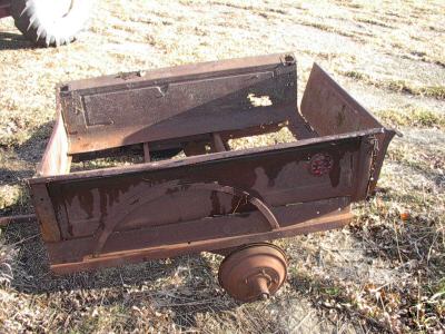

    After a couple hours of web surfing and reading, it seems like the bed could be an early 1926 Model T, as they used the stamped half moon fender locators but had the front pockets mistakenly placed to the forward ends of the box side. But...no cutout for the battery? Or is it a very early Model A box, using left over Model T side panels but the front panel for the A. Tailgates for T's and A's seem to be interchangeable but hinges have slight variations. A bit of a mystery, more sleuthing to be done.
    brEad and 05snopro440 like this.

    Turns out I'm not very observant, it sure looks like remnants of a battery access port in the left front of the bed panel;
    So here is my best guess at what I've got; A '26 or '27 Model T box, with sort of rare (?) forward mounted stake pockets and with a random Model A tailgate.
    There are many interesting discussions on the interweb about how to identify the various years and incremental changes and why. At this point I'm just gonna use what I have and make it all work, it's a hot rod after all.
