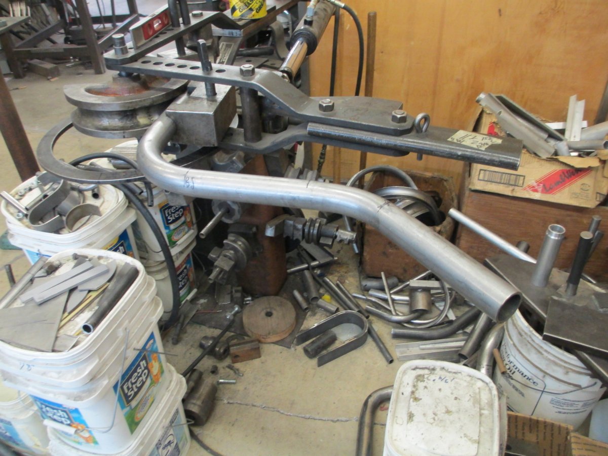

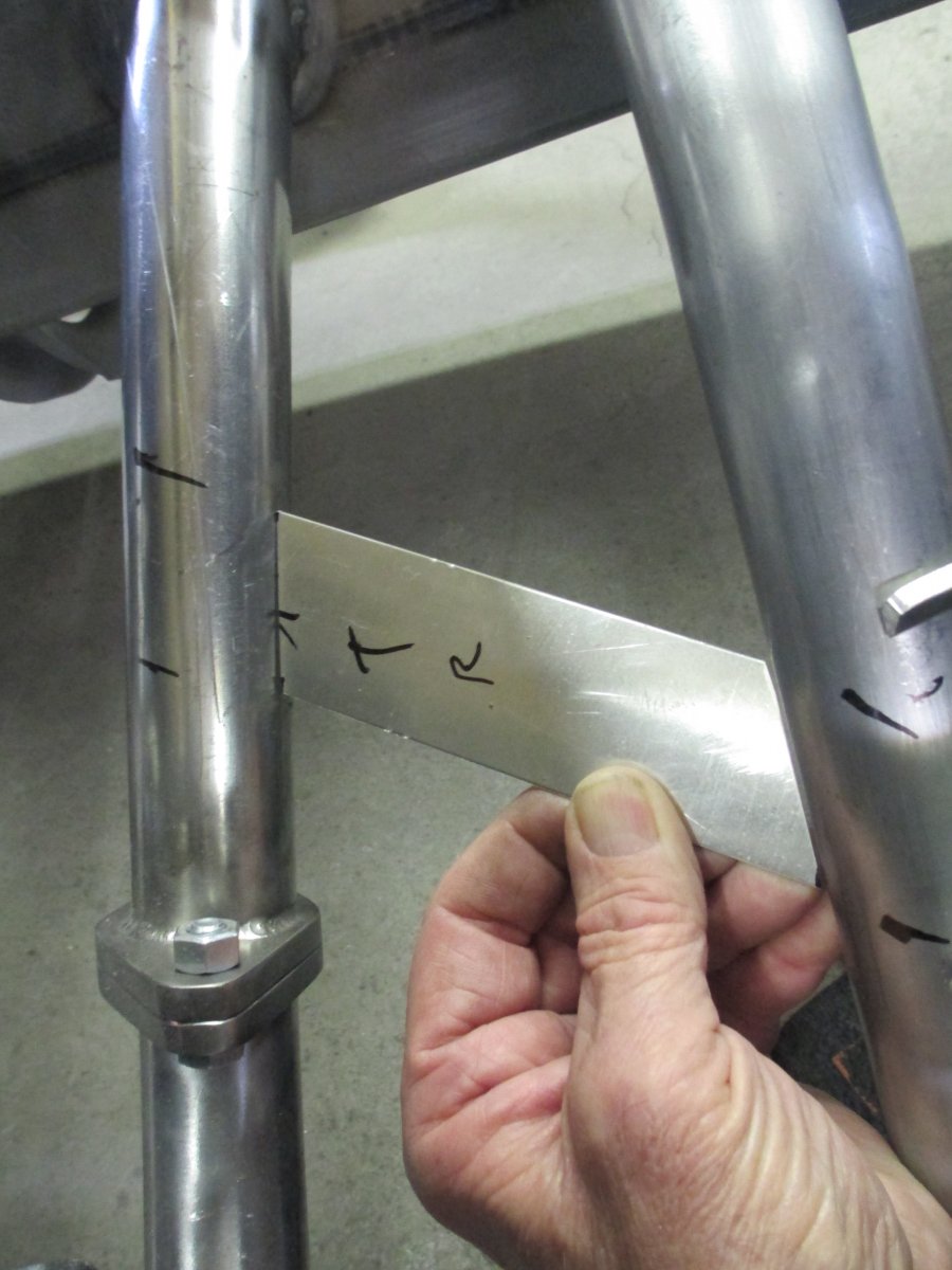

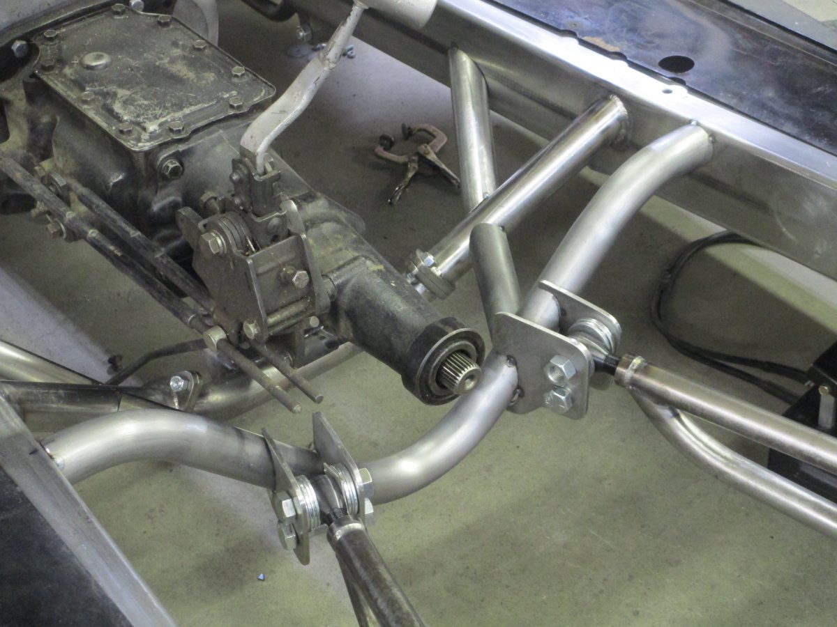

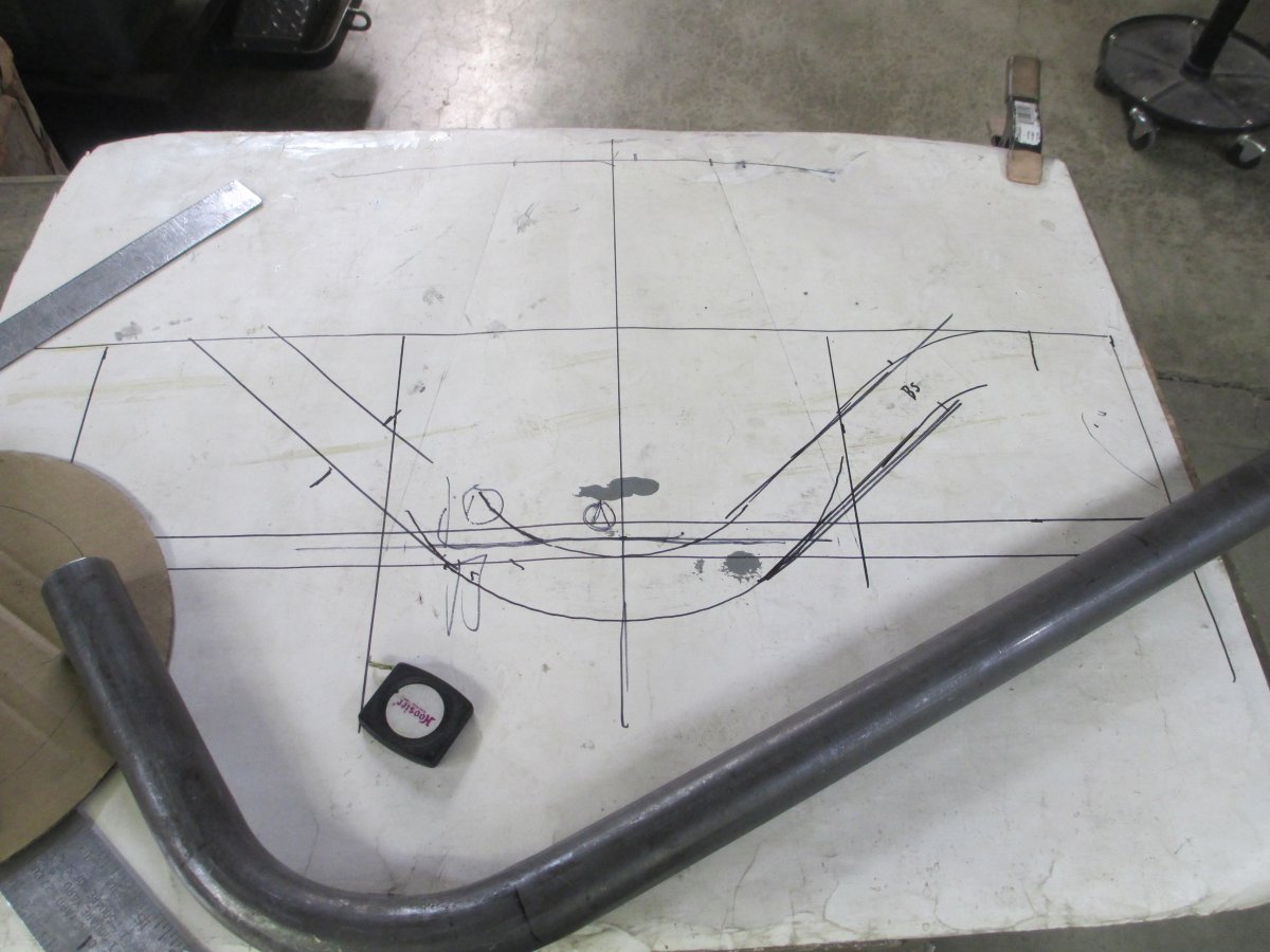

    Making link brackets on an angle tube is always a challenge. The fact that the double shear plates can't be even close to symmetrical, requires and attempt to be artsy. I make all the templates out of .063 aluminum, because it gives a more honest fit than cardboard, and can be bolted in place. A contour guage gives a place to start on the fitment. The real plates will be made out of 3/16 cold rolled, an the top front corners will be boxed in, and there will be a tube connecting at the push point to the trans crossmember above the flange. IMG_4640.JPG IMG_4641.JPG IMG_4642.JPG IMG_4643.JPG IMG_4645.JPG IMG_4649.JPG IMG_4650.JPG IMG_4651.JPG

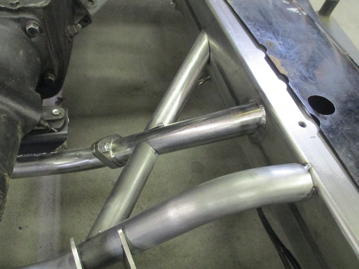

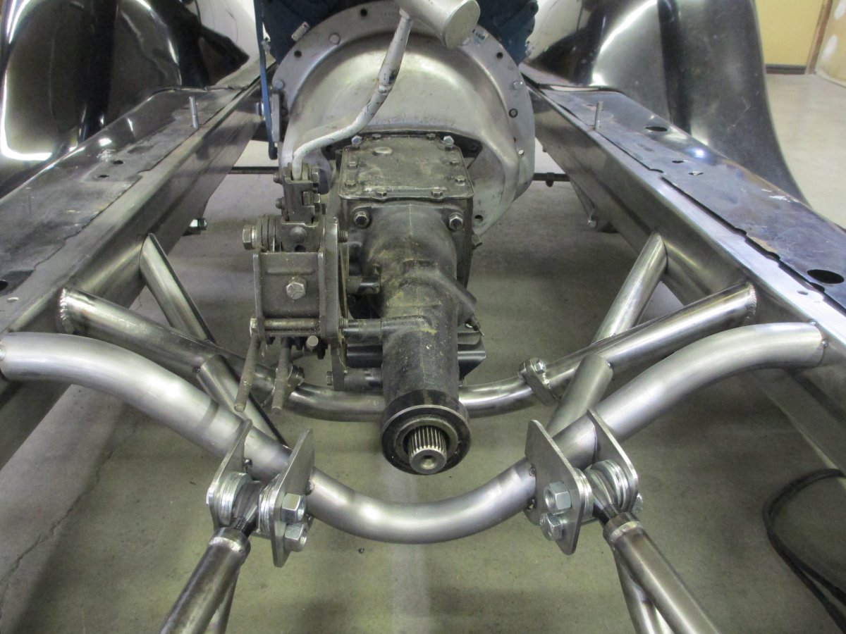

    Today, I got the front mounting plates cut out, drilled, and the outer ones fit and tacked on, along the with the rear mountings. The pinion angle is dead parallel at this time. Tomorrow, the inner plates will be fit, and boxed on the top side. Then, the network of tubes will connect with some diagonal braces to the frame rail, to keep the frame rails square, under hard launches. IMG_4654.JPG IMG_4655.JPG IMG_4657.JPG IMG_4658.JPG IMG_4661.JPG IMG_4665.JPG IMG_4666.JPG IMG_4667.JPG IMG_4669.JPG

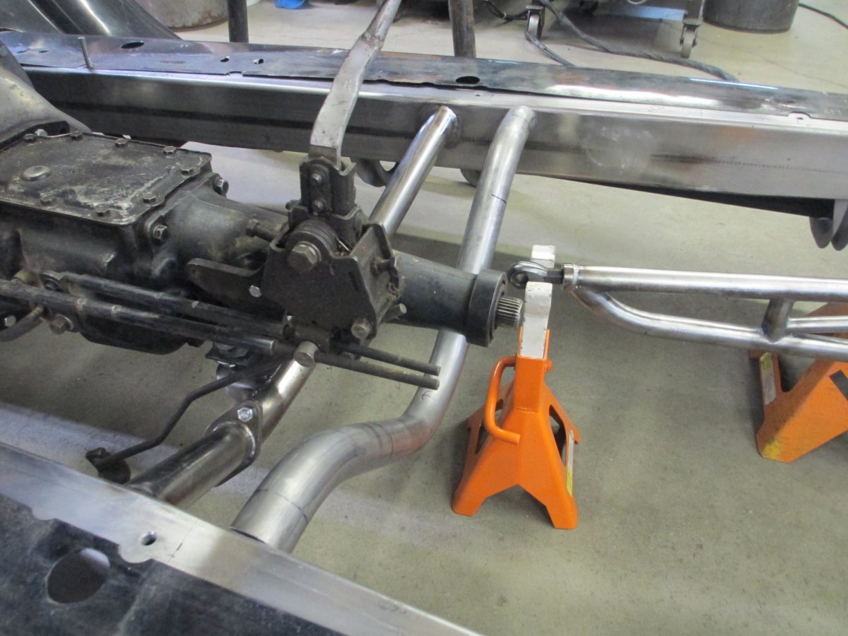

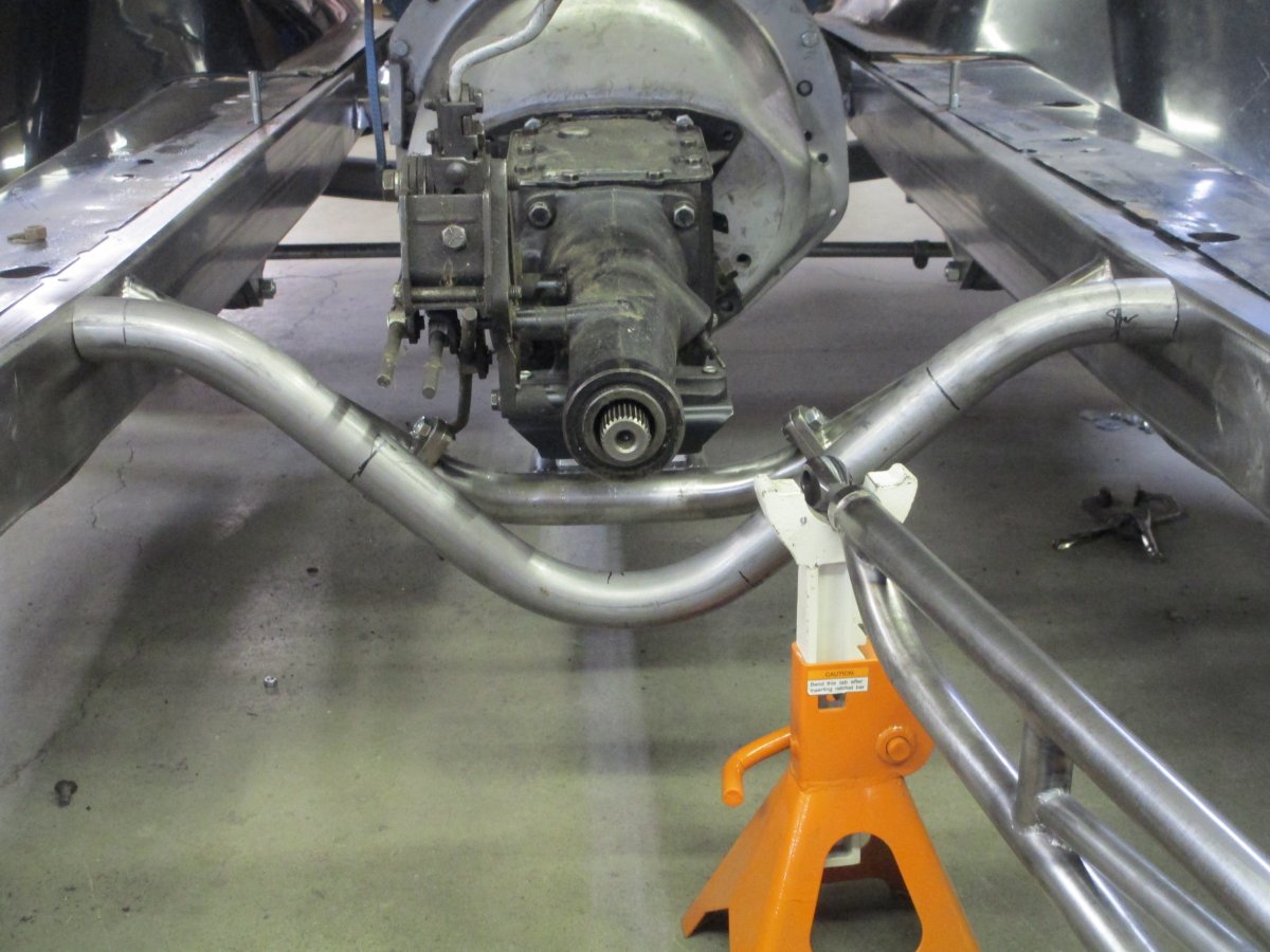

    Got a late start today, but got the inner plates, and the rest of the tubes fit and tacked. The first couple of shots, shows the sheet metal strip fitting method I use. I call this arrangement, a "Caged K Member", with a drop out transmission mount. The ladder bar mounts will be boxed in at the top and front, later when the frame is on the table. IMG_4671.JPG IMG_4672.JPG IMG_4673.JPG IMG_4675.JPG IMG_4676.JPG IMG_4679.JPG

    I like your ladder bar crossmember solution Marty.
    I used to run a toploader in an altered. I liked the Mr. Gasket Vertical Gate for the track.
    Just a heads up - IIRC the big block input shafts are about 3/8" shorter than the small blocks' input shaft. Also, Liberty's Gears put a first gear on mine that had an extra tooth on the same pitch diameter (each tooth profile was just a smidge narrower) that gives a 2.87:1 ratio, if you need more gear to launch it.

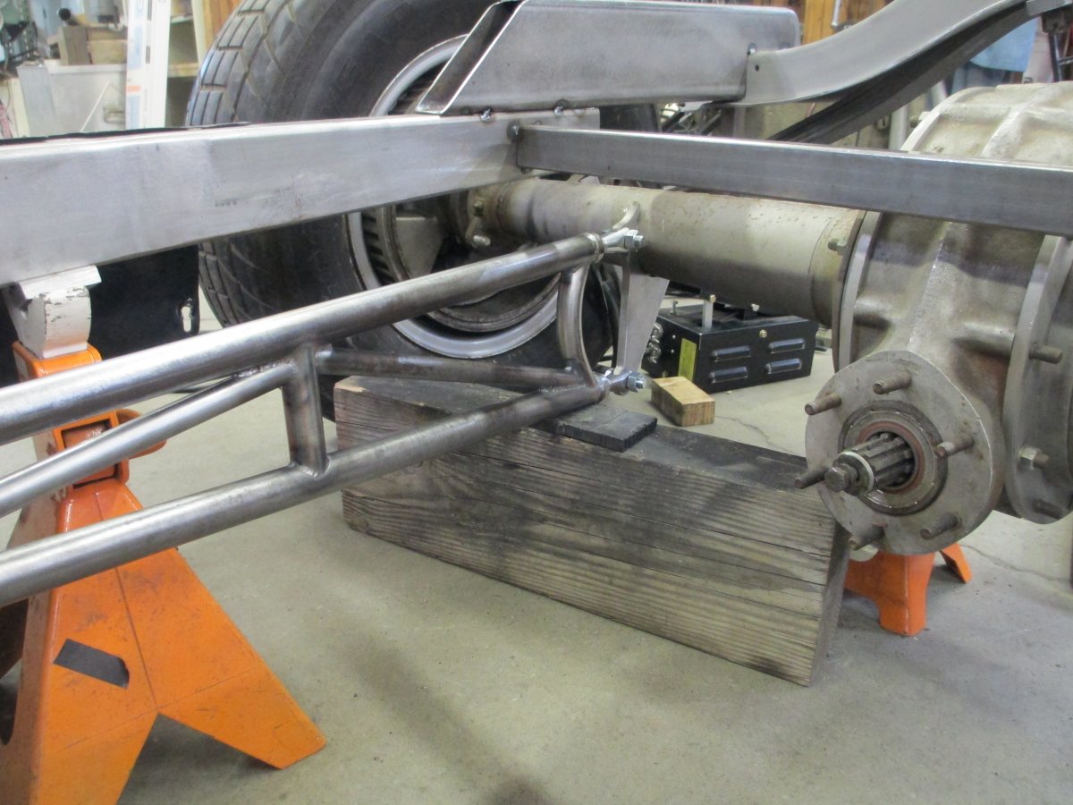

    Last pic in this post shows bunch washers holding heim joint. Will u later put in high misalignment spacers to allow more heim movement? Or will u leave washers?
  26. Marty Strode
    Joined: Apr 28, 2011
    Posts: 9,689
    Marty Strode
    The washers were to hold the space for the urethane ends, (street use) that measure 1.750"wide, during fitment. The solid ends for the strip measure .875 ", and I will machine (4) .4375"wide spacer sleeves, that are 7/8" OD, to keep the rod end centered. IMG_4591.JPG
