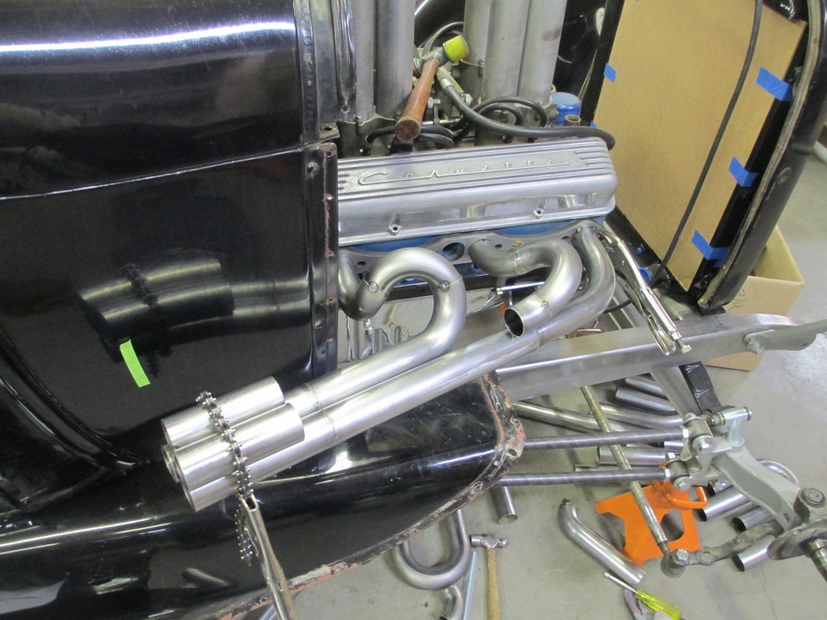

    Got started making pipes last night, both front pipes are welded, and tacked in place. Now the creative aspect comes into play. I shortened the collectors from Speedway, they are as nice as any I have ever used. IMG_4726.JPG IMG_4727.JPG IMG_4729.JPG IMG_4730.JPG [/ATTACH] IMG_4732.JPG IMG_4733.JPG IMG_4734.JPG

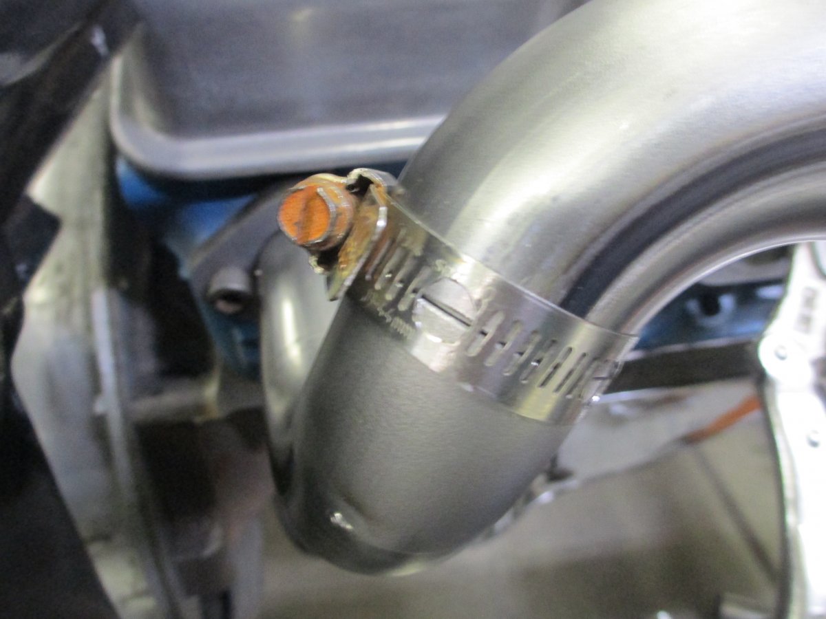

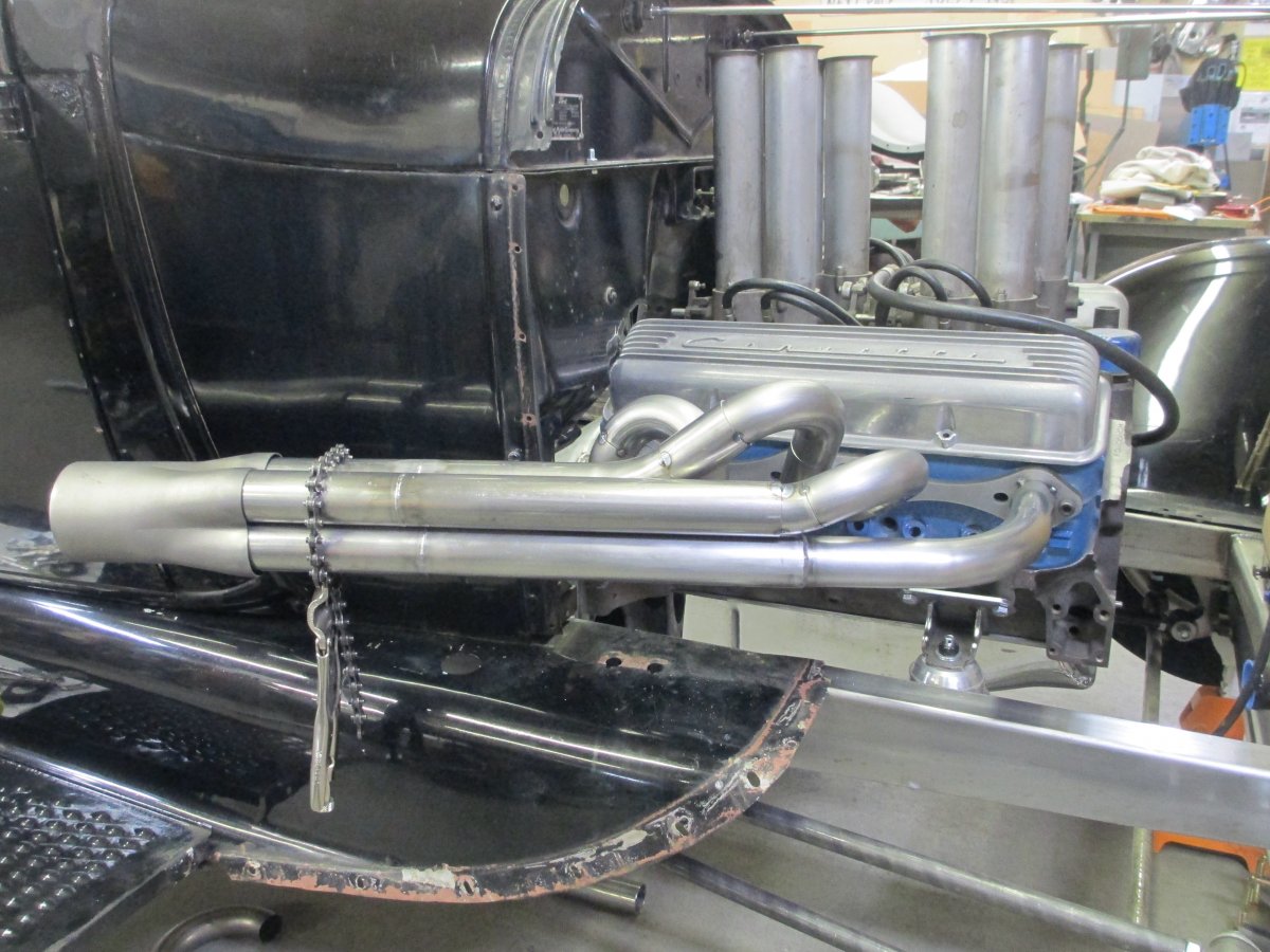

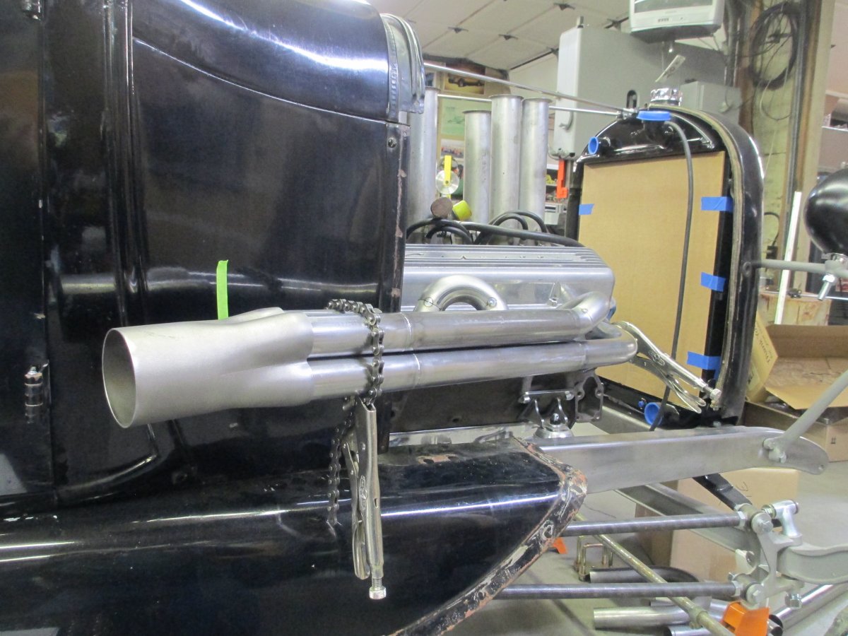

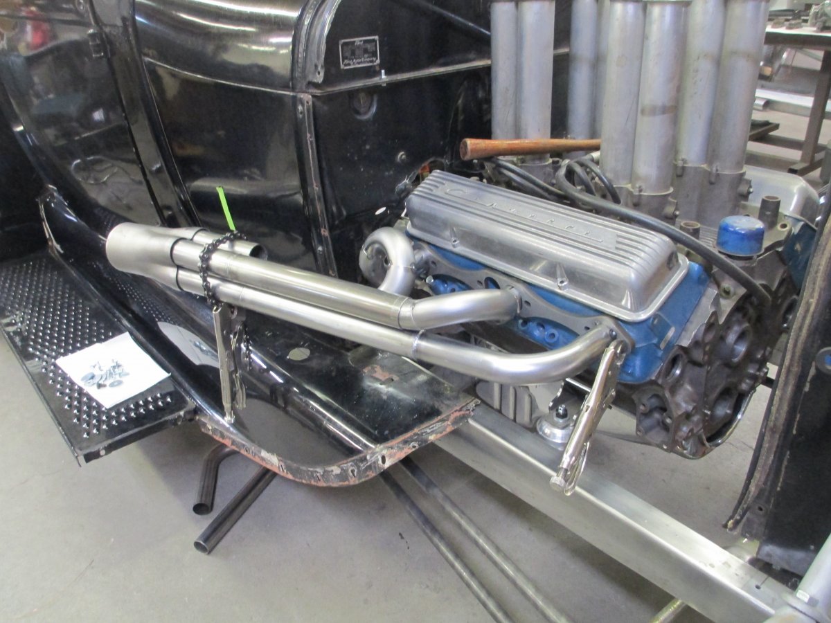

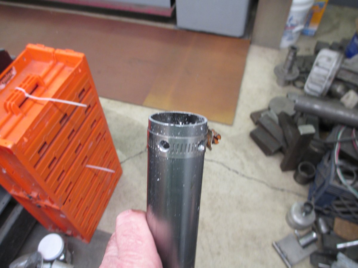

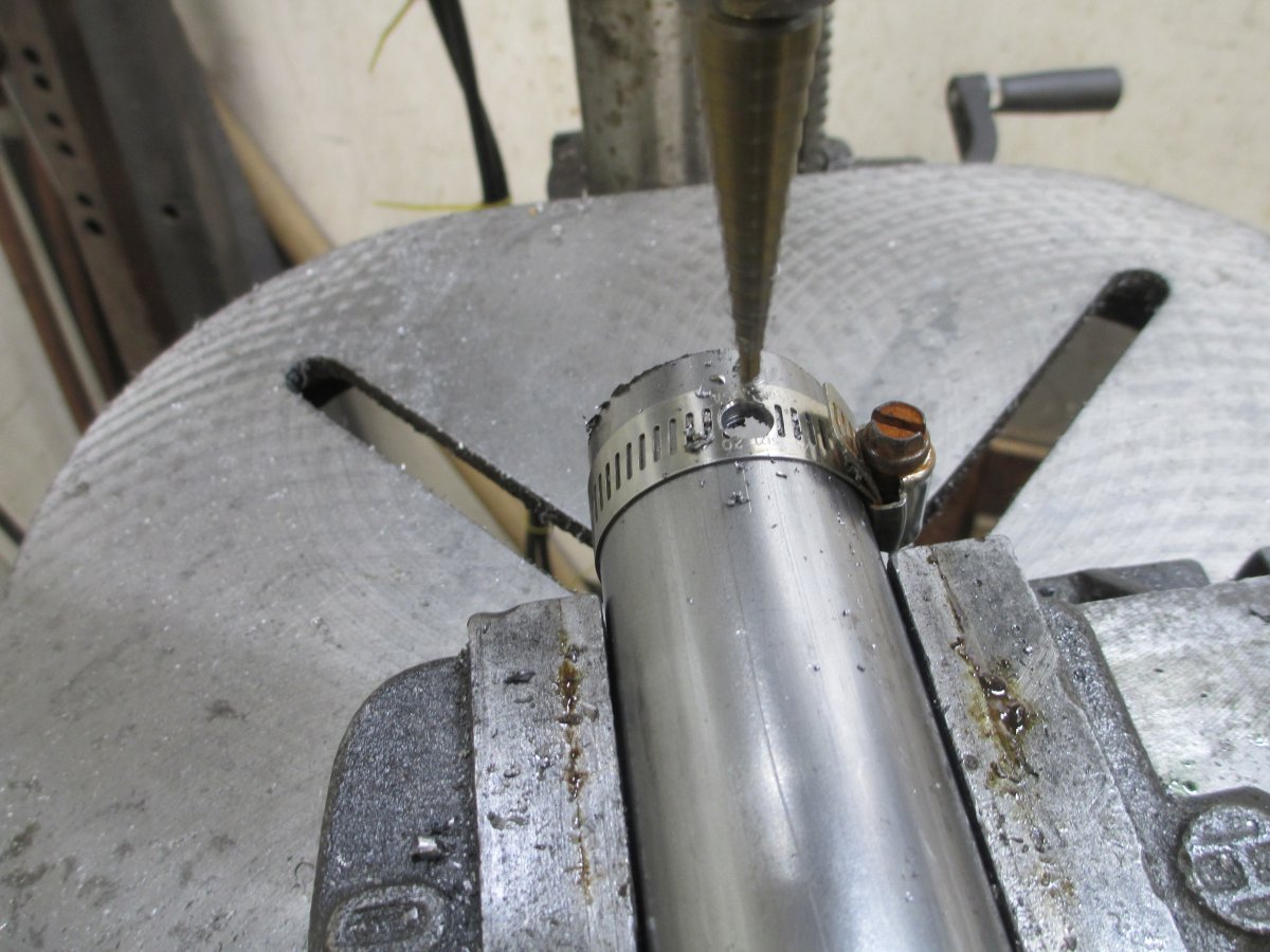

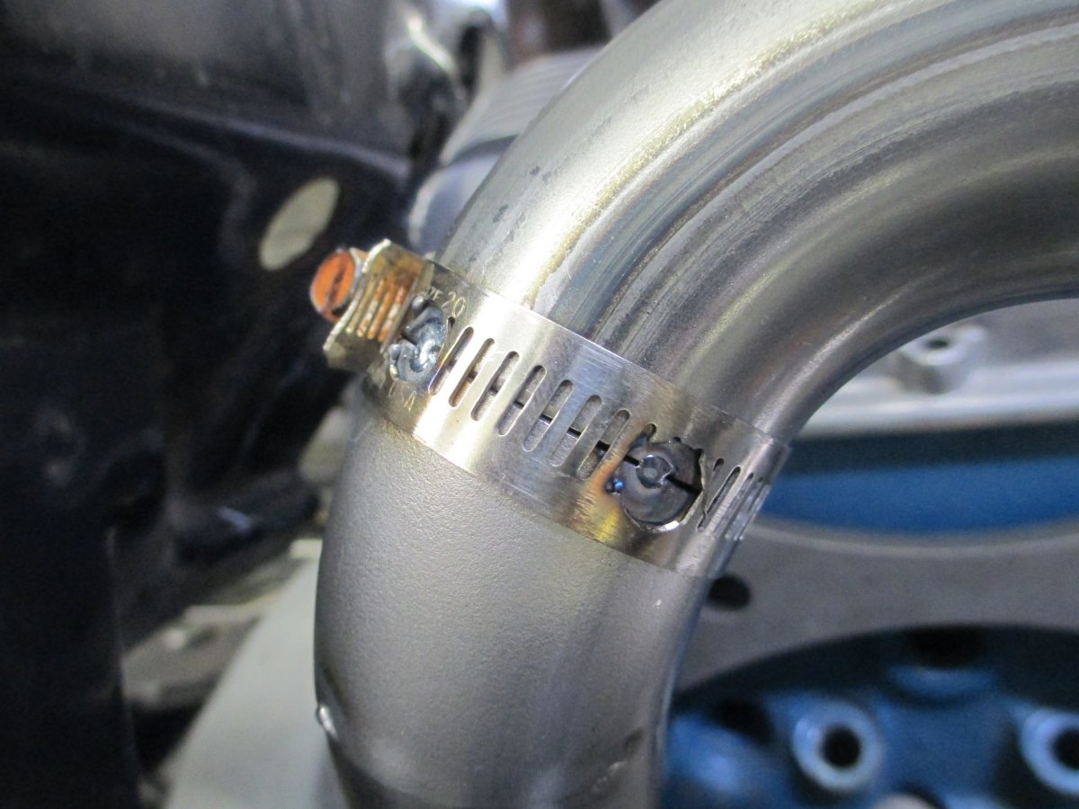

    Back on the headers today. The first 4 pics, illustrate how I solved the problem of holding and tack welding the joints. Tacking with a tig can be difficult while trying to hold the sections together tightly. About 20 years ago I devised the method shown, it doesn't work in all applications, but it gets rid of much frustration. One more pipe to fit, after lunch, and then I can mark and cut the pieces for the other side. IMG_4765.JPG IMG_4766.JPG IMG_4769.JPG IMG_4770.JPG IMG_4771.JPG IMG_4772.JPG IMG_4773.JPG IMG_4774.JPG IMG_4776.JPG
  19. alchemy
    Joined: Sep 27, 2002
    Posts: 22,680
    alchemy
    That clamp is engine-ious!

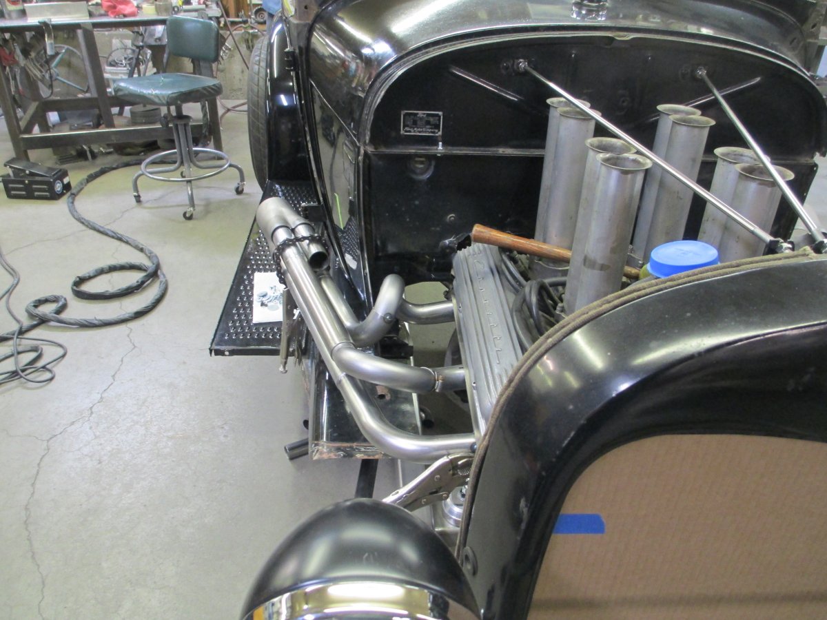

  20. Marty Strode
    Joined: Apr 28, 2011
    Posts: 9,685
    Marty Strode

    Marty, that's a good lookin set of headers!!!!!

    Those headers are beautiful.:cool:
    That had to have been a LOT of measuring, eyeballing, head-scratching, t*******, repeat...o_O

    I like your hose clamp alignment tack weld device!
    On the collectors, did you block
    off the center of the union with a square(ish) plug or make a cone?
