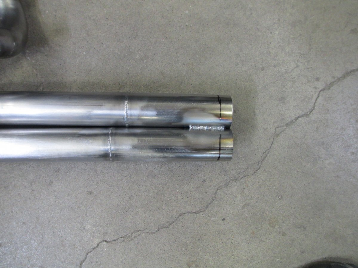

    Frenchtown, I haven't finish welded the one side yet, I usually fab a cone, trying to emulate a set of merge collectors. I will post pics of the finished product.

    Blues, this being the street set, the tubes are 1-5/8, and step up to 1-3/4. The compe***ion versions will start at 1-3/4 and step to 1-7/8. You are right, the slip joints, certainly make the fitting and welding somewhat easier. Now is the time for you to round up some bends and get started, let me know if I can share some advice.

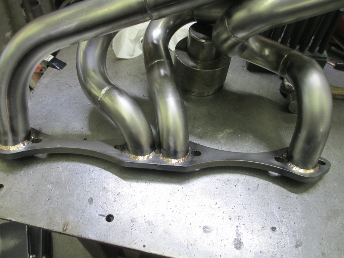

    Gary, one of the toughest parts of the job, is shaping the starter tubes at the flange, on the center two ports, without a straight section. The end ones are easy, just a little squeeze and you have a nice oval.

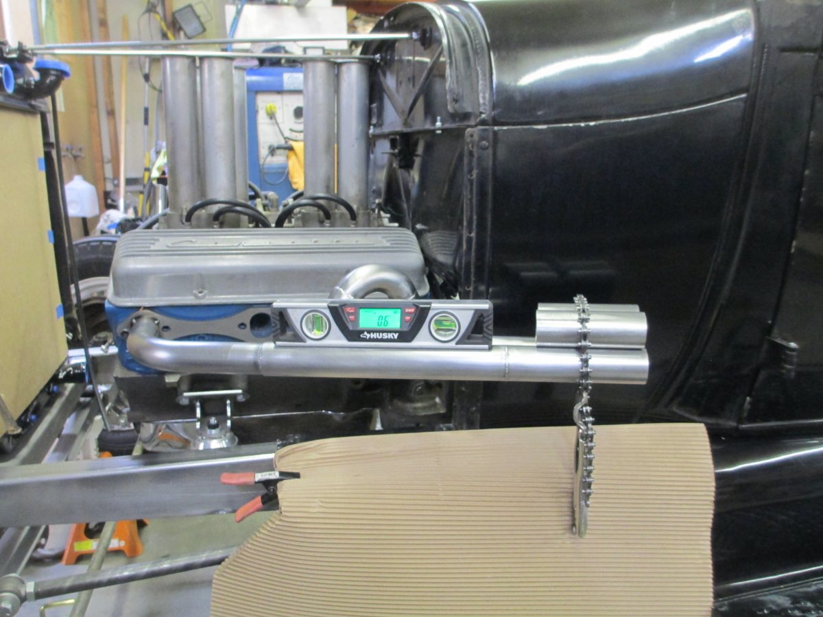

    Got a late start today, built 2 more pipes for the driver side, one to go. I was able to fully weld the pipes as I go, since they are a mirror image of the other side, at least as close as I can. Can't wait to see it with the fender back on, and the collectors welded on. IMG_4835.JPG IMG_4836.JPG IMG_4838.JPG IMG_4841.JPG IMG_4843.JPG IMG_4844.JPG

    Got the flanges welded on the inside, and ran some silicone bronze on the outside, along with welding all four pipes together at the back. All that is left, is closing the diamond shape between the pipes, and installing the collectors for good. I needed to see it on the floor, with the fender back on. IMG_4847.JPG IMG_4848.JPG IMG_4849.JPG IMG_4851.JPG IMG_4854.JPG IMG_4855.JPG

    I’ve been using silicon bronze for decades on pieces that I will dress the welds on. Apparently not too many know about it.

    I like the little "up tick" you gave the 3rd pipes back to get them equal length. Gives the headers just the right amount of "visual at***ude" to set them apart from the usual sets.

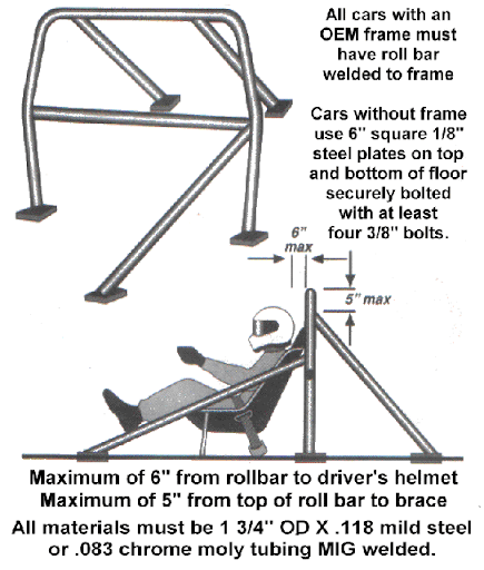

    I had planned on building another set, with 1-3/4" primaries, stepping up to 1-7/8", but I have encountered a snag, with my overall plans. For as long as I can remember, a bolt-in roll bar was legal, in both uni-body and full frame cars, for some time, it would allow 1/4 mile times as quick as eleven flat. This truck should run closer to ten flat, but I was OK running low elevens. Now, looking at the current rules, bolt in is legal with uni-body, but not for OEM frames. Welding the bar to the frame, is out of the question, as it would prohibit removing the body and box. I can still run the truck at two different venues, Riverdale Raceway (Billetproof) and Eagle Field, but I had plans of running Wednesday nights at Portland International Raceway. With the limitations, there is no need to go to extra trouble, to gain performance I can utilize.

    Marty, do you just want the option to remove the body, or do you see a need to once the car is finished. The roll bar in the old red car was welded to the frame with the center bar bolted to the rear cross member, and dutchman clamped to the hoop. In all the years of racing and re painting, there was never a need to pull the body off the frame. The bed was off a couple of times, but not the cab. I hate to see a car that can run 10's be limited to 11's.

    Dean, since I am not doing the body justice and painting it like it should be, that's my dilemma. The 2 rear struts have to be welded to the frame as well, trapping both the body and the box. I suppose I could drill the rivets out of the Body back panel and the front panel of the box, and bolt it together, with Allen ****on heads.

    I wonder why they specify MIG welded? That does not seem right - TIG should be allowed, even preferred.

    Joined: Apr 28, 2011

    I think that was a misprint.

    Do it how you think best Marty, but if it were mine, and that ***** would 10's, by God, that's what I'd set it up to do. Have some fun with it!

    So, I wonder what will happen the first time somebody shows up with an all-MIG welded roll bar? Or worse yet one is discovered in a post-wreck ****ysis of why the cage broke up. I've seen some MIG welded test coupons that looked good visually and you could whack it with a big hammer and break it cleanly apart.

    When we built our '46 coupe in the '80's, it was built to NHRA specs, it had a bolt in cage, the mounting plates were 3/8" chrome molly plate drilled and taped, cut in a triangle shape and welded to the top of the frame for a six point cage with matching 3/16" plates welded to the tubes. NHRA didn't like it because it wasn't square or rectangle shaped. When the car crashed at Fremont, we took it home and salvaged what we could, not a mounting bolt, nor the cage was bent, sheered, or broken. the cage wasn't even sprung. so much for they're rules.. And yes, I don't understand why they say it's OK to MIG weld chrome molly tube...
