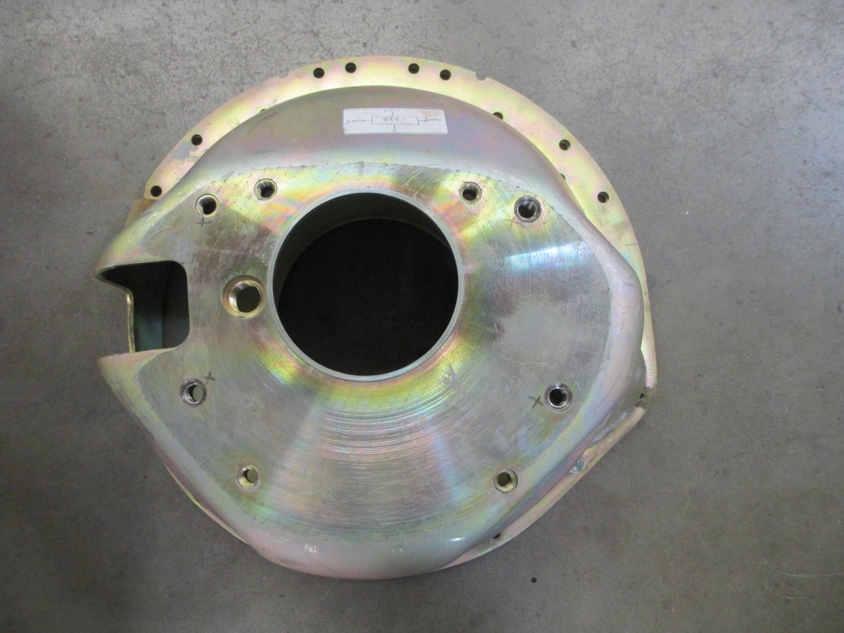

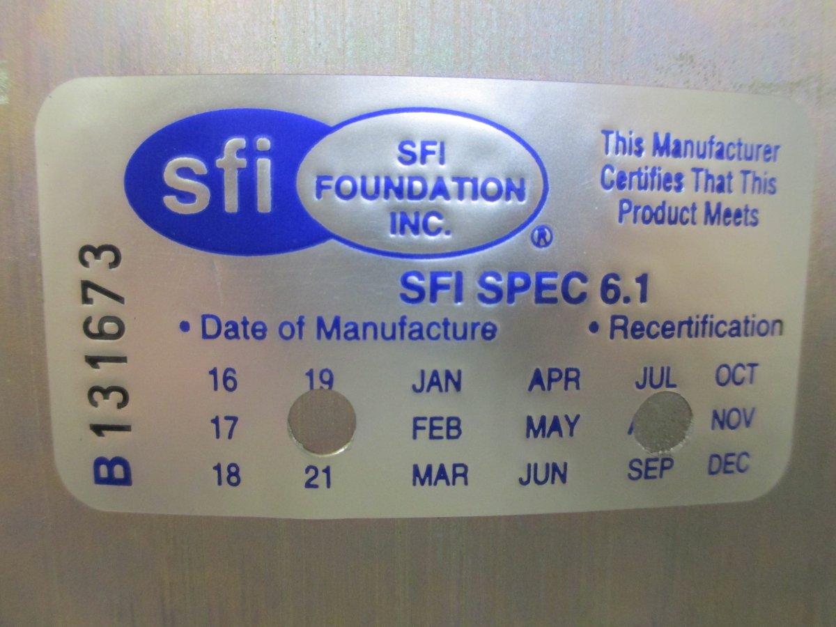

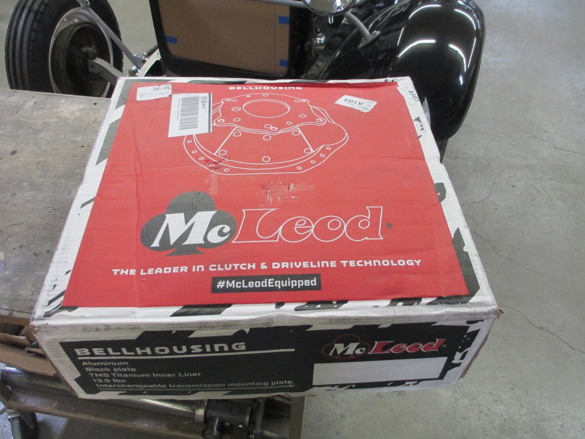

  17. Marty Strode
    Joined: Apr 28, 2011
    Posts: 9,639
    Marty Strode
    The bellhousing came back from McLeod, and I couldn't be happier. The re-certification fee was only $30. and the shipping was $26. Great people to deal with. Thanks again Rich ! IMG_4935.JPG IMG_4936.JPG IMG_4937.JPG
