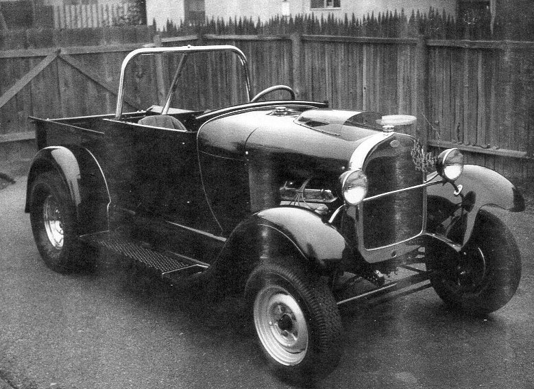

    I was just thinking that Marty’s RPU build looked a whole lot Like Jim Steven’s “ Grant Piston Ring Service” Alhambra Ca. World Champion 29 RPU. That racer was sweet racing with the likes of Bill Roadie’s 27 T- Roadster (spelling may be off) . Fantastic. build!!!!

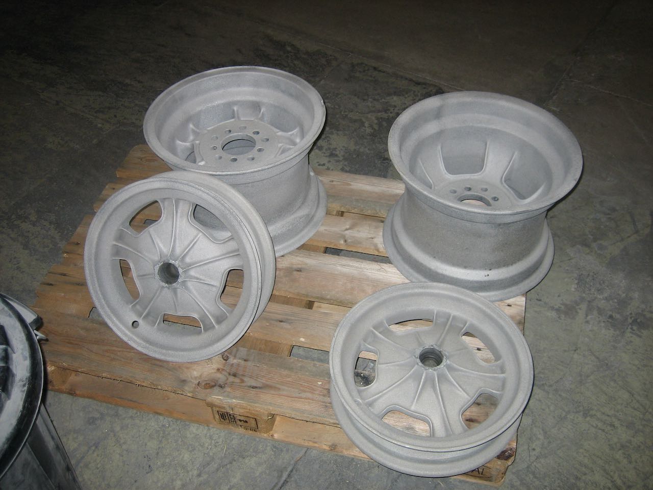

    Looks almost like the DOW 7 that many of those wheels were. I am going to have all 4 spindle mounts blasted, using a special process that a friend does Triumph Motorcycle barrels and cases. And follow up with Gibbs Oil.

    No problem if it is done the right way.
    We did it like this...first blasting, then the parts go thrugh a chemical bath, first degreasing, then anti corrosion/rust.
    Then primer, paint and clear coat.
