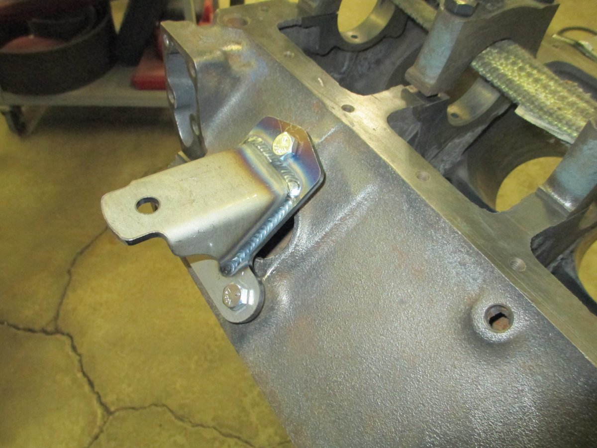

    Today I got the rear frame section squared and tack welded in place. After tack welding the front engine mounts in, I have a 327 block, along with a Mcleod ****tershield dug out and plan to install the engine/trans combo tomorrow. IMG_3716.JPG IMG_3717.JPG IMG_3719.JPG IMG_3721.JPG

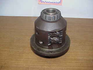

    That's a TruTrac style. Could have been made by a variety of manufacturers. Are there any markings anywhere on it?
    A Torsen Gleason looks like this:

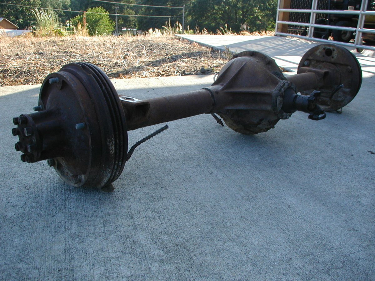

    Bowie is correct, the basis for Championship quickchange rears evolved from the 3/4 ton Timken truck axle that was used in 1939 and up Fords and Studebakers. The wide 5 hubs (Shown) were 39-41 Ford as near as I know. P1010156.JPG

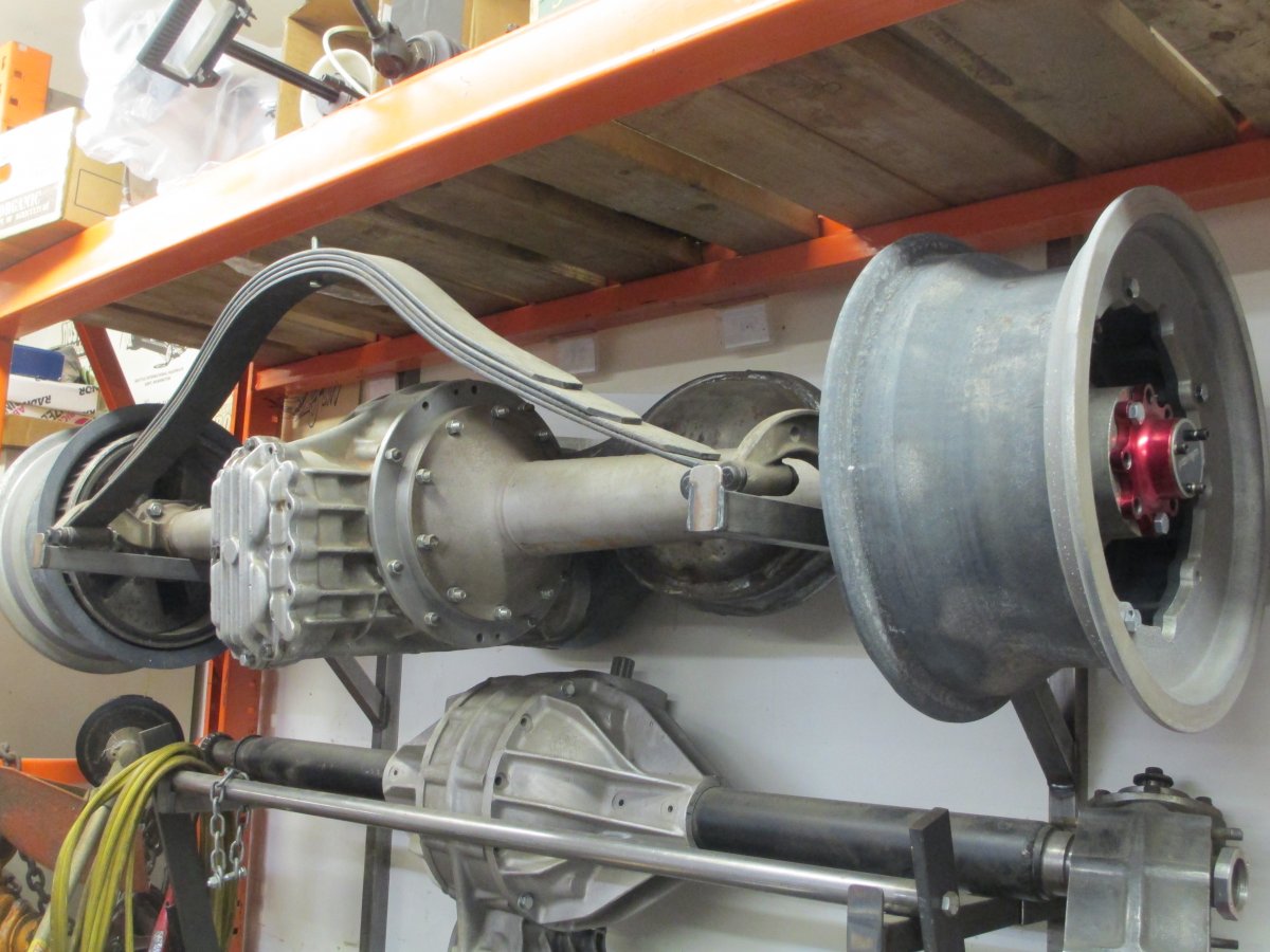

    Really like how you're getting started but I've got a question. Looking at the pic of the rear ends hanging on the wall, how are the spring perches attached? I can't get in close enough to see it. Are they welded directly to the axle tubes?

    The housings are '37-'40 with the stock spring hanger in place. I wanted to retain the spring stretch of v-8 rear axle. The width of a v-8 banjo is 3-3/4" vs 4-3/8" for the Championship, and the thickness of the side plate adapters is 1-1/4. My old friend Lonnie Gilbertson narrowed each housing 1-9/16" to compensate for the width, and pruned off the bearing snouts to fit the bolt on floater spindles. Thanks for your interest. IMG_3738.JPG

    Bruce, The only markings I found were engraved on the center barrel, LG333R, I know the L &R designate right and left. Is a TruTrac similar to a Dan Press Gold Trac ? BTW, did you notice you and Swade41 share the same Avatar, hard to miss ! IMG_3739.JPG
