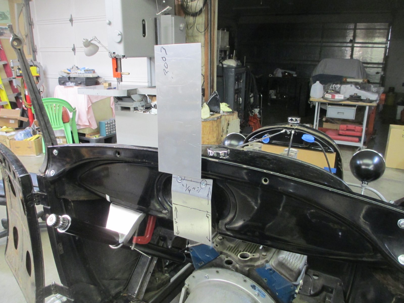

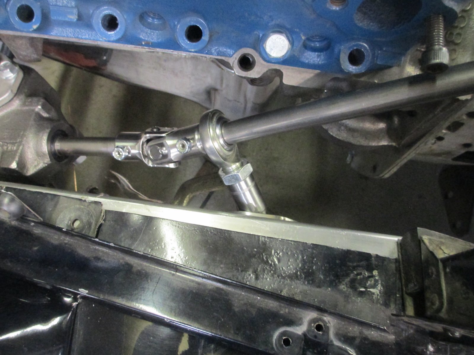

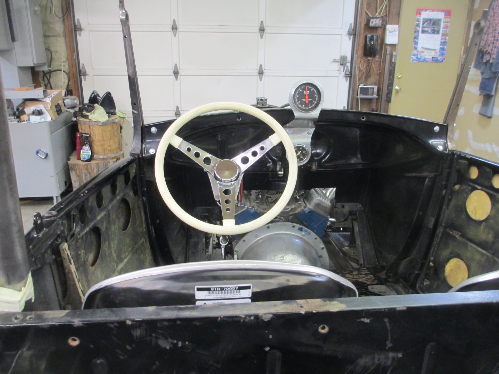

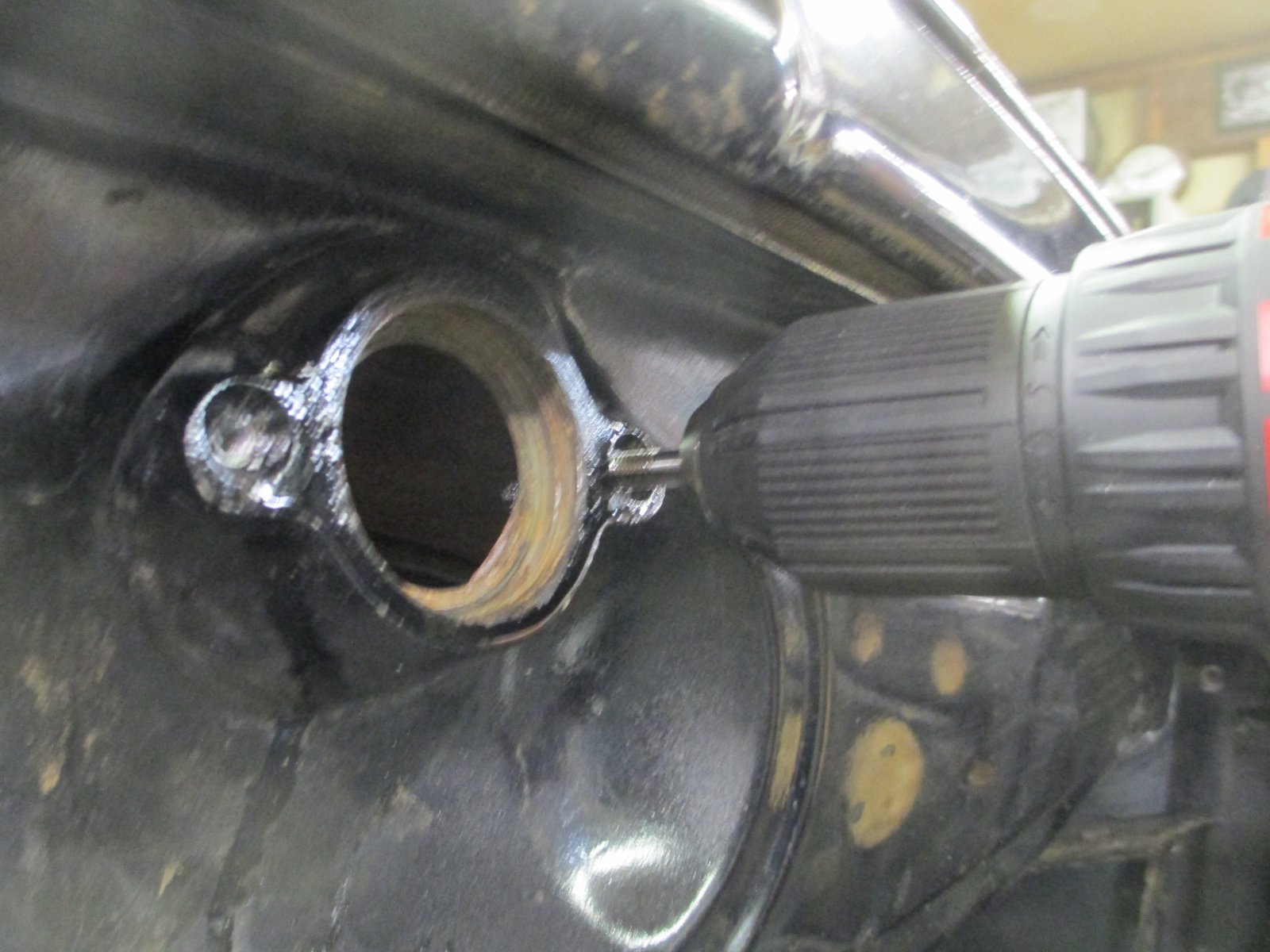

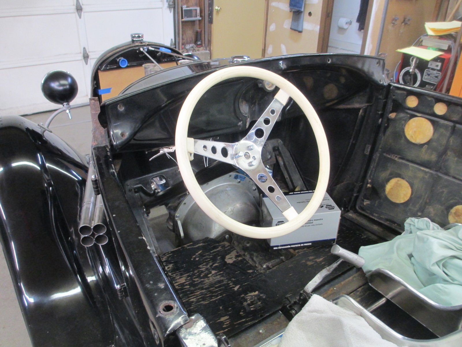

    I got the seat bolted down in the RPU and shortened the steering column 2" today. It took a little milling and cutting the end off. Now I can use the white, dished, steering wheel. The next thing is to build the column drop, then it will require some m***age to the jacket to get clearance around the header flange and spark plug. IMG_8858.JPG IMG_8857.JPG IMG_8859.JPG IMG_8860.JPG IMG_8862.JPG IMG_8861.JPG

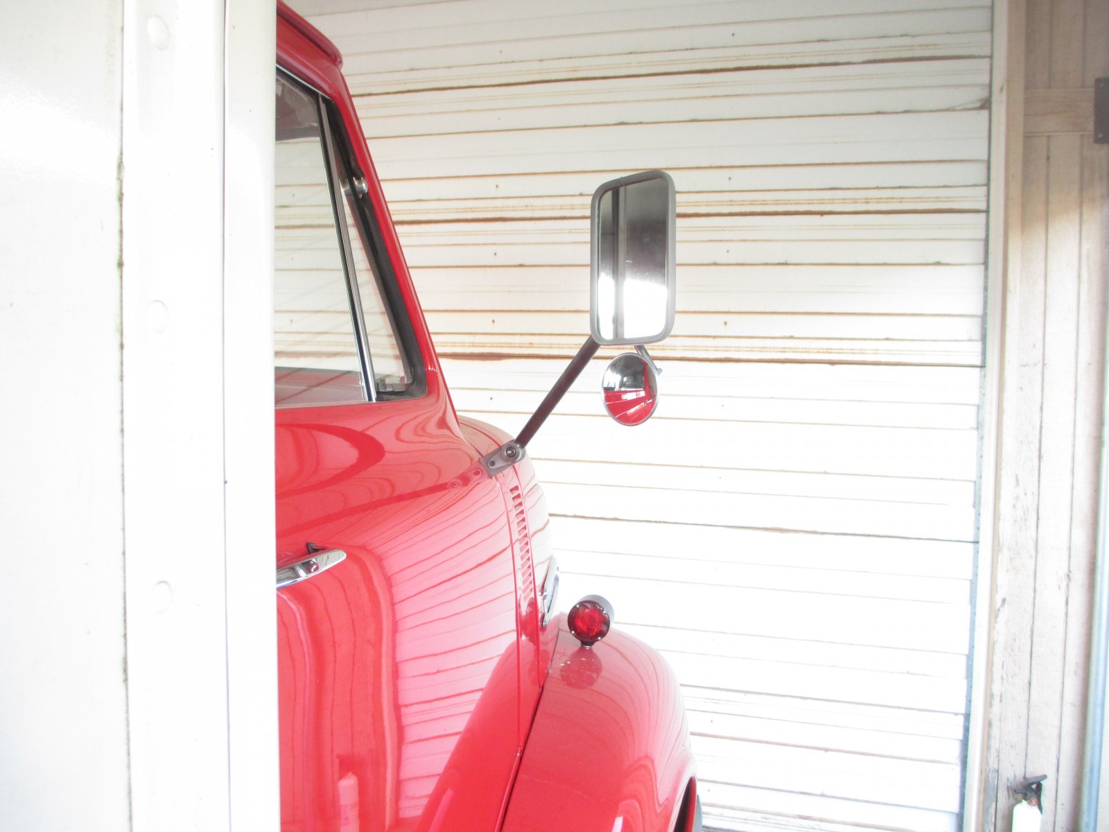

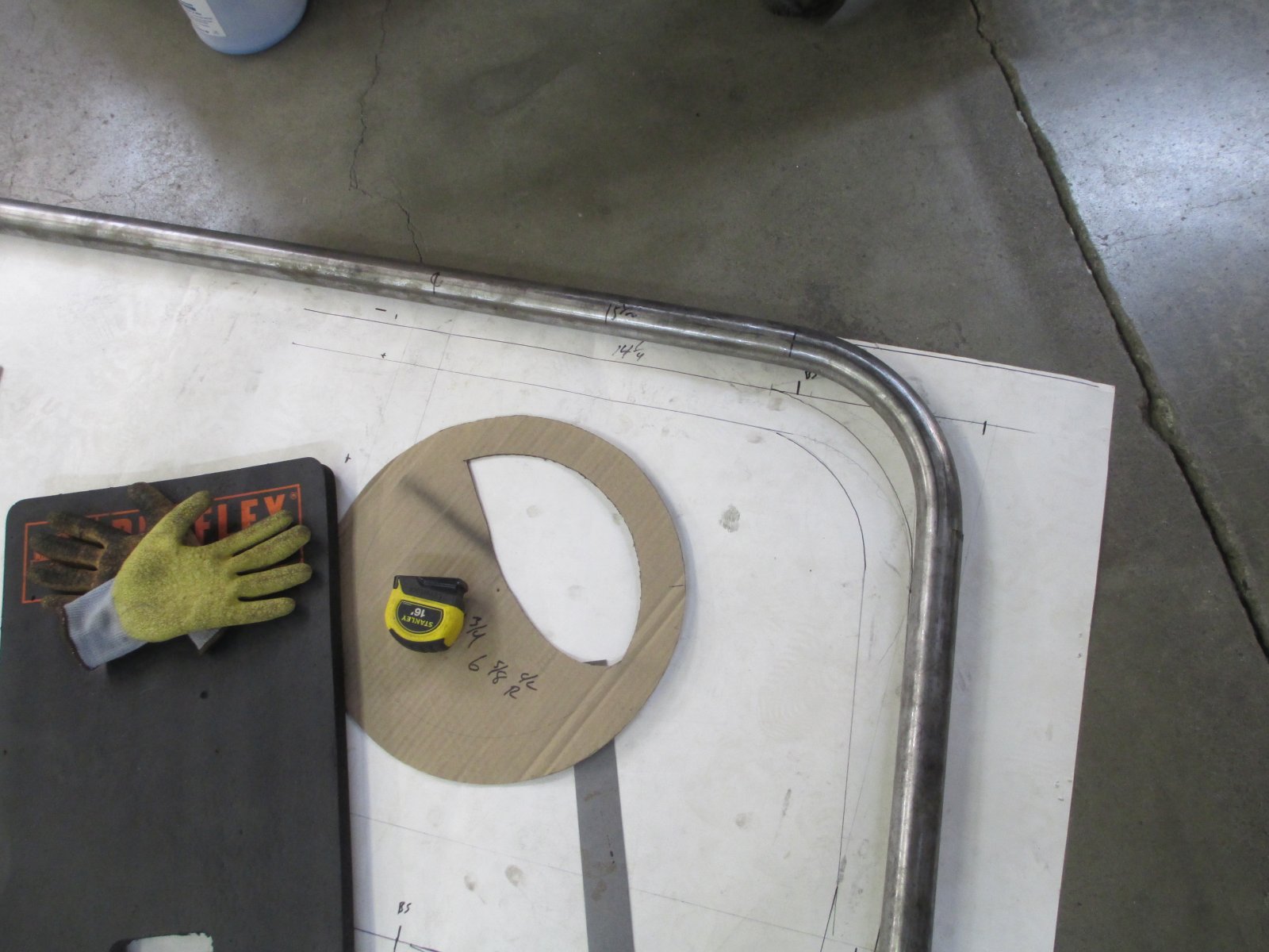

  4. Marty Strode
    Joined: Apr 28, 2011
    Posts: 9,689
    Marty Strode

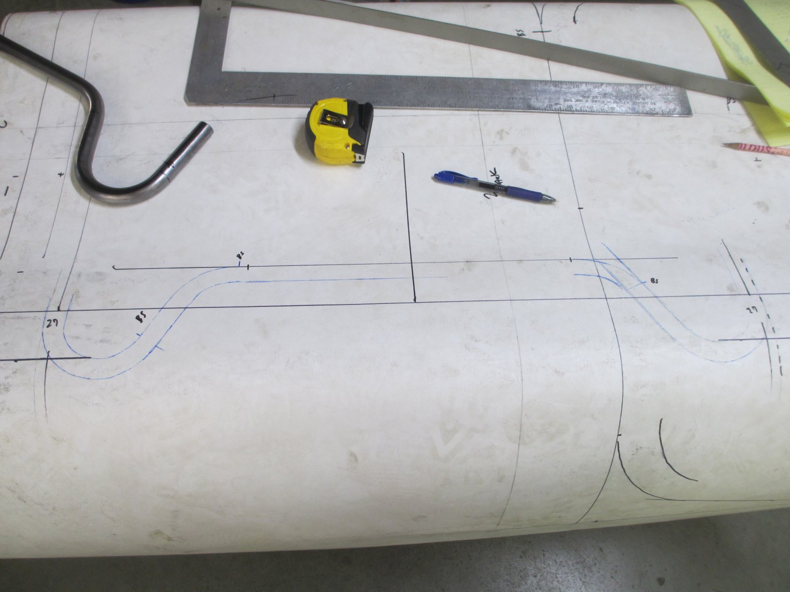

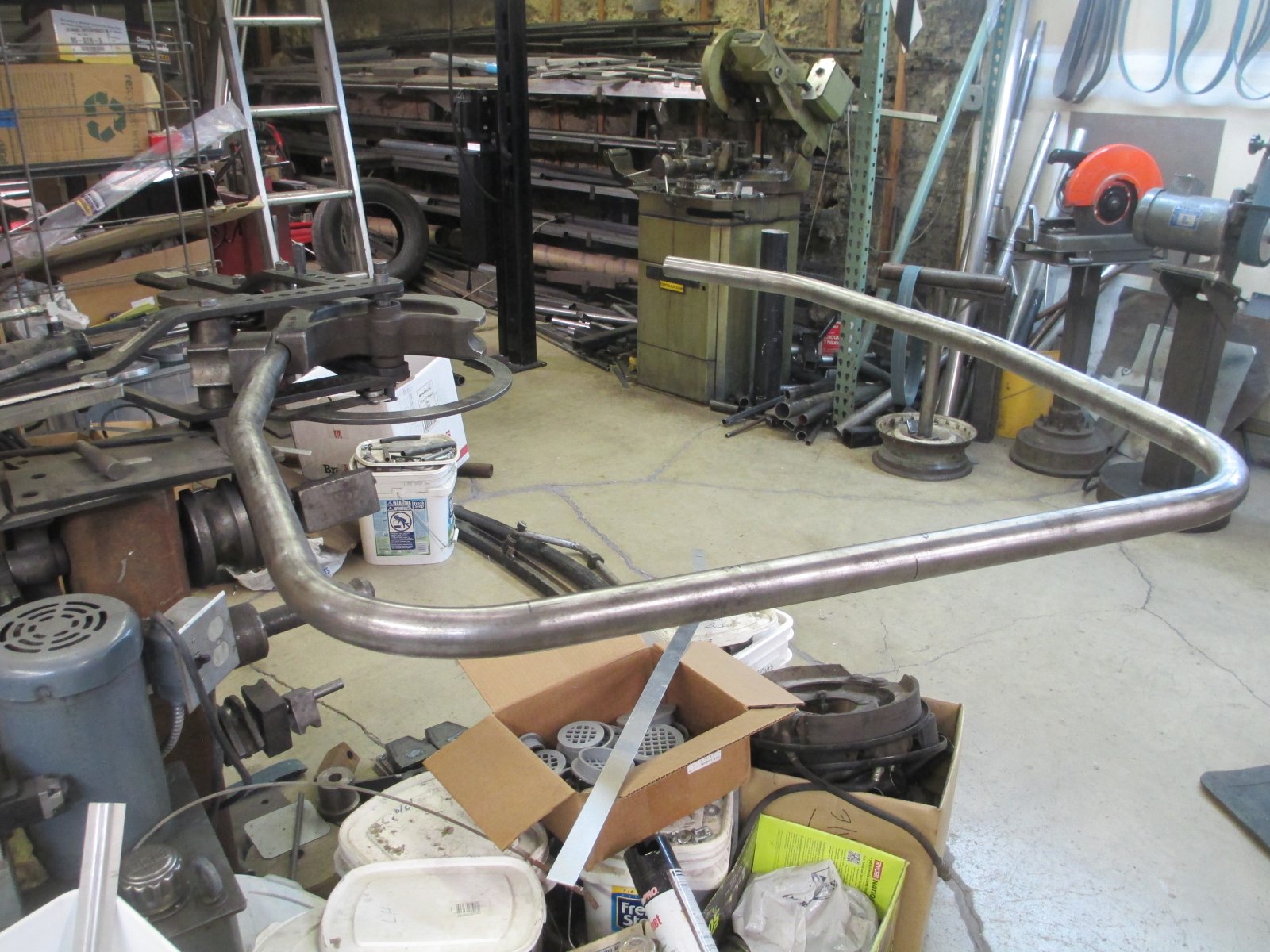

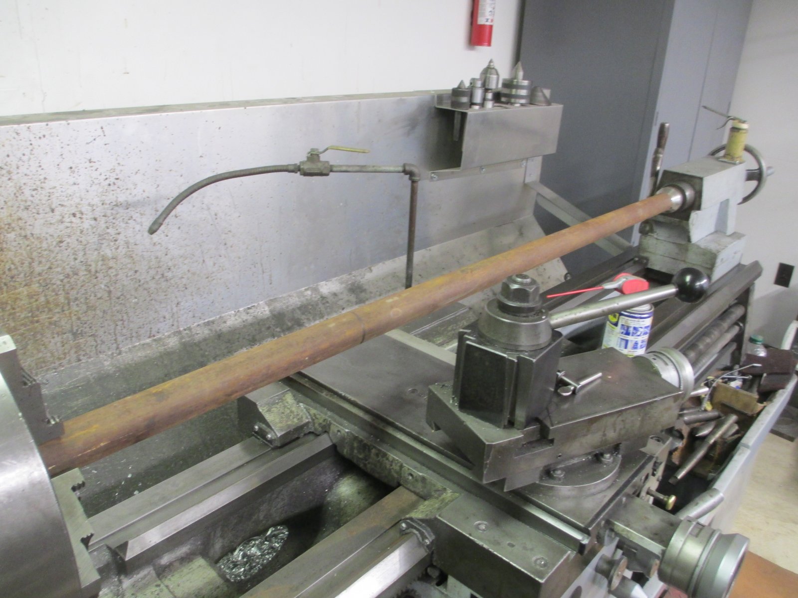

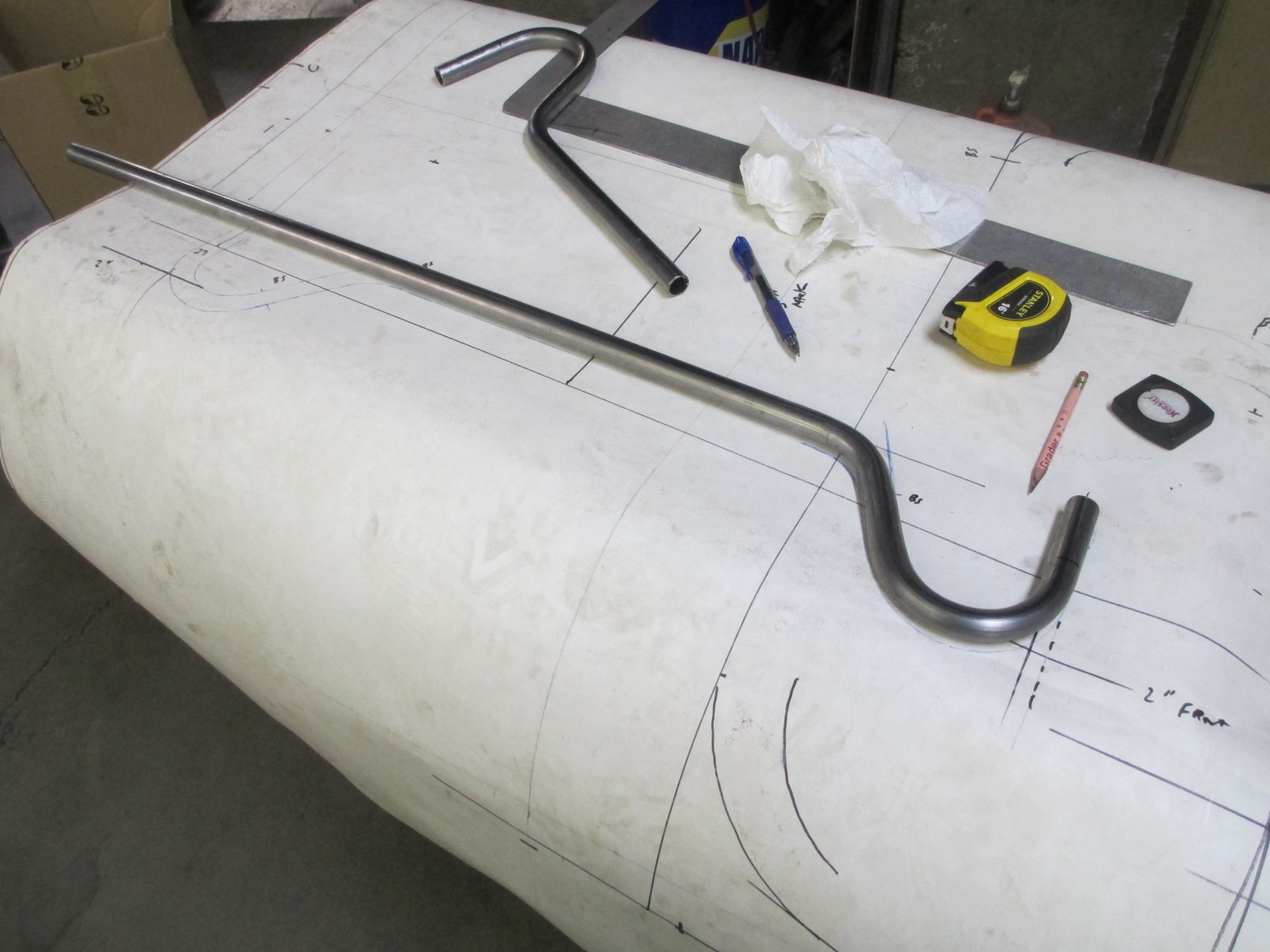

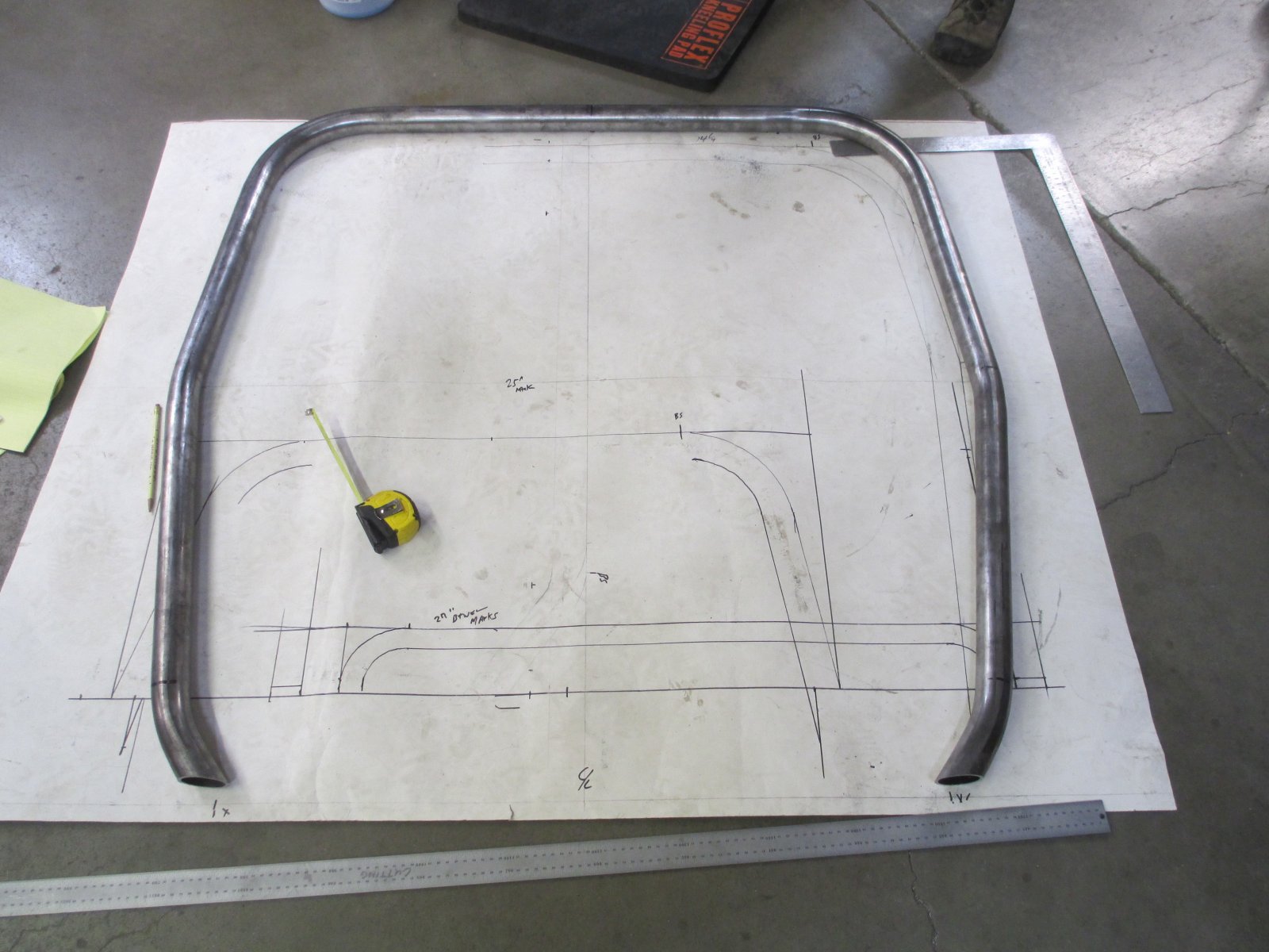

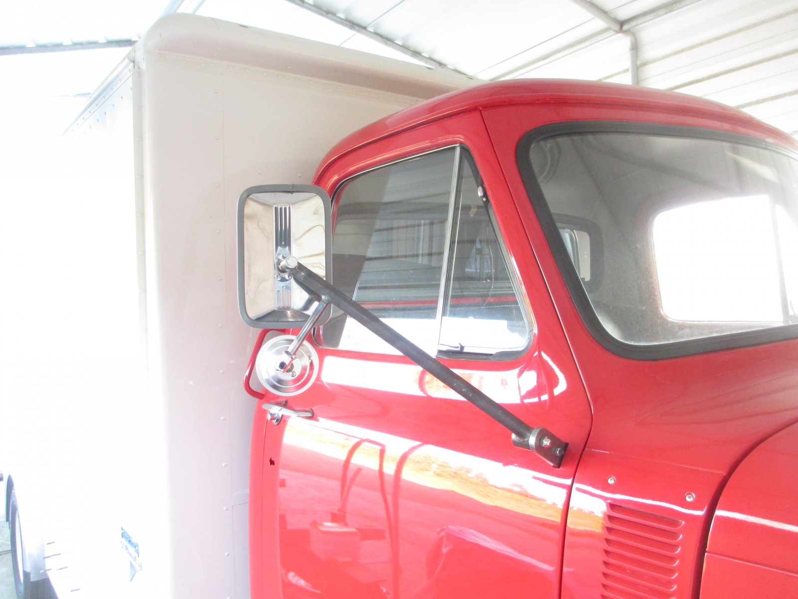

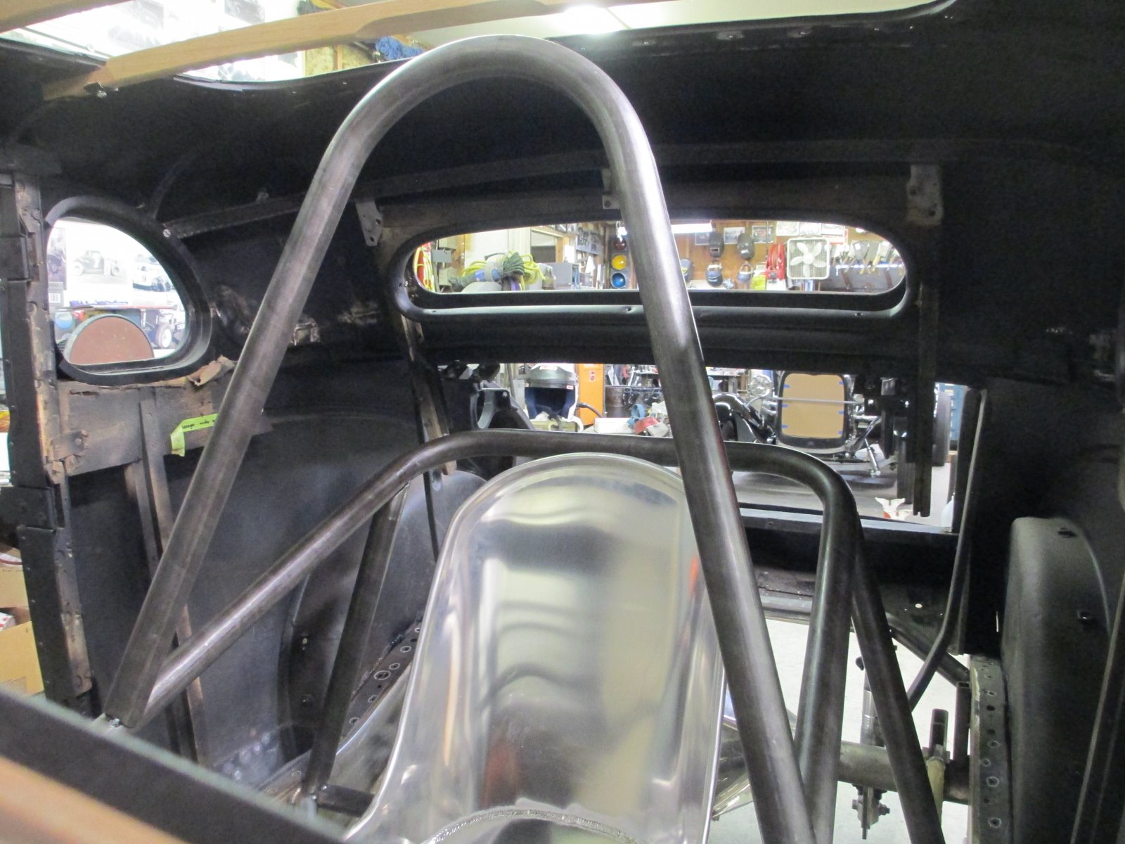

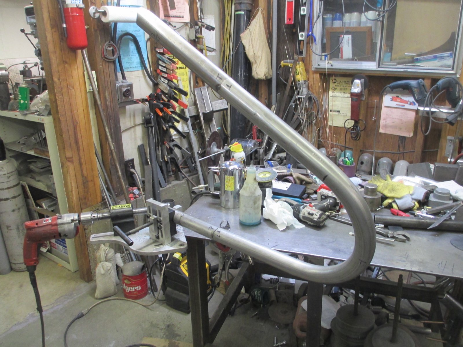

    Well, I had some help today, and got a couple things done. We got the blind spot mirrors mounted on the COE, and roll bar laid out and bent for the RPU. I have about 120' of 1-3/4" X .125 4130 tube, that has been in the weather. Most people would think it's just rusty junk. But a little WD 40, some Scotchbright, and fine Emery cloth, while spinning it in the lathe, it cleaned up great ! I also had a friend that is our NHRA Tech Inspector, look over Derrick's 34 roll cage, and he made some suggestions about the roll bar in mine. It looks tall, but the rules state, 3" over the driver's helmet. It is only sitting in the truck, until I get a short windshield /screen place, and set the final height. IMG_8871.JPG IMG_8870.JPG IMG_8872.JPG IMG_8874.JPG IMG_8877.JPG IMG_8885.JPG IMG_8888.JPG IMG_8889.JPG

  5. Weedburner 40
    Joined: Jan 26, 2006
    Posts: 1,122
    Weedburner 40
    The mirrors look great Marty. I hope they don't vibrate though, that is a long way out there for those supports.

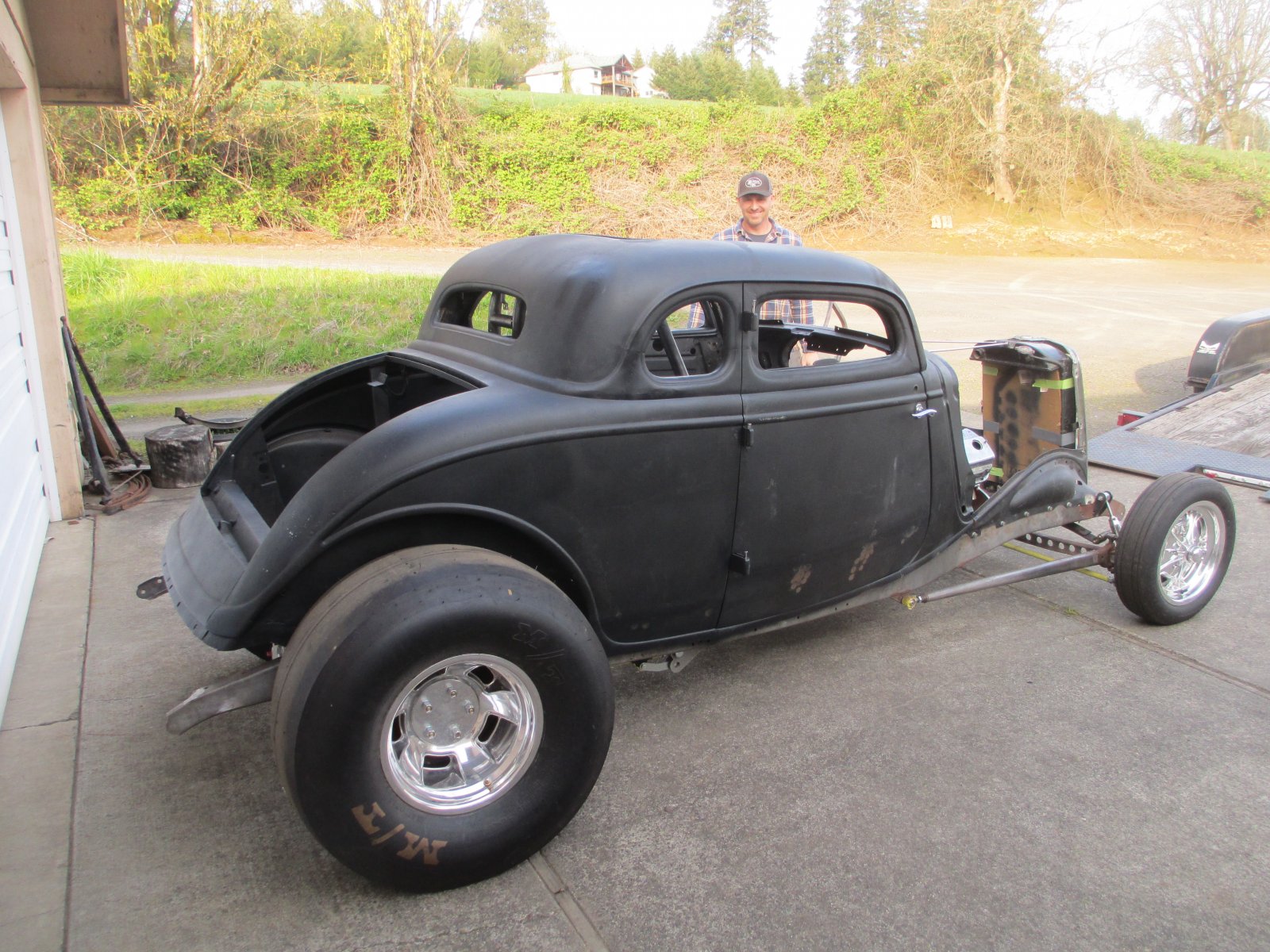

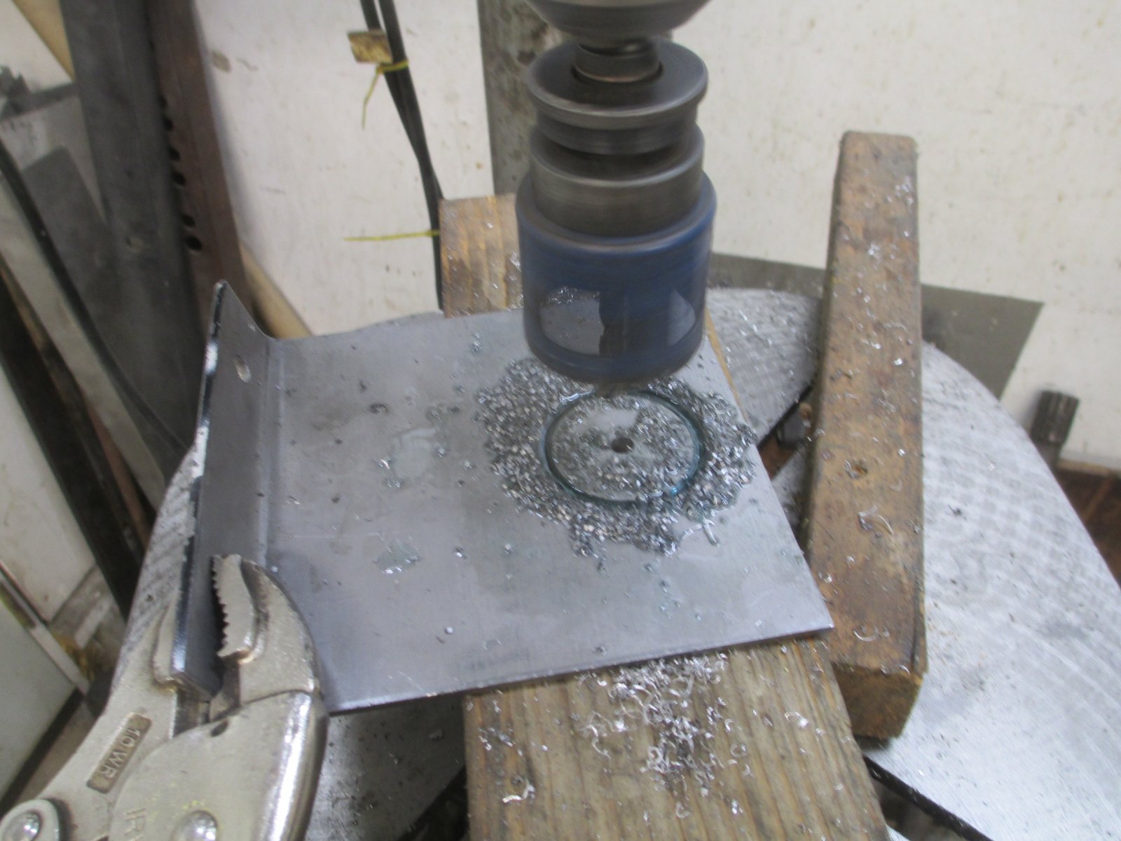

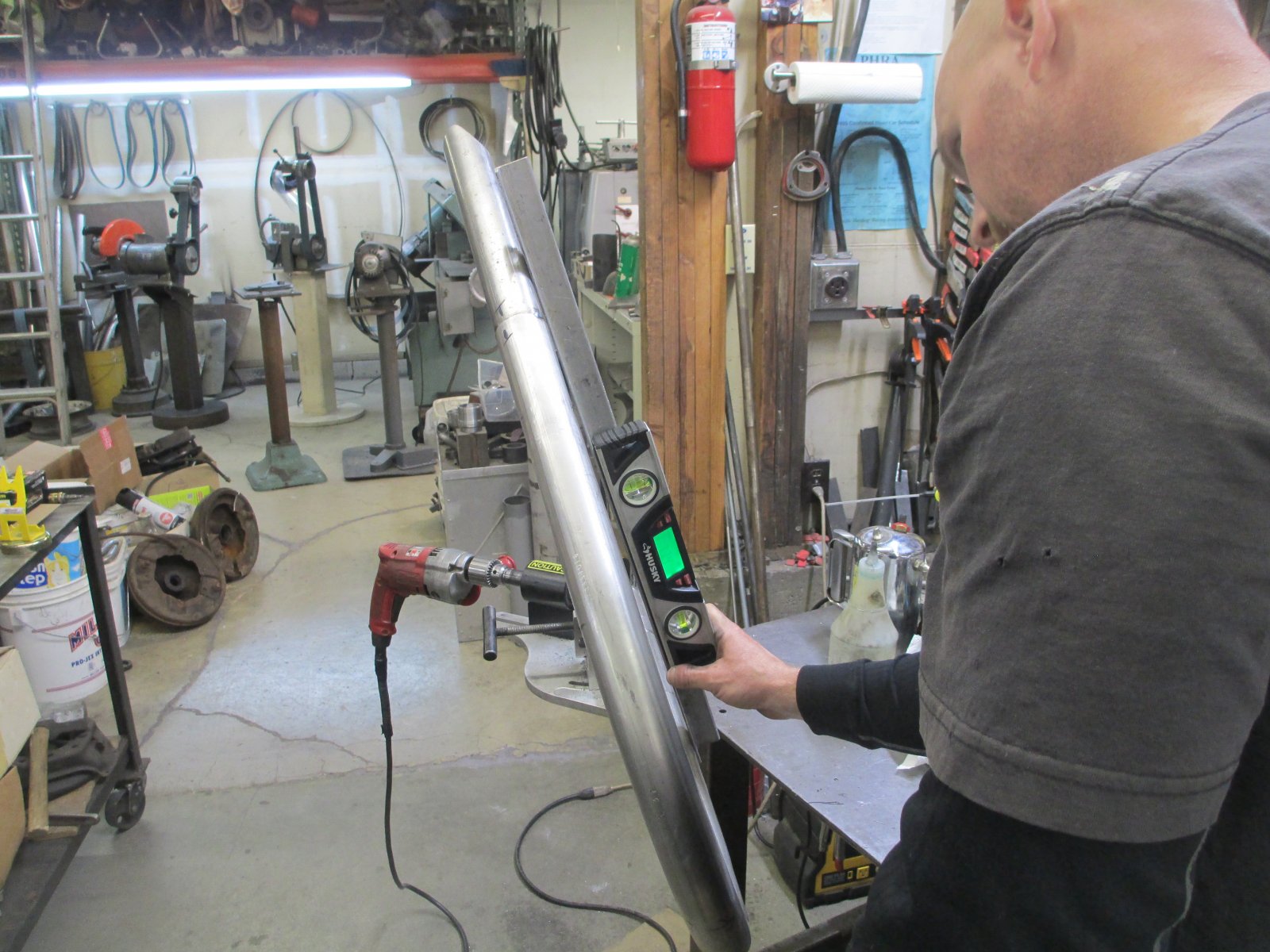

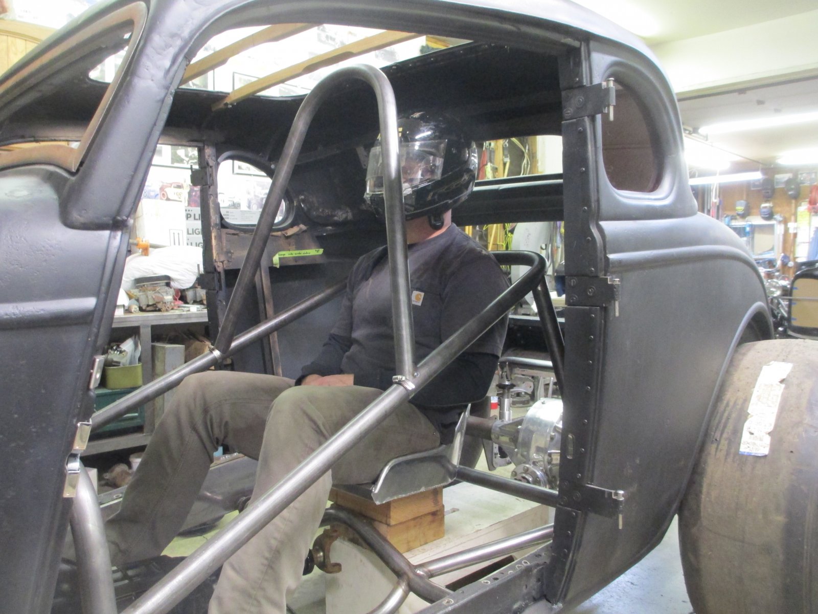

    We worked on Derrick's 34 today, got most of the upper section of the cage fit and tacked in place. The mid bars will come next. IMG_8915.JPG IMG_8922.JPG IMG_8926.JPG IMG_8927.JPG IMG_8937.JPG IMG_8939.JPG IMG_8940.JPG IMG_8940.JPG

    Marty, you always amaze us with neat tricks, like tack welding those short sections of tubing on to guide the hole saw. I'm going to print that picture out and nail it on the wall over my bender!

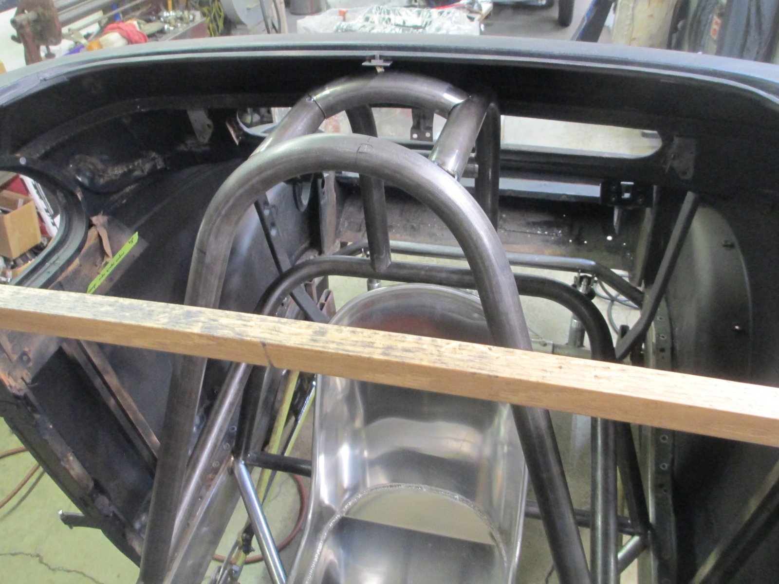

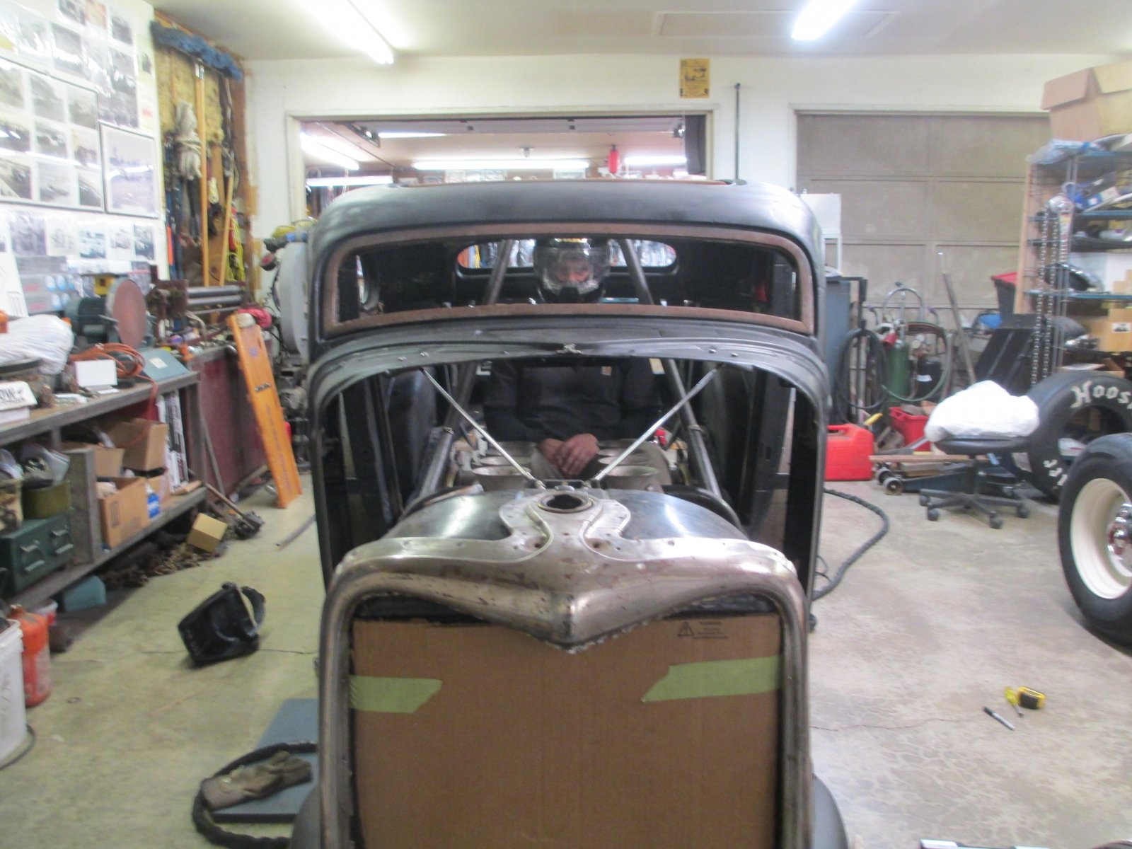

    Well, Derrick and I got the rest of the large tubes in the cage today. The next move for him, is installing the steering gear and the seat. He is a great student, learns fast and picks up the mess, when he is done. IMG_8946.JPG IMG_8953.JPG IMG_8954.JPG IMG_8957.JPG IMG_8958.JPG

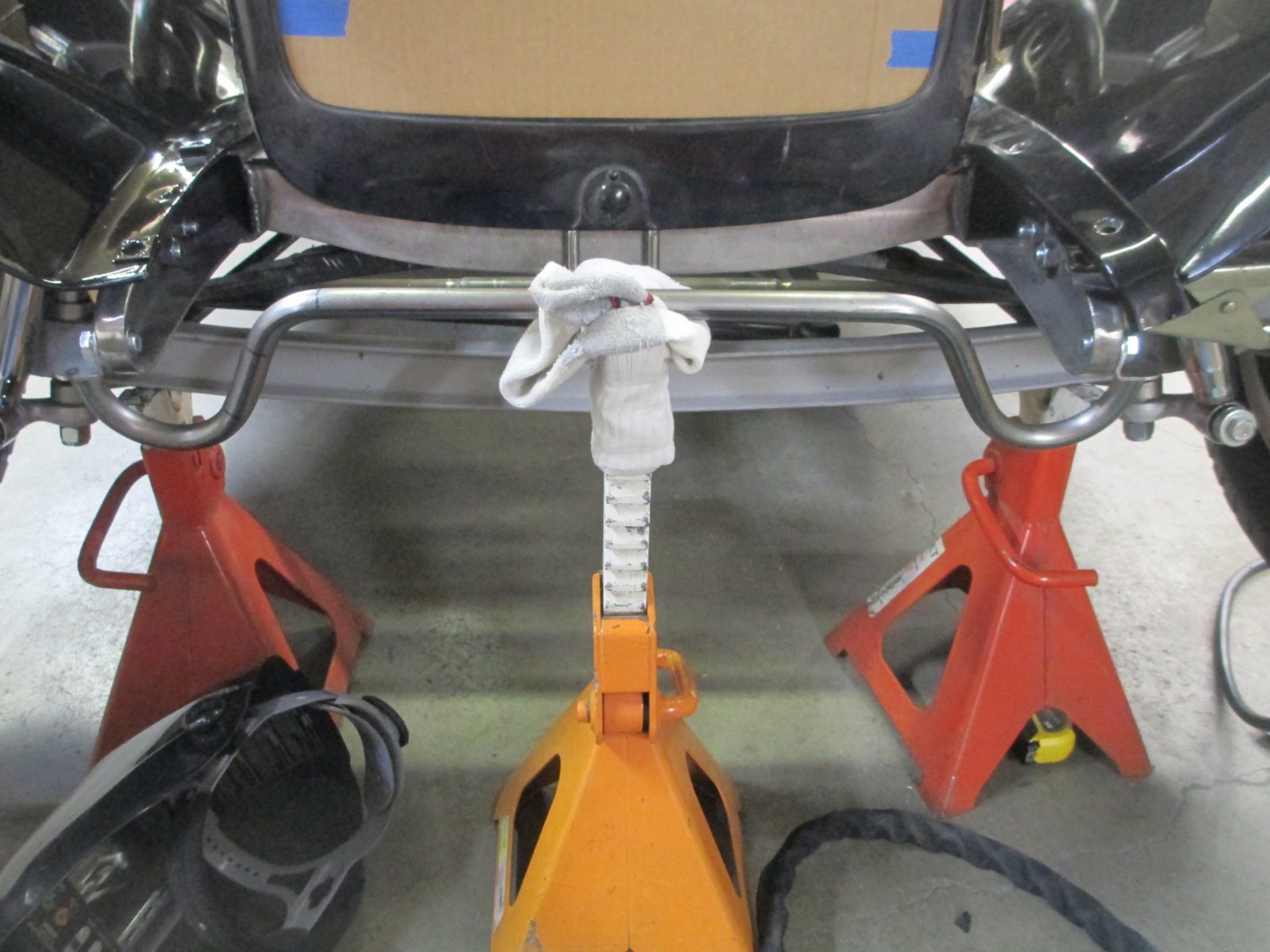

  11. Marty Strode
    Posts: 9,689
    Marty Strode

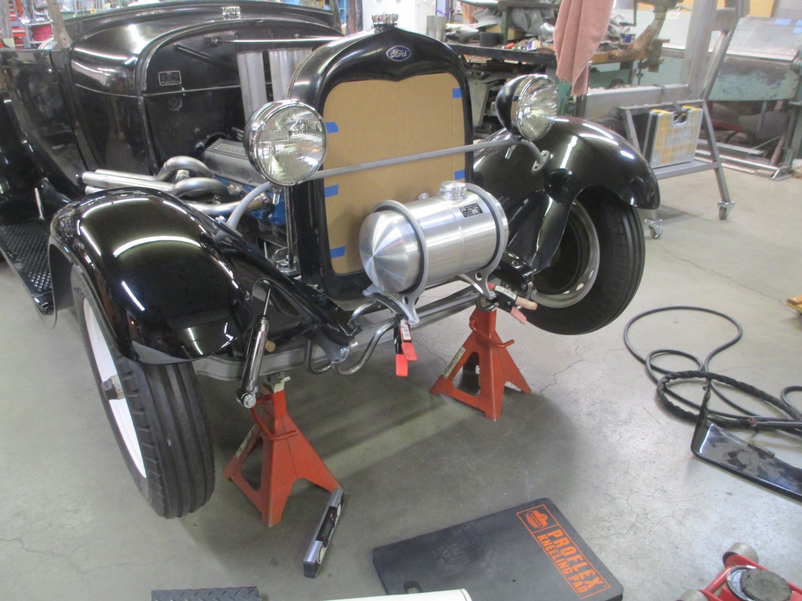

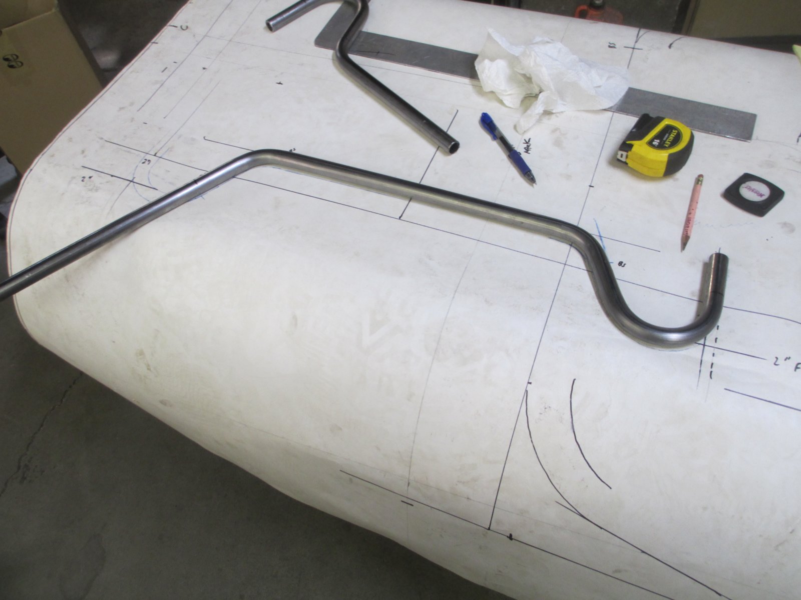

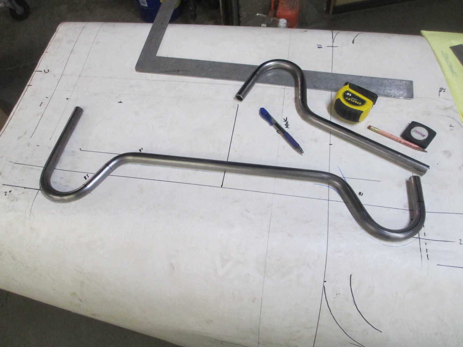

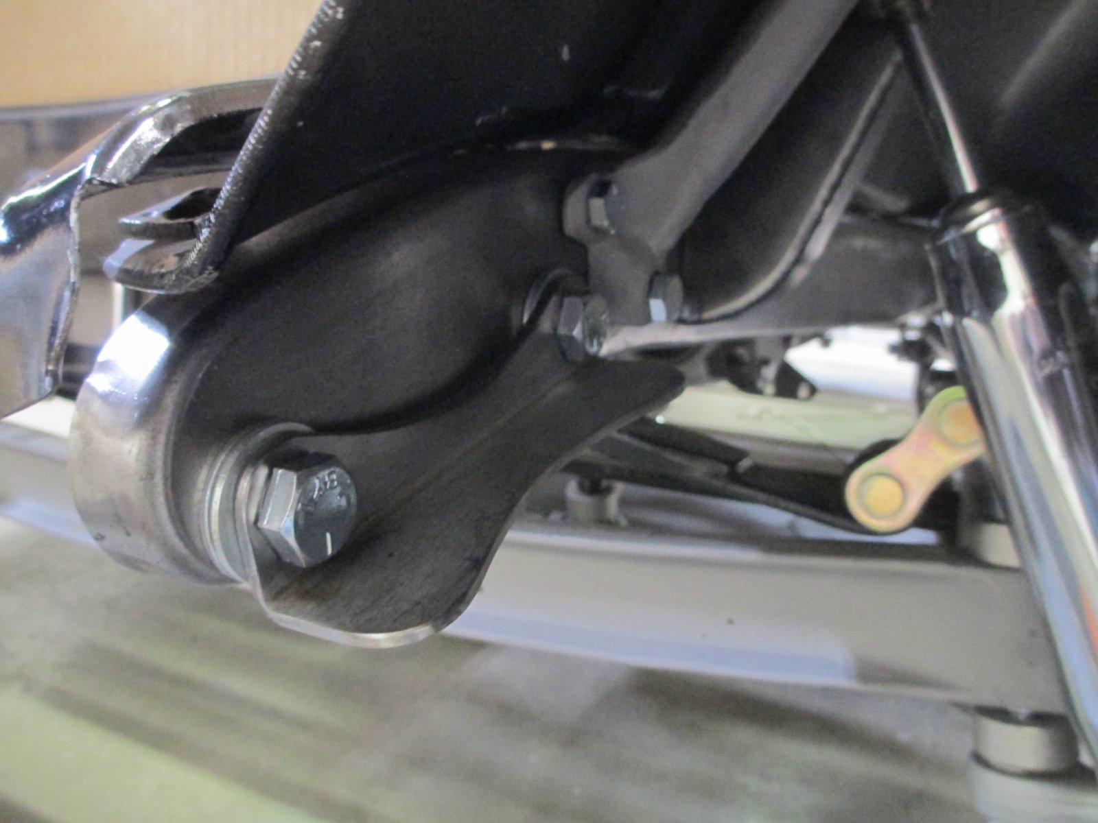

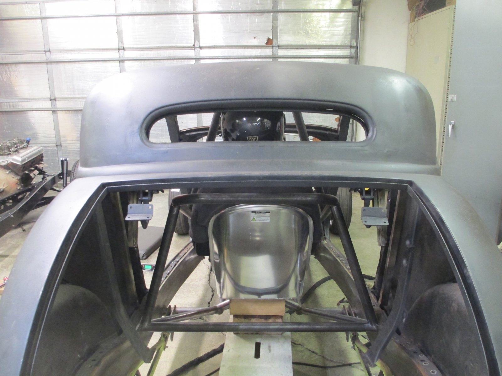

    Today I mounted the Moon Tank, what made the job more difficult was, I wanted to retain the stock front valance, in it's original form. That required mounts outside the frame, and brackets (tubes in this case) curve around and under the frame horns. I wasn't sure I could get all the bend angles correct and wind up with the tank mounting at the proper height. I got lucky, and got them both on the first try. IMG_9008.JPG IMG_9010.JPG IMG_9012.JPG IMG_9017.JPG IMG_9021.JPG IMG_9023.JPG

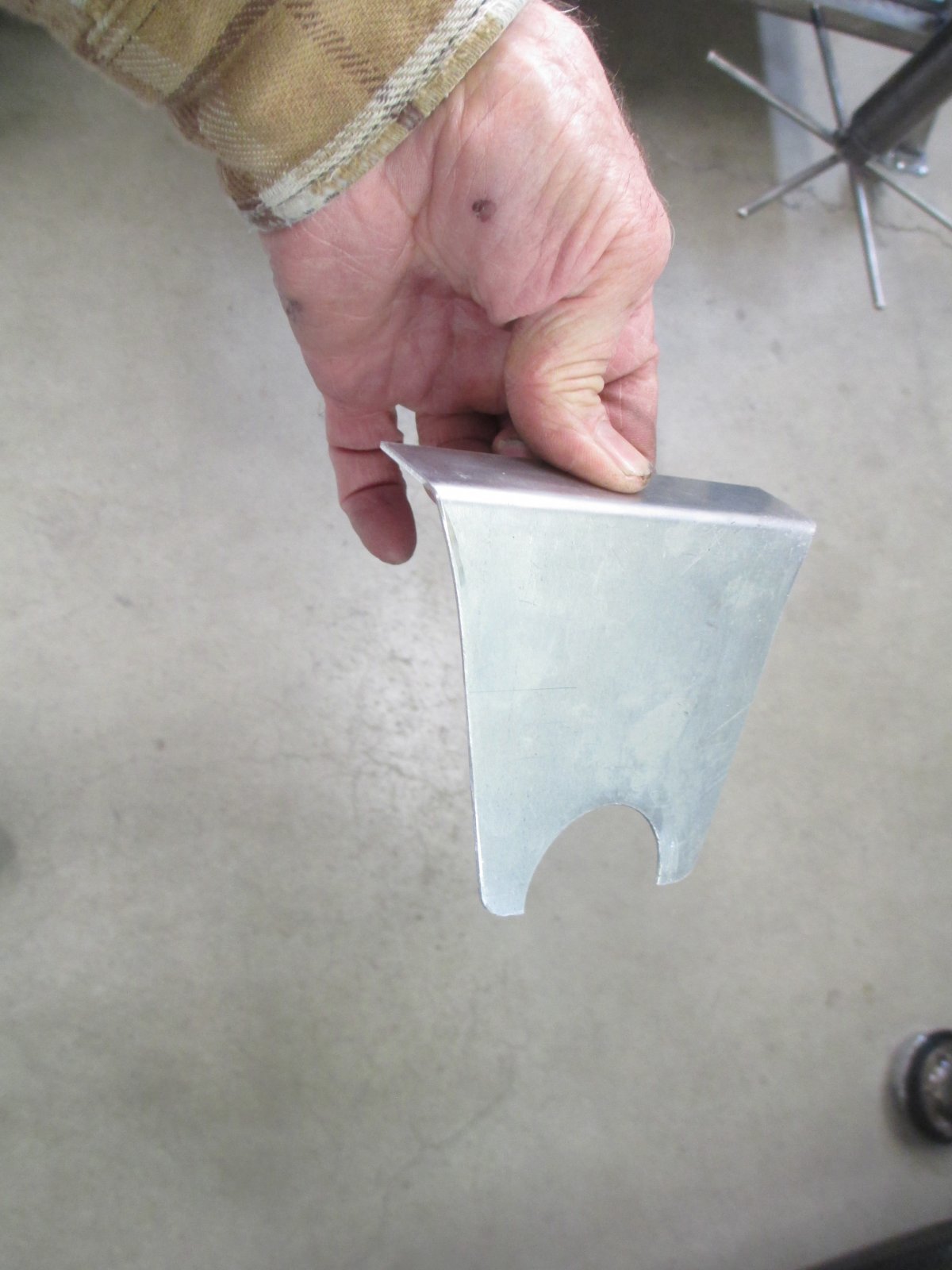

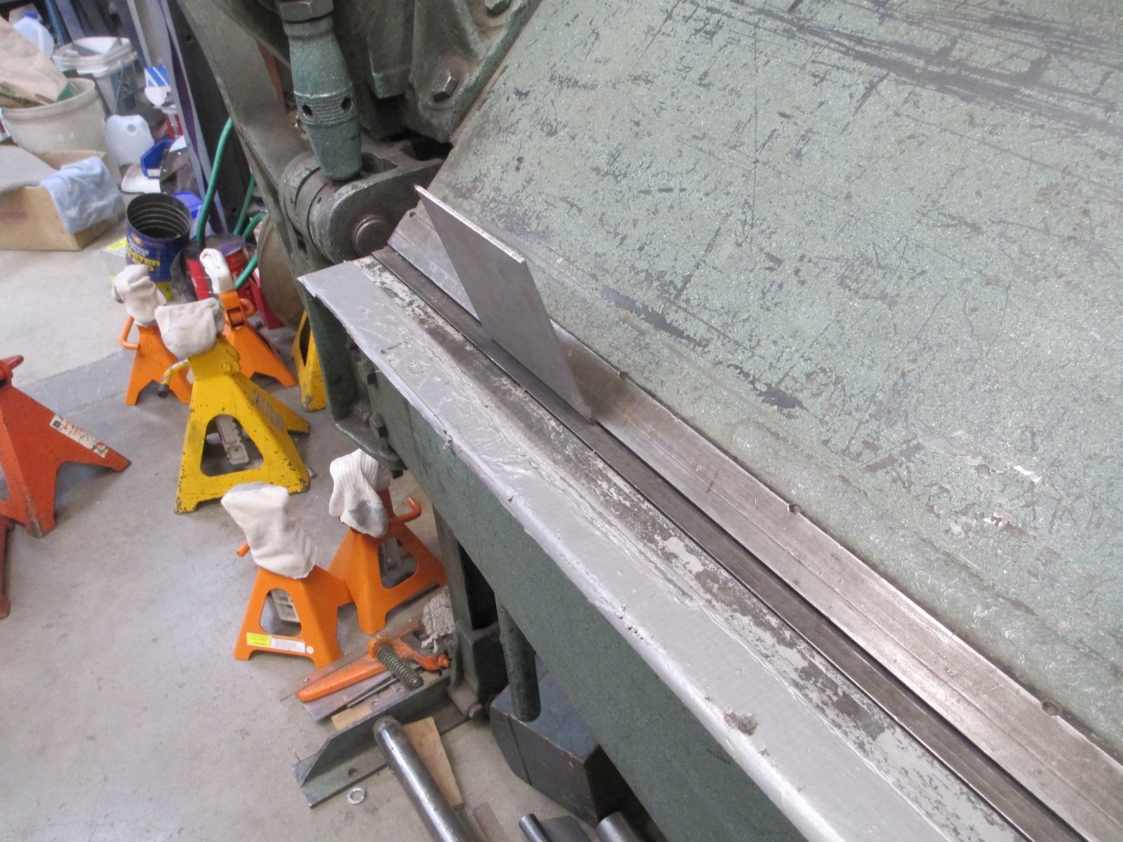

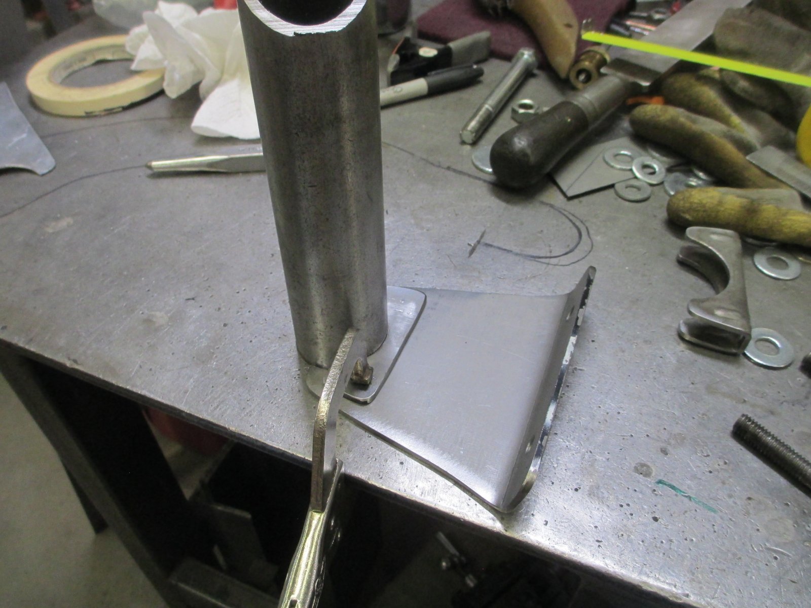

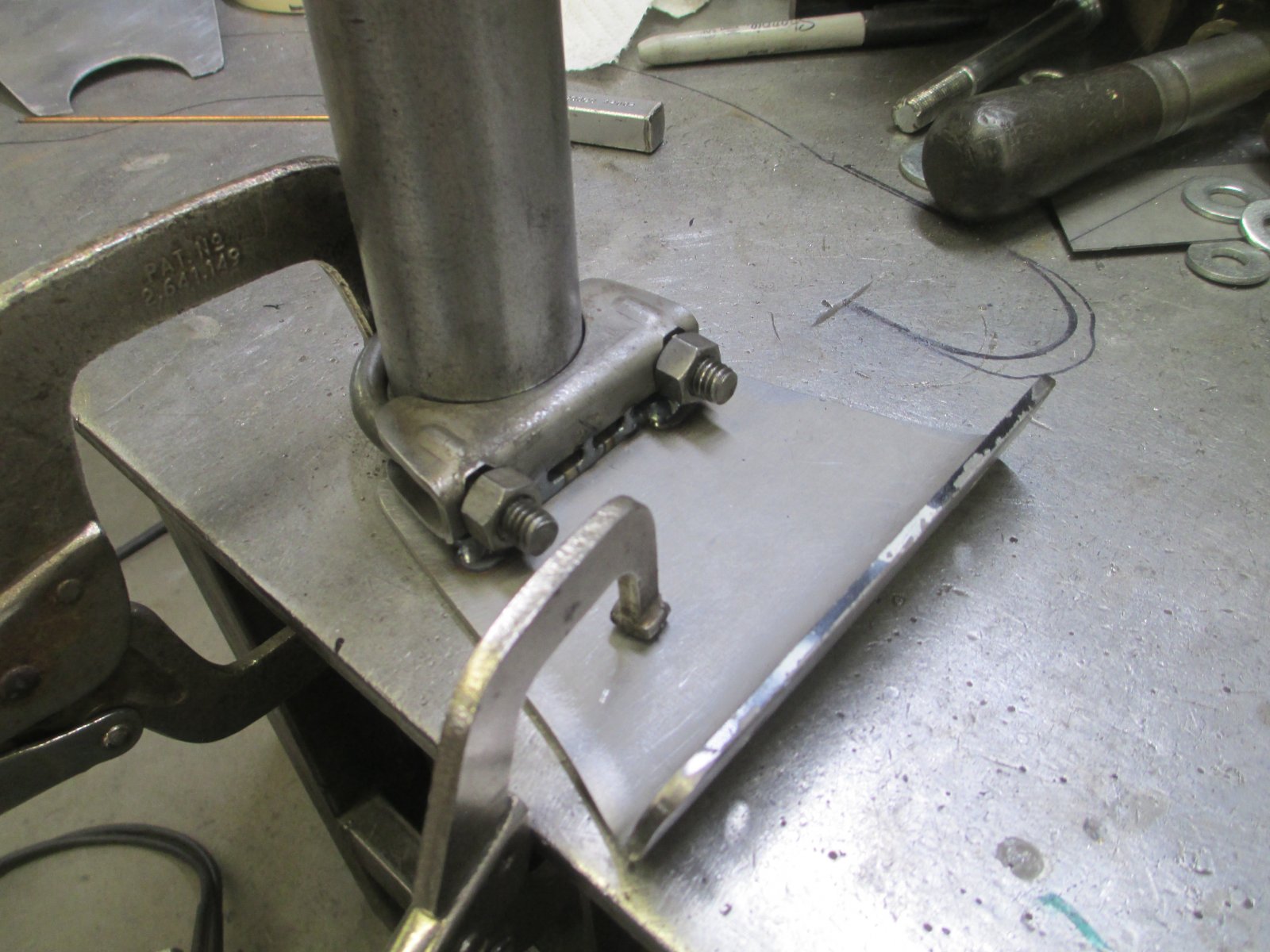

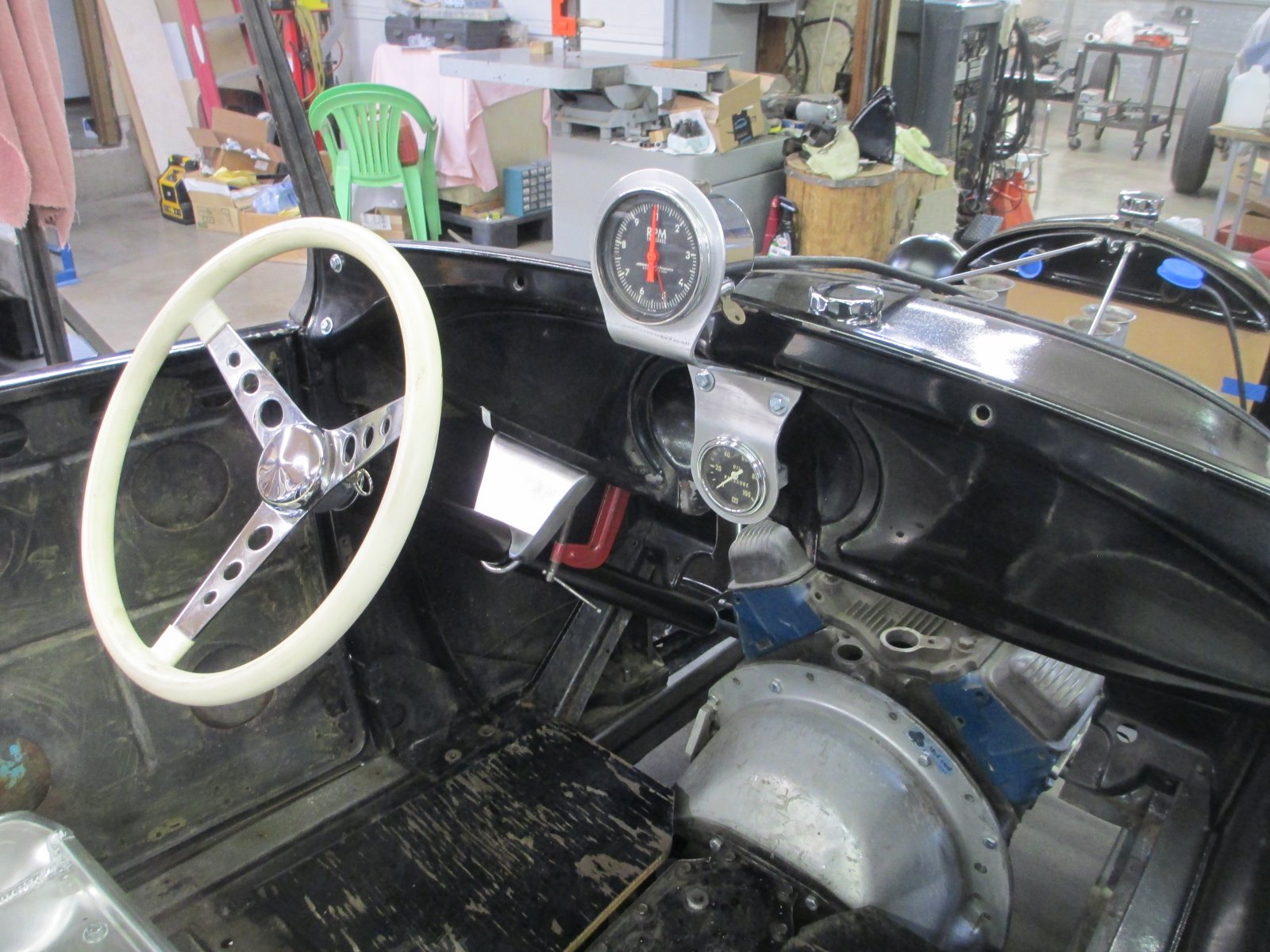

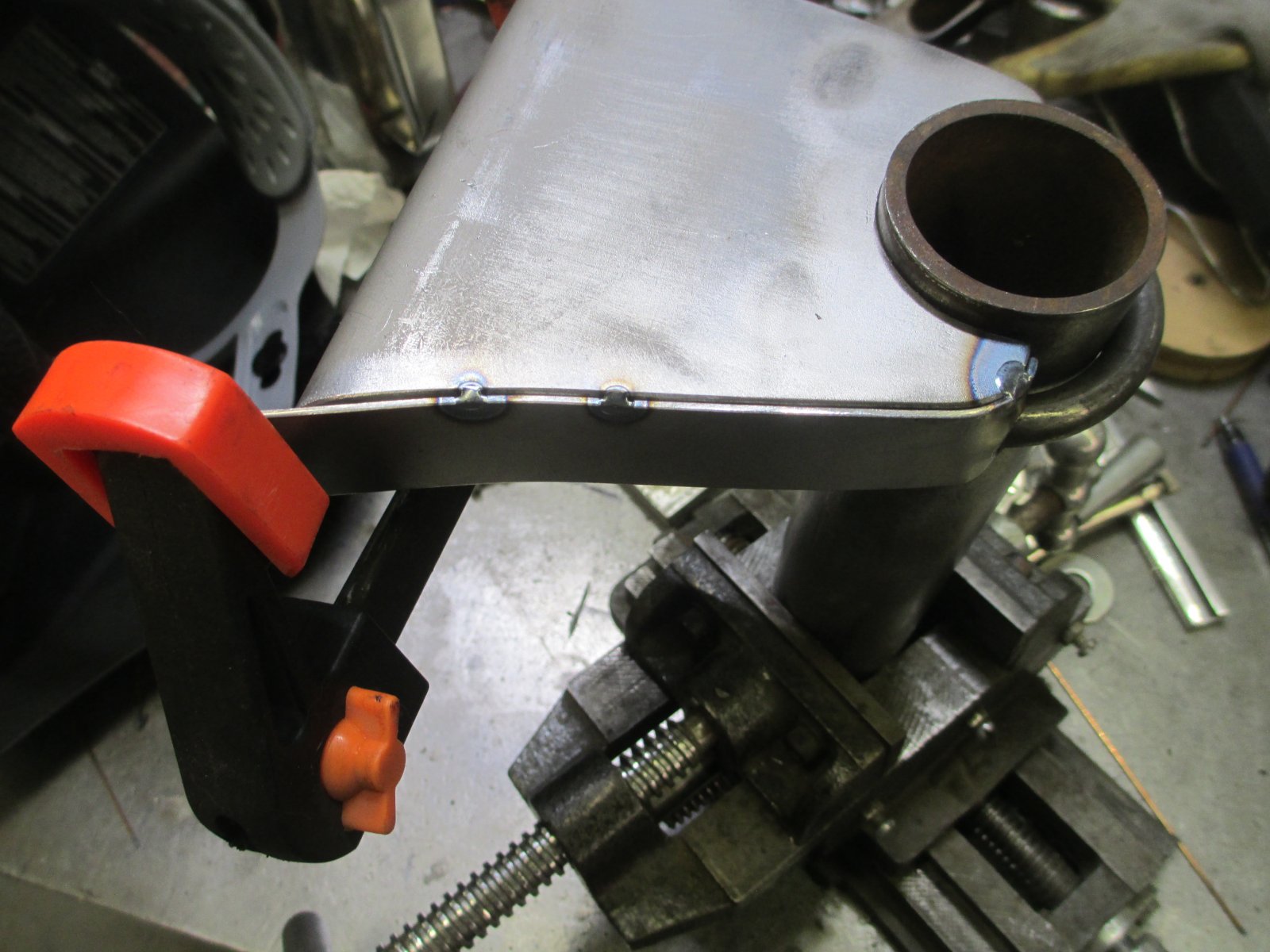

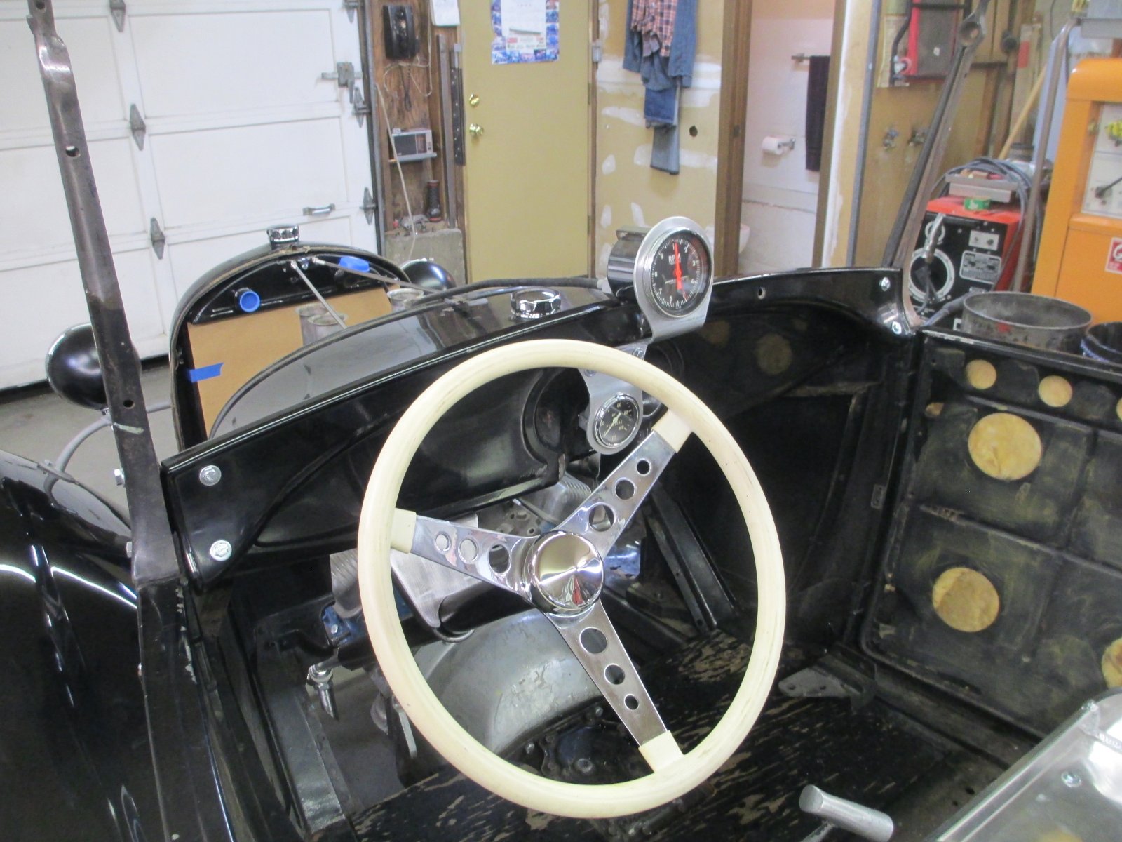

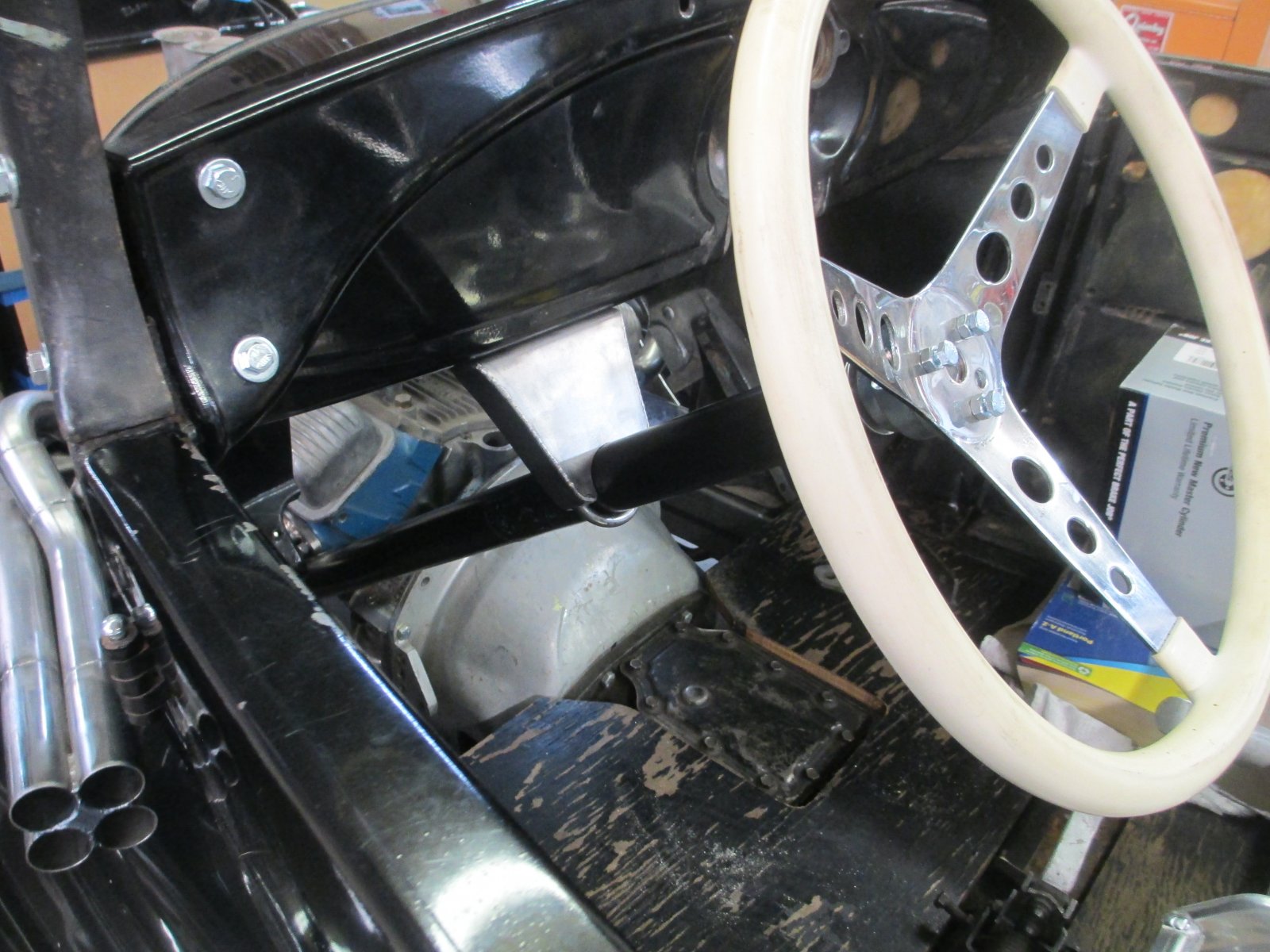

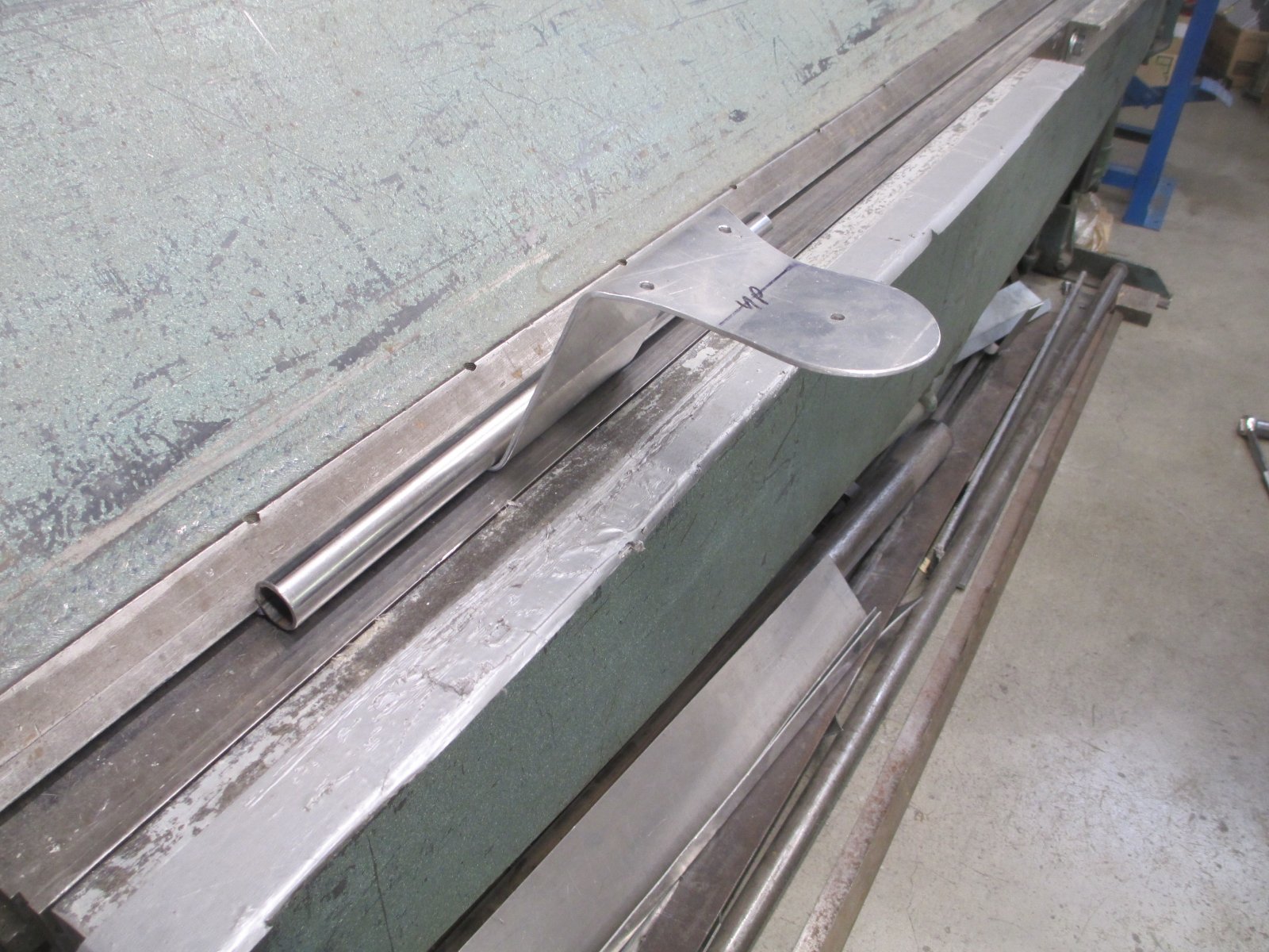

    I finally got around to fabricating the column drop today. In the 60's most most guys would have done something simple, spartan, and perhaps used a muffler clamp, so that's what I did. IMG_9087.JPG IMG_9091.JPG IMG_9092.JPG IMG_9093.JPG IMG_9095.JPG IMG_9098.JPG IMG_9100.JPG IMG_9105.JPG IMG_9107.JPG IMG_9112.JPG

    Nice Marty. Clean and simple. I'm learning so much by just paying attention.

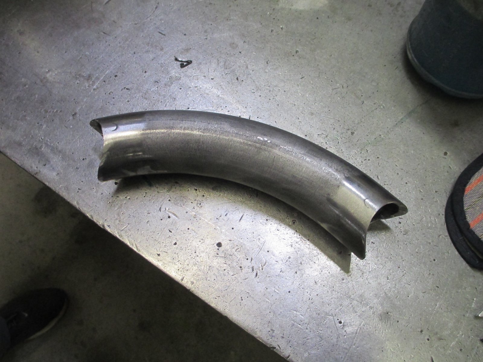

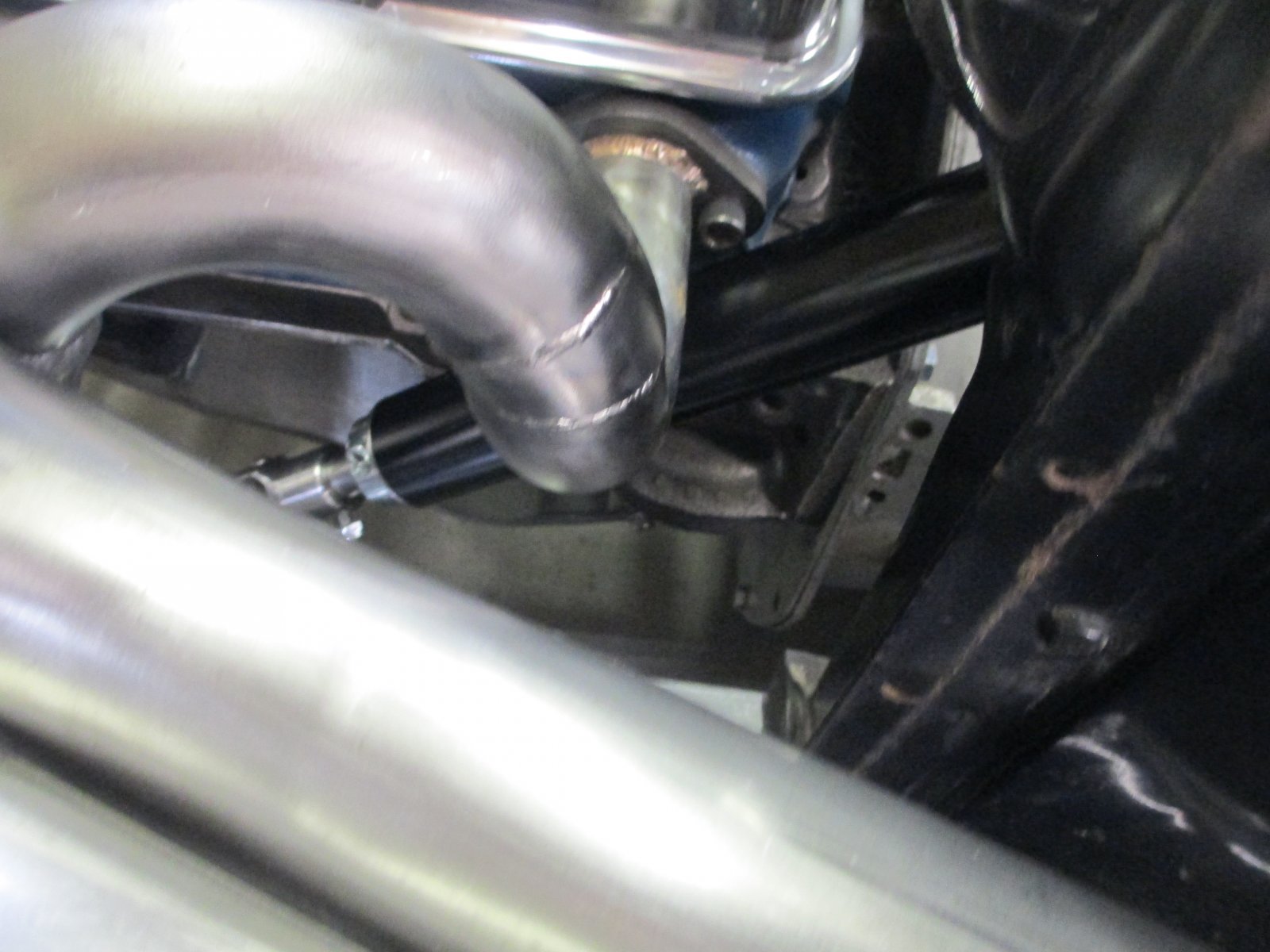

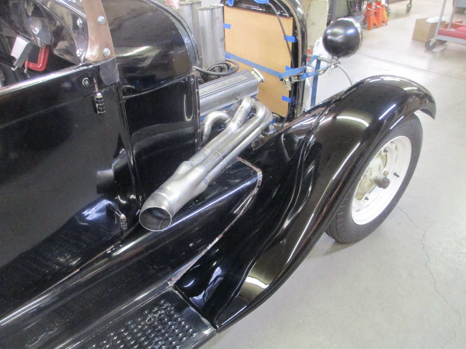

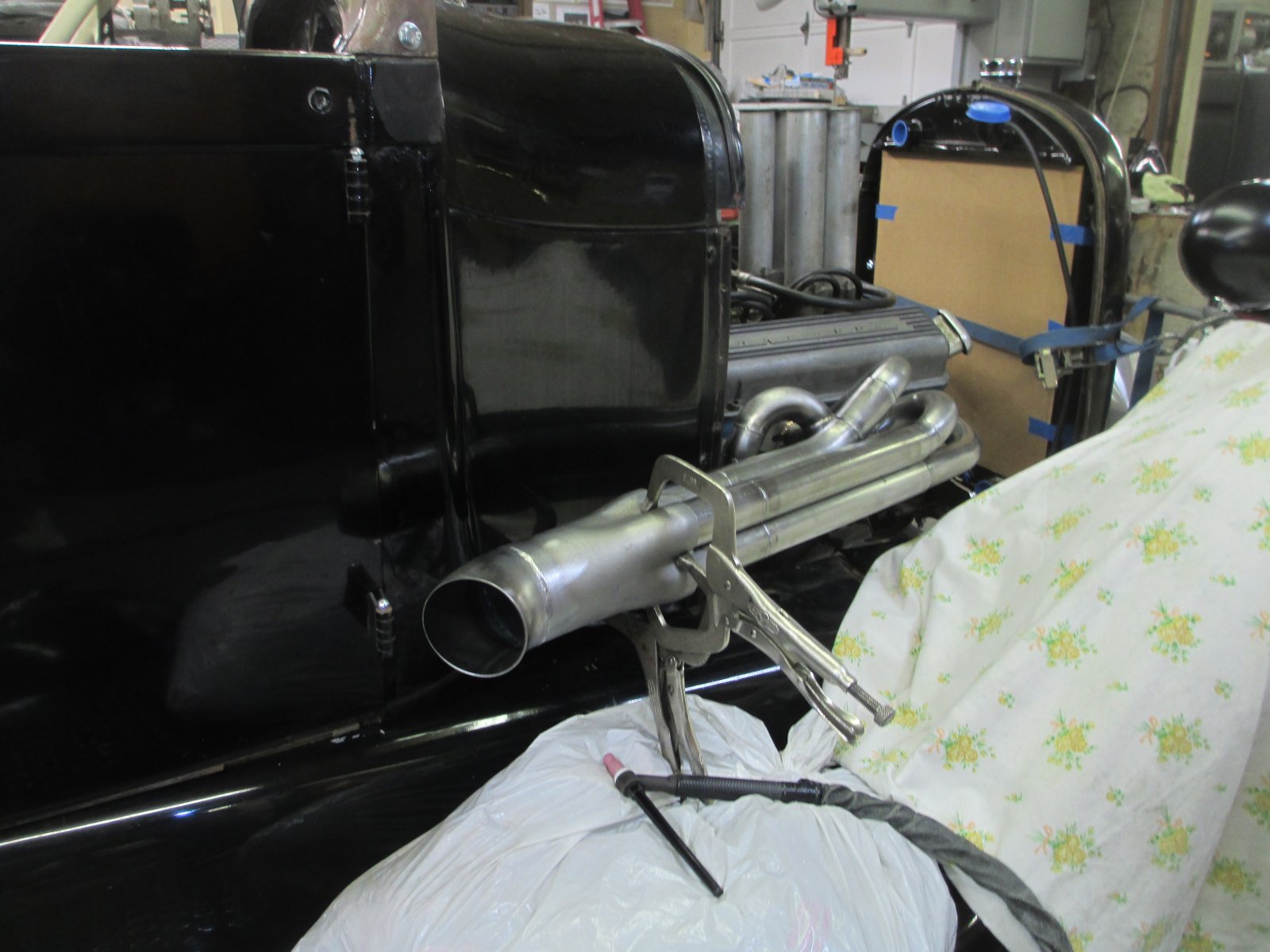

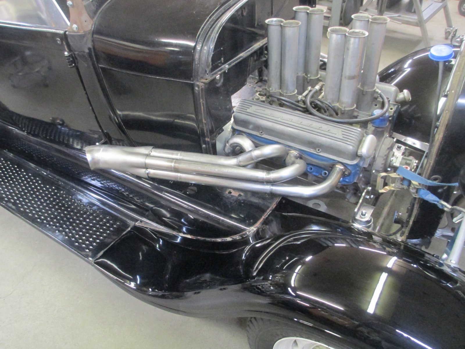

    I dug through my stash of pipes and bends, and found a couple remnant pieces of 3-1/2" bends to weld on the collectors. The ends needed to be tipped out to direct the exhaust away from the body. I need to have a couple 3/8" thick rings cut to mount muffling devices, since I plan on running some Wed nights at Portland International Raceway.
    My friend, HAMB Member @Alan Davis, gave me a pair of Supertrapps, that might just make it quiet enough to meet the decibel level. All of the other places I will run, won't require mufflers. Also, Jegs finally got a stock of M&H frontrunner tires, so I will have a pair mounted on Halibrand spindle mounts soon ! IMG_9120.JPG IMG_9122.JPG IMG_9132.JPG IMG_9133.JPG IMG_9134.JPG IMG_9130.JPG

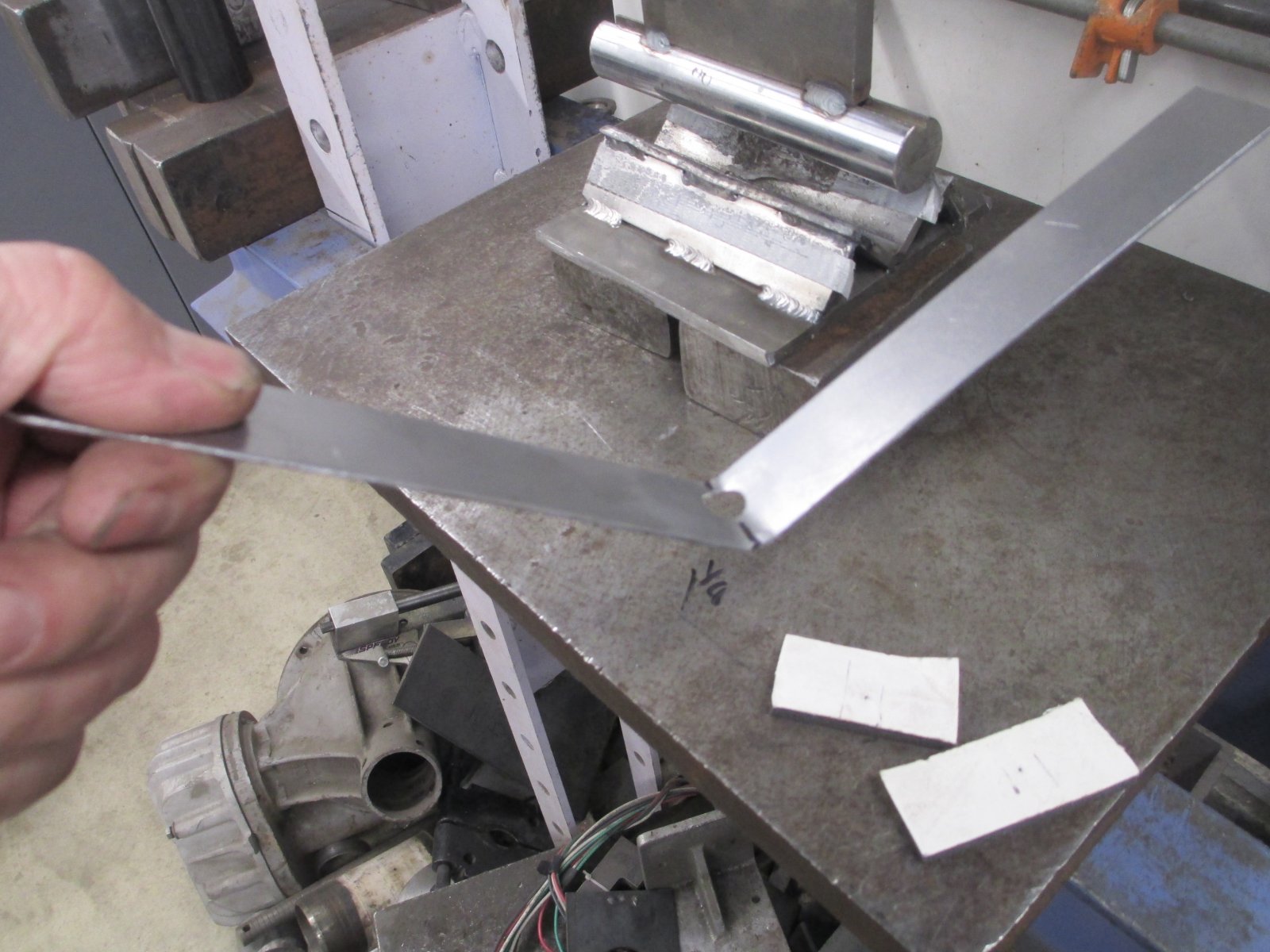

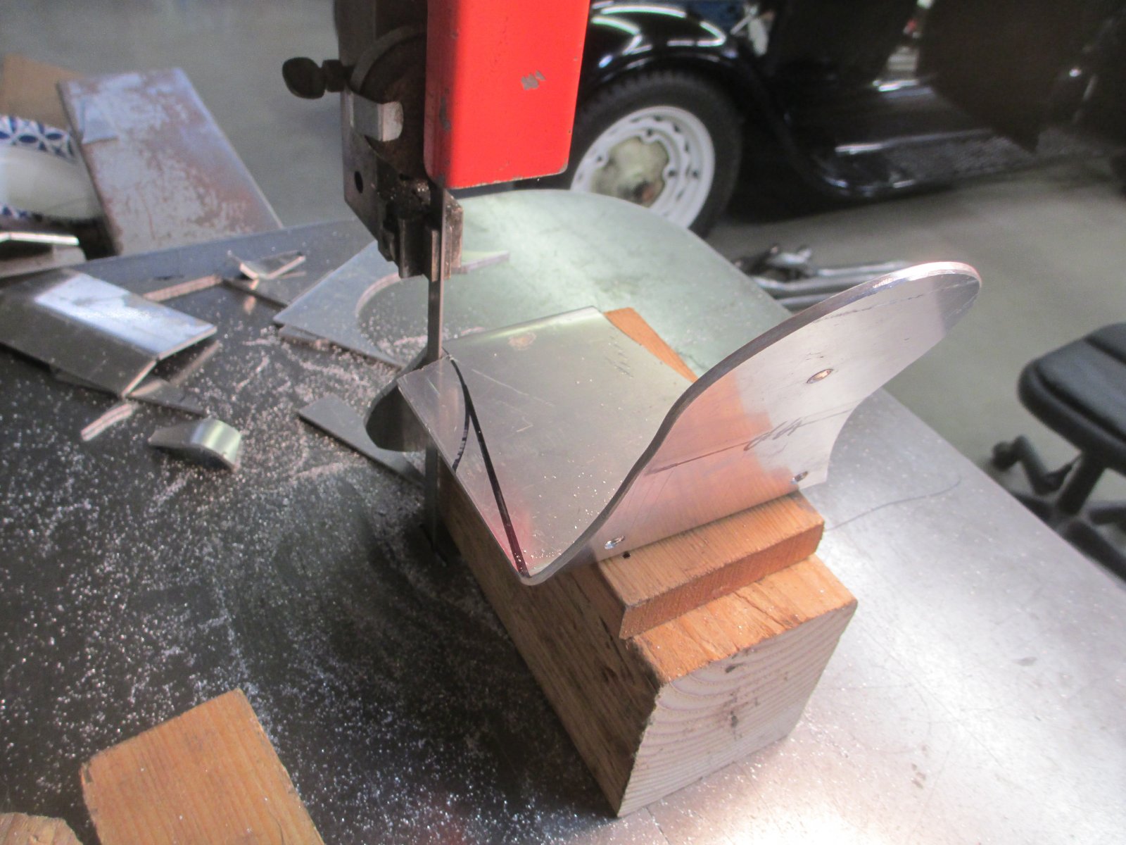

    Posts: 9,689
    Marty Strode

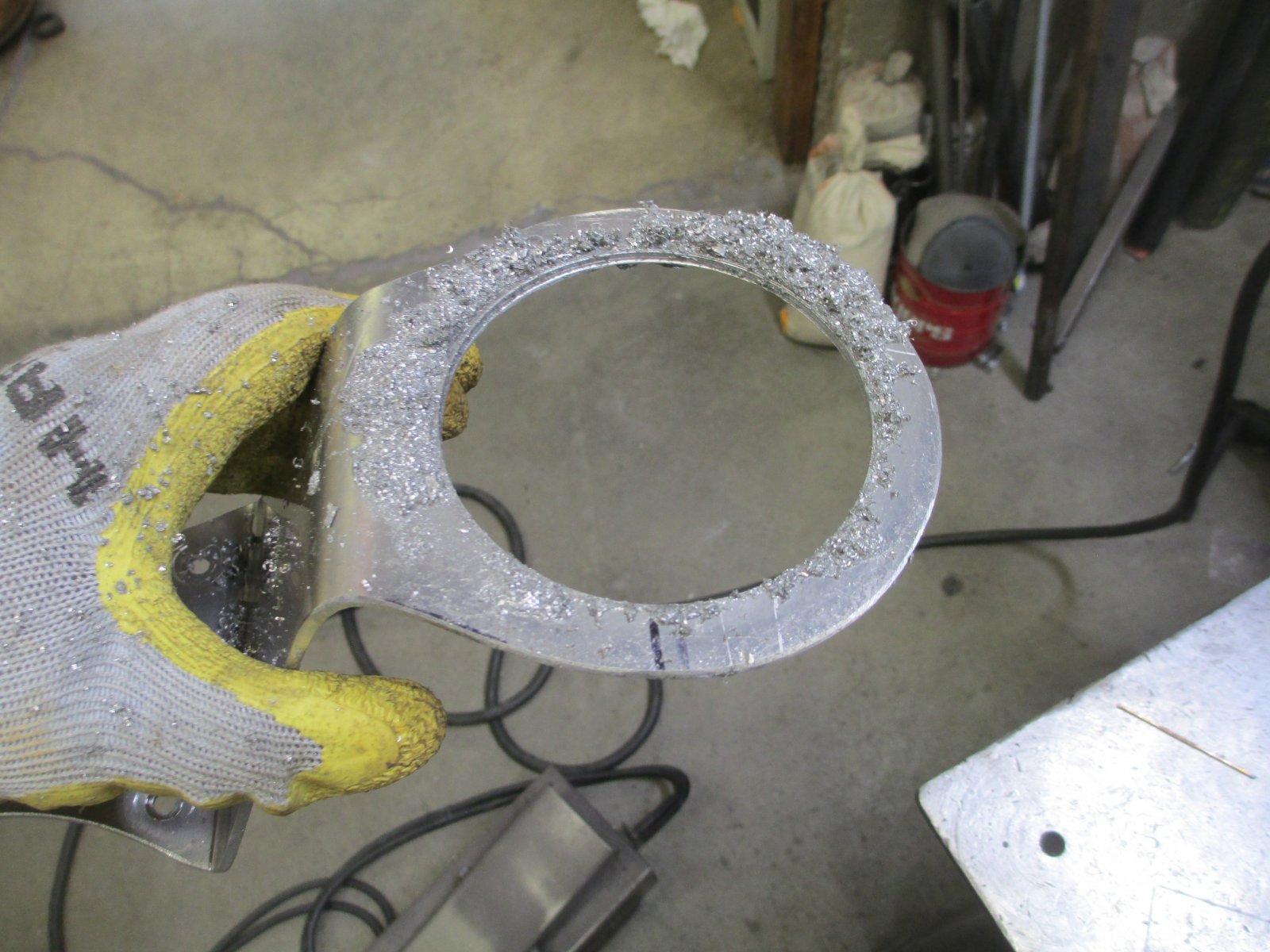

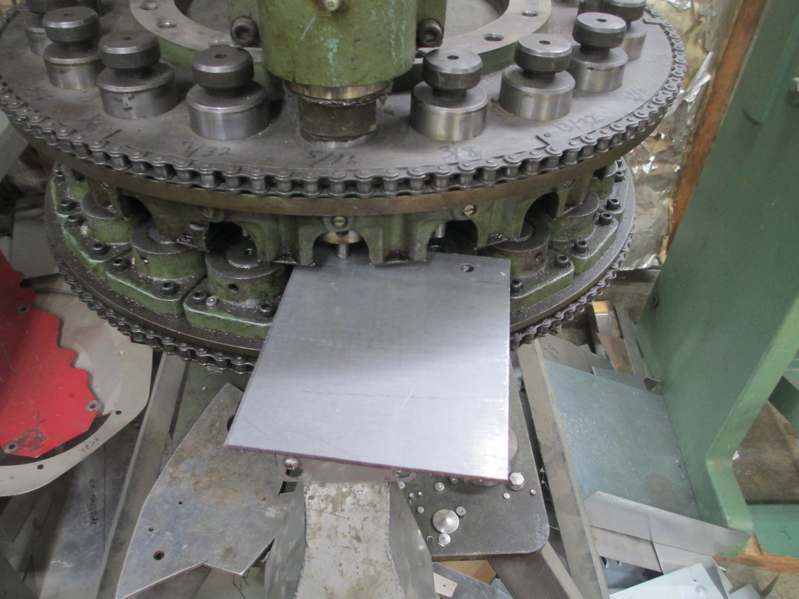

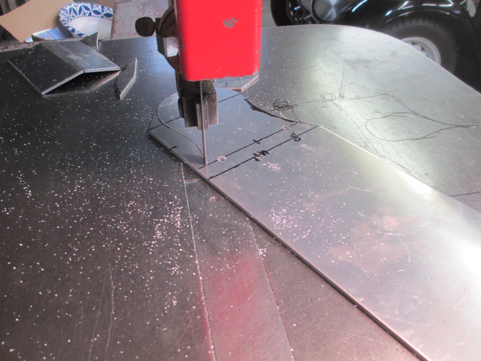

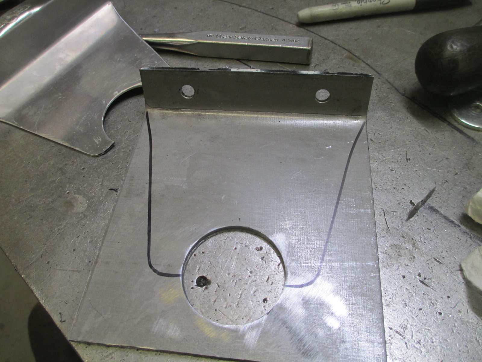

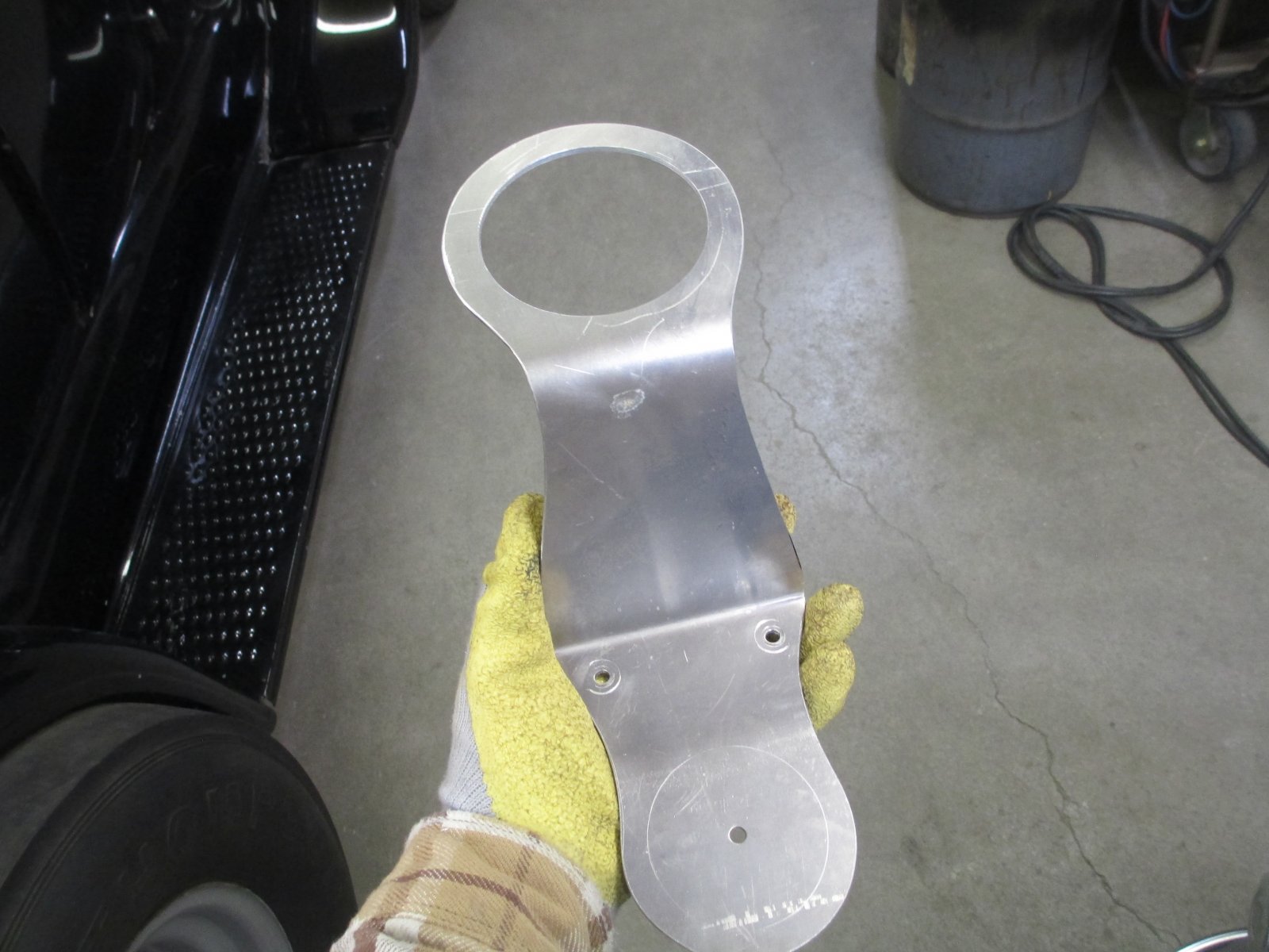

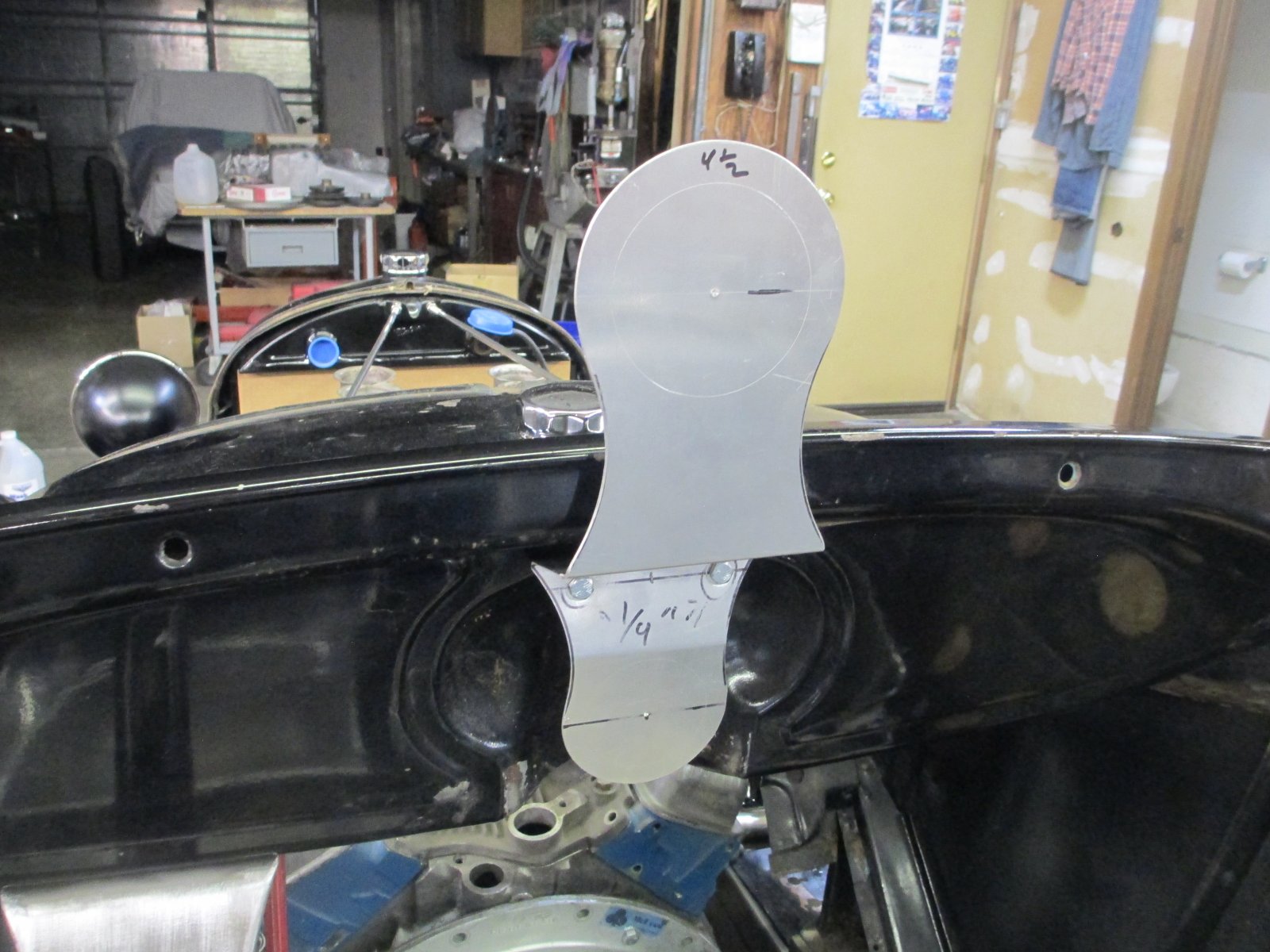

    I have been thinking of how to mount the Jones Mechanical Tach, and decided to use the bosses that held the instrument panel. I started by drilling the holes all the way through, and tapping them 1/4-28 thread. After making a sample pattern out of .063 aluminum, and locating the tach and 2-5/8" oil pressure gauge, I duplicated it out of 1/8" aluminum, for the final product. IMG_9162.JPG IMG_9164.JPG IMG_9168.JPG IMG_9169.JPG IMG_9172.JPG IMG_9174.JPG IMG_9175.JPG IMG_9176.JPG IMG_9180.JPG IMG_9181.JPG IMG_9182.JPG
