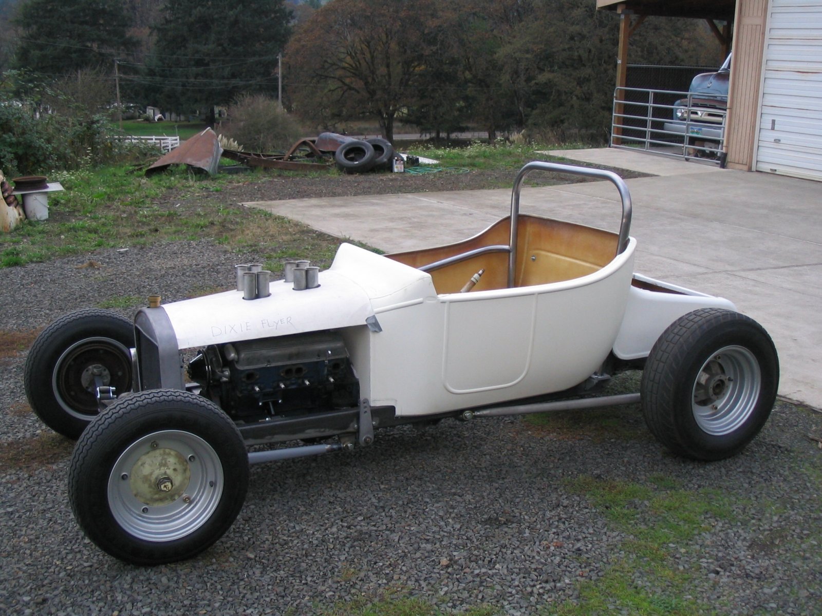

    Johnny, I am not familiar with Pixley, I am new here, just short of 50 years ! I hope I can make Toutle with the RPU, lots of details yet, and I have been helping friends and family, and that's more important. This morning, I considered, putting the Injected Chevy in the #10 Track Roadster, it should run in the 5's ! It would look like this. 045_45.JPG

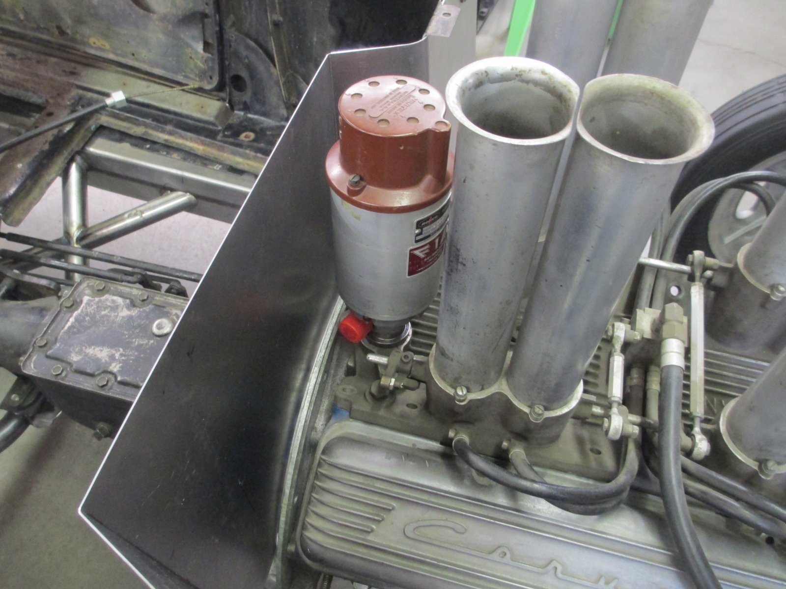

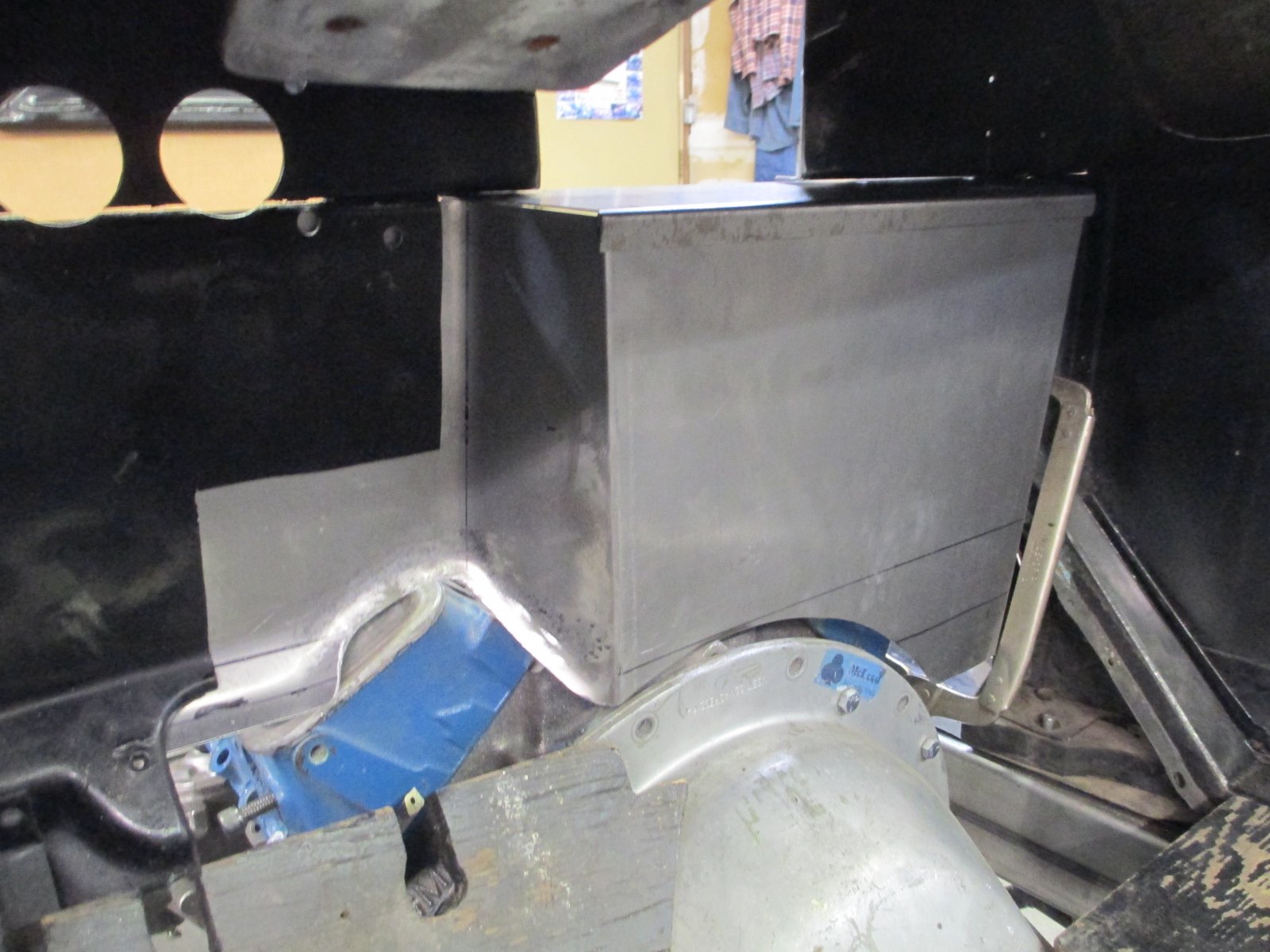

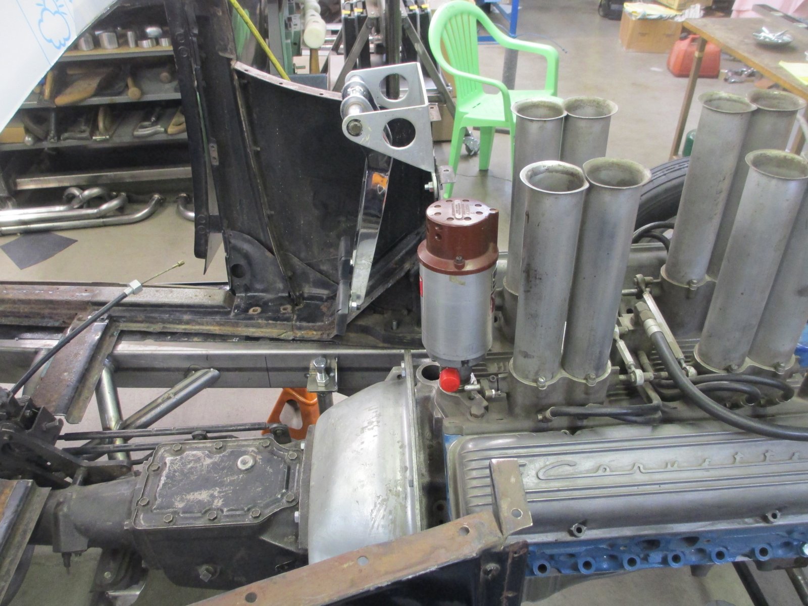

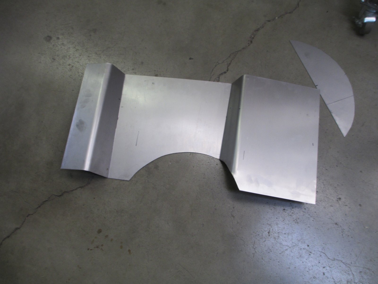

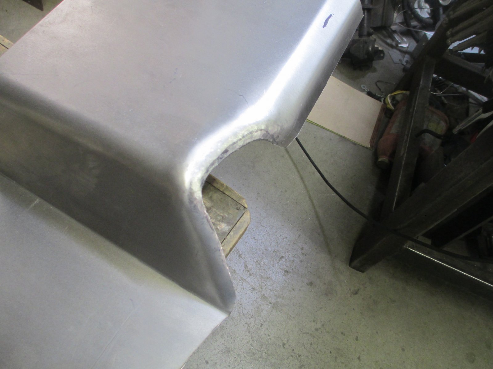

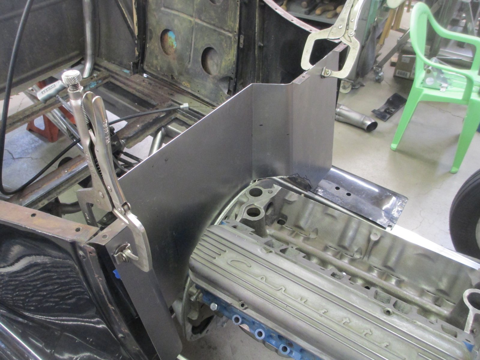

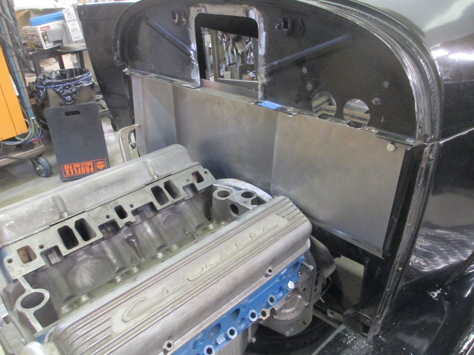

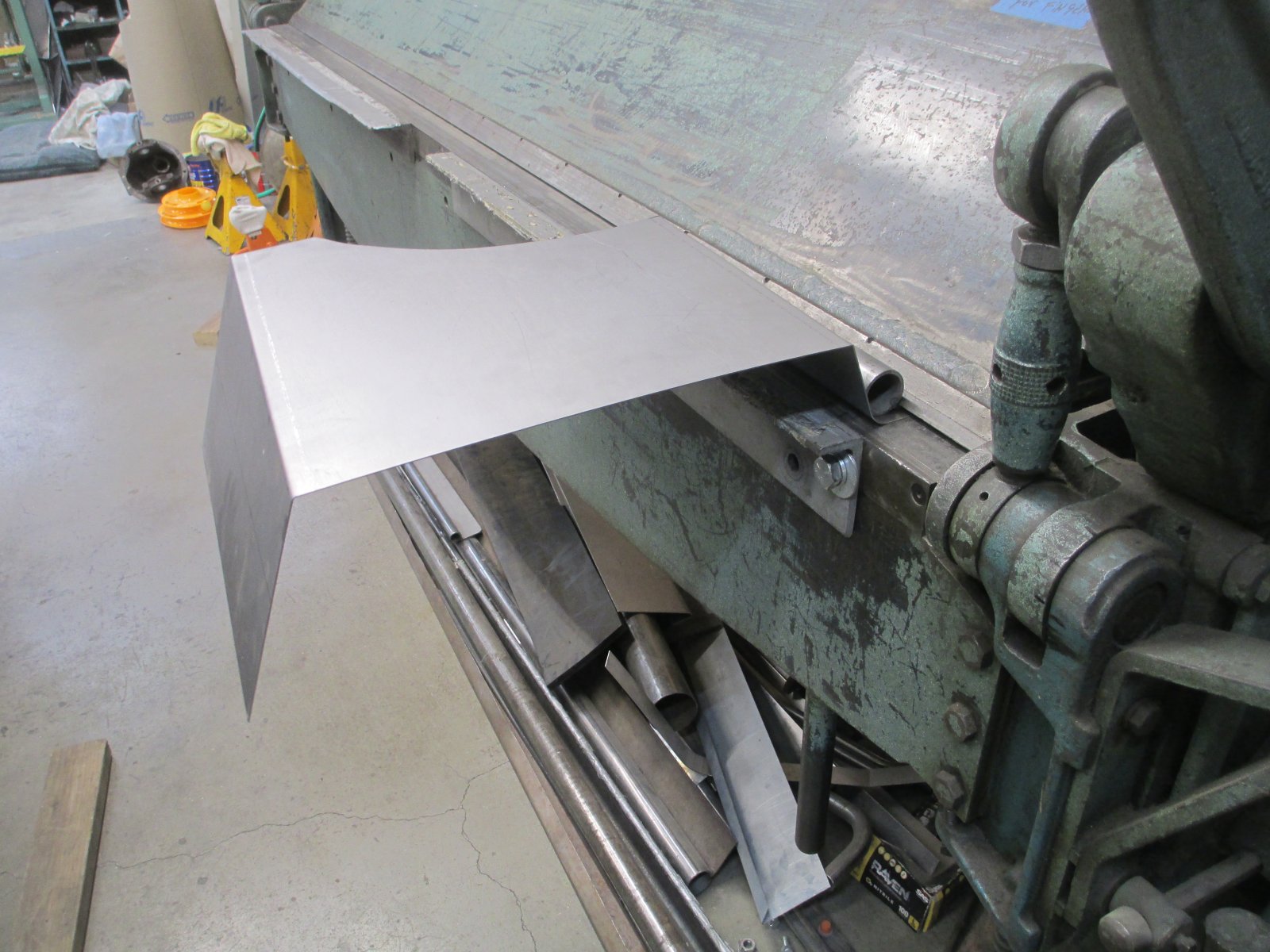

    I have been tackling the firewall, and it has been a little bit of a struggle, due to the fuel tank/upper cowl being removable, and the hanging pedals. Also the very tall slot required to take the mag in and out. The lower half is roughed in, and once I am happy with it, it will get scribed on the inside and trimmed for a flush fit. I have made the decision to make a removable faceplate out of aluminum to cover the large opening over the mag. The tach drive cable will route through the old gas filler cap, loop around and connect to the the mag drive connection on the p*** side. IMG_9446.JPG IMG_9448.JPG IMG_9450.JPG IMG_9452.JPG IMG_9456.JPG IMG_9458.JPG IMG_9460.JPG IMG_9462.JPG IMG_9471.JPG IMG_9479.JPG IMG_9480.JPG

    Quick question, Is the tubing attached to a piece of flat stock like we've seen before.. Thanx..

    Yes it is.

    That's the way the original builder of my current RPU did it Marty. Good idea, but I would not have chromed it. Car was originally built in the early 70's when things like that were done. Thought about painting it but the chrome is still pristine so I left it.

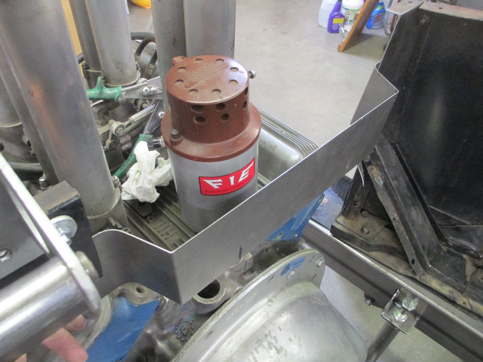

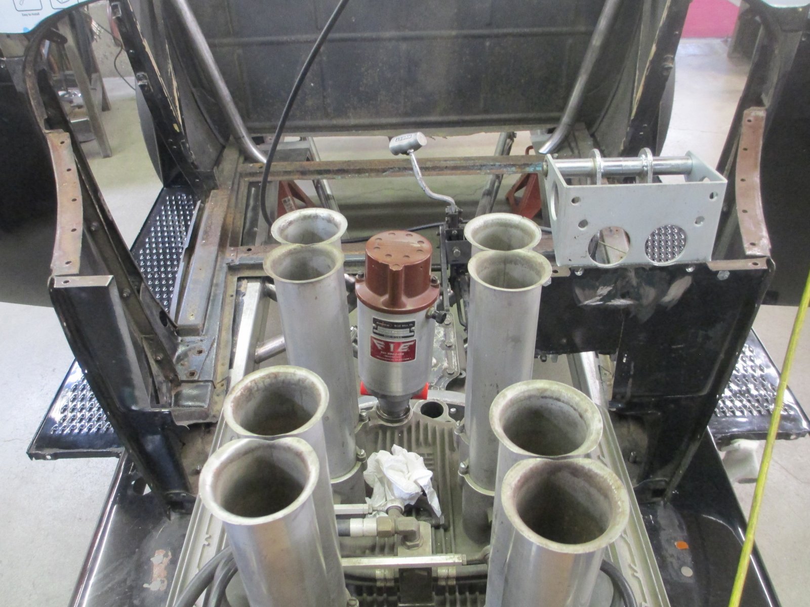

    Thanks Jim, I do enjoy the fabricating. Spud Miller is the go to guy, for Injectors and Magnetos, although he is about an hour and a half for me, I have never met him in person. He flowed a couple of -0 pumps for me, for this car and we will be making the decision to run gas or alcohol. As far as the friends go, they are second only to my family, and I have truly been blessed with both. This hobby would be nothing without the great people involved, and are as important as building and playing with the machines we love. I have a buddy coming from Australia to spend a month with me, and we will be going to Speedweek, along with taking in some other fun events. Back to the fab work, I am nearly done with the firewall, just a little welding left, and making a cover for the top half of the slot . Then it's on to the throttle linkage, which will be a challenge. IMG_9509.JPG IMG_9510.JPG
