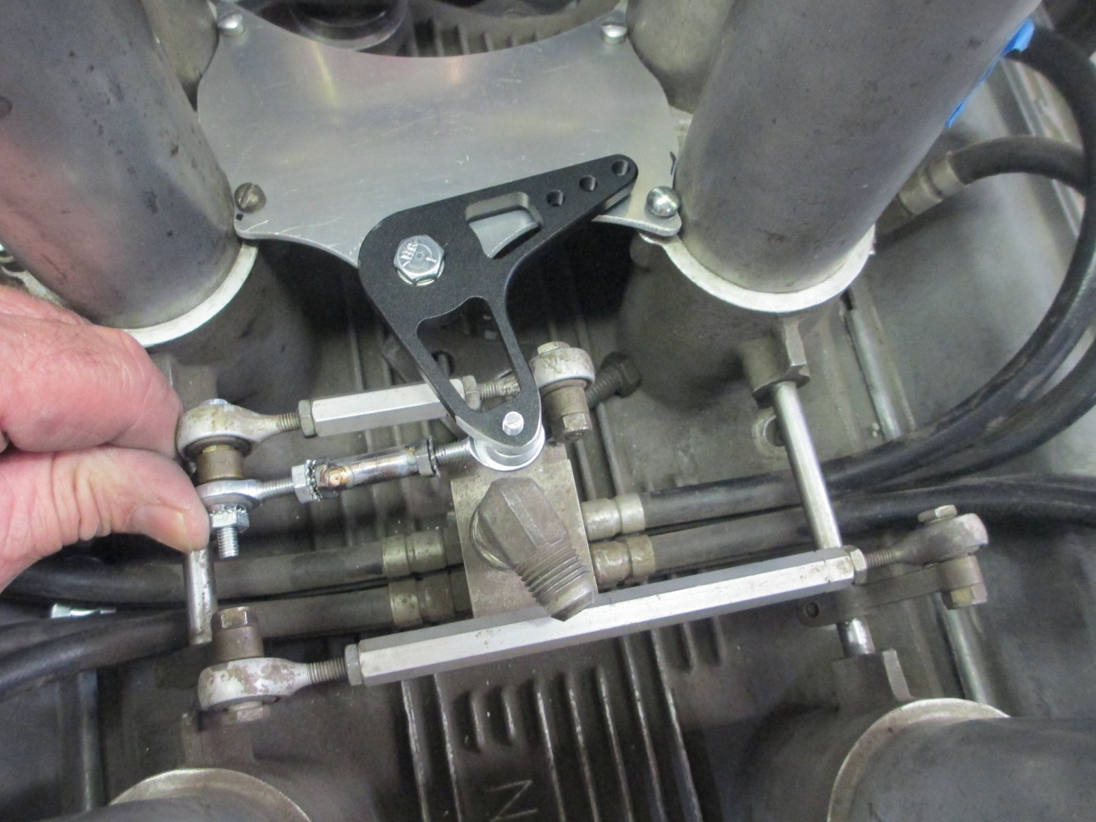

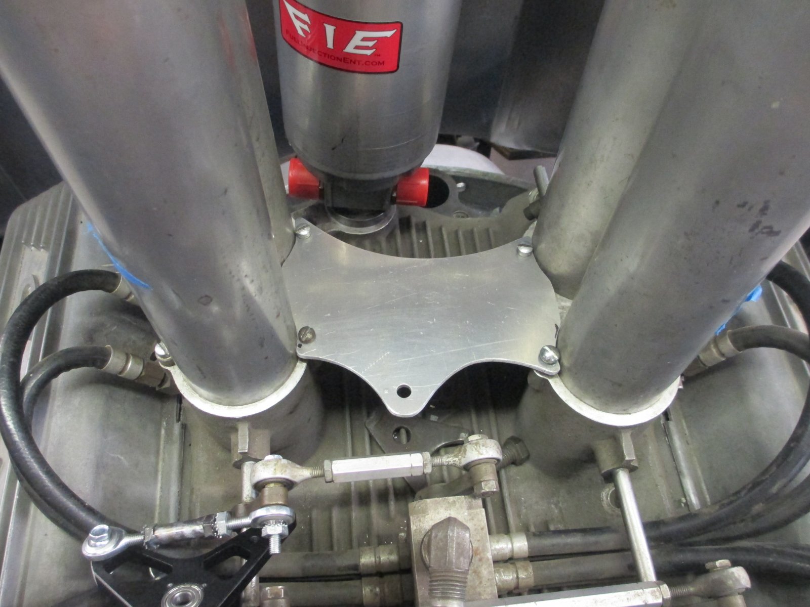

    Marty, I don't have any good pictures from way back when in the injected dirt cars, however what we did for throttle linkage might work for you. Briefly, if the engine doesn't rock, solid mounted, we ran a section of tubing sized to fit over the throttle shaft on the right bank, that had a slit cut along one side about a half inch long. Then a split collar matched to the od of the tube locked it on the throttle shaft.
    The tube then extended back thru the firewall and a heim joint supported from a crossmember in the roll cage. Just behind this was a clamp on arm, made from another split collar with an arm welded on. It was located just above (7-8 inches) the throttle pedal, so a short link up made it operate.
    In your car, you could mount the extension on the left bank throttle shaft, and maybe use a spherical bearing in a flanged housing bolted to your firewall.
    If the engine can move, it could still work, just insert a small u-joint between the engine and firewall in the extension.
    Just a thought...

    Dave, My friend, Lonnie Gilbertson came to see me yesterday, and he came up with what could be the solution. Lonnie is a long time quality car builder (won the AMBR twice) and a very good problem solver. Thanks for the sound advice, there will be some engine movement.

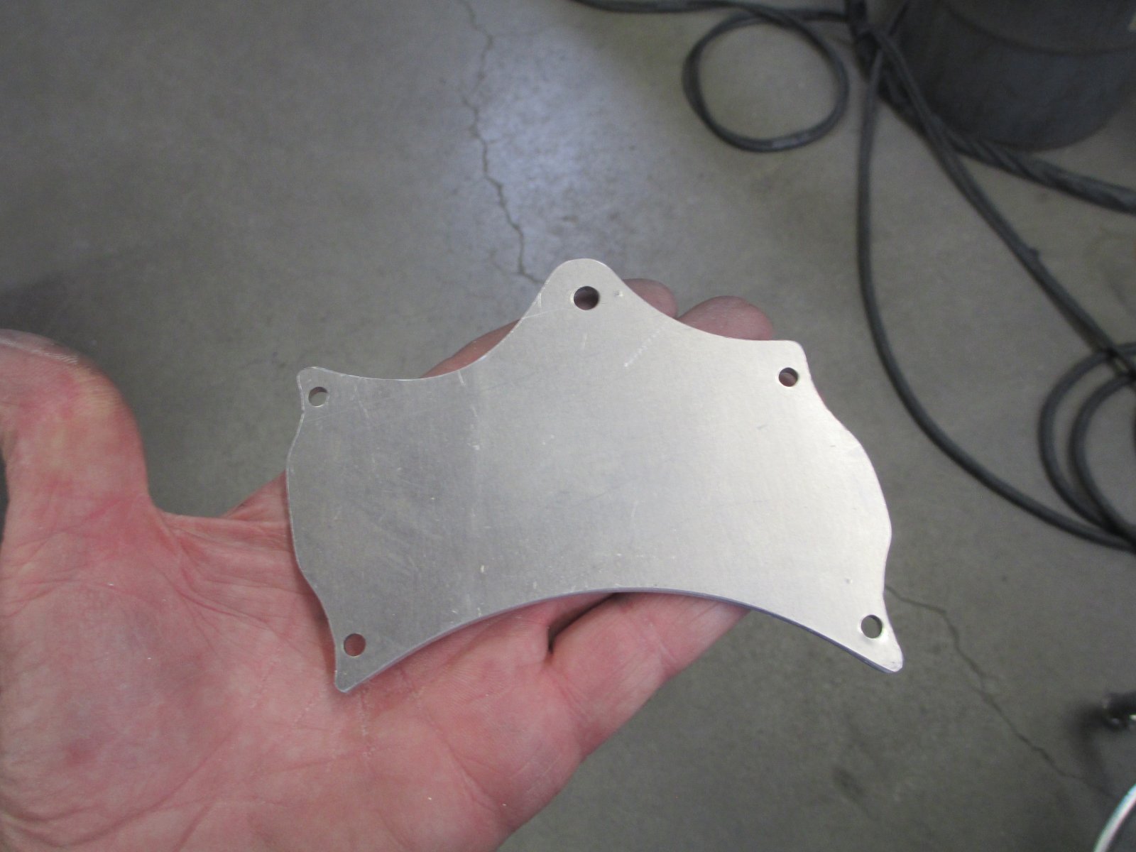

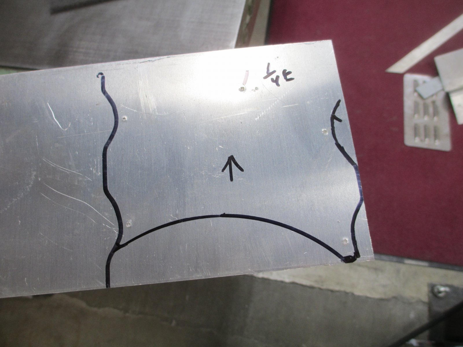

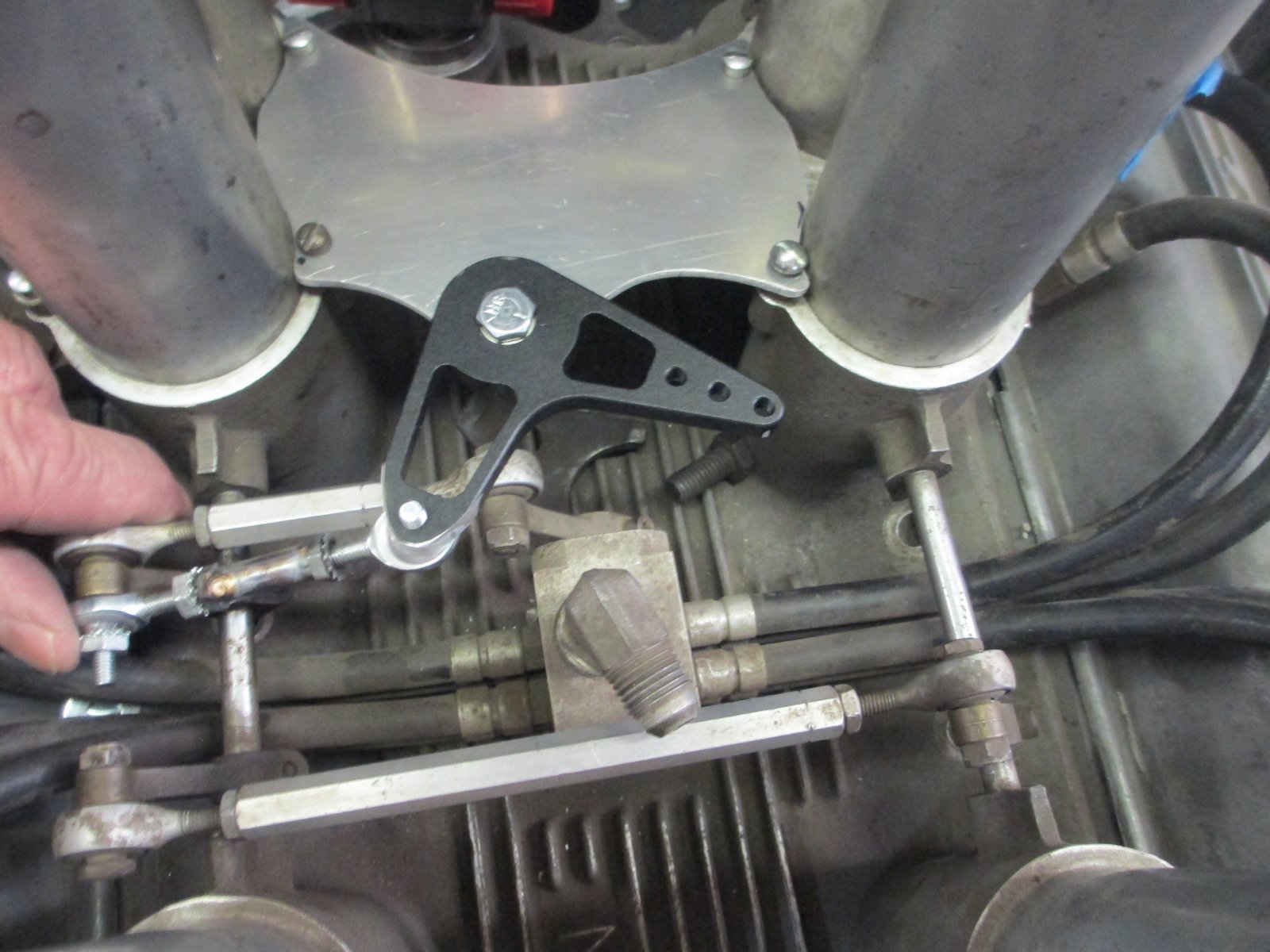

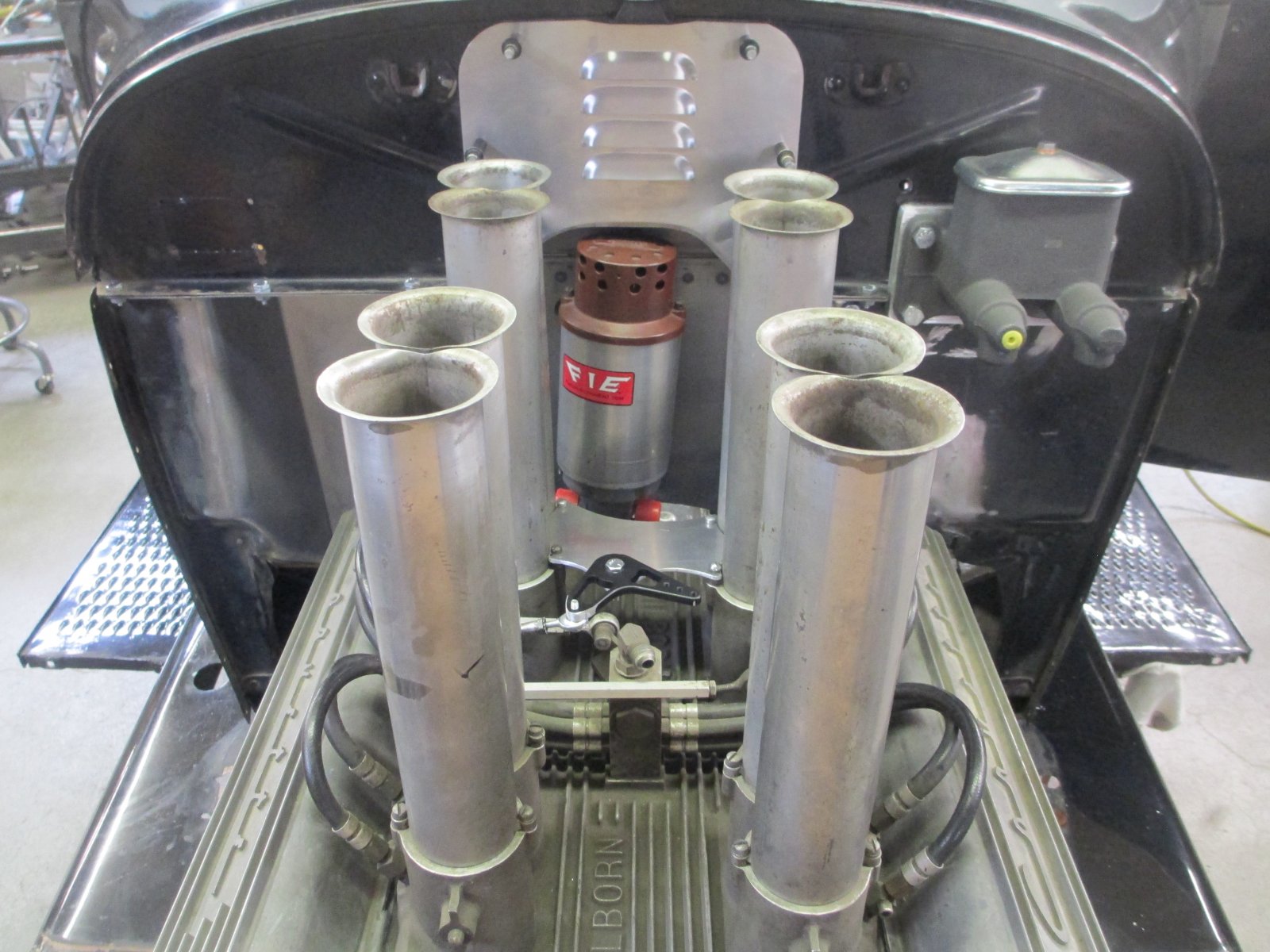

    Neil, Lonnie and I have been working together for nearly 25 years, and we both have different specialties, that work well in our projects. He came up with the idea of a plate that attaches to the screws that mount the stacks, with a bell crank pivot. IMG_9519.JPG IMG_9520.JPG IMG_9521.JPG IMG_9522.JPG IMG_9525.JPG IMG_9526.JPG So, I made one out of steel, that serves as a prototype, the final one will be aluminum. I had purchased some bell cranks from Speedway, and once I get some more 3/16 rod ends, it should work slick, I didn't want to use a cable.

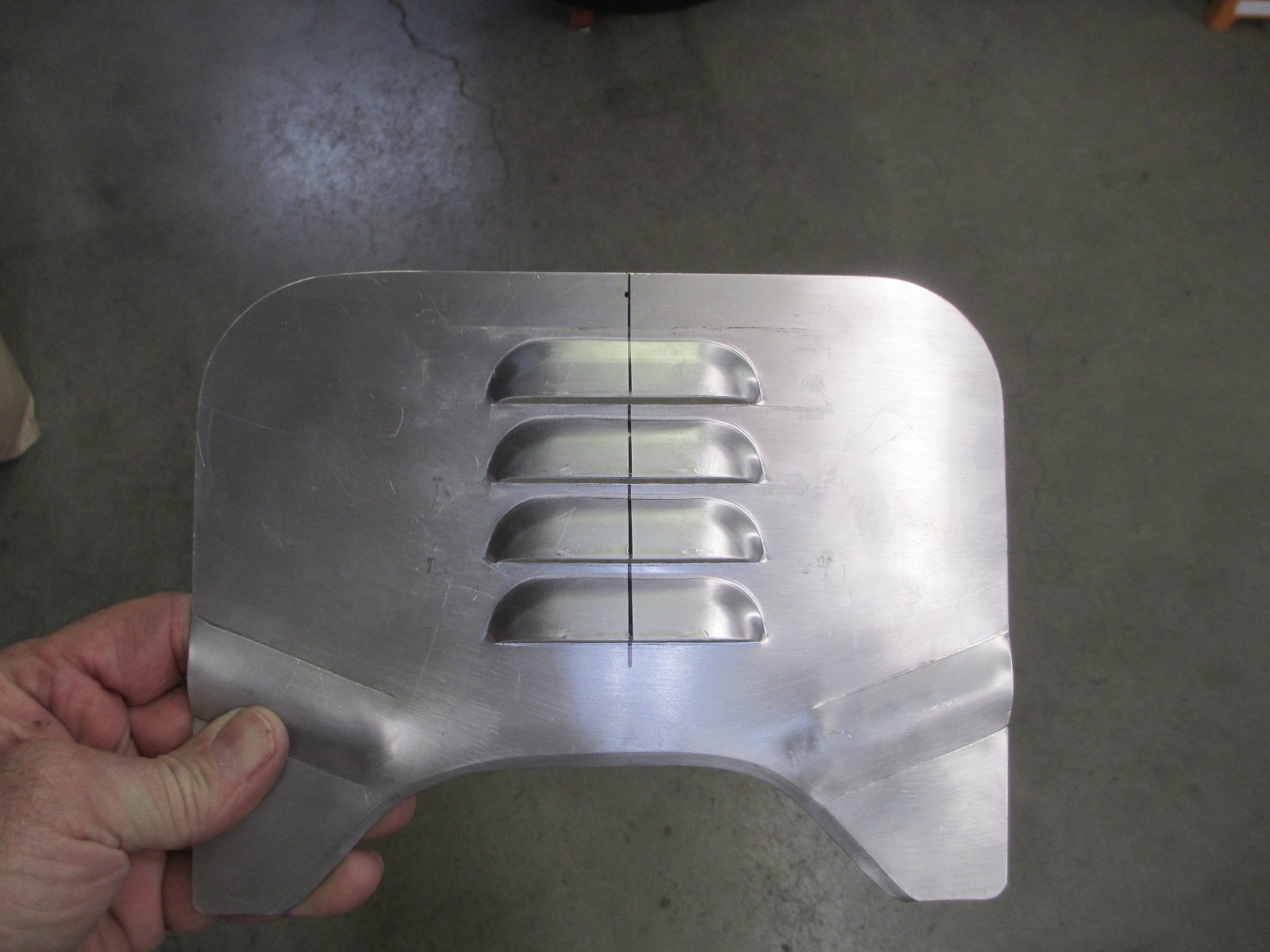

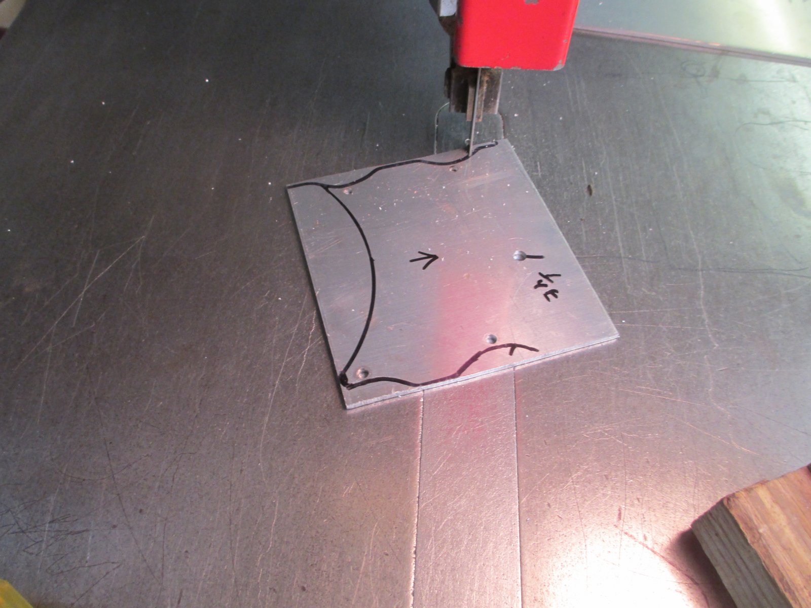

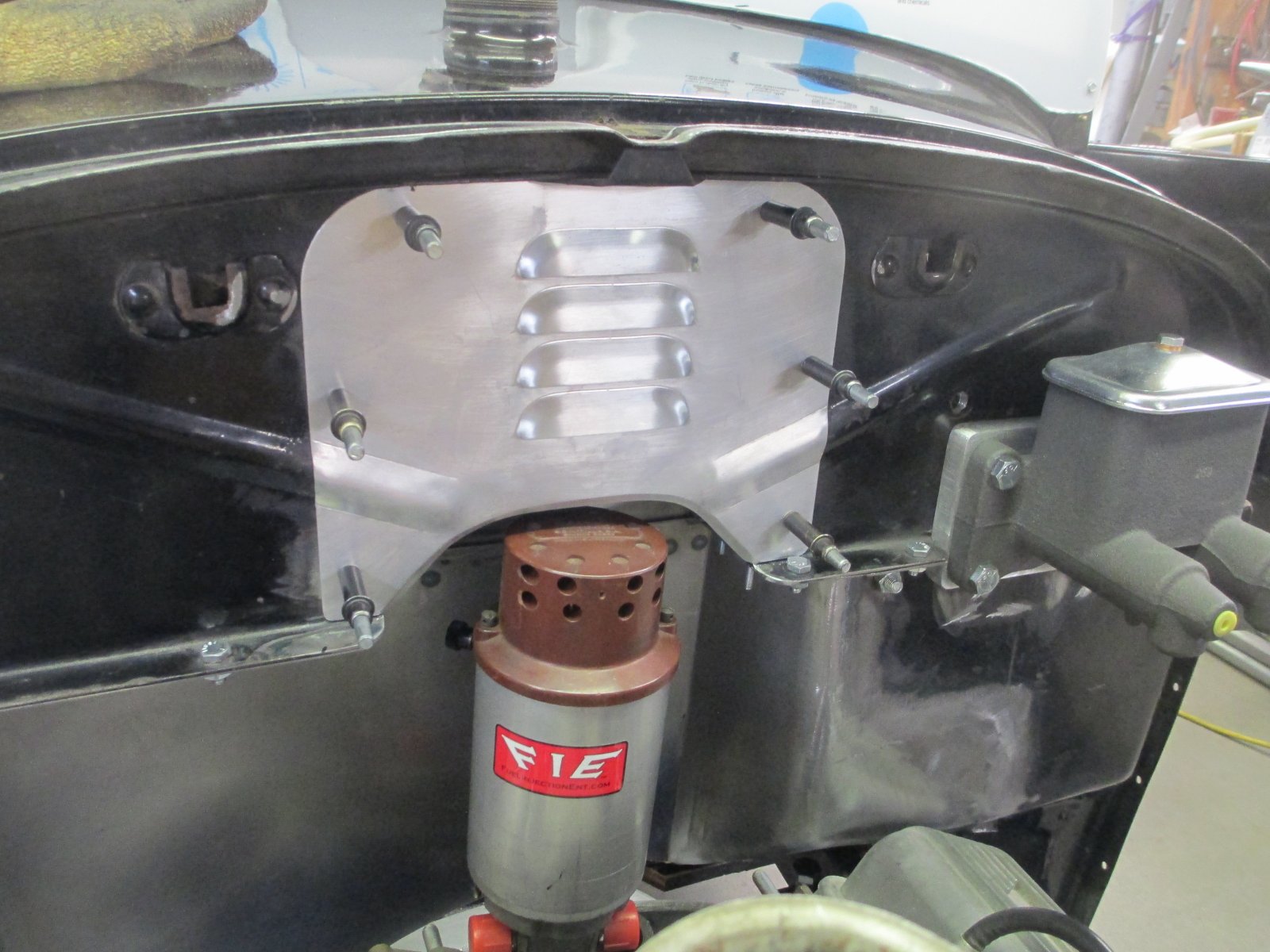

    I an earlier post, I mentioned fabricating a panel to cover the large slot in the firewall required to get the Mag in and out. I finished the cutout today and whipped up an aluminum cover, that will be retained with 6 - 10-32 screws, and plan on punching 4 louvers, to add a little eye appeal, along with ventilating the trapped air in that area. IMG_9527.JPG IMG_9528.JPG IMG_9532.JPG IMG_9533.JPG IMG_9534.JPG IMG_9535.JPG

    Here is the cover, louvered and mounted. Since I have Covid, and can't go anywhere, I was able stay busy and get the result I wanted for the throttle linkage. Other than the temporary link ( that looks like junk) it works great. My goal was to set it up, so where the linkage p***es through the firewall, it will also work with a set of carburetors. IMG_9537.JPG IMG_9538.JPG IMG_9541.JPG IMG_9543.JPG IMG_9544.JPG IMG_9546.JPG IMG_9549.JPG IMG_9550.JPG IMG_9552.JPG

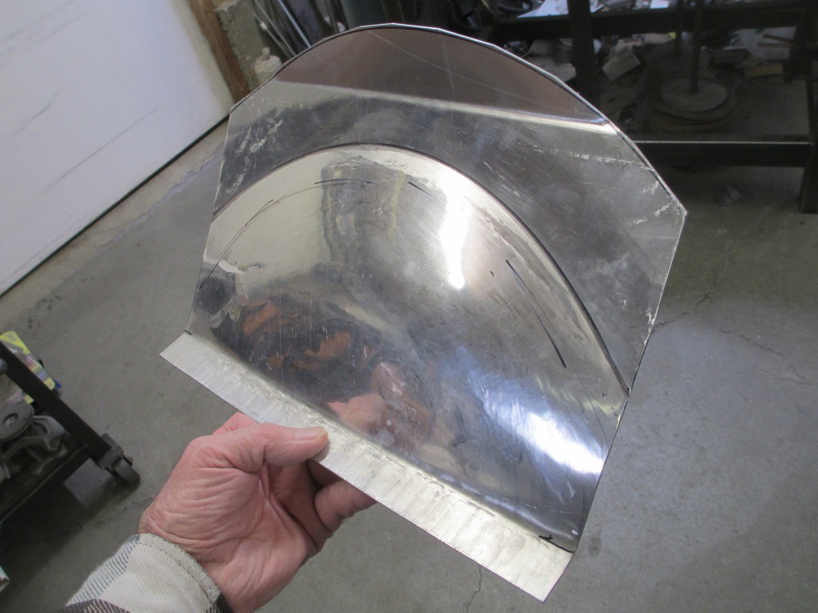

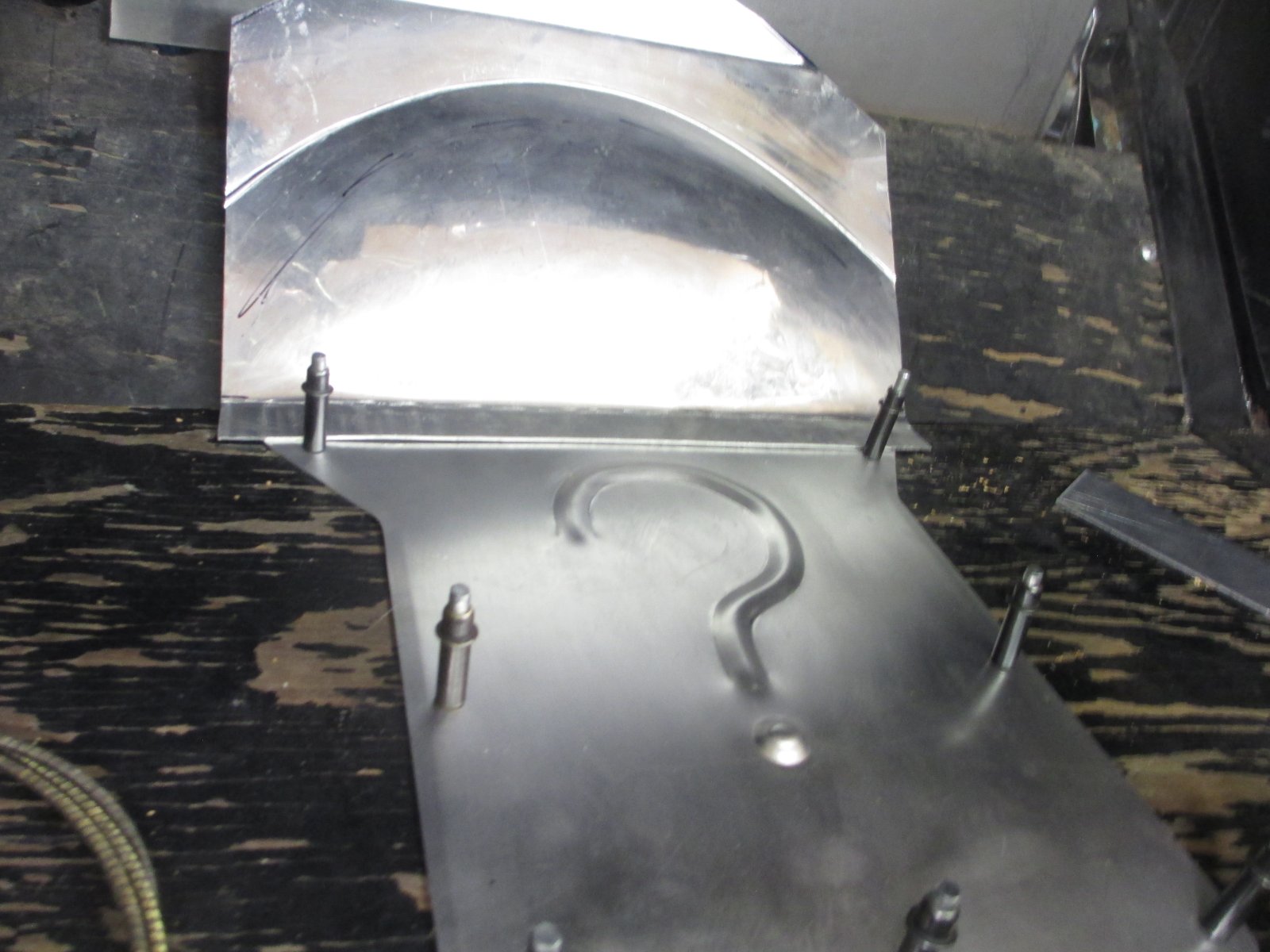

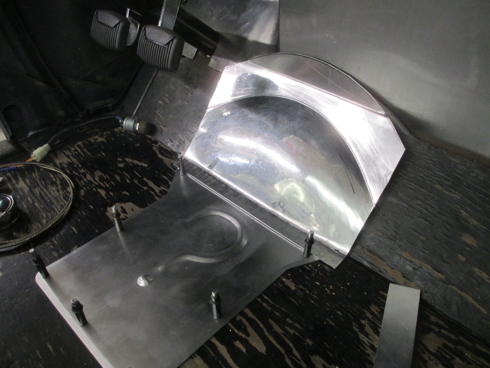

    A friend dropped by for a visit today and it inspired me to work on the trans and bellhousing cover. So, I annealed, beat and wheeled a piece of aluminum. I got it roughed into shape, now to do a little more tomorrow. IMG_9838.JPG IMG_9839.JPG IMG_9840.JPG IMG_9841.JPG

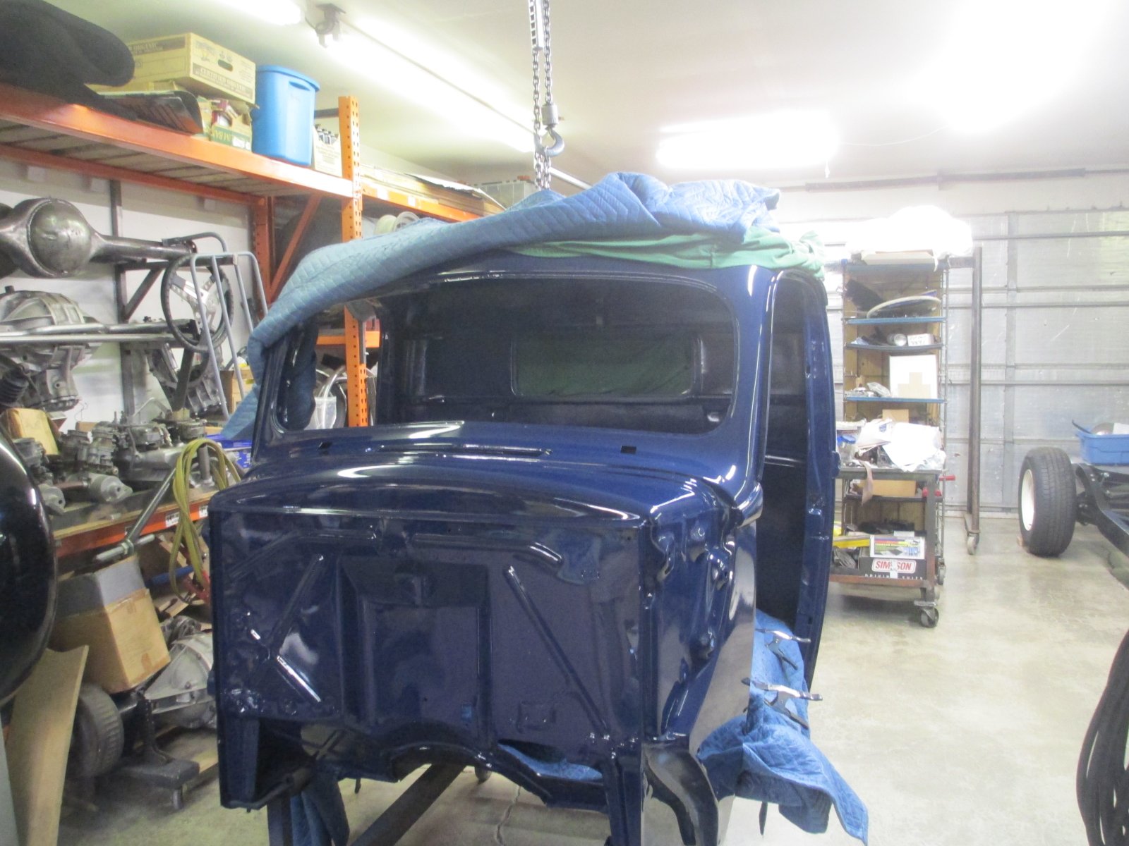

    We had planned to undercoat the cab, and inside to fenders on the '40 today, but wind and rain from the south, changed our minds. The big shop door, faces south, and we didn't want to have problems, but it looks good for next Sat. We are using a Raptor coating kit, that is black and rubberized. The cab will be hung from the ceiling using a chain and a spreader bar. Also, my old race partner sent me this photo that he took when we were racing at Fremont, Ca. in 1988. It's in the staging lanes, and I am talking to veteran Top Fuel racer Sammy Hale, his ride, (the Champion Speed Shop) is right behind ours, and the Charlie's Business Coupe, Fiat is behind us. Those were fun days ! IMG_9905.JPG IMG_9906.JPG Ruthless   Marty and Sammy Hale at Fremont.jpg
