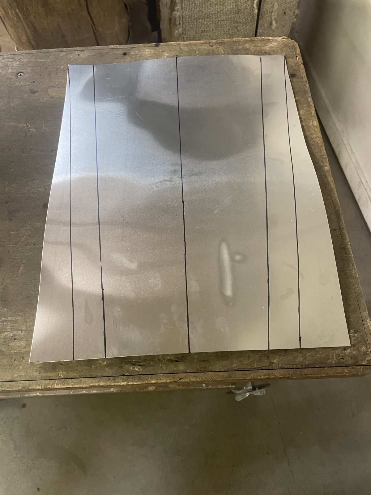

    Laid out the hood pattern last night, going to transfer it to some .063, 3003 aluminum today. IMG_9983.JPG IMG_9986.JPG IMG_9985.JPG IMG_9987.JPG IMG_9990.JPG IMG_9991.JPG IMG_9993.JPG IMG_9994.JPG

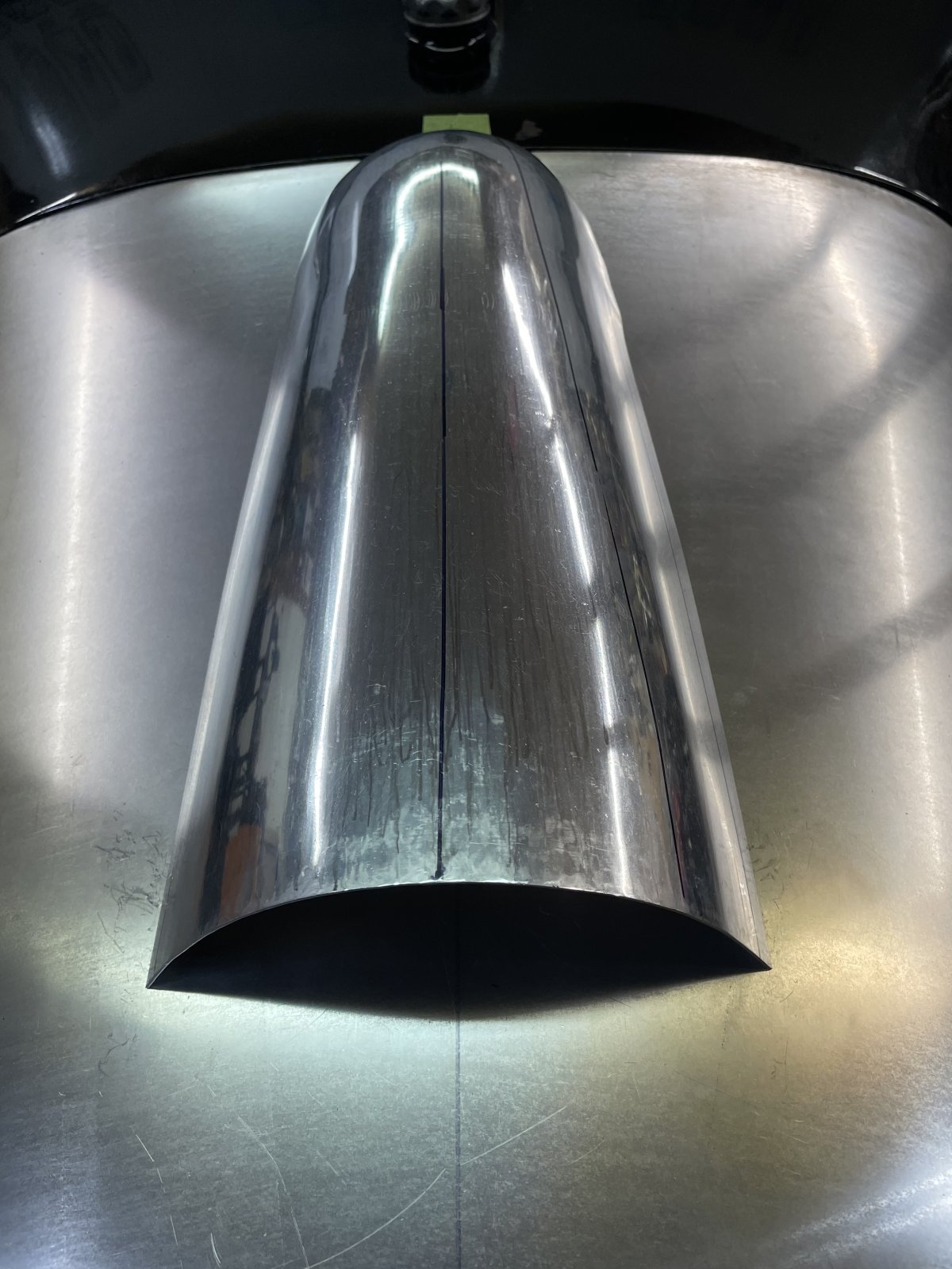

    OK, it's 2 hours later, and this is what I got accomplished. After getting the lines transferred, I started by t******* the line across the back and then the front. After filing and sanding the edge on the rear, it was time to run it through the rolls, concentrating on the rear center profile. Then back and forth to the rolls until it lays down pretty good. I need to get a cowl lacing before I can go any farther. At that time I will tune up the entire fit and trim the front, before folding the sides under, for a 1/2" flange on both sides, the mounting will be Dzus fasteners. I am contemplating a scoop or a bubble in the center for air intake, as the stacks are pretty close the the hood. Good Day ! IMG_9997.JPG IMG_9999.JPG IMG_0002.JPG IMG_0005.JPG IMG_0006.JPG IMG_0007.JPG IMG_0009.JPG IMG_0010.JPG IMG_0013.JPG IMG_0014.JPG IMG_0017.JPG IMG_0019.JPG

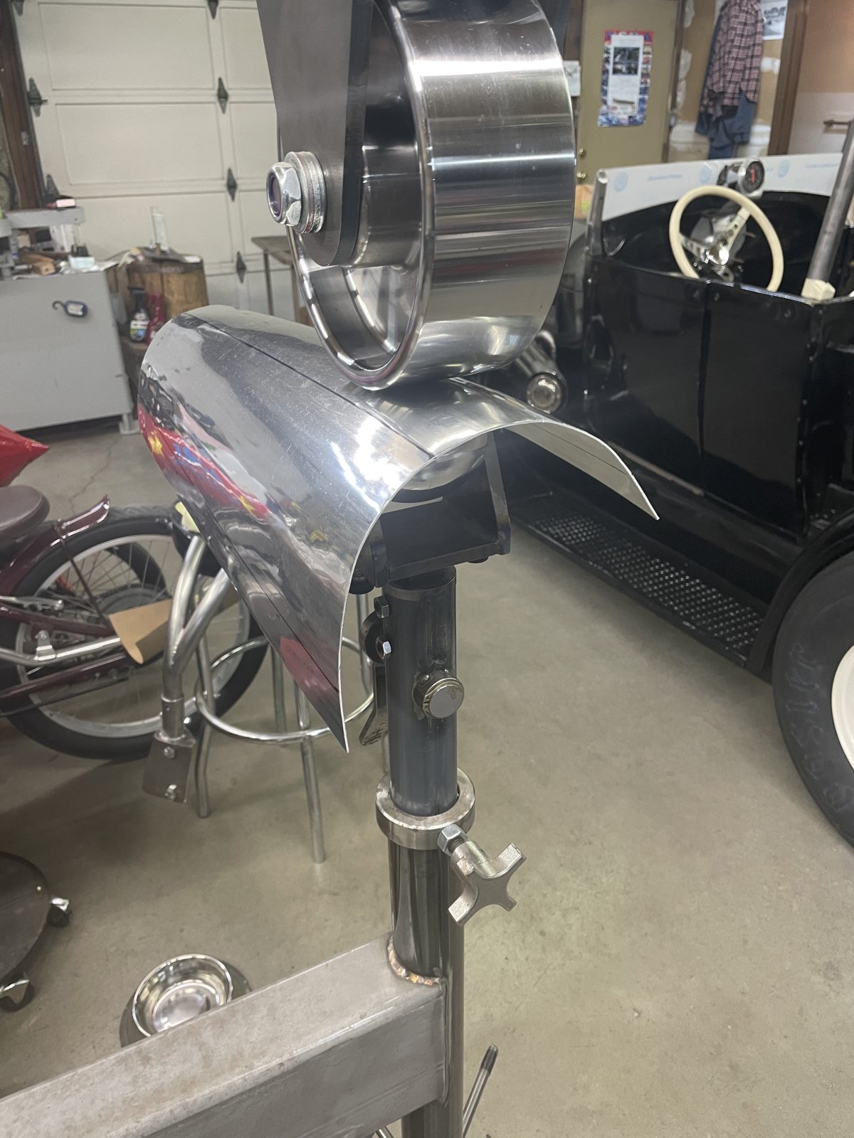

    I understand rolling it to fit the Cowl, but how does one achieve the tighter radius at the front (grill shell)?

    If you notice the first picture the roll is parallel to the centerline, and the next time it is at an angle to the centerline. That allows for the taper over the distance front to rear. With 3 rollers, two are stacked, and the the back one adjusts up at an angle, allowing to roll one end tighter than the other for a different radius on each end. What I couldn't show in the pictures, is how I clamp the piece in the brake, to hold it, while I hand form each end to fit the shape of the vehicle. As far as the Track Roadster, it will have to wait until I get the '29 ready to race, and the COE completed to haul it. BTW, I am thinking of the name I will paint on the hood sides, when it is in compe***ion livery. It will contain the word "Bone", as that was the man's last name on the ***le, when I bought it. It is truly an "A-Bone". IMG_0023.JPG
