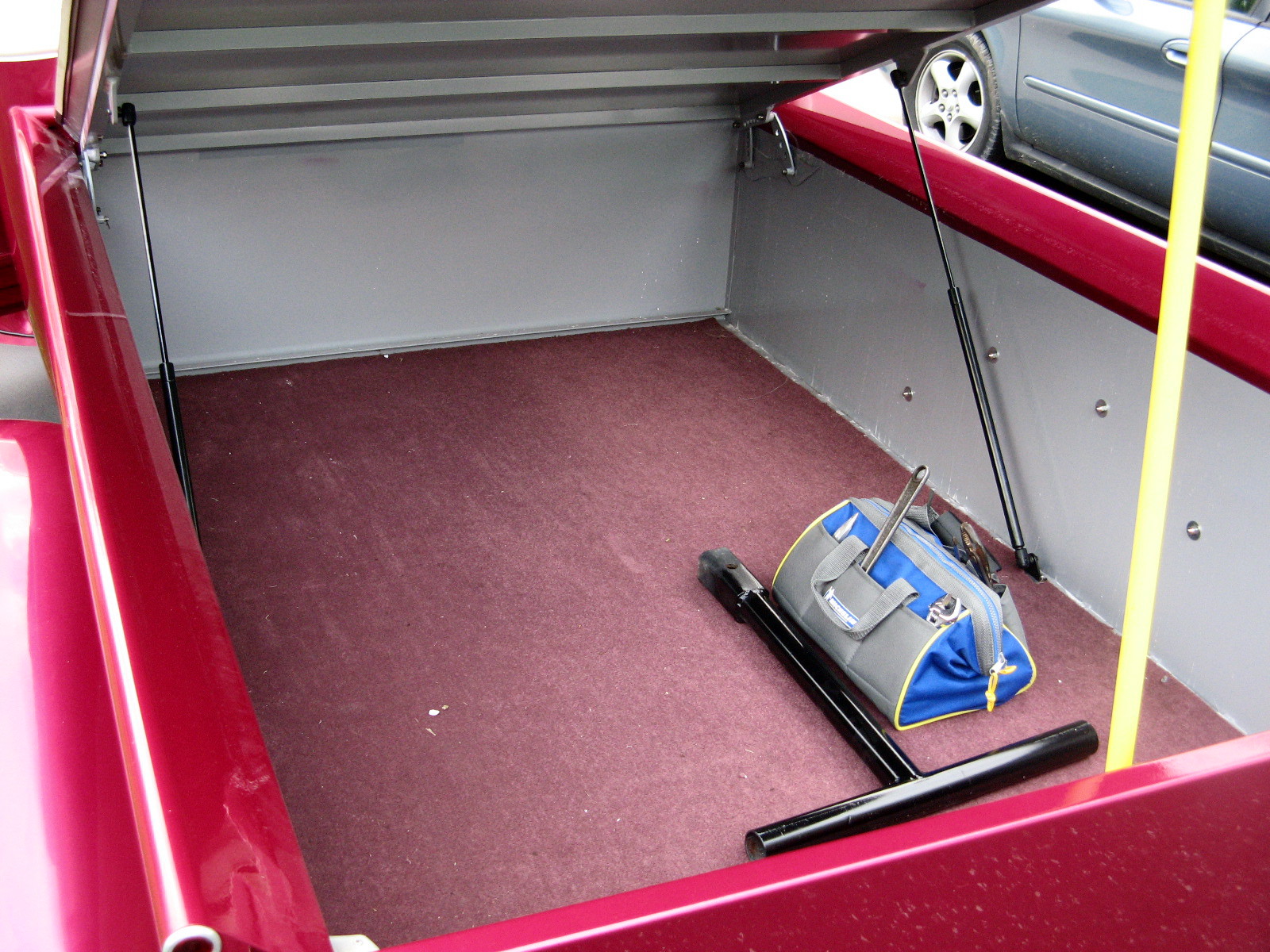

    My friend Sam @bskustoms is going to upholster the seats for the RP. I haven't asked him yet, but I will also need a tonneau cover for the bed. I didn't want to drill the box and tailgate for snaps, so I have been thinking of a way to do it. I decided to fab up and aluminum frame that would bolt to the holes already in the bed. I have a young guy that is like family, that gets some time off, about one Friday a month, and comes up from time to time to help me. He is sharp, has a good eye, fun to work with. We always get good things accomplished when he comes. We put our heads together, and came up with this, made out of .063, 5052 alloy. It does a couple things, including hiding the ripples in the base rails. There will be some cross bows that span the width of the box. IMG_0058.JPG IMG_0056.JPG IMG_0057.JPG IMG_0059.JPG IMG_0060.JPG IMG_0061.JPG IMG_0063.JPG IMG_0066.JPG IMG_0067.JPG

    Why would you not want to drill it for snaps Marty? It's just a Model A bed after all. This one still has the 60 year old snaps that Greg Schifano used when he upolstered the car.

    Dean, I thought drilling holes for snaps would add extra work for the next guy restoring it, with an electric motor. Actually my thinking was, it was a good way fill the voids on the front and back, to make it flat, and have a set of rails down each side to attach the cross bows to. Plus, remove 4 bolts and the whole thing comes off. We will see what Sam thinks.

    I did similar one piece aluminum on my 46. Its held down with two Dzus wing ****ons. Plus, I added the high heels handle.

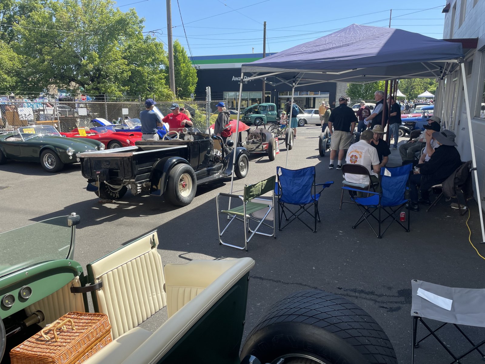

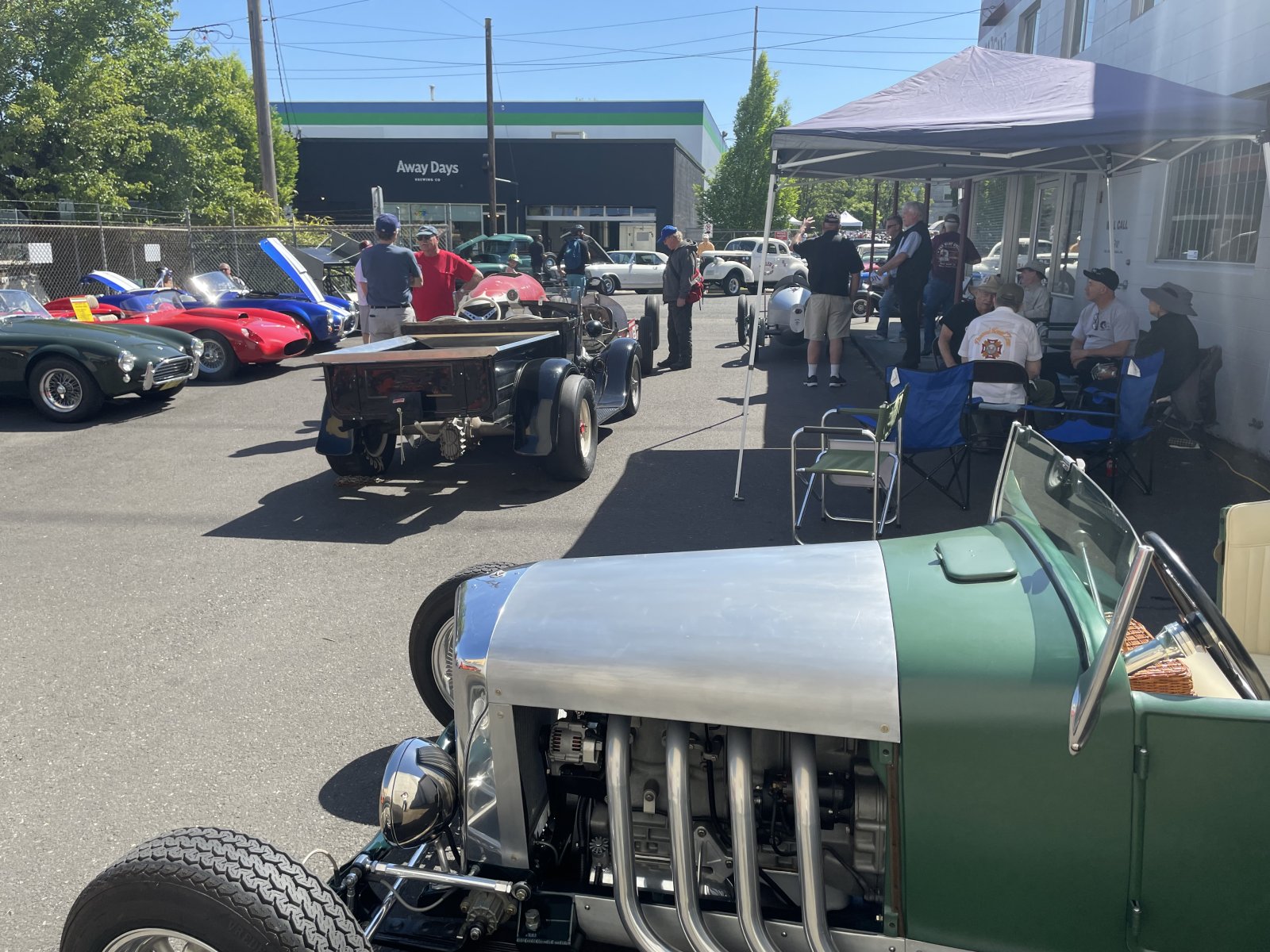

  29. Marty Strode
    Joined: Apr 28, 2011
    Posts: 9,710
    Marty Strode
    I didn’t take many photos, here are a few from our compound.
